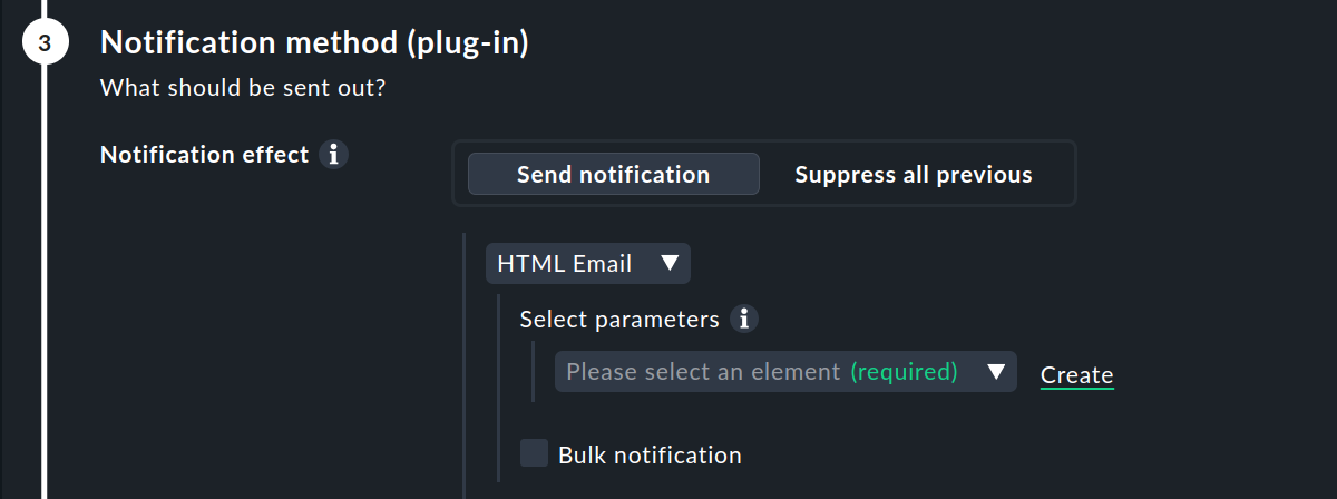

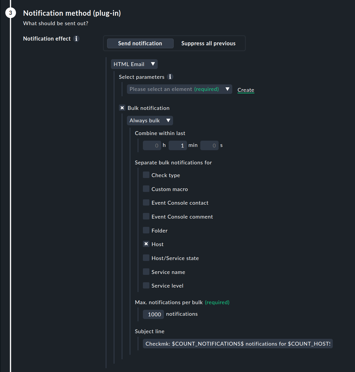

Notification method
The notification method in step 3 specifies the technique to be used for sending the notification., e.g. with HTML email.
Regel mit den Optionen zur Benachrichtigungsmethode.
Each method is realized using a script. Checkmk includes a number of predefined scripts. You can also quite easily write your own custom scripts in any desired programming language in order to implement special notifications — for example, to redirect a notification to your own ticket system.
Some notification methods can include parameters. For example, the methods for ASCII and HTML emails allow you to explicitly specify the sender address (From:). The appropriate page for setting the parameters appears after selecting the method as soon as you click on Create.
However, before you make settings in the individual notification rule here, you should know that you can also set parameters for the notification methods generally in two other places in Checkmk:
  • In the Parameters for notification methods, which are described later in this article. In the notification rule, select the desired parameter definition under Select parameters before you click on Create to change the selected parameter definition for this notification rule.
  • In the rules for hosts and services: Under Setup > Services > Service monitoring rules, you will find a rule set for each notification method in the Notifications section, which you can use to define the same settings — and as usual, depending on the host or service.
Only change the parameter definitions in the notification rule if you want to deviate from these settings for individual cases. For example, you can define a specific subject for your email globally, but define an alternative subject in an individual notification rule.
Instead of Send notification, you can also select Suppress all previous. Notifications from previous rules that used this method will then be discarded. You can find more information on this in the section Deleting notifications by rules.
For many notification methods for forwarding to other systems, you will find more detailed information in separate articles. The list of articles can be found in the chapter on notification scripts.

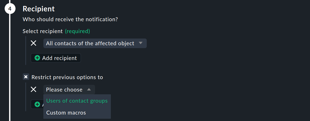

Selecting contacts
The most common procedure is for notifications to be sent to all users who have been registered as a contact for the respective host/service. This is the ‘normal’ and logical procedure, since it is also via the contacts that it is defined which objects each user receives in their GUI display — in effect those objects for which the user is responsible.
You can specify several options when selecting contacts with Add recipient and thus extend the notification to more contacts. Checkmk will automatically delete duplicate contacts. In order for the rule to make sense at least one selection must be made.
Rule with contact selection options.
The two Restrict previous options to options function somewhat differently. Here the contacts selected with the other options will again be restricted. With these you can also create an AND-operator between contact groups, for example, to enable notifications to be sent to all contacts who are members of both the Linux and Data center groups.
By entering Explicit email addresses you can notify persons who are not in fact nominated as users in Checkmk. This of course only makes sense when used in the notification method that actually sends emails.
If, in the chosen method, you have selected Suppress all previous, the notifications will only be deleted for the contact selected here.
When using a ticket system, a messenger or an event engine as notification method, you should also observe the notes on these special cases.

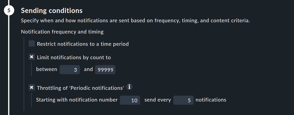

Conditions for sending notifications
You can skip the Sending conditions step for simple rules for the time being. These are primarily of interest if you want to set up escalations.
General properties
As with all rules in Checkmk, here you can include a description and a commentary for the rule, or even temporarily deactivate the rule.
Rule with the option to enable disabling of notifications by users.
With the Allow users to deactivate this notification option you can allow users to 'unsubscribe' from notifications generated by this rule. We show how to do this with the personal notifications.

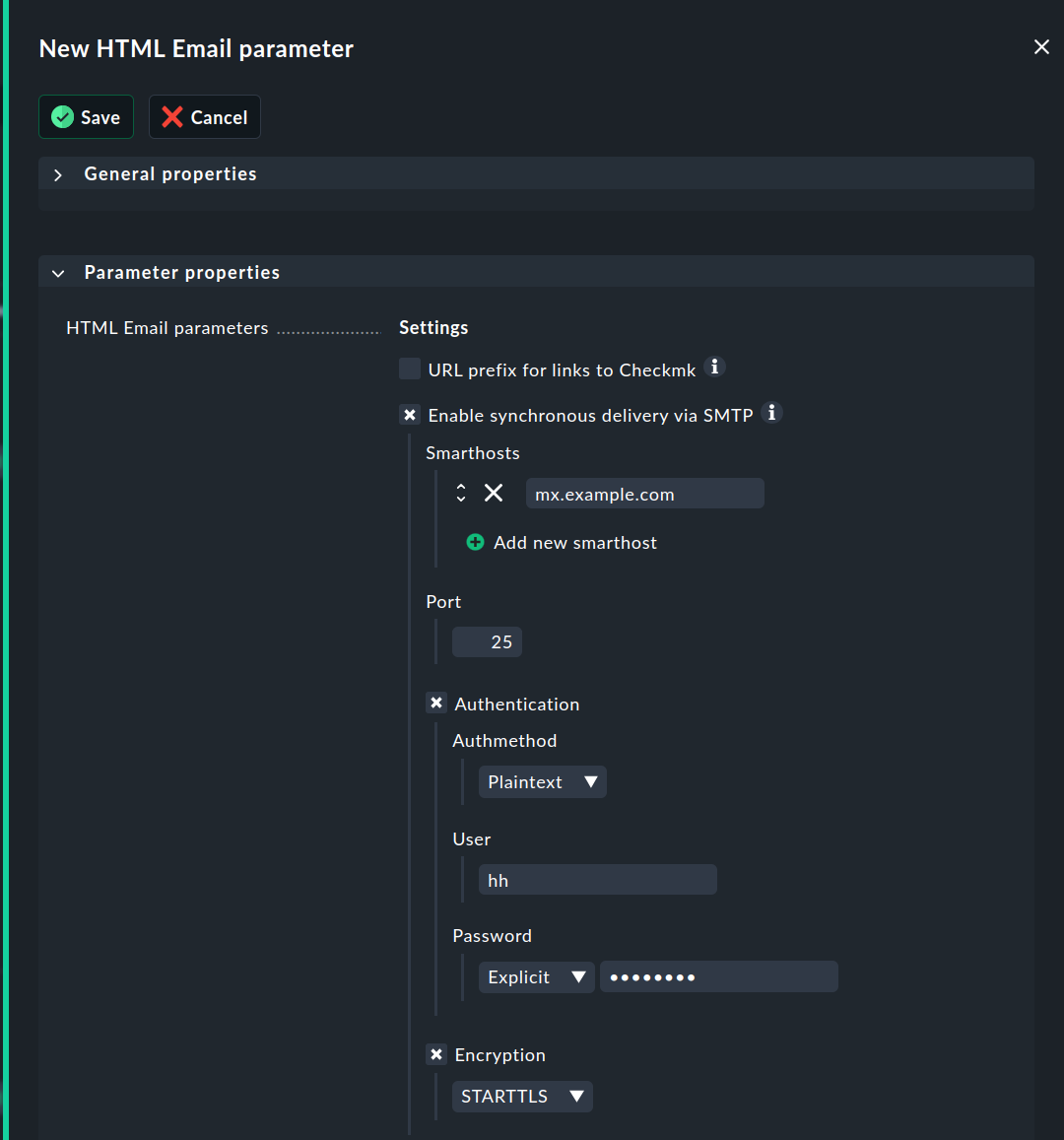

4.3. Set parameters for notification methods
You can define separate parameters for each notification method. These parameters are defined and managed separately from the actual notification rules in Checkmk. This allows you to use the parameters for multiple rules at the same time. You only need to make any changes centrally in one place, and you will get a uniform appearance for all notifications of the same type, regardless of the triggering rules.
Open the overview of all customizable parameters via Setup > Events > Notifications and the button Parameters for notifications methods:
“Overview of all notification methods for which parameters can be assigned.”
From here, you can create, edit and — if they are not used in any rule — delete the general parameters for each method.

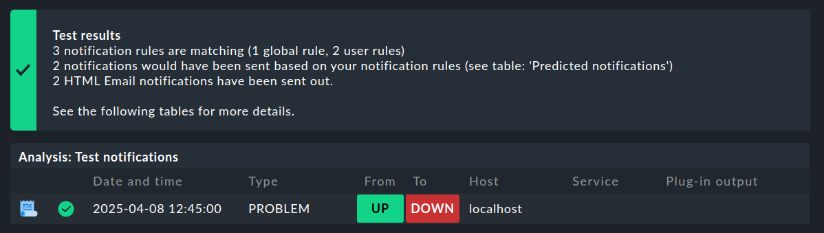

4.4. Testing notification rules
For testing notification rules, Checkmk offers a smart tool with Test notifications. You can use it to simulate a notification for a host or service and recognize which of your notification rules are effective. In addition to the simulation, you can also have the notification sent.
The quickest way to access the notification test is via Setup > Events > Test notifications. In addition, there are other options for calling from some views in Monitoring (service list and service details) and in the Setup (host properties), in each case in the menu Host > Test notifications.
Dialog for defining the properties of the simulated notification.
First, click on one of the two buttons to decide whether the notification is for a Host or a Service. Then select which host or service it should be. As the event you can select a state change or the start of a scheduled downtime. You can add a description of the event to Plugin output. Use the Send out notification for specific method checkbox to specify whether the notification is only simulated or actually sent.
Finally, under Advanced condition simulation there are two further options with which you can define the time and number of notifications. This allows you to test notification rules that only apply during a certain period (e.g. outside of business hours) or that start an escalation after a specified number of repeated notifications.
Click on Test notifications to start the test — and also the dispatch, if you have selected this option. The results are displayed below the Test notifications box:
Die Zusammenfassung der Simulationsresultate.
First comes the summary. Under Test results you can see how many notification rules apply and how many notifications result from them. If you have selected Send out notification, the corresponding message notifications have been sent out is displayed here. This must then immediately lead to an email for this problem.
The line below summarizes the notifications generated from your entries. By clicking on the Icon for showing or hiding the notification context. icon, you can show the notification context. This allows you to see the environment variables and their values that are valid in the context of this notification.
The following two sections then show more details:
The details of the simulation results.
Under Predicted notifications you can see to whom and how notifications would be sent. You will also receive this information about the simulation if you have not selected to send the notification.
Under Global notification rules the notification rules are listed that you have created here. At this point, only the first column of the table is important, which uses icons to indicate which of the rules apply Icon for displaying a positive status. and which do not Icon for displaying a negative status..

Set up escalations and understand them
To set up an escalation, create an additional notification rule which uses the Restrict to notification number condition.
Regel zur Einstellung der Häufigkeit von Benachrichtigungen.
If you enter 3 to 99999 as the range for the sequential number, this rule takes effect from the third notification. The escalation can then be performed either by selecting another method, (e.g., SMS), or it can notify other persons (contact selection).
With the Throttling of 'Periodic notifications' option, after a given time the rate of notification repetition can be reduced so that, for example, in the beginning an email can be sent every hour, and later this can be reduced to one email per day.
With multiple notification rules, you can build an escalation model. But how will this escalation then function in practice? Who is notified and when? Here is an example, implemented with one rule for periodically repeated notifications as well as three notification rules: For example:

As already mentioned in the selection of the notification method, you will also find the selection option Suppress all previous. In order to be able to understand the functioning of such a rule, it is best to visualize the notification table. Assuming the processing of the rules for a concrete monitoring event is partly complete, and that due to a number of rules the following three notifications have been triggered:
Who (contact) How (method)
Harry Hirsch
Email
Bruno Weizenkeim
Email
Bruno Weizenkeim
SMS
Now comes a next rule with the SMS method and the Suppress all previous selection. The contact selection chooses the 'Windows' group, in which Bruno Weizenkeim is a member. As a result of this rule, the entry 'Bruno Weizenkeim / SMS' is removed from the table, which then looks like this:
Harry Hirsch
Email
Bruno Weizenkeim
Email
Should a subsequent rule again define an SMS notification for Bruno, then this rule will have priority and the SMS will be added anew to the table.
To summarize:
  • Rules can suppress (delete) specific notifications.
  • Deletion rules must come after the rules that create the notifications.
  • A deletion rule does not actually ‘delete’ a preceding rule, rather it suppresses the notifications that are generated by (possibly multiple) preceding rules.
  • Subsequent rules can reinstate the previously suppressed notifications.
4.7. Synchronous delivery for HTML emails
You can select and configure the traceable delivery via SMTP for the notification method HTML email by entering the smarthost (with name and port number) and the access data and encryption method:
Notification method with synchronous email delivery options.
In the history of the service concerned, you can then track the delivery exactly. Here is an example in which a service — for testing purposes — was manually set to CRIT. The screenshot below shows the notifications for this service, which you can display on the service details page with Service > Service Notifications:

The mode of operation of this bulk notification is very simple. When a notification occurs, at first it will be held back for a short time. Subsequent notifications that occur during this time will be immediately added into the same email. This collecting can be defined for each rule. So, for example, during the day you can operate with individual emails, but overnight with a bulk notification. If a bulk notification is activated you will generally be offered the following options:
Notification method with bulk notification options.
The waiting time can be configured as desired. In many cases one minute suffices as by then at the latest all related problems should have appeared. You can of course set a longer time, but that will result in a fundamental delay to the notifications.
Since it naturally makes no sense to throw everything into a single pot, you can specify which groups of problems should be notified collectively. The Host option is very commonly used — this ensures that only notifications from the same host are bundled.
Here are a few additional facts about bulk notifications:
  • If the bundling is activated in a rule, the activation can be deactivated by a subsequent rule – and vice versa.
  • The bulk notification always takes place per contact. Each contact has their own 'private collection pot' in effect.
  • You can limit the size of the pot (Max. notifications per bulk). Once the maximum is reached the bulk notification will immediately be sent.
