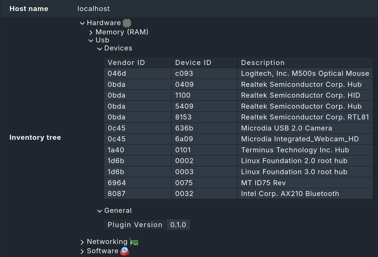

A look at the test host’s inventory now shows—​as soon as the next regular check has been performed—​a new leaf in the inventory tree.

4.4. The finished plug-in
The finished plug-in puts everything together. The TableRow class is also imported here:
~/local/lib/python3/cmk_addons/plugins/lsusb_demo/agent_based/inventory_lsusb_demo.py
#!/usr/bin/env python3
from cmk.agent_based.v2 import InventoryPlugin, Attributes, TableRow
def parse_lsusb_demo(string_table):
    parsed = { "devices": [] }
    for line in string_table:
        vendor = line[5].split(":")[0]
        device = line[5].split(":")[1]
        description = ""
        for i in range(6, len(line)):
            description = description + " " + line[i]
        parsed["devices"].append({ "vendor": vendor, "device": device, "description": description })
    return parsed
def inventory_lsusb_demo(section):
    section = parse_lsusb_demo(section)
    yield Attributes(
        path = [ "hardware", "usb", "general" ],
        inventory_attributes = { "Plugin version": "0.1.0" },
    for d in section["devices"]:
        yield TableRow(
            path = [ "hardware", "usb", "devices" ],
            key_columns = {
                "vendor": d["vendor"],
                "device": d["device"],
            inventory_columns = {
                "description": d["description"],
inventory_plugin_lsusb_demo = InventoryPlugin(
    name = "lsusb_demo",
    inventory_function = inventory_lsusb_demo,

Inventory tree with Hardware > USB > Devices expanded.
After using the UI API, the columns will be displayed in the desired order

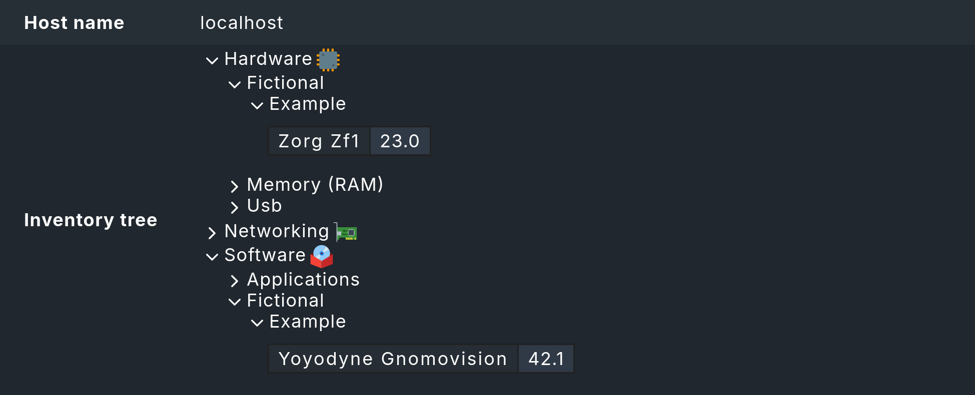

In the Checkmk inventory, the resulting nodes look like this:
Inventory tree with the expanded nodes for Software > Fictional > Example and Hardware > Fictional > Example.
Here, a single inventory function evaluates two agent sections
