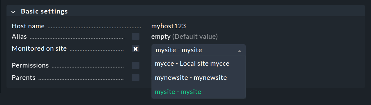

In distributed monitoring, you can organize your piggyback data according to your operational structures. This means that piggyback data that flows into monitoring via a host can be assigned to another host for evaluation — even across sites. Piggyback data is forwarded via the central site.
By default, piggyback data is always processed on the site on which it is detected, and the data is automatically assigned to the host on which it arrives. You can change this behavior via the host properties.
“Settings for the monitoring site.”
Select the desired alternative site here — whether it is the central site or a remote site on which you want to monitor the piggyback data. The following also applies to the hosts on the 'new' site: Hosts must be present.
To reduce the load on your central site, you can alternatively transfer the piggyback data from one remote site to another directly — i.e. without involving the central site. Further information on this peer-to-peer connection can be found in the Distributed monitoring article.
