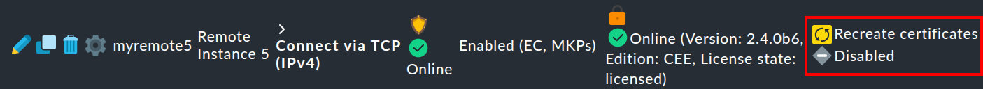

2.3. Connecting Livestatus with encryption
From version 1.6.0 Livestatus connections between the central site and a remote can be encrypted. For newly-created sites nothing further needs to done, as Checkmk takes care of the necessary steps automatically. As soon as you then use omd config to activate Livestatus, encryption is also automatically activated by TLS:
distributed monitoring livestatus tcp tls activated
The configuration of distributed monitoring therefore remains as simple as it has been up to now. For new connections to other sites the option Encryption is then automatically enabled.
After you add the remote site, you will notice two things — firstly, the connection is marked as encrypted by this new icon encrypted icon. And secondly, Checkmk will tell you that the CA will no longer trust the remote site. Click on icon encrypted to get to the details of the certificates used. A click on icon trust lets you conveniently add the CA via the web interface. Then both certificates will be listed as trusted:
distributed monitoring certificate details

Piggyback data
Some check plug-ins use Piggyback data, for example, to assign monitoring data that has been 'piggybacked' from a host to the individual virtual machines. In distributed monitoring, the piggyback host — i.e. the host that receives the piggyback data — and the hosts that depend on it — as the actual consumers of the piggyback data — are not always monitored from the same site. For such cases, a cross-site host assignment of piggyback data can be activated.
You should check this at the latest when you see Disabled here:
“The piggyback connection is displayed as 'disabled'.”
