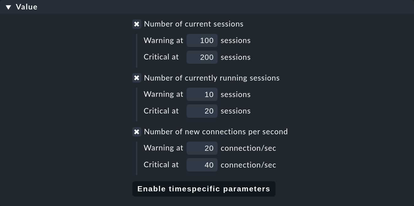

Monitoring sessions
Some of the checks set up in this way have no preset threshold values. This is usually the case because there are no reasonable default values that would be sufficient in most cases. However, these can be set up in a few simple steps.
For example, you can find in the Service monitoring rules the MySQL sessions & connections rule. This can be used to define meaningful threshold values for the MySQL sessions service for your MySQL instance.
mysql sessions connections

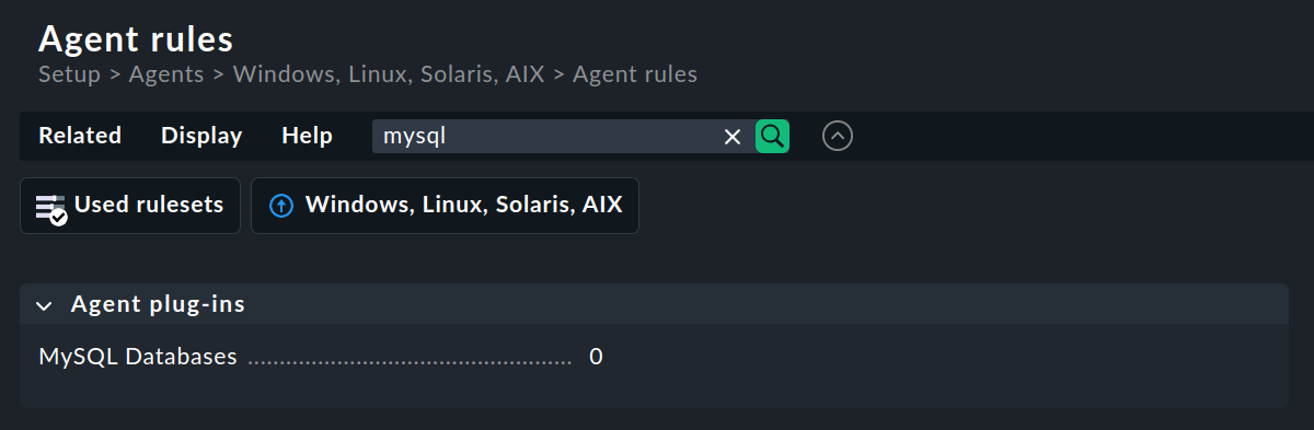

4. Configurations using the Agent Bakery
CEE The setup is much simplified with the Agent Bakery, since syntax errors in the configuration files are avoided, and adaptations to changing environments can easily be made. The main difference compared to a manual installation is that only for special MySQL-specific configurations you have to work on the MySQL host on its command line.
For the initial setup, it is sufficient if you set up the database user on the MySQL host, and create a corresponding rule in the Agent Bakery. You can find the rule set under Setup > Agents > Windows, Linux, Solaris, AIX > Agent rules. You can then search for mysql in the search field:
mysql bakery ruleset search
