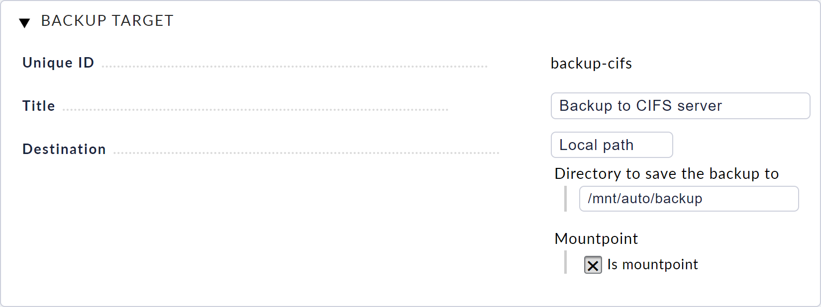

Now select Device backup from the main menu of the web interface and open the backup targets from there via Backup targets. Create a new target via New backup target. You can freely choose the ID and the title. Under Directory to save the backup to configure the file path for the mounted network share, here /mnt/auto/backup. The option Is mountpoint should be active when you back up to a network share. This allows the backup to check whether the network share is actually mounted before saving.
Setting the backup target.

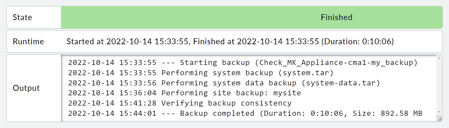

Start the job you have just set up by clicking on the play icon. You will now see in the table that the job is currently being executed. Click on the log icon to display the progress of the job in the form of log output.
Once the backup has been completed, this will also be displayed in the table.

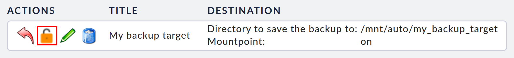

7.1. Decrypting a backup
In exceptional situations, it may be necessary to only decrypt an encrypted backup and not restore it completely. You may only want to extract individual files from a backup or examine the backup. As of version 1.7.3 of the appliance, there is an additional button in the restore menu (Device backup > Restore).
cma en backup decrypt backup
As soon as you click on this button, you will see an overview of all encrypted backups that are located in this backup target. Now click on the lock icon in the line of the desired backup, then enter the passphrase of the backup key used and click on Start decryption.
Once the process is complete, you will find the decrypted backup in the list of all backups of the respective backup destination. (Device backup > Restore) It has the same name as the source backup, supplemented by the suffix _decrypted.
