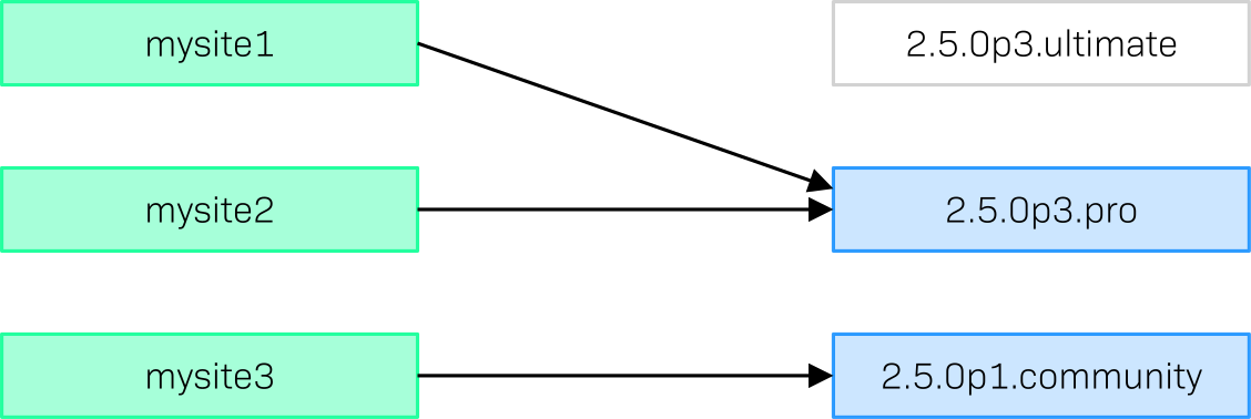

The reason is that Checkmk not only allows multiple independent sites to run on a single server, but it also allows multiple software versions to be installed simultaneously. With this system each site is assigned to an installed version of the software. To illustrate, we can take the following situation on a fictional server:
Three sites and their software versions used.
Here, the sites mysite1 and mysite2 use version 2.5.0p3.pro, and the site mysite3 uses version 2.5.0p1.community. Although Checkmk-Version 2.5.0p3.ultimate has been installed, it is currently not being used.
This example makes it clear that an update does not simply mean the installation of a new Checkmk RPM/DEB package on a server. An additional step is also required. Let us take the following situation as an example:

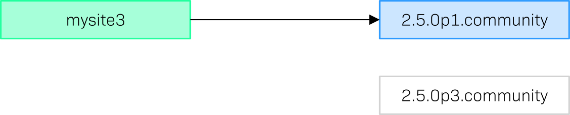

The site 'mysite3' with the software version used before the update.
Here, the site mysite3 is to be updated to the Checkmk version 2.5.0p3.community. The first step is to download and install the appropriate RPM/DEB-Packet. This is performed exactly as with the initial installation. At first the newly-installed version will not be used by any site, and it will look like this:
The situation after installing the new software version.

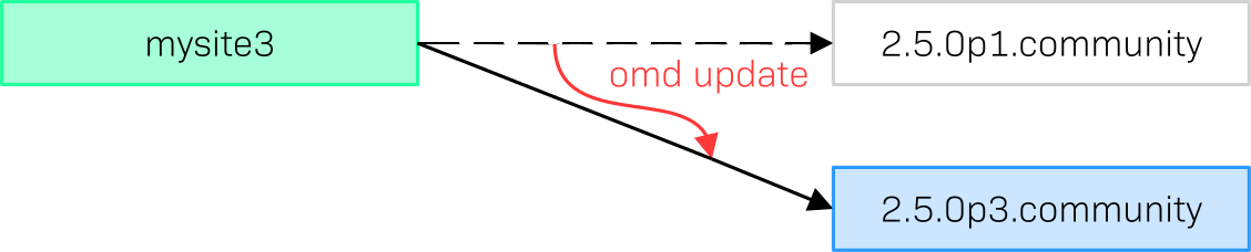

The second step will now be to update the site from 2.5.0p1.community to the 2.5.0p3.community. This is performed with the omd update command, which we will discuss in detail below:
With 'omd update' the site receives the new software version.
Following the update, the (likely) no longer required version 2.5.0p1.community can be deleted by uninstalling the appropriate package.
