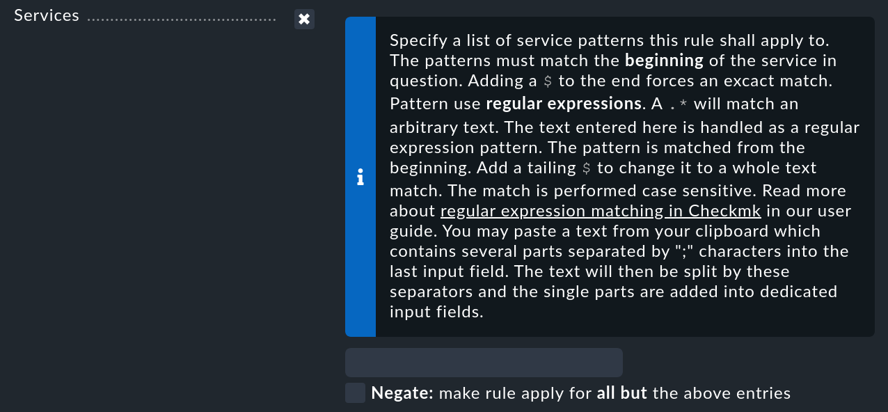

In Checkmk, regular expressions are allowed in input fields on various pages. If you are unsure, use the context-sensitive help via the Help menu (Help > Show inline help). There you can see whether regular expressions are permitted and how they can be used.

In monitoring and the Event Console, infix match is the standard. In monitoring, infix match is the standard. Expressions that occur anywhere in the text are found, i.e. the search for 'memory' also finds 'kernel memory'. In the Setup GUI, on the other hand, when comparing regular expressions with service names and other things, Checkmk basically checks whether the expression matches the beginning of the text (prefix match) — this is usually what you are looking for:
regexes servicematch
If you do need an infix match in places where prefix match is provided, simply extend your regular expression with .* at the beginning to match any prefixed string:
