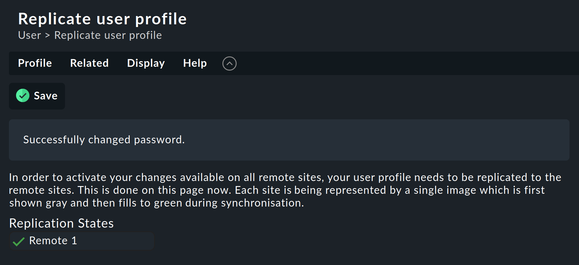

Once the remote site has been subordinated to the central site,
all users will be replaced by those from the central site anyway.

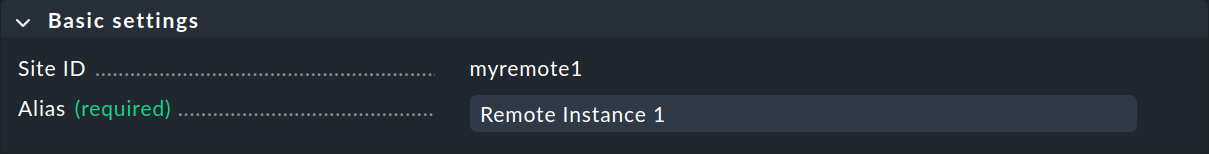

Add connection, now define the connection to the first remote site:
In the Basic settings it is important to use the remote site’s EXACT name — as defined with omd create — as the Site ID.
As always the alias can be defined as desired and also be later changed.

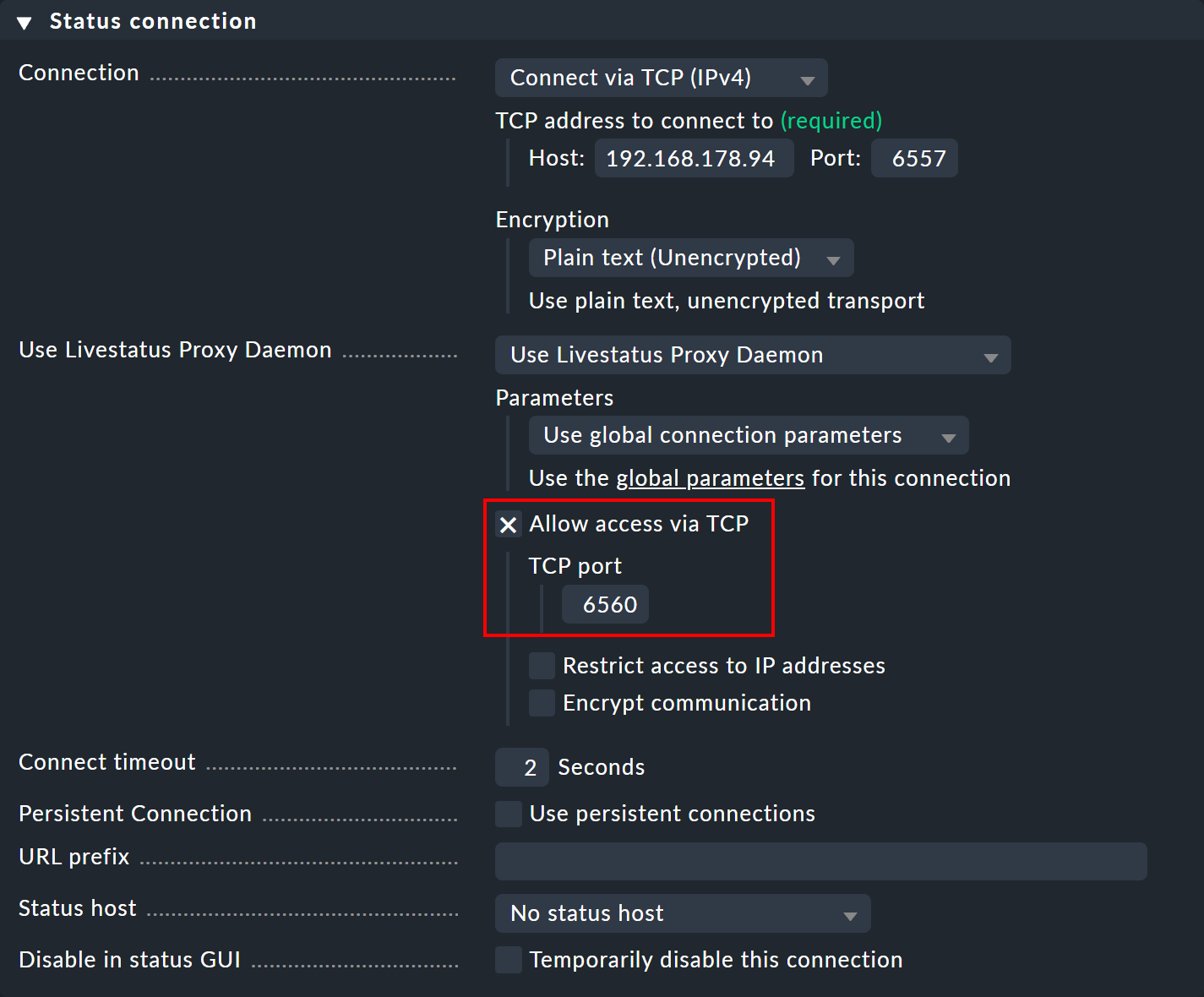

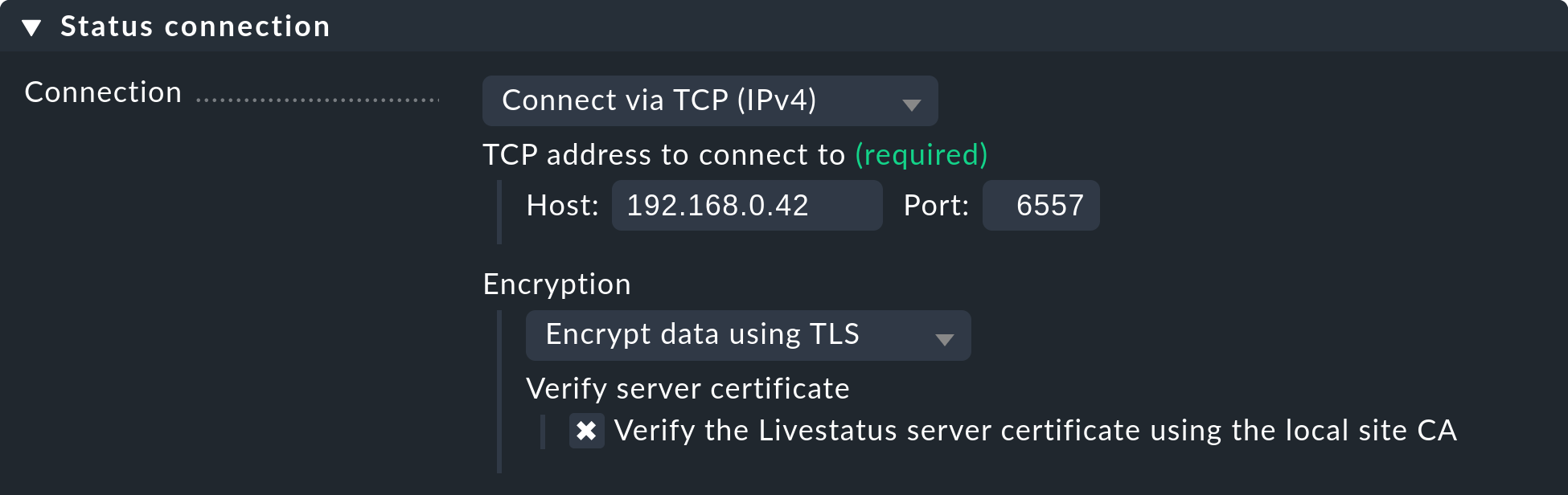

The settings of the Status connection determine how the central site queries the status of the remote sites via Livestatus. The example in the screenshot shows a connection with the Connect via TCP(IPv4) method. This is the optimal for stable connections with short latency periods (such as, e.g. in a LAN). We will discuss the optimal settings for WAN connections later.
Here enter the HTTP URL for the remote site’s web interface, without the check_mk/ at the end of the URL.
If you normally access Checkmk per HTTPS, then substitute the http here with https.
Further information can be found in the online help
or the article on securing the web interface with HTTPS.

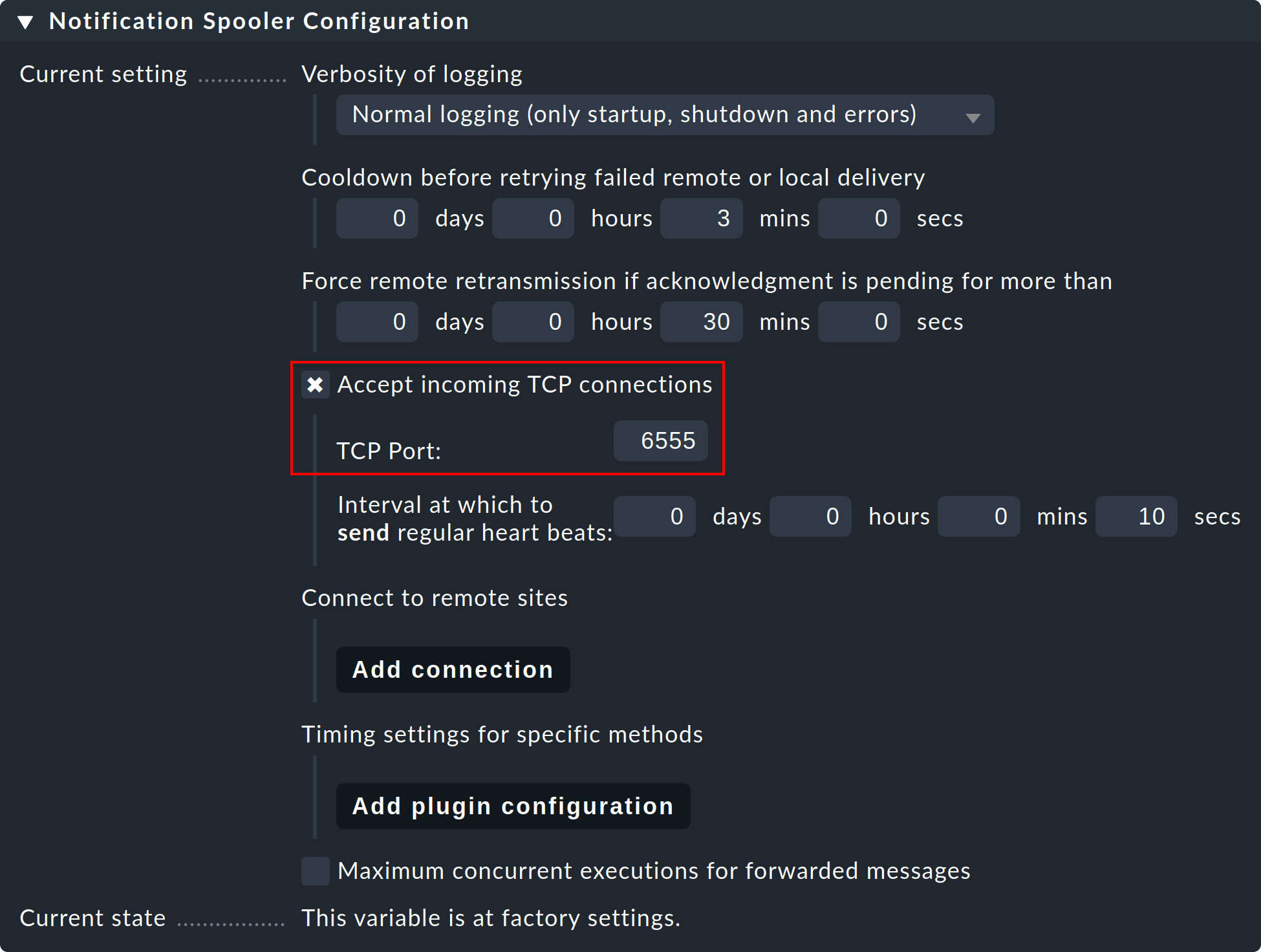

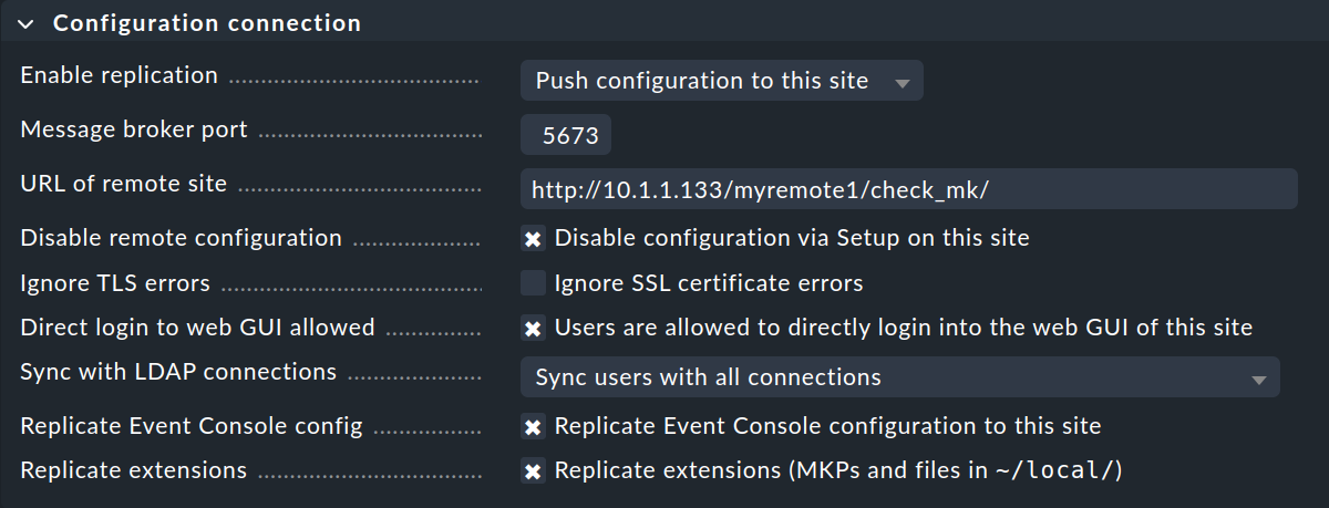

Replicating the configuration and thus using the central setup is, as we discussed in the introduction, optional. Activate replication by selecting Push configuration to this site if you wish to configure the remote from the central site. In such a case select the exact settings as shown in the image above.
Be sure to check which Message broker port you need to specify.
To find this out, log in to the respective remote site and run omd config from the command line.
Navigate to the section Basic.
Here the variable RABBITMQ_PORT is the relevant one.
┌─────────────────Basic───────────────────┐ │ ┌─────────────────────────────────────┐ │ │ │ ADMIN_MAIL │ │ │ │ AGENT_RECEIVER on │ │ │ │ AGENT_RECEIVER_PORT 8016 │ │ │ │ AUTOMATION_HELPER on │ │ │ │ AUTOSTART on │ │ │ │ CORE cmc │ │ │ │ RABBITMQ_DIST_PORT 25672 │ │ │ │ RABBITMQ_MANAGEMENT_PORT 15671 │ │ │ │ RABBITMQ_ONLY_FROM :: │ │ │ │ RABBITMQ_PORT 5671 │ │ │ │ TMPFS on │ │ │ │ │ │ │ └─────────────────────────────────────┘ │ ├─────────────────────────────────────────┤ │ < Change > <Main menu> │ └─────────────────────────────────────────┘
Don’t be confused: the Message Broker Port is defined in the variable |
A correct setting for the URL of remote site is very important.
The URL must always end with /check_mk/. A connection with HTTPS is recommended, provided that the remote site’s Apache supports HTTPS.
This must be installed manually on the remote site at the Linux level.
For the Checkmk Appliance, HTTPS can be set up using the web-based configuration interface.
If you utilize a self-signed certificate, you will require the Ignore SSL certificate errors check box.

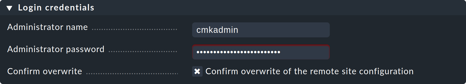

In order to use the central setup you still need a Login for the remote Checkmk site.
To this end, the central site exchanges a randomly-generated login secret with the remote site, through which all future communication will take place.
The cmkadmin account on the remote site will subsequently no longer be used.
In the following form, use as Login credentials cmkadmin and the password assigned when creating the remote site.
At this point, confirm that you want to overwrite the settings by clicking Confirm overwrite.
A successful login will be so acknowledged:

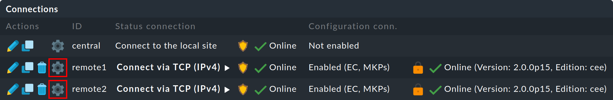

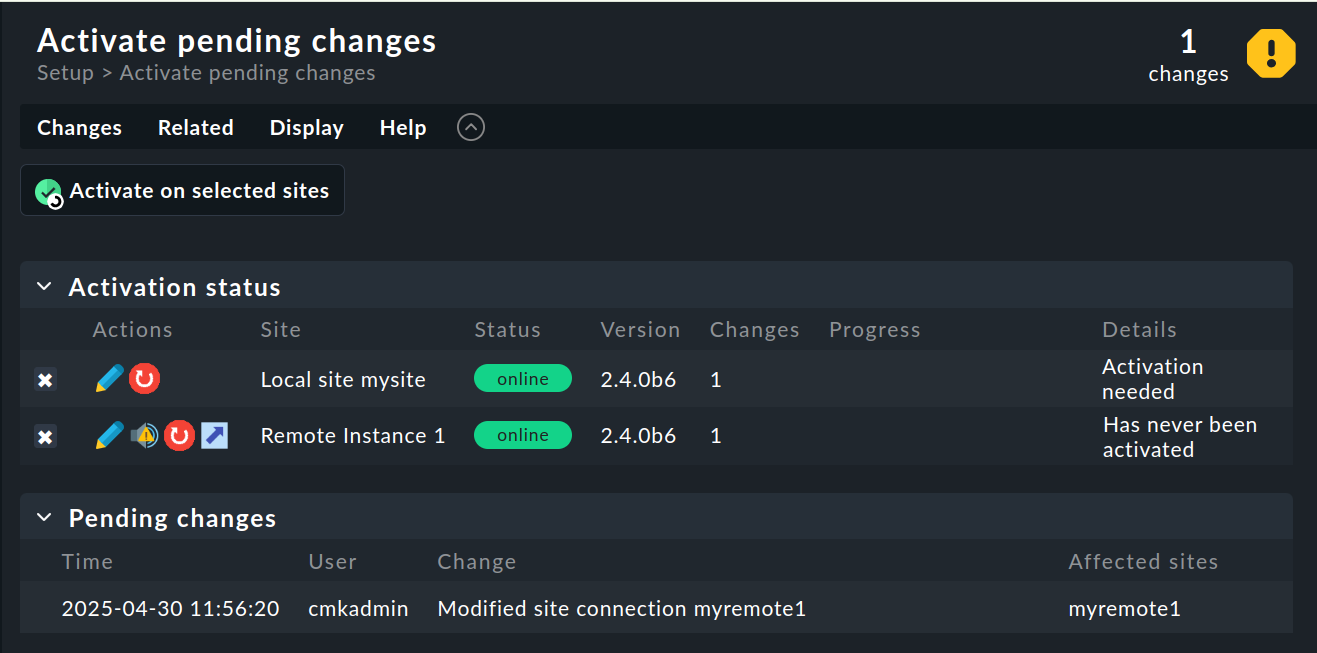

When everything has been successful, run Activate Changes. This will, as always, bring you to an overview of the not yet activated changes. Simultaneously the overview will also show the states of the Livestatus connections, likewise the synchronization states of the individual sites in the central setup:
The Version column shows the Livestatus-version of the respective site. When using the CMC as the Checkmk’s core (commercial editions), the core’s version number (shown in the ‘Core’ column) is identical to that of the Livestatus. If you are using Nagios as the core (Checkmk Community), the Nagios version number will be seen here.
The following icons show the replication status of the configuration environment:
This site has outstanding changes.
The configuration matches the central site, but not all changes have been activated.
With the |
The configuration for this site is not synchronous and must be carried over.
A restart will then of course be necessary to activate it.
Both functions can be performed with a click of the |
In the Status column the state of the Livestatus connection for the respective site can be seen. This is shown purely for information since the configuration is not transmitted via Livestatus, but rather over HTTP. The following values are possible:
The site is reachable via Livestatus. |
The site is currently not reachable. Livestatus queries are running in a timeout. This delays the page loading. Status data for this site is not visible in the GUI. |
The site is currently not reachable, but this is due to the setting up of a status host or is known through the Livestatus proxy (see below). The inaccessibility does not lead to timeouts. Status data for this site is not visible in the GUI. |
The Livestatus connection to this site has been temporarily deactivated by the (central site’s) administrator. The setting matches the Temporarily disable this connection check box in the settings for this connection. |
Clicking the
Activate on selected sites button will now synchronize all sites and activate the changes.
This is performed in parallel, so that the overall time equates to the time required by the slowest site.
Included in the time is the creation of a configuration snapshot for the respective site, the transmission over HTTP, the unpacking of the snapshot on the remote site, and the activation of the changes.
Important: Do not leave the page before the synchronization has been completed on all sites — leaving the page will interrupt the synchronization.

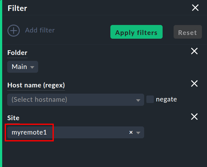

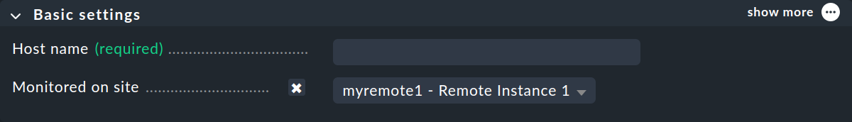

Specifying to the hosts and folders which site should monitor them

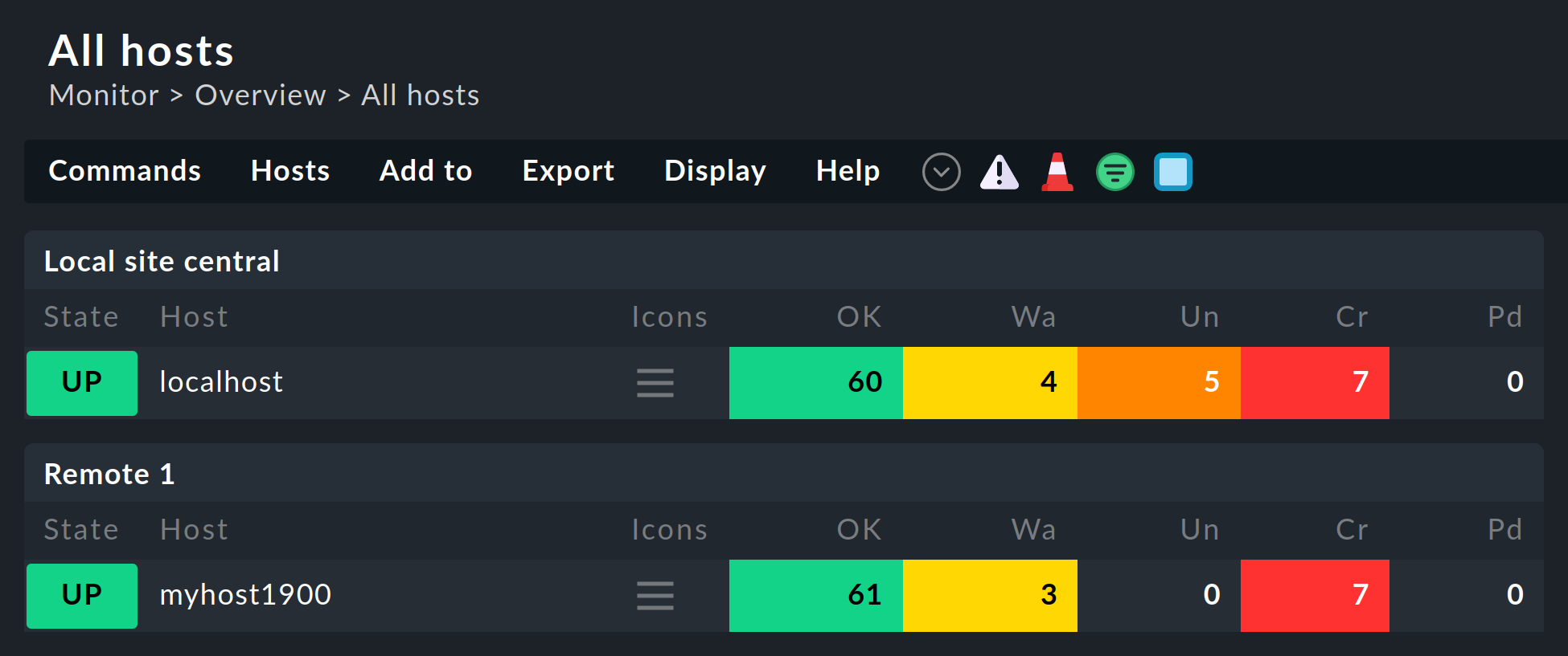

Once your distributed environment has been installed you can begin to use it. You actually only need to tell each host by which site it should be monitored. The central site is specified by default.
The required attribute for this is Monitored on site. You can set this individually for each host. This can naturally also be performed at the folder level:
Executing a fresh service discovery and activating changes for migrated hosts

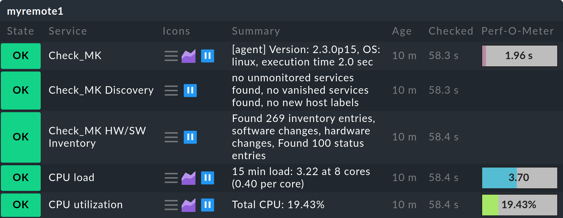

Adding hosts functions as usual — apart from the fact that the monitoring as well as the service discovery will be run from the respective remote site, there are no special considerations.
When migrating hosts from one site to another there are a couple of points to be aware of. Neither current nor historic status data from the host will be carried over. Only the host’s configuration is retained in the configuration environment. In effect it is as if the host has been removed from one site and freshly-installed on the other site:
Automatically discovered services will not be migrated. Run a service discovery after the migration.

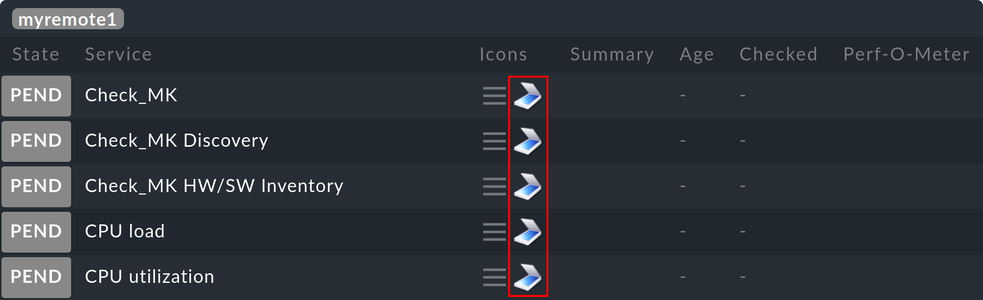

Once restarted, hosts and services will show PEND. Currently existing problems may as a result be newly notified.
Historic metrics will be lost. This can be avoided by manually moving the relevant RRD-files. The location of the files can be found in Files and directories.
Data for availability and from historic events will be lost. These are unfortunately not easy to migrate as the data consists of single lines in the monitoring log.

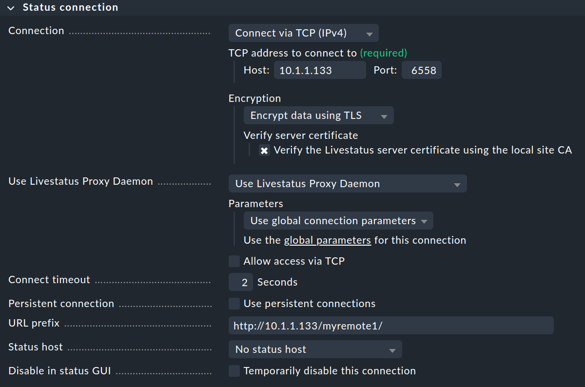

2.3. Connecting Livestatus with encryption
Livestatus connections between the central site and a remote site can be encrypted.
For newly-created sites nothing further needs to done,
as Checkmk takes care of the necessary steps automatically.

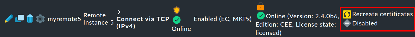

As soon as you then use omd config to activate Livestatus, encryption is also automatically activated by TLS:
┌────────────Distributed Monitoring──────────────┐ │ ┌────────────────────────────────────────────┐ │ │ │ LIVEPROXYD on │ │ │ │ LIVESTATUS_TCP on │ │ │ │ LIVESTATUS_TCP_ONLY_FROM 0.0.0.0 ::/0 │ │ │ │ LIVESTATUS_TCP_PORT 6557 │ │ │ │ LIVESTATUS_TCP_TLS on │ │ │ │ PIGGYBACK_HUB on │ │ │ │ │ │ │ └────────────────────────────────────────────┘ │ ├────────────────────────────────────────────────┤ │ < Change > <Main menu> │ └────────────────────────────────────────────────┘
The configuration of distributed monitoring therefore remains as simple as it has been up to now. For new connections to other sites the option Encryption is then automatically enabled.
After you add the remote site, you will notice two things — firstly, the connection is marked as encrypted by this new
icon.
And secondly, Checkmk will tell you that the CA will no longer trust the remote site.

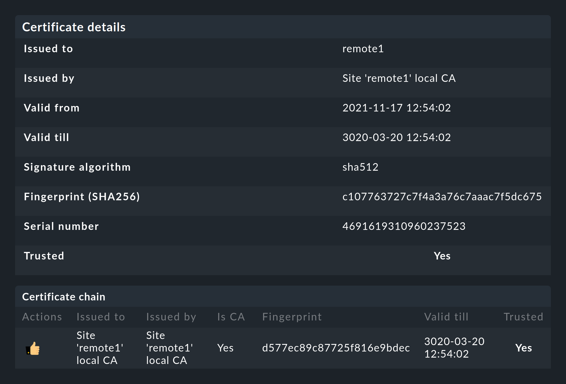

Click on
to get to the details of the certificates used.
A click on
lets you conveniently add the CA via the web interface.
Then both certificates will be listed as trusted:

To achieve the encryption Checkmk uses the stunnel program along with its own certificate and its own certificate authority (CA) to sign the certificate.
These will be individually generated automatically with a new site and they are therefore not predefined static CAs or certificates.
That is a very important safety factor to prevent fake certificates from being used by attackers, because any attackers could then gain access to a publicly-available CA.
The generated certificates also have the following properties:
Both certificates are in the PEM format. The signed certificates for the site also contain the complete certificate chain.
The keys use 4096-bit RSA, and the certificate is signed using SHA512
The site’s certificate is valid for 10 years.
The fact that the standard certificate is valid for so long very effectively prevents you from getting connection problems that you cannot classify. At the same time it is of course possible that once a certificate has been compromised it is accordingly long open to abuse. So if you fear that an attacker will gain access to the CA or to the site certificate signed with it, always replace both certificates (CA and site)!

Access to the monitored hosts
All accesses of a monitored host are consistently carried out from the site to which the host is assigned. This applies not only to the actual monitoring, but also to the service discovery, the Diagnostics page, the notifications, the alert handlers and everything else. This point is very important as it is not assumed that the central site actually has access to this host.
Specifying the site in views
Some of the standard views are grouped according the site from which the host will be monitored — this applies for, e.g. All hosts:
The site will likewise be shown in the host’s or service’s details:
This information is generally available for use in a column when creating your own views. There is also a filter with which a view of hosts on a specific site can be filtered:

Piggyback data
Some check plug-ins use Piggyback data, for example, to assign monitoring data that has been 'piggybacked' from a host to the individual virtual machines. In distributed monitoring, the piggyback host — i.e. the host that receives the piggyback data — and the hosts that depend on it — as the actual consumers of the piggyback data — are not always monitored from the same site. For such cases, a cross-site host assignment of piggyback data can be activated.
To enable such communication, you only need to ensure that the message broker port is set correctly on all participating sites and the piggyback hub is enabled.
You should check this at the latest when you see Disabled here:

Changing a password
Even when all sites are being centrally monitored, a login on an individual site’s interface is quite possible and often also appropriate. For this reason Checkmk ensures that a user’s password is always the same for all sites.
A password change made by the administrator will take effect automatically as soon as it is shared to all sites with Activate pending changes.
A change made by a user themselves using the
sidebar in their personal settings works somewhat differently.
This cannot execute an Activate pending changes since the user of course has no general permission for this function.
In such a case Checkmk will automatically share the changed password across all sites — directly after it has been saved in fact.
As we all know, networks are never 100 % available. If a site is unreachable at the time of a password change, it will not receive the new password. Until the administrator successfully runs an Activate pending changes, or respectively, the next successful password change, this site will retain the old password for the user. A status icon will inform the user of the status of the password sharing to the individual sites.

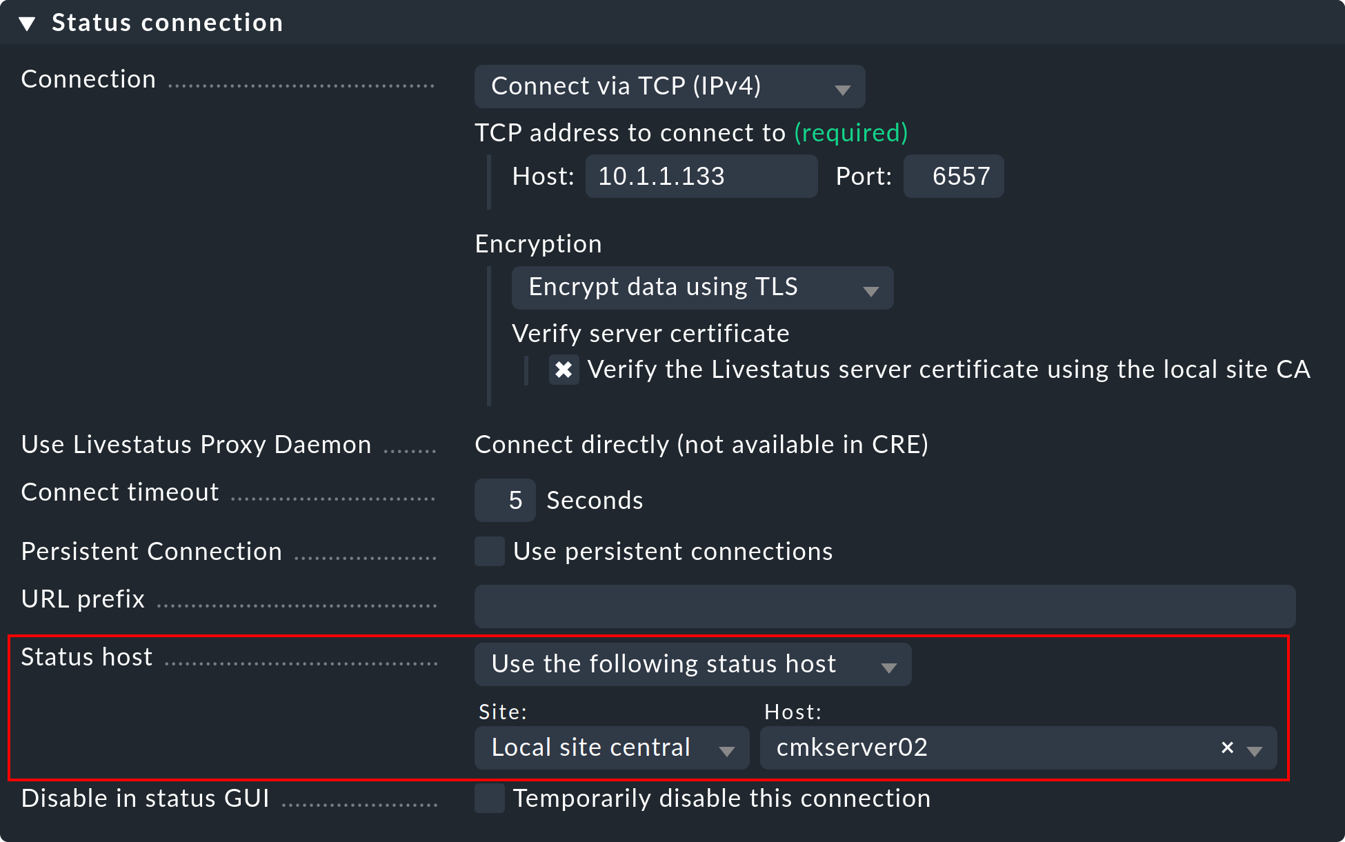

Here is how to set up a status host for a connection:
Add the host on which the remote site is running to the central site in monitoring.
Enter this as the status host in the connection to the remote:
A failed connection to a remote site can now only lead to a brief hangup of the GUI — namely until the monitoring has recognized it. By reducing the status host’s proof interval from the default of sixty seconds to, e.g. five seconds, you can minimize the duration of a hangup.

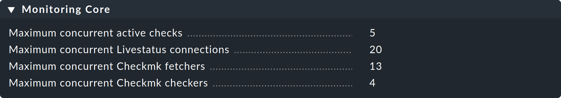

Because the Apache GUI is shared over multiple independent processes a connection is required for each Apache-Client process running simultaneously.
If you have many simultaneous users, ensure the configuration has a sufficient number of Livestatus connections in the remote’s Nagios core.
These are configured in the ~/etc/mk-livestatus/nagios.cfg file.
The default is twenty (num_client_threads=20).
By default, Apache is so configured in Checkmk that it permits up to 128 simultaneous user connections.
This is configured in the following section of the ~/etc/apache/apache.conf file:
This means that under high load up to 128 Apache processes can start which then also generate and sustain up to 128 Livestatus connections.
Not setting the num_client_threads high enough can result in errors or a very slow response time in the GUI.

Installing the Livestatus proxy is very simple. It is activated by default in the commercial editions — which can be seen when starting a site:
Select the setting Use Livestatus Proxy-Daemon for the connection to the remote sites instead of Connect via TCP:
The details for host and port are as always. No changes must be made on the remote site. In Number of channels to keep open enter the number of parallel TCP-connections the proxy should establish and sustain to the target site.
The TCP-connections pool is shared by all GUI inquiries. The number of connections limits the maximum number of queries that can be processed concurrently. This indirectly limits the number of users. In situations in which all channels are reserved this will not immediately lead to an error. The GUI waits a given time for a free channel. Most queries actually require only a few milliseconds.

4. Cascading Livestatus
As already mentioned in the introduction, it is possible to extend a distributed monitoring to include dedicated Checkmk viewer sites that display the monitoring data from remote sites that by themselves are not directly accessible. The only prerequisite for this is that the central site must of course be accessible. Technically, this is implemented via the Livestatus proxy. The central site receives data from the remote site via Livestatus and itself acts as a proxy — i.e. it can pass the data on to third sites. You can extend this chain as you wish, for instance, by connecting a second viewer site via the first.
This is practical, for example, in a scenario such as the following: The central site supports three independent networks — customer1, customer2 and customer3, and is itself operated in the network operator1. If the management of the operator from the operator1 network would like to see the monitoring status from the customer sites, this could of course be regulated via an access from the central site. For technical and legal reasons, however, the central site could be reserved exclusively for the personnel responsible for it. A direct access can thus be avoided by setting up a viewer site dedicated to viewing remote sites. The viewer site then shows the hosts and services on connected sites, but its own configuration remains completely empty.
The setup is done in the connection settings on the distributed monitoring, first on the central site, then on the viewer site (which does not actually have to exist yet).
On the central site, open the connection settings for the desired remote site via Setup > General > Distributed monitoring.
Under Use Livestatus Proxy Daemon activate the Allow access via TCP option and enter an available port (here 6560).
In this way, the Livestatus proxy on the central site connects to the remote site and opens a port for requests from the viewer site — which are then forwarded to the remote site.
Now create a viewer site and again open the connection settings via Setup > General > Distributed monitoring. In the Basic settings enter — as always for connections in distributed monitoring — the exact name of the central site as the Site ID.
In the Status connection panel, enter the central site as the host — as well as the manually assigned free port (here 6560).
As soon as the connection is established, you will see the desired hosts and services on the remote site in the monitoring views for the viewer site.
If you want to cascade further, you must also allow TCP access to the Livestatus proxy on the viewer site, as done before on the central site, this time with a different free port.

As with Livedump the hosts and services will now appear on the central site in the PEND state.
You will however see by the
icon that we are dealing with a shadow object.
In this way it can be distinguished from an object being monitored directly on the central site or on a ‘normal’ remote site:

Step 1: On the remote site, edit the site specific global setting Notifications > Notification Spooler Configuration and activate Accept incoming TCP connections. TCP-Port 6555 will be recommended for incoming connections. If there are no objections, adopt these settings.
Step 2: Now, likewise, in the Notification Spooling submenu only on the remote site, select the option Forward to remote site by notification spooler.

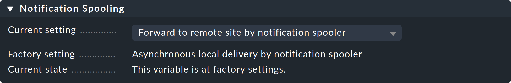

Step 3: Now, on the central site — i.e. in the normal global settings — configure the connection to the remote site (and then to additional remotes as needed):
Step 4: Set the global setting Notification Spooling to Asynchronous local delivery by notification spooler, so that the central site’s communications will also be processed over the same central spooler.

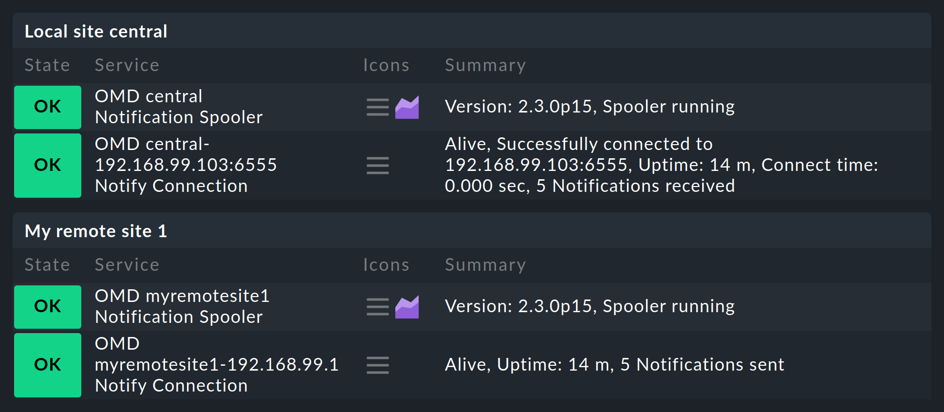

The notification spooler logs to the ~/var/log/mknotifyd.log file.
In the spooler configuration the log level can be raised so that more messages are received.
With a standard log level one should see something like this on the central site:
2025-04-30 07:11:40,023 [20] [cmk.mknotifyd] -----------------------------------------------------------------
2025-04-30 07:11:40,023 [20] [cmk.mknotifyd] Check_MK Notification Spooler version 2.5.0-2026.04.28 starting
2025-04-30 07:11:40,024 [20] [cmk.mknotifyd] Log verbosity: 0
2025-04-30 07:11:40,025 [20] [cmk.mknotifyd] Daemonized with PID 31081.
2025-04-30 07:11:40,029 [20] [cmk.mknotifyd] Connection to 10.1.8.44 port 6555 in progress
2025-04-30 07:11:40,029 [20] [cmk.mknotifyd] Successfully connected to 10.1.8.44:6555At all times the ~/var/log/mknotifyd.state file contains the current status of the spooler and all of its connections:
Connection: 10.1.8.44:6555
Type: outgoing
State: established
Status Message: Successfully connected to 10.1.8.44:6555
Since: 1637129500 (2025-04-30 07:11:40, 140 sec ago)
Connect Time: 0.002 secA version of the same file is also present on the remote site. There the connection will look something like this:
Connection: 10.22.4.12:56546
Type: incoming
State: established
Since: 1637129500 (2025-04-30 07:11:40, 330 sec ago)To test, select any monitored remote service and set it manually to CRIT with the Fake check results command.
Now on the central site an incoming notification should appear in the notifications log file (notify.log):
2025-04-30 07:59:36,231 ----------------------------------------------------------------------
2025-04-30 07:59:36,232 [20] [cmk.base.notify] Got spool file 307ad477 (myremotehost123;Check_MK) from remote host for local delivery.The same event will look like this on the remote site:
2025-04-30 07:59:28,161 [20] [cmk.base.notify] ----------------------------------------------------------------------
2025-04-30 07:59:28,161 [20] [cmk.base.notify] Got raw notification (myremotehost123;Check_MK) context with 71 variables
2025-04-30 07:59:28,162 [20] [cmk.base.notify] Creating spoolfile: /omd/sites/myremote1/var/check_mk/notify/spool/307ad477-b534-4cc0-99c9-db1c517b31fIn the global settings you can change both the normal log file for notifications (notify.log) and the log file of the notification spooler to a higher log level.
Monitoring the spooling
Once you have set up everything as described you will notice that on the central site, and respectively on the remotes, a new service will be found that must definitely be taken into the monitoring. This monitors the notification spooler and its TCP-connections. Every connection will thereby be monitored twice: once by the central, and once by the remote site:
