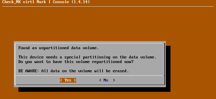

During the initial start-up, a first message appears requesting a selection of the desired language:
Language selection during initial installation.
This language is saved for the entire appliance. Afterwards, a message appears prompting you to initialize the data medium (for the racks in the RAID):
Dialog for initialization.
Confirm this dialog and wait for the process to complete. The status view will then be displayed on the local console:

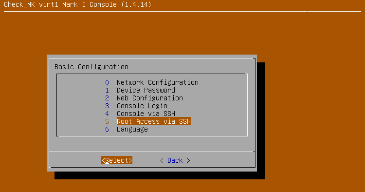

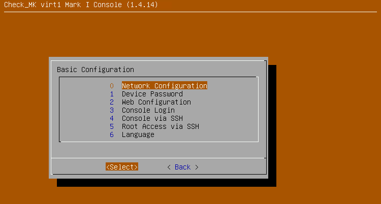

2.2. Network and access configuration via the console
From the status view, you can open the configuration menu by pressing the F1 key:
Selection of the Network Configuration.
To put the appliance into operation, you must now set the network configuration and define this unit’s password.
Network configuration
First set up the network via the Network Configuration item. To do this, the IP address, netmask and the optional standard gateway are requested one after the other.
In most cases, the appliance should also be able to access network devices outside of its own network segment. For this, the standard gateway must also be configured.
After entering these values, the configuration will be activated. The appliance will then be immediately accessible via the network under the specified IP address. You can test this connection, for example, with a ping from another device in the network.

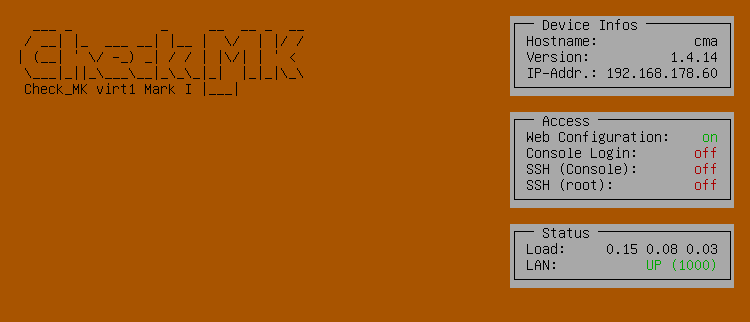

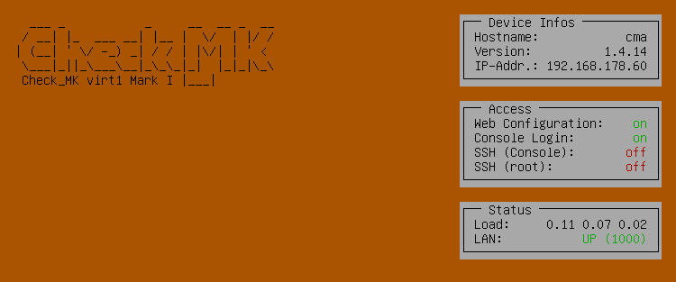

When you have completed these steps, you will see the changed status view of the console:
View of changes to the status view.
In the Device Infos box is the configured IP address and in the Access box is Web Configuration: on. If you have already connected the appliance correctly to your network, in the Status box you should also see that the network connection is active: LAN: UP.

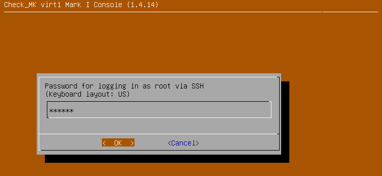

Securing access to the console
When you first started the appliance, you may have noticed that there was no password prompt. Anyone with physical access to the rack or the virtualization solution’s management interface could change its basic settings via the console.
You should therefore activate password protection in the configuration menu via the Console Login menu item. If protection is activated, the device password will be requested before the status view is displayed and any settings can be changed.
Afterwards, in the status view you will see the Console Login: on entry in the Access box.
Changed status view.

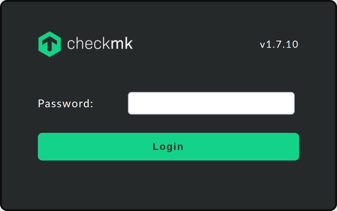

After you have enabled access to the web interface through the previous configuration, you can now call it up via any computer in the network. To do this, enter the appliance URL in the browser’s address line, in this case http://192.168.178.60/. You will then see the login dialog for the web interface:
The Checkmk login window.

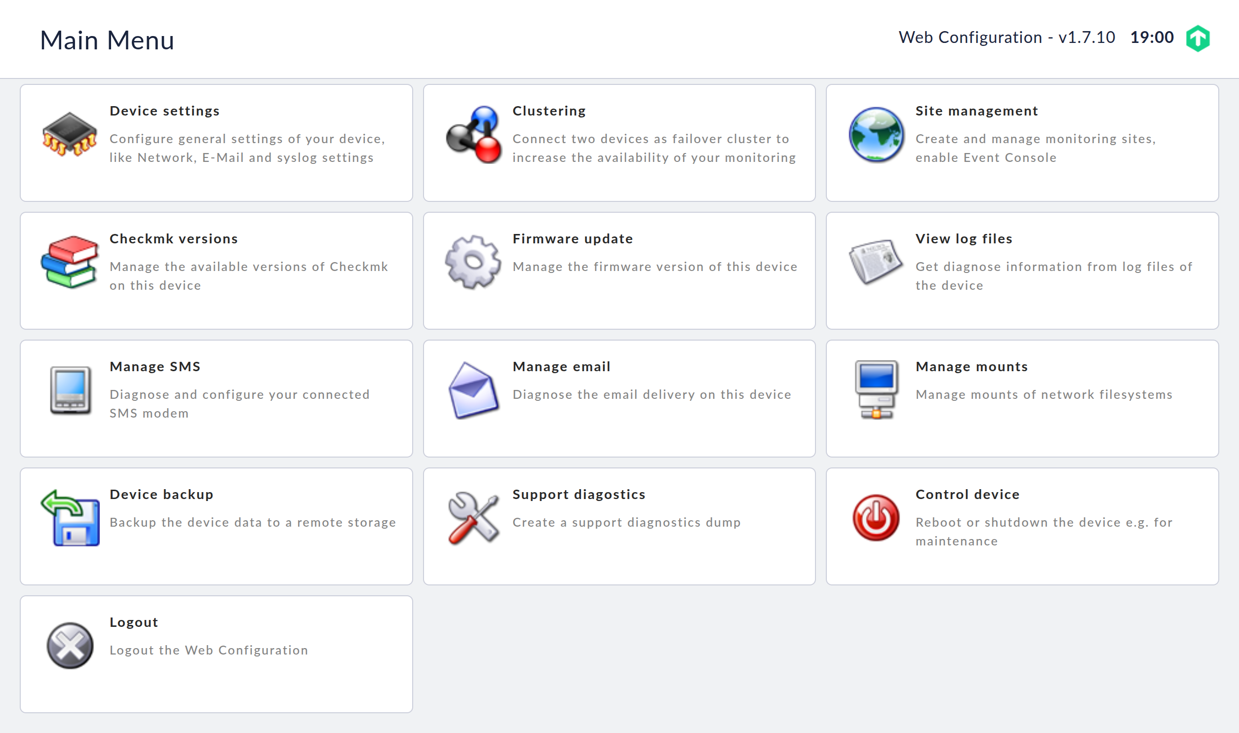

When you have logged in with the previously set device password, the main menu opens from which you can access all of the functions of the web interface.
Main menu on the web interface.
Select Device Settings, to view the most important settings for the appliance and to change these if required:
Selecting the Device Settings.
Clicking on the parameter name will take you to the respective page for editing this setting.

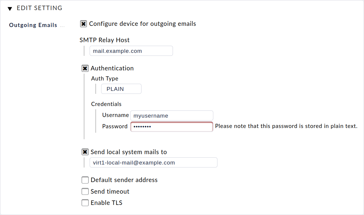

3.7. Configuring outgoing emails
In order to be able to send emails from the unit, e.g. in case of events during monitoring, the forwarding of the mails to one of your mail servers must be configured via Outgoing Emails.
To do this, as the minimum, the host address of your mail server must be defined as SMTP Relay Host. This server accepts the emails from your machine and forwards them.
However, configuring the SMTP relay server is only sufficient when your mail server accepts emails via anonymous SMTP. If your mail server requires authentication, then you must activate the appropriate login method under Authentication and enter the appropriate access data.
If you do not receive any emails even after this has been configured, it is worth taking a look at the appliance’s system log. All attempts to send mails are logged here.
The appliance itself can send system mails in the event of a critical problem occurring, e.g. if a job cannot be executed or a hardware problem has been detected. To receive these emails, you must configure an email address via Send local system mails to to which these mails are to be sent.
Finally, you can activate transport encryption via TLS and manually specify a default sender address.

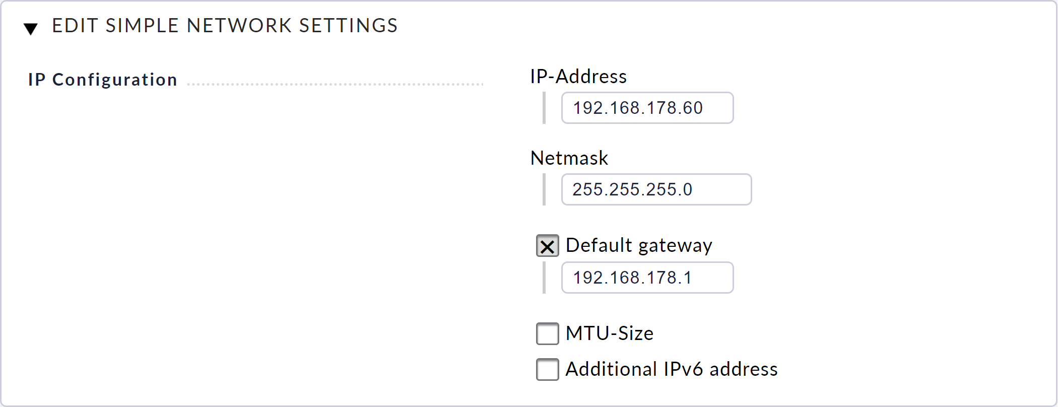

3.9. Altering the network configuration
The basic network configuration for the standard network interface was done via the console during the startup. You can change these settings later via Device Settings > Network Settings. You can also add an IPv6 address at this point.
Altering the Simple Network Settings.
These settings are in the Simple Mode, as you can see from the title of the dialog: Edit Simple Network Settings. The Advanced Mode button activates the Advanced Mode, which gives you access to all of the available network interfaces and bonding functions.
The advanced configuration can help you to increase the availability of monitoring via redundancies. It is also the starting point for configuring a cluster and is therefore described in detail in the cluster article.

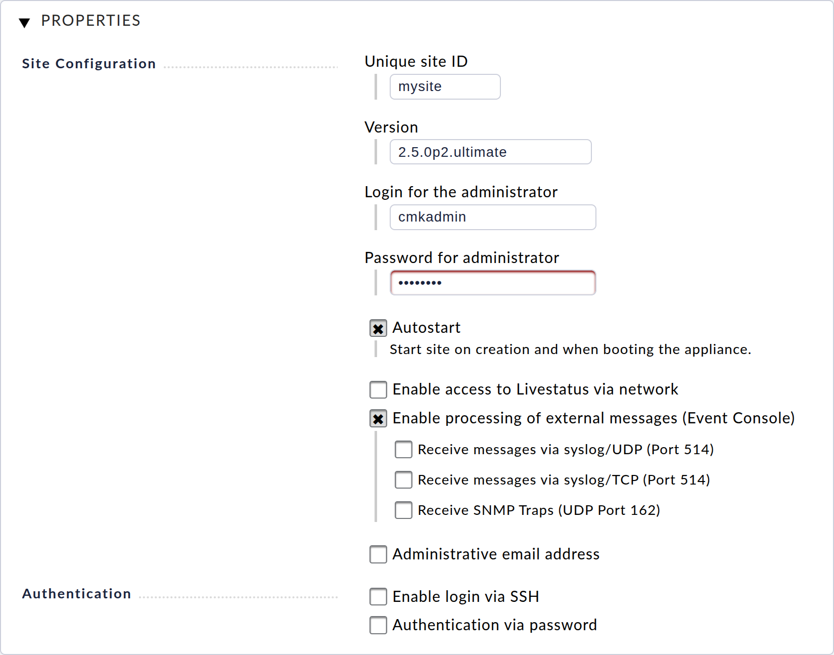

This page will be empty when you access it for the first time. To create your first site, click the Create New Site button. On the page that follows you can define an initial configuration for the site:
Site Configuration Properties.
First enter an ID (Unique site ID) here, which is used to uniquely identify the site. The ID may only contain letters, numbers, hyphens (-) and underscores (_), must begin with a letter or underscore and may be a maximum of 16 characters long.
Next select the Checkmk version with which the site is to be created. You will be offered all installed versions as listed in the Checkmk versions management.
Finally, you define the username and password for the Checkmk administrator. You can leave all other settings unchanged for the time being and adjust these later if required.
Click Create Site to create the site. This may take a few seconds. Once the site has been created and started, a list of all sites will appear on the page:

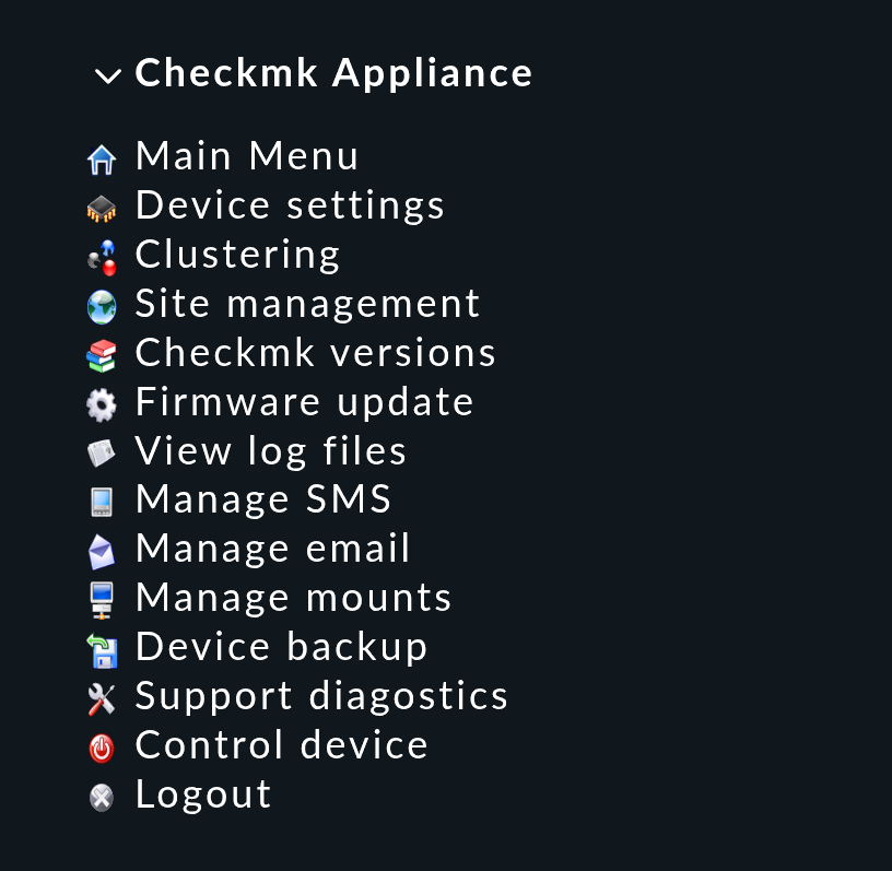

In all appliance sites, the Checkmk Appliance snap-in is available to all administrators in the sidebar:
The Checkmk Appliance snap-in.
With the entries in this snap-in, you can always switch from a site to the appliance’s web interface.

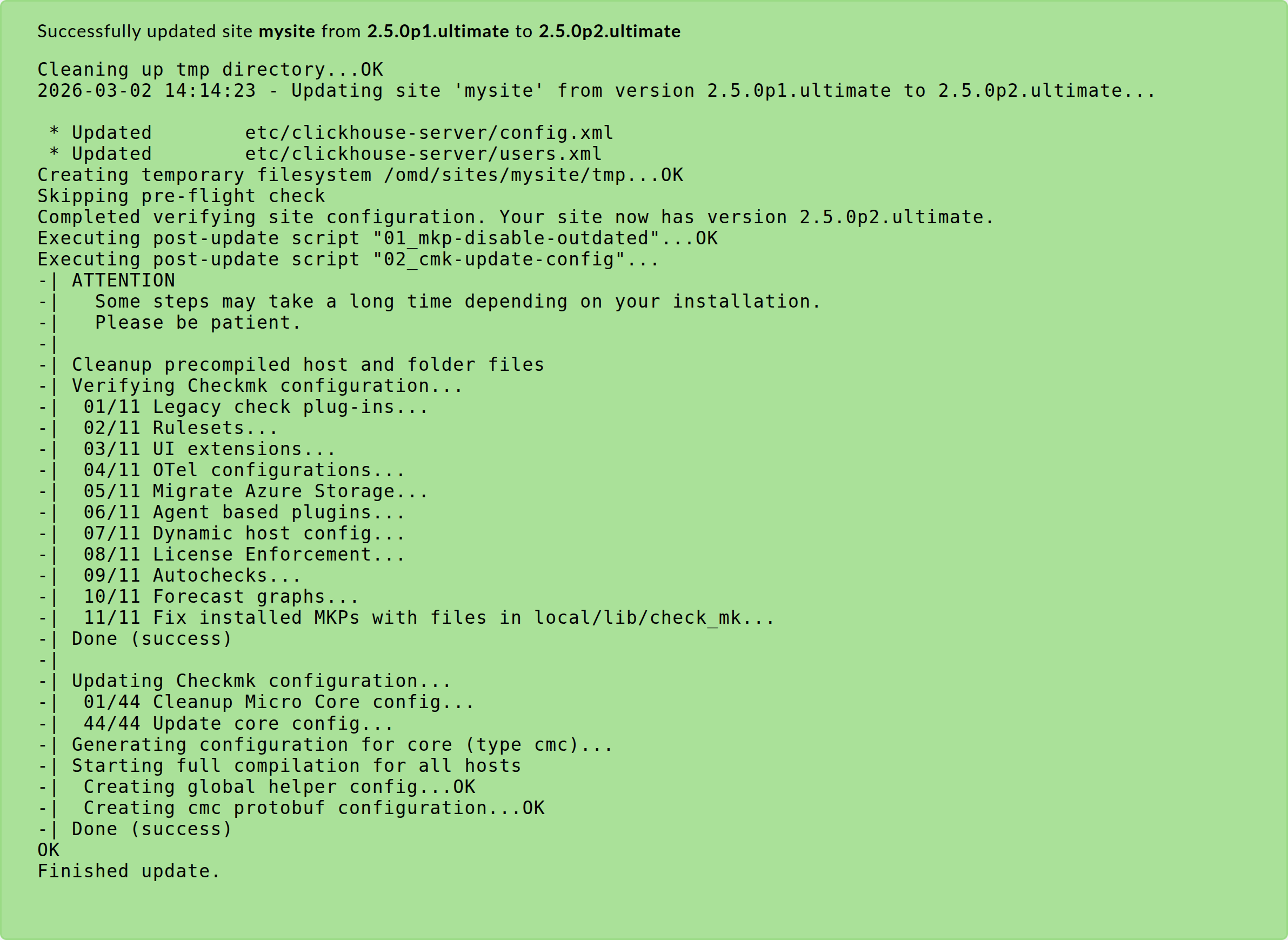

5.2. Updating a site
When a site is updated, it will also automatically be updated to a new Checkmk software version. First install the desired new version as described in the chapter on managing Checkmk versions.
Caution: When updating to new Checkmk major versions, you should refer to the related article. It is important here that you only ever update to the next major version and do not skip over any intermediate versions.

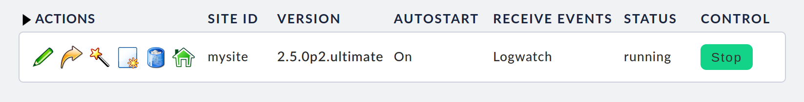

Then have the appliance’s web interface list the sites (Main Menu > Site Management):
Display the running status for an appliance.
Make sure that the site is not running, i.e. if its Status is shown as running, stop the site (Control > Stop). Then click on the update icon icon cma site update under Actions.
The following page lists the possible target versions for the update:
View of target versions for a Checkmk update.
Select the target version listed at Target Check_MK version, and click on Update now. After a short time, the update messages will be displayed:
Message history during a Checkmk update.
The Back button returns you to the list of sites, with the updated version information. You can now restart the site.
Note: Updating an site in the appliance follows the same principle as updating on a regular Linux server. In the event of problems, error messages or conflicts, you can obtain detailed information on the update process in the Updates and Upgrades article.

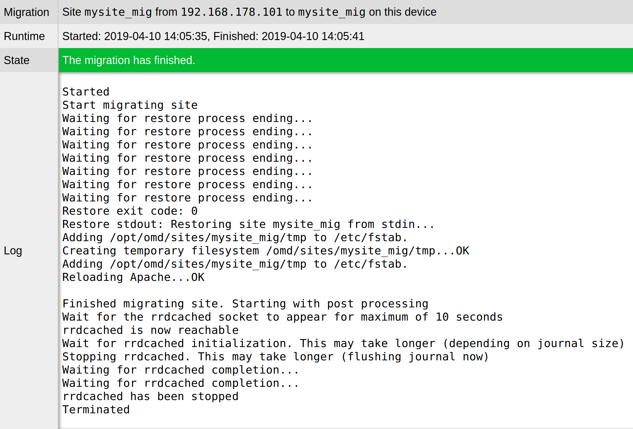

5.3. Migrating a site
It is often the case that a site already running on another Linux system is to be migrated to a Checkmk appliance. The Checkmk appliance includes a function with which you can carry out this migration.
The following requirements must be met:
  • You need a network connection between the source system and your appliance as the target system.
  • The Checkmk version of the source site must be installed on your appliance (an architecture change from 32-bit to 64-bit is possible).
  • The source site must be stopped during the migration process.
In the web interface, under Site Management, you will find the Migrate Site button, which will take you to this page:
Specifying the migration parameters.
On this page, you must first enter the host address (host name, DNS name or IP address) for the source system under Source Host. You also enter the ID of the site to be migrated under Source site ID.
The migration of the site is done via SSH. To do this, you need the access data for a user who can log on to the source system and is authorized to access all of the site’s files. For this you can use the source system’s root user — or the site user, if a password has been defined for that site user.
Optionally, you can now still choose whether you want to use a new site ID for the target site on your device or leave the original ID unchanged.
Furthermore, you can specify that you do not want to transfer the performance data (metrics and graphs) and the historical data from the monitoring events during the migration. This can be useful if you do not need a 1:1 image of the site, but only want to duplicate it, e.g. for testing purposes.

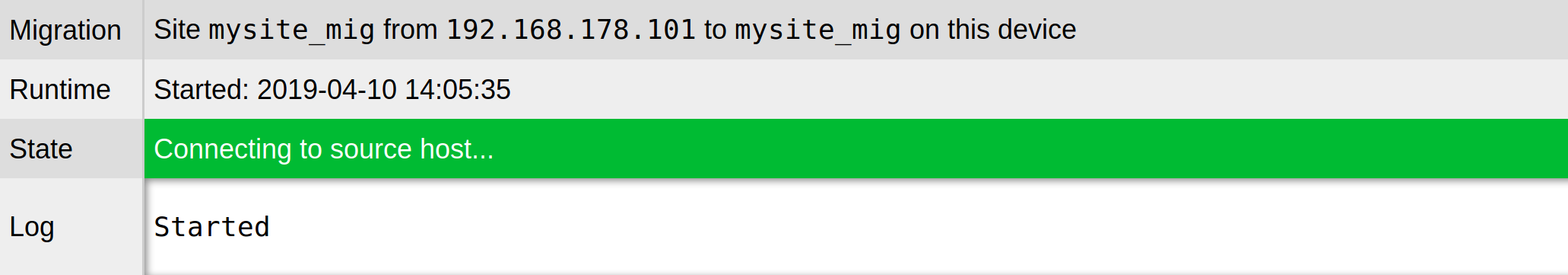

After you have filled in the parameters and confirmed with Start, the progress of the migration will be displayed:
View of the migration progress.
Once the migration has finished, you can exit the migration administration via the Complete button. You will end up back in the site management and will be able to start and manage this newly migrated site:
Migration log data up until the completion of the migration.

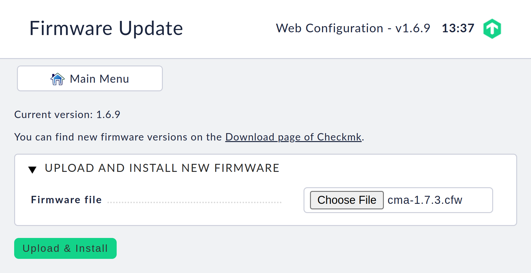

6. Managing firmware
You can update your appliance’s software, i.e. the appliance’s firmware, to a newer version during normal operation.
You can download the appliance firmware as a CFW file from the download page.
After you have downloaded the CFW file, select Firmware Update in the main menu, and on the following page with the file selection dialog select the CFW file from your hard disk:
Selection of the desired CFW file.
Confirm with a click on Upload & Install. Now the firmware will be uploaded to your unit, which may take a few minutes depending on your network connection.
Once the file has been recognized as valid firmware, the Confirm Firmware Update dialog will be displayed for you to confirm the firmware update. During this process, depending on any differences between the current version and the version to be installed, various messages will appear to inform you of how your data will be handled during the update:
  • Change in the first digit of the version number (major release): You must manually back up your appliance’s data and import it again following the update. An update without manual data migration is not possible.
  • Update to a higher number in the second digit (minor release): The update can be carried out without manual data migration. A prior backup is nevertheless recommended.
  • Change of the third digit in the version number (patch): The update can be carried out without manual data migration. A prior backup is nevertheless recommended.
You can cancel the dialog at this point with No, and first make any necessary data backups.
Important: If you confirm the Confirm Firmware Update dialog with Yes!, the appliance will be restarted immediately!
The selected firmware will be installed during this restart. The restart will take considerably longer than usual, but usually less than 10 minutes. Afterwards, another restart will be automatically carried out, which completes the firmware update. The status view in the console will display the newly installed firmware version.
Note on updating the major or minor version: For example, if you update the firmware from 1.6.x to 1.7.y, you must also update all Checkmk versions used by any site or install them in the same version (but for the new platform). The reason: Major and minor versions usually update the operating system version used as foundation or change underlying concepts.
Under Checkmk versions you can check whether there are any incompatible firmware versions. Sites using incompatible versions can no longer be started.

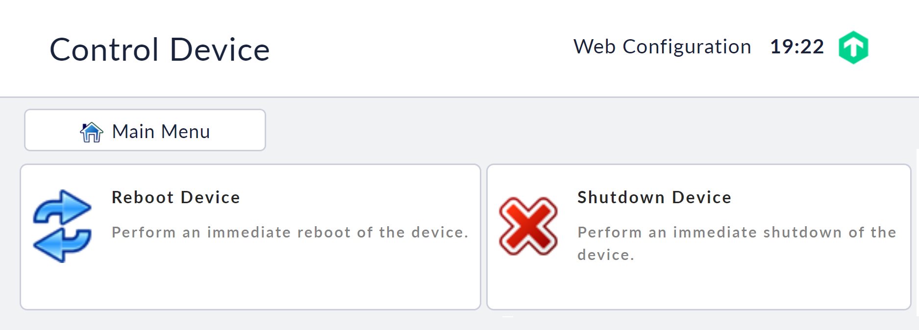

You can restart or shut down the appliance via the web interface or via the console.
In the web interface, you will find the menu items Reboot Device and Shutdown Device under the Control Device item in the main menu. The appliance will perform the action immediately when the command is selected.
cma webconf control 2
In the console, you can access the menu for controlling the unit by pressing F2.
cma console actions 2

9.2. Activating site logins via SSH
You can enable access to the command line for the individual monitoring sites. This allows you to view and control the entire environment at the site.
This access is controlled via the site management. In the settings dialog for each individual site, you can activate and deactivate access and also specify a password to protect the access.
cma webconf site edit pw 2

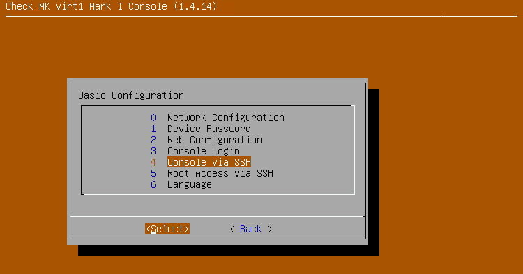

9.3. Activating the console via SSH
It is possible to activate access to the text-based configuration environment on the device (console) via the network. This allows you to view and customize the basic configuration of the unit even without direct access to the unit.
You can enable access via the configuration menu in the console. To do this, select the Console via SSH menu item.
cma console config ssh console 2
When you activate the option, you will be prompted to enter a password. You must enter this password when you connect via SSH with the setup username. Access will be automatically enabled immediately after confirming this dialog.
You can now connect to the unit as setup user with the help of an SSH client (e.g. PuTTY).
You can see whether access is currently enabled in the console’s status view in the Access box.

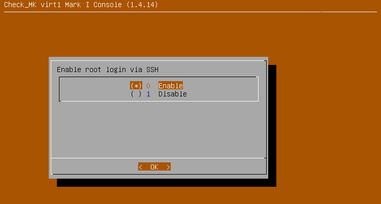

9.4. Enabling root access via SSH
It is possible to enable access to the unit as the system user root. However, after initializing the device, this access is disabled. Once activated, you can log in to the appliance as root user via SSH. As root, however, you do not land in the appliance menu, but instead simply on the command line.
Warning: Commands that you execute as root on the device can permanently change or damage not only your data but also the factory-supplied system. We will not be held liable for any changes made by you in this way. Only activate and use the root user if you are absolutely certain about what you are doing and only for diagnostic purposes.
You can enable access via the console’s configuration menu. To do this, select the menu item Root Access via SSH.
cma console config ssh root 1 2
Then set the option to enable.
cma console config ssh root 2 2
As soon as you activate the option, you will be asked to enter a password. You must enter this password when you connect as root user via SSH. Access will be automatically enabled immediately after confirming this dialog.
cma console config ssh root 3 2
You can now connect to the unit as the root user with the help of an SSH client.

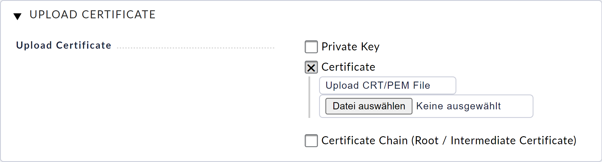

You can now transfer the signed certificate to the appliance via the Upload Certificate dialog. If you have received a certificate chain, you can also upload it via the dialog.
cma webconf ssl upload 2
After confirming the dialog with Upload, you can continue with the configuration of the access paths.

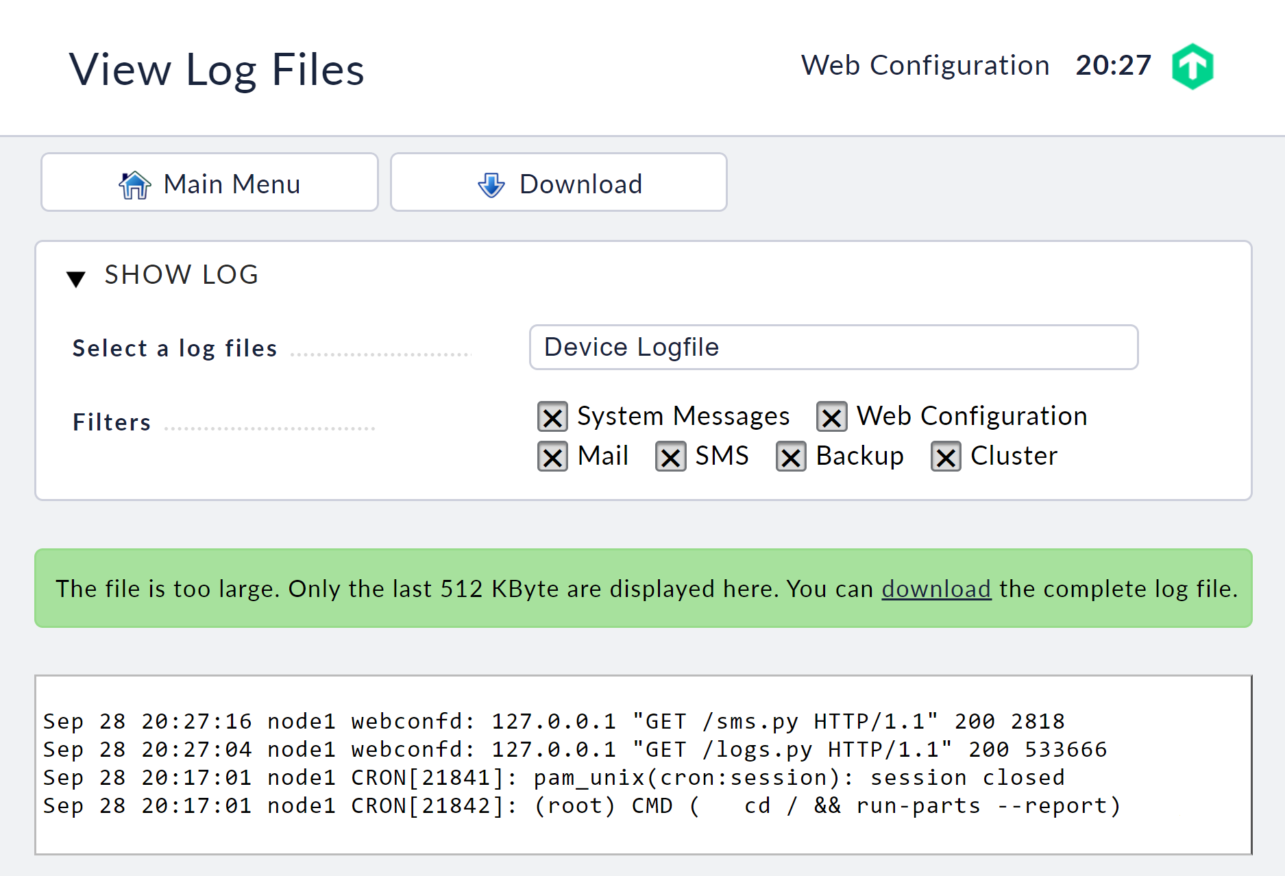

11.1. Logs
Despite careful testing, it cannot be ruled out that unforeseen errors occur which are difficult to diagnose without looking at the operating system.
One possibility is to have the log entries generated on the system sent to a syslog server via syslog. However, the log entries from the individual monitoring sites are not processed via syslog, so these are not forwarded and can only be viewed at the device itself.
To simplify error diagnosis on the appliance, there is a view for displaying various log files on the appliance. You can access this via the menu item View Log Files in the main menu of the web interface.
cma webconf logs 2
Here you can select the logs from the device and view their current content.
Note: The system log is reinitialized every time the unit is started, so if you want to receive the log entries, you must send them to a syslog server.
At the local console there is also the possibility of viewing the system log. The most recent entries for the system log are displayed on the second terminal.
You can reach this terminal with the key combination Ctrl+Alt+F2. The third terminal displays all kernel messages. Here you will find the respective messages in the event of hardware problems. This terminal can be reached with the key combination Ctrl+Alt+F3. You can switch back to the status view with the key combination Ctrl+Alt+F1.
