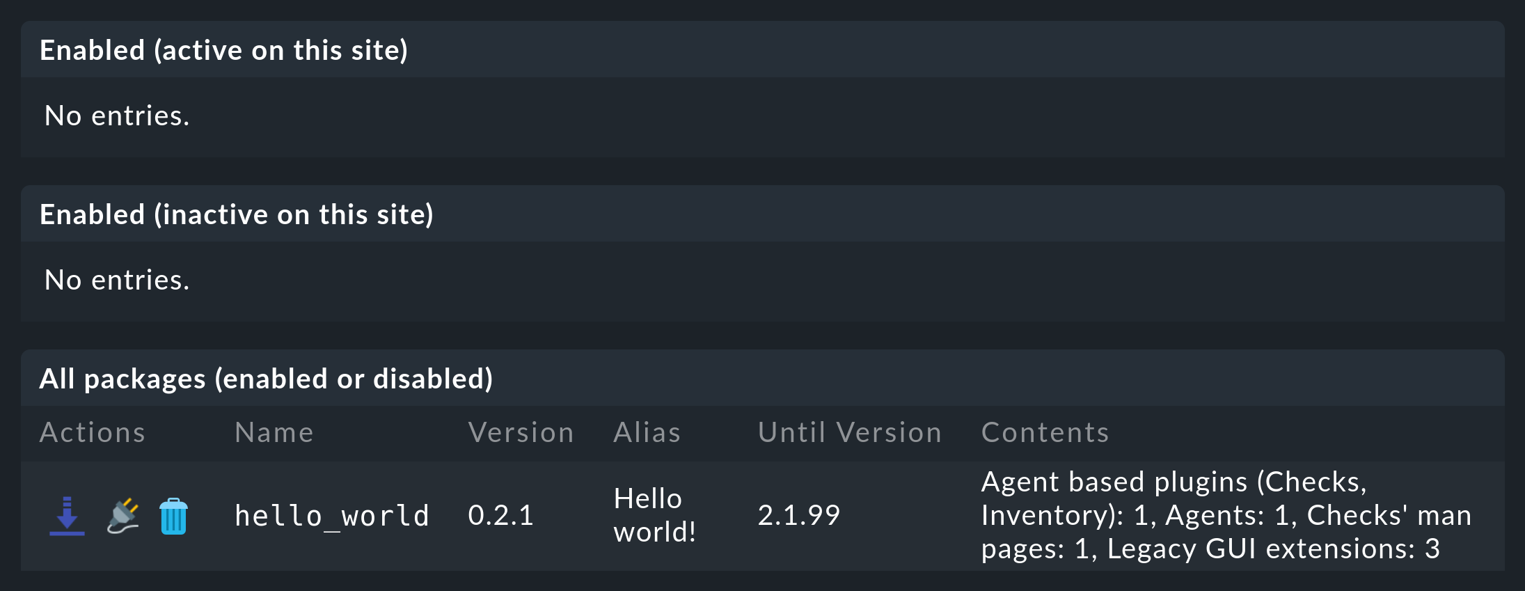

2.3. Deactivating and removing packages
The complete deletion of a package is also done in two stages. With the icon disabled button you first deactivate a package in the list of active packages. In this step the installed files are removed, but the MKP is still kept — this step only reverses the activation.
Using the icon delete icon in the list of all packages, you can again delete installed and unused packages. When deleting, the package is deleted and with it the extension is completely removed — i.e. the opposite of adding a package.

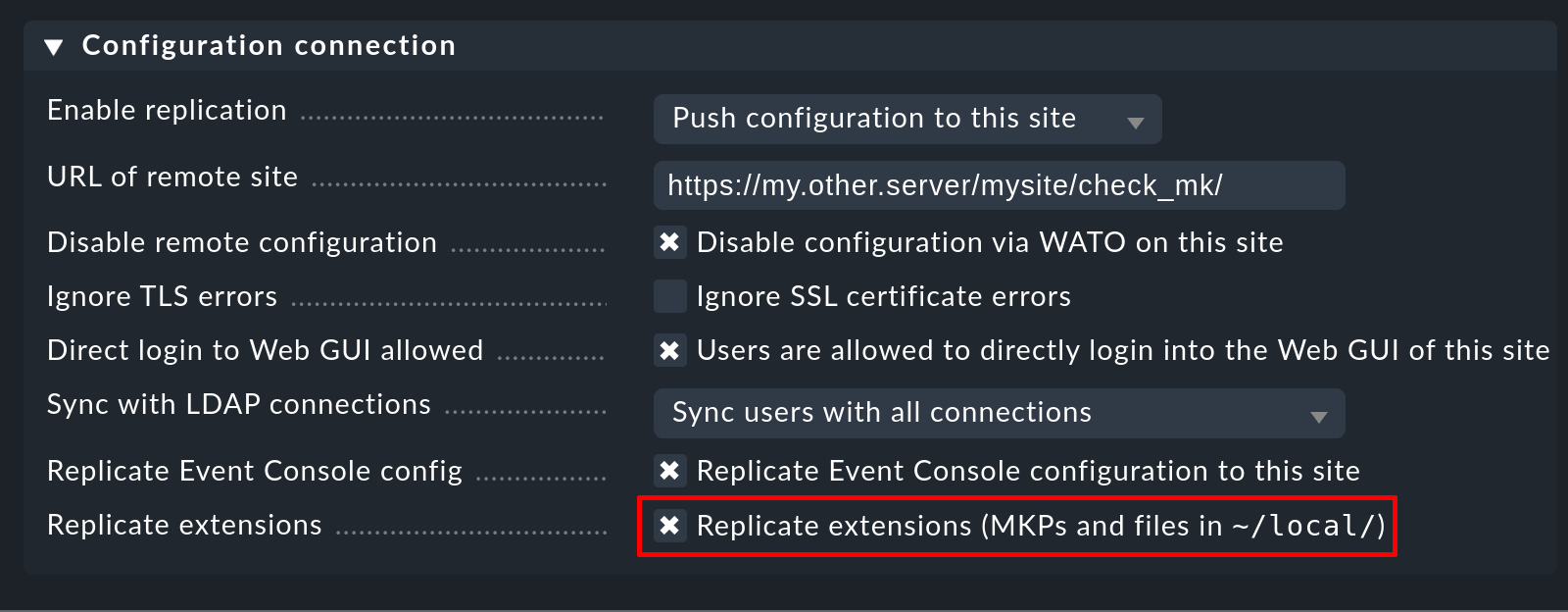

2.4. MKPs in distributed environments
In the case of a distributed monitoring with central setup, it is sufficient to make the packages available on the central site. For each remote site associated with the central site, you can then separately determine whether the customizations should be propagated to that remote site. All you have to do is activate the Replicate extensions option. After that, the MKPs and all other changes within the ~/local directory will also be transferred during a synchronization.
mkp distr wato
If a particular transfer is not desired, simply turn off the option for this or all sites.
Important: The customizations for the central setup will only be transferred if the Enable replication option is set to Push configuration to this site.

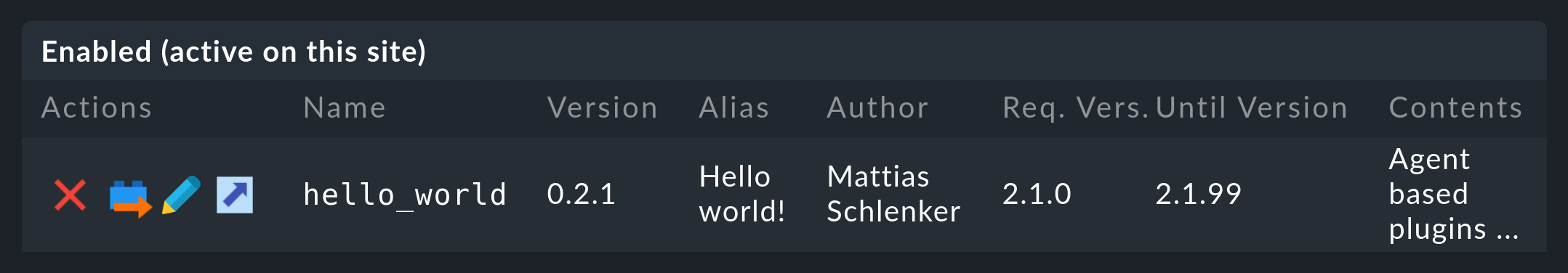

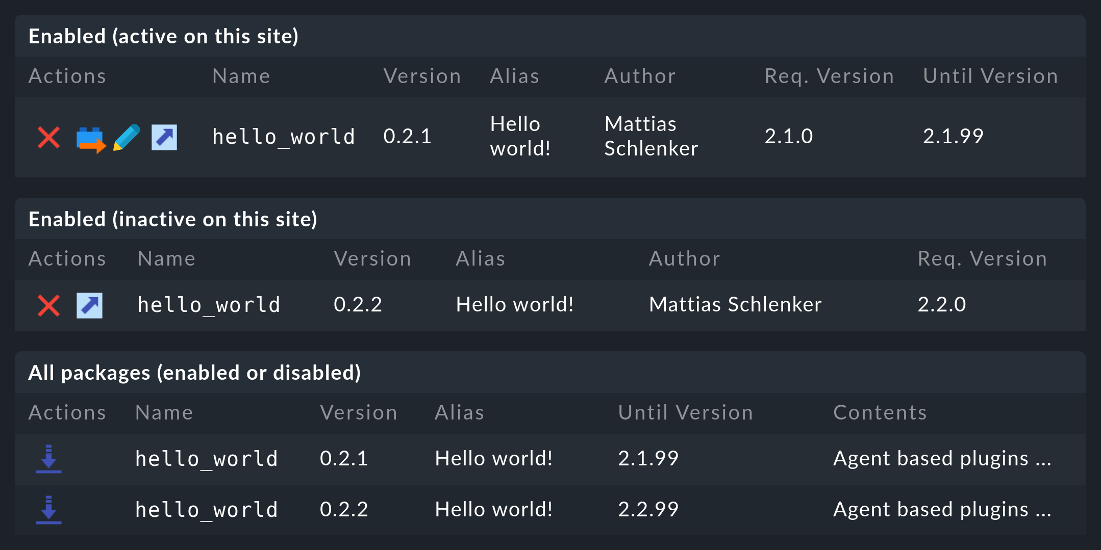

2.5. A special case: enabled but inactive packages
A special situation is the attempted activation of a package that does not match the Checkmk version used. Such a package that is enabled, but whose activation fails because of an incompatible Checkmk version, will end up in the Enabled (inactive on this site) list.
mkp manager all states
But why install packages that do not match the Checkmk version you are using? There are two good possible reasons:
  1. An update of the Checkmk version: You have the possibility of storing packages for both the old and the new versions — when you next perform an update, the newer package will be activated automatically.
  2. Distributed monitoring: To facilitate updates, the Checkmk major version of remote sites may be one higher than that of the central site. However, this previously made it difficult to distribute MKPs because these had to be compatible with both major versions. With the ability to unlock mismatched packages, you can keep packages on the central site that match both the source and target versions. The newer version will then be automatically activated during an update.
From the version numbers shown in the above screenshot, you can see that it is a Checkmk 2.1.0 central site that provides packages for remote sites that have already been upgraded to 2.2.0.

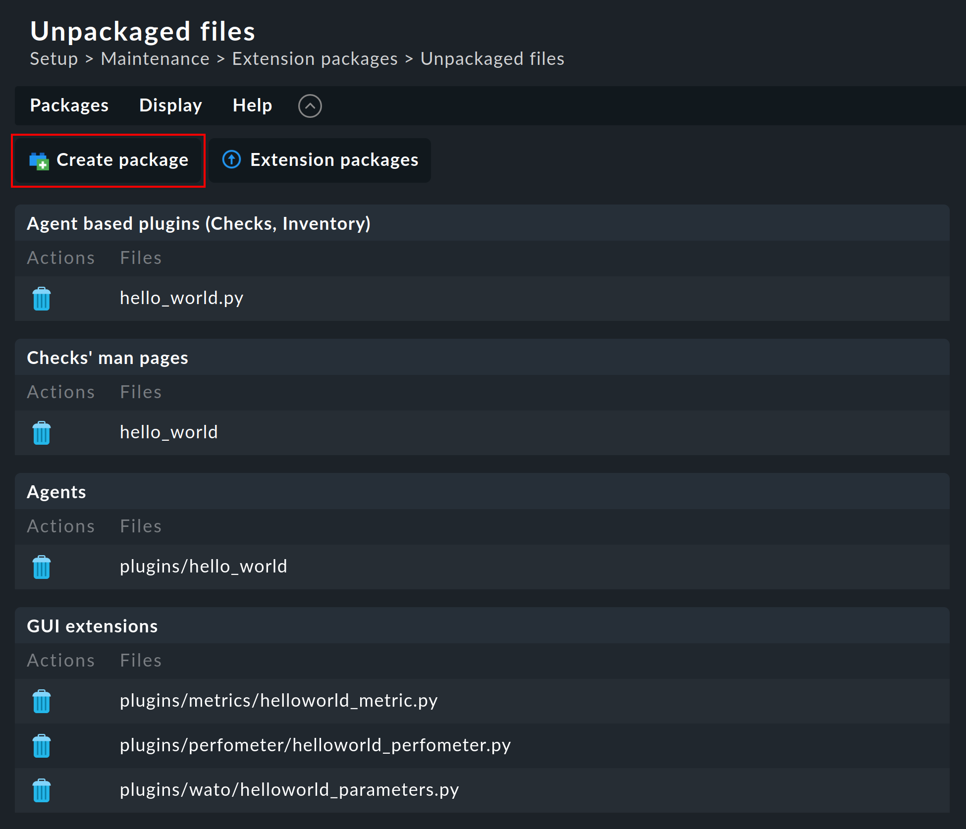

4.3. Finding unpackaged files
The Setup menu
Once the programming or customization work has been completed, it will be necessary to find the existing and added files again. Since these files do not currently belong to any package, they are listed in the Setup under Unpackaged files:
mkps unpackaged
List of Unpackaged files and the Create package button

Delete files that are not needed, or note which files should not be included in the new package. In the next step, the unpackaged files will then be (again) combined into a package.
4.4. Creating packages
The Setup menu
The icon new mkp Create package button in the unpackaged files overview takes you to the dialog for creating a new package:
mkps create
In addition to the obvious details, it is important that you select at least one file to be packaged. Creating a package also creates a package description under ~/var/check_mk/packages/, which contains general information as well as the list of the included files. The maximum supported Checkmk version is of course difficult to predict without a crystal ball.
