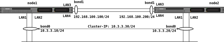

The following describes a reference configuration of a cluster with two bonding interfaces, which corresponds to the following diagram:
cluster
The interface designations LAN1, LAN2 etc. used in the diagram represent the physical interfaces on the device. The actual designations depend on the respective hardware.
The IP addresses used are of course arbitrary. However, make sure that the internal cluster network (bond1 in the diagram) uses a different IP network than the 'external' network (bond0 in the diagram).

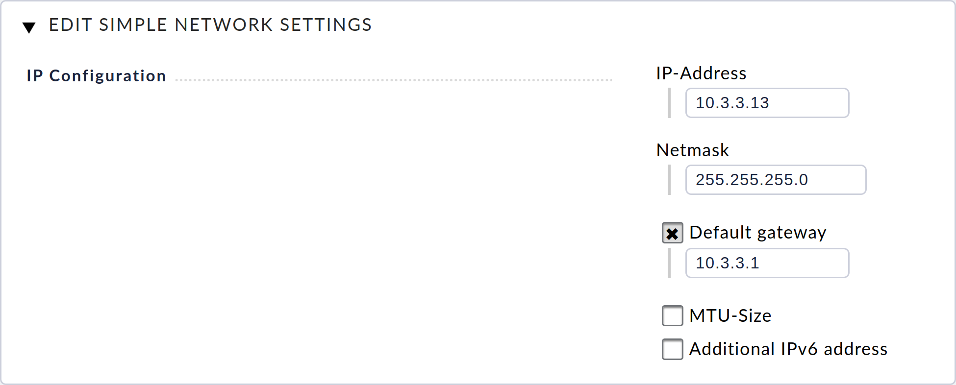

Open the first node’s web interface, select the device settings and at the top, the Network Settings. Inside of the Network Settings two modes are available.
The Simple Mode, with which you can only configure your device’s standard interface, is activated by default. (This mode corresponds to the configuration via the text console that you performed during the initial setting up of the appliance).
appliance cluster edit simple network

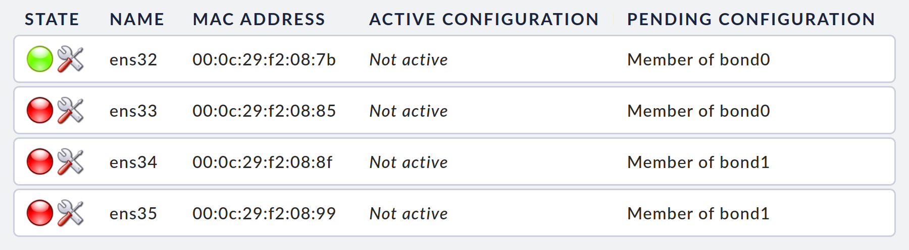

On the following page you will see all of the network interfaces available in the unit. Only the standard interface currently has a configuration — here ens32 in the below screenshot. This was taken over from the Simple mode.
appliance cluster advanced mode

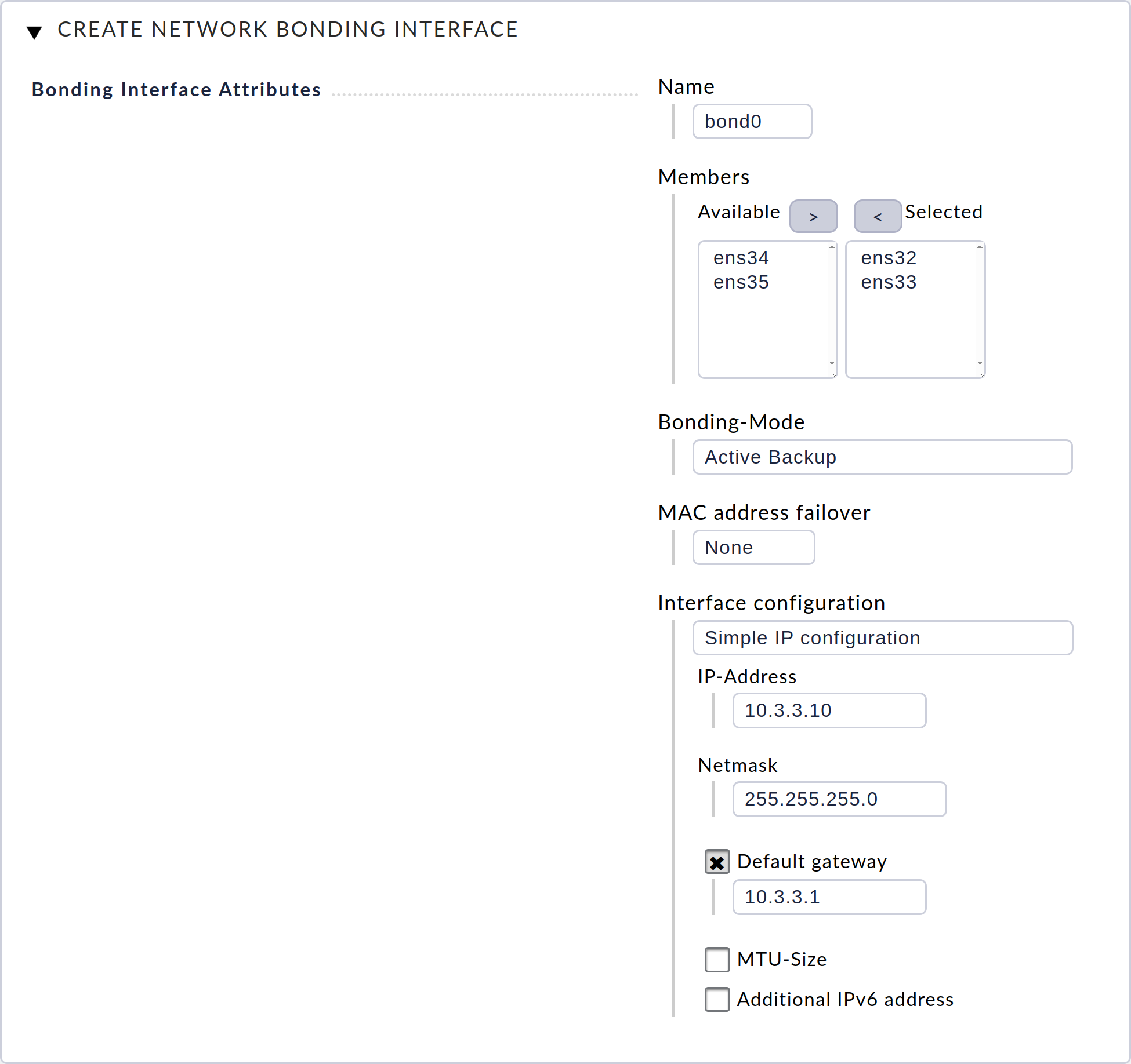

Now create the first bonding interface bond0 by clicking on Create Bonding. In the following dialog, enter all data as shown in the following screenshot and confirm the dialog with Save.
appliance cluster create bond0
Next create the second bonding interface bond1 with the appropriate configuration for the direct sync connection.
appliance cluster create bond1
After you have created the two bonding interfaces, you will once again see all of the settings made in the network configuration dialog for the network interfaces …
appliance cluster create bonds pending interfaces

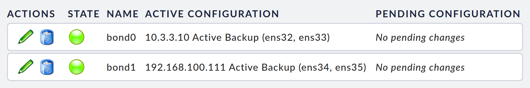

When you have successfully completed all of the configuration steps, click on Activate Changes to make the settings effective. The new network settings will then be loaded. After a few seconds the network configuration will show the status 'OK' everywhere, for the real network interfaces …​
appliance cluster create bonds no pending interfaces
… and again at the bondings:
appliance cluster create bonds no pending bonds

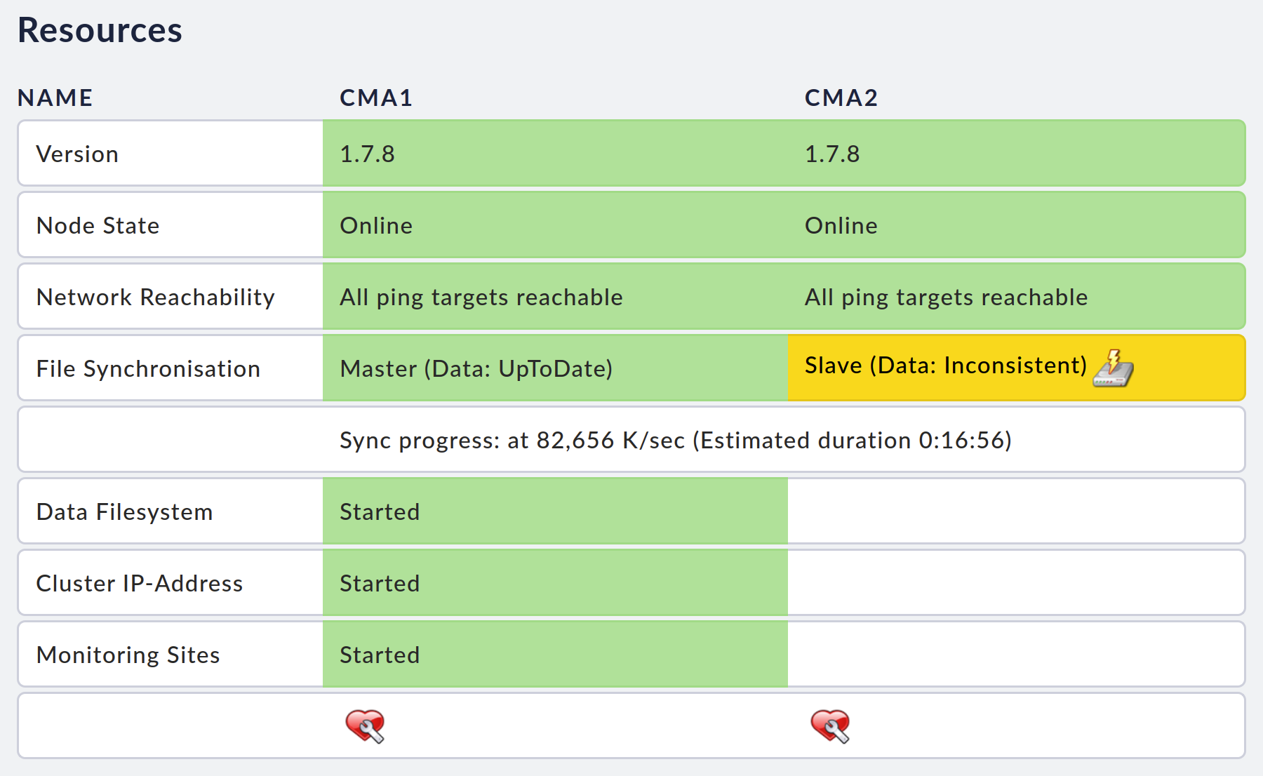

Once this connection has been successfully established, synchronization of the cluster’s devices will begin. You can view the current status of this process on the cluster page. During the synchronization, all resources, including any existing monitoring sites, will be started on the first node.
appliance cluster cluster resources

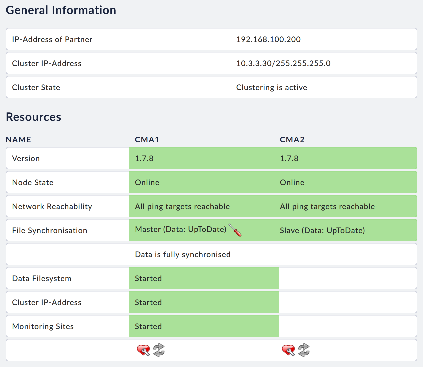

After the first synchronization has been completed, your cluster will be fully operational. You can view its status at any time on the cluster page.
appliance cluster cluster status
