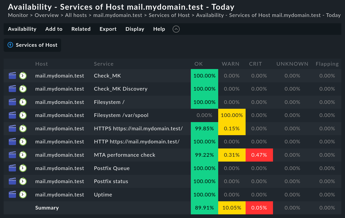

Generating an availability analysis is very simple. First retrieve any view of hosts, services or BI aggregations. There you will find in the menu Services menu or Hosts the Availability item, which takes you directly to the calculation of the availability of the selected objects. The data will be displayed as a table:
View of the availabilities of all services.
The table shows the same objects that were seen in the preceding view. Shown in each column is the proportion of the requested time range an object was in the state being queried. The value is given as a percentage, by default to two decimal places — which you can also easily customize.

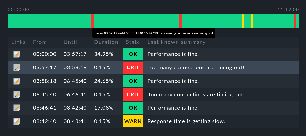

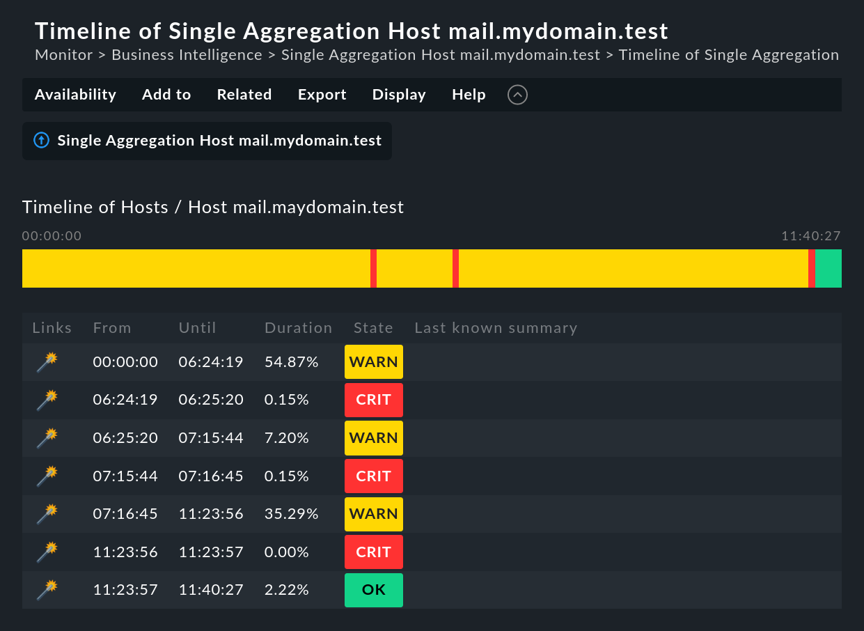

2.2. Timeline display
The button timeline symbol can be found in every line of the table. This button takes you to a timeline display for the relevant object, in which it is precisely itemized which state change(s) occurred in the specified time range (abbreviated here):
View with timeline of state changes.

  • Hover the mouse cursor over a timeline symbol in a object’s line in the display, this will be highlighted in the table display.

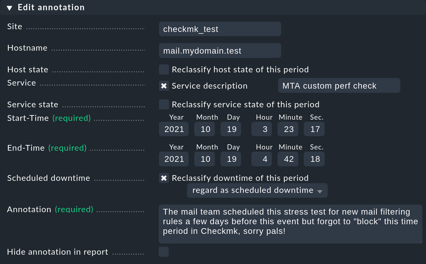

As just mentioned, with the button annotation symbol the timelines offer the possibility of adding an annotation to a time period. A pre-filled form (‘Properties’) is provided into which comments can be entered:
Properties of an annotation.
With this you can define and extend the time range with different values as required. This is, for example, practical if you wish to annotate a larger time slice that has experienced repeated state changes. If you omit entering a service, the annotation will be created for the host. This will then be automatically related to all of the host’s services.
In every availability view all annotations applicable to the time range and the objects being displayed will be automatically visible.
But annotations have an additional function. Downtimes can be retrospectively entered — or conversely, removed. The availability analysis takes these corrections into account in exactly the same way as with ‘normal’ downtimes. There are at least two legitimate justifications for this:
  • During operations it can happen that planned downtimes are incorrectly entered. This of course is bad for the accuracy of the availability statistics. Through retrospective entering of these times the reporting can thus be rectified.
  • There are users who misuse downtimes during a spontaneous outage in order to suppress a notification. This effectively corrupts the later analysis. This can be corrected retrospectively by deleting the erroneous downtime.
To reclassify downtimes, simply select the Reclassify downtime of this period checkbox:
The 'Reclassify downtime of this period' option in the annotation properties.

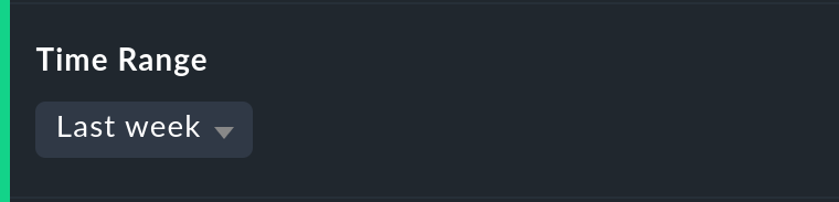

The first and most important option in any availability calculation is of course the time range to be examined. In Date range a time range with precise start and end dates can be specified. The final day — up until 24:00 — will be included.
Option for a relative time range.
Much more practical are the relative time specifications, such as, for example, Last week. Exactly which time range will be displayed — intentionally — depends on the point of time at which the calculation is made. Note — here "one week" always refers to a range from Monday 00:00 until Sunday 24:00.

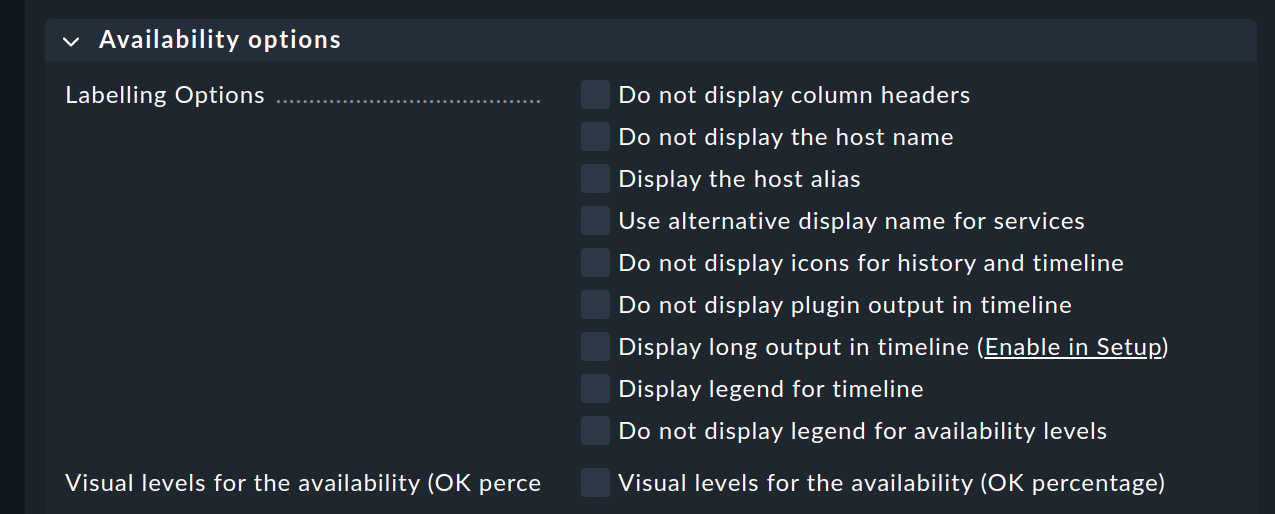

Labelling options
Labelling options.
The Labelling options allow various label fields to be activated or deactivated. Some of the options are primarily interesting for Reporting. If, for instance, a report is to be produced for a single host, then the column for the host name is not really required.
The alternative display names for services can be defined using a rule, and by using these, for example, displays for important services can be given a name that is explicit and meaningful for the report’s reader.

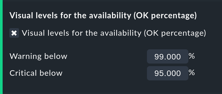

Using colors when displaying SLAs with thresholds
Options for colored display when falling below threshold values.
With Visual levels you can highlight objects that have not maintained a specified availability within the queried time range. This applies only to the column for the OK-state. This is normally always green. A shortfall for the defined threshold will cause the color of this cell to change from green to yellow, or to red. This could be described as a very simple SLA-overview.

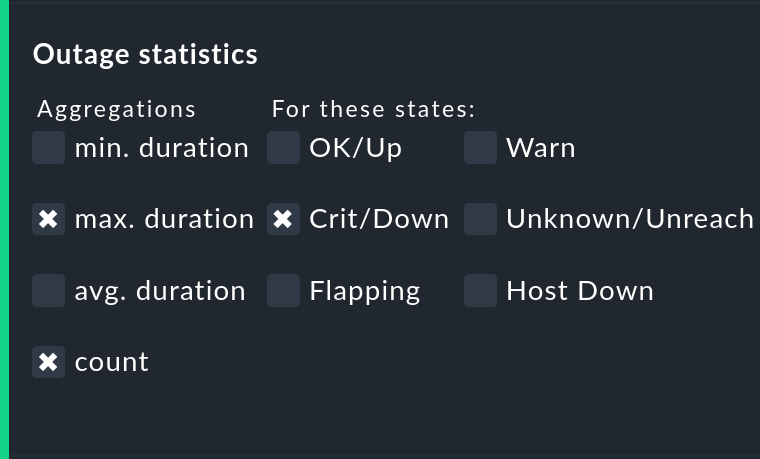

Displaying the number and duration of the individual outages
Options for displaying the number and duration of outages.

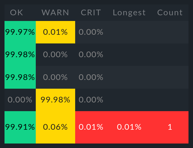

The Outage statistics option provides additional information columns in the availability table. In the screenshot below it can be seen that the additional information for max. duration and count have been activated for the Crit/Down status column. This means that for outages with a CRIT/DOWN state, the number of incidents, as well as the duration of the longest incident respectively, are shown.
View with the additional columns for displaying outages.
In the table these additional columns will be created.

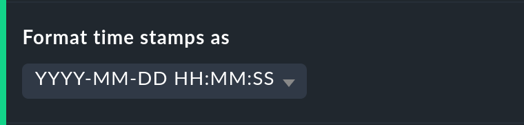

It is not always wise to specify (un)availabilities as percentages. The Format time ranges option enables switching to a display that presents the time ranges as absolute values. With this the total duration of the outages can be seen to the exact minute. The display even shows seconds, but note that that this only makes sense if the monitoring is conducted at one-second intervals, and not as is customary with one check per minute. Likewise the specification’s precision (the number of decimal places in the percentage values) can be defined.
Option for formatting time stamps.
The formatting of time stamps applies to settings in the Timeline. A changeover to Unix-Epochs (seconds elapsed since 1.1.1970) simplifies the correlation of time ranges to the appropriate locations in the monitoring history’s log data.

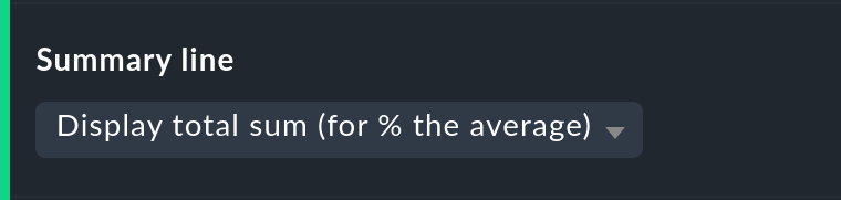

Customizing the summary line
Option for customizing the summary.
Not only can the summary in the table’s last line be activated/deactivated with this — you can also decide between a total sum and an average. For columns containing a percentage value, using the setting Display total sum will result in an average being shown, since adding percentage values makes little sense.

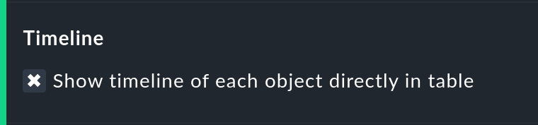

Showing the small timeline
Option for showing the small timeline.
This option adds a miniature version of the availability timeline directly to the results table. It corresponds to the graphic bar in the detailed timeline, but is smaller and is integrated directly into the table. In addition, it is true to scale, so that multiple objects can be compared in the same table.

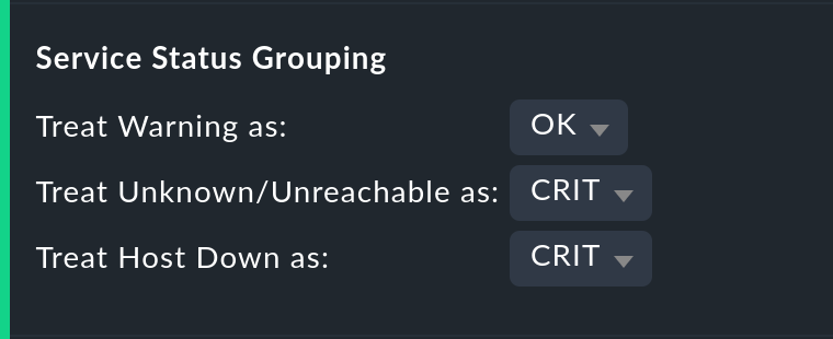

Handling the WARN, UNKNOWN and Host Down states
Options for grouping service states.
The Service status grouping option provides the possibility of showing various ‘intermediate states’. A common situation is to force WARN to be treated as OK. This can be quite useful if you are interested in a service’s actual availability. Often WARN doesn’t mean a real problem exists yet, but could soon develop. Thus, looked at in this way, WARN must be regarded as available. With network services such as an HTTP-server, it is certainly sensible to treat times during which the host is DOWN in the same manner as when the service is CRIT.
The states that are omitted due to the regrouping will of course also be missing from the results table, which will have fewer columns.

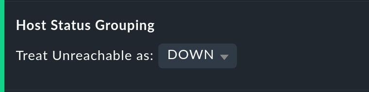

The Host status grouping option is very similar, but it relates to the availability of hosts. The UNREACH state means that a host, due to network problems, cannot be monitored by Checkmk. In such situations, for the purposes of the availability calculations you can decide whether you prefer to treat the UNREACH state as UP or DOWN. The default is to treat UNREACH as its own state.

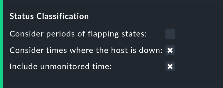

In the Status classification option further summaries will be undertaken. The Consider periods of flapping states check box is on by default — with this phases of frequent state changes constitute their own state: icon flapping — ‘flapping’. The idea behind this is that even though it can be said that at such times the affected service always returns to the OK state, due to the frequent outages the service is effectively unusable. By deactivating this option the concept of ‘flapping’ will then be completely ignored, and the respective actual state will reappear — and the flapping column will also be removed from the table.
Removing the Consider times where the host is down option works in a similar way. The concept of Host down is deactivated. This option only makes sense for the availability of services. In phases during which the host is not UP, the actual state of the service will be taken as the basis for the availability — or more precisely, the state of the last Check before the host became unavailable. This can be sensible with services for which their accessibility over the network is not relevant.
The Include unmonitored time option is also similar. Assume that an analysis for February is to be made, and that a particular service has only been in the monitoring since the 15th of February. Does this service then have an availability of only 50 %? With the default setting — option active — this will actually be the case. The missing 50 % will not be assessed as outage, rather it will be added-together in its own column under the title N/A. Without the option it will correspond to 100 % of the time from the 15th to the 28th of February. This does however mean that a one hour outage for this service will be reflected as double the percentage of a service that has been monitored for the whole month.

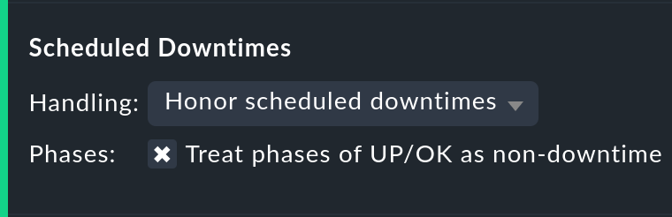

Handling of scheduled downtimes
Options for handling scheduled downtimes.
With the Scheduled Downtimes option you can specify how scheduled downtimes affect the availability analysis:
  • Honor scheduled downtimes is the default. Here downtimes will be treated as their own state and summarized in their own column. With Treat phases of UP/OK as non-downtime you can subtract the times during which, despite the downtime, the service was OK.
  • Ignore scheduled downtimes is treated as if no downtime had been entered. Outages are outages — full stop. Of course then only if an outage really occurred.
  • Exclude scheduled downtimes means that the scheduled downtimes are simply excluded from the time period being analyzed. The percentage for the availability then corresponds to the times outside the scheduled downtimes.

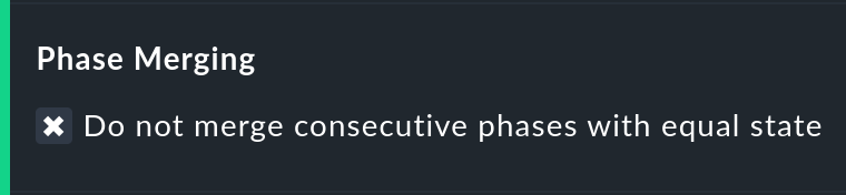

Merging equal phases
Option for merging identical phases.
Through the conversion of one state to another (e.g., from WARN to OK) it can occur that consecutive sections of an object’s timeline will have the same state. Normally such sections will be merged into a single section. This is generally a good thing, and clear, but it does has an effect on the display of the details in the timeline, and possibly also the counting of events with the Outage statistics option. You can therefore deactivate this merging with the Do not merge consecutive phases with equal state option.

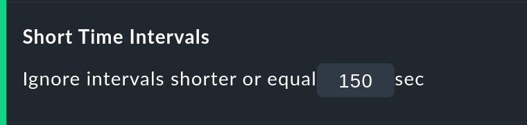

3.4. Ignoring short interruptions
Sometimes monitoring often produce momentary problem messages, but under normal conditions the object is already OK by the time the next check runs (after one minute) — and no way has been found through adjusting thresholds or similar to get a neat grip on such cases. A common solution is to set the Maximum number of check attempts from 1 to 3 to allow more failures before a notification is triggered. Thus the concept of Soft states has been developed — meaning the WARN, CRIT or UNKNOWN states — as long as all of the permitted attempts have not been ‘used up’.
We are occasionally asked by users who use this feature why Checkmk’s Availability Module has no function for calculating using only Hard states. The reason for this: There is a better solution! One could use the hard states as the basis…​
  • …​ so that real outages, due to the unsuccessful first and second check attempts, will be assessed as being two minutes too short.
  • …​ and one could not retrospectively readjust the behavior for short outages.
Option for handling short disruptions.
The Short time Intervals option is much more flexible and at the same time very simple. Simply define a length of time which must be exceeded before the states will be evaluated.
Assume that the time value has been set to 2.5 minutes (150 seconds). If a service has been continuously OK, then is CRIT for 2 minutes, and then reverts to OK, the short CRIT-interval will simply be assessed as OK! The opposite situation incidentally also works! A short OK within a long WARN-phase will likewise be assessed as WARN.
Generally speaking, short intervals for which before and after the same state prevails will receive that same state. For a sequence of OK, then a 2 minute WARN, followed by CRIT, the WARN will persist — even if it was of a shorter duration than the defined length of time!
Bear in mind when defining the time, that in Checkmk the standard check interval is one minute. Thus every state has a duration of multiples of approximately one minute. Because the agent’s actual response times vary slightly, this can easily be 61 or 59 seconds. Therefore it is safer to not enter exact minutes for the value, rather to include a buffer — hence the example with 2.5 minutes.

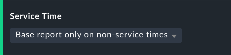

  • Use the Service time Availability-option to control the behavior:
Option for handling time periods for services.
Here there are three simple possibilities. The default Base report only on service times hides times outside the defined service times. These hidden times then don’t count towards the 100 %. Only the time ranges within the service times will be actually considered. In the timeline display the remaining times will be ‘grayed-out’.
Base report only on non-service times performs the opposite, and and in effect calculates the inverse display: How good was the availability outside the service times?
The third option Include both service and non-service times deactivates the complete concept of service times and shows the calculations for all times from Monday 00:00 to Sunday 24:00.

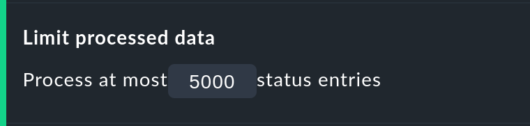

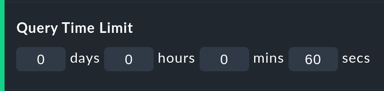

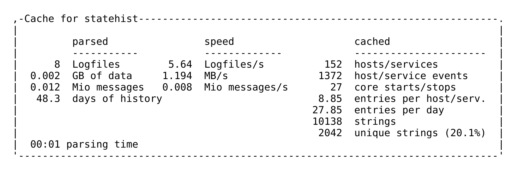

3.6. Limiting the calculation time
When calculating availability, the complete history of the selected object must be reopened. How that works in detail can be learned further below. Especially in CRE Checkmk Community, the analysis can take some time, since its core has no cache for the required data and the text-based log data must be sequentially searched.
So that an excessively-complex query — that may possibly have been started unintentionally — does not tie up an Apache process, consume CPU and thus ‘hangs’, there are two options to limit the calculation’s duration. Both are activated by default:
Option for limiting the time period for the evaluation.
The Query time limit limits the duration of the underlying query to the monitoring core to a specified time. This is predefined as thirty seconds. If this time is exceeded the analysis will be aborted and an error highlighted. If you are certain that the analysis can be allowed to run for longer, simply raise the timeout manually.
Option to limit the amount of data for the evaluation.
The Limit processed data option protects from calculations with many objects. Here a limit will be applied that functions analogous to that in the views. If the query to the monitoring core will produce more than 5000 time periods, the calculation will be aborted with a warning. The limitation will have been pre-processed in the core — where the data is gathered.

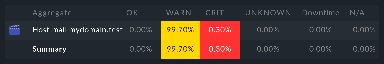

Retrieving the availability view is initially analogous to that for the hosts and services. Select a view with one or more BI aggregations, and select the BI Aggregations > Availability menu item. Here there is also a second method — every BI aggregation has a direct path to its availability using the button availability symbol:
BI view with icon for calling up availability.
In itself the calculation is initially analogous to that for the services, however without the Host down and flapping columns, since these states do not exist for BI:
View of a BI aggregation availability.
4.3. Time travel
The big difference is in the button timeline time line view. The following example shows an aggregate in our demo server, which was CRIT for a very brief interval of one second (this would be a good example for the use of the Short time intervals option).
View with timeline of the BI aggregation state changes.
Do you want to know what the cause of the outage was? A simple click button timewarp on the magic wand is enough. This enables a journey through time to the exact point of time when the outage occurred, and opens a display of the BI aggregation at that time — in the following image, already opened at the correct location:
Timewarp of a BI aggregation.

Cache statistics
If you are curious about how long the generation of a cache could take, a statistic can be found in the ~/var/log/cmc.log log file. Here is an example from a smaller monitoring system:
Statistics for calculating the cache.

~/var/check_mk/availability_annotations.mk
Here the annotations and retrospectively-amended scheduled downtimes for outages are stored. The file is in the Python-format and can be manually edited.
