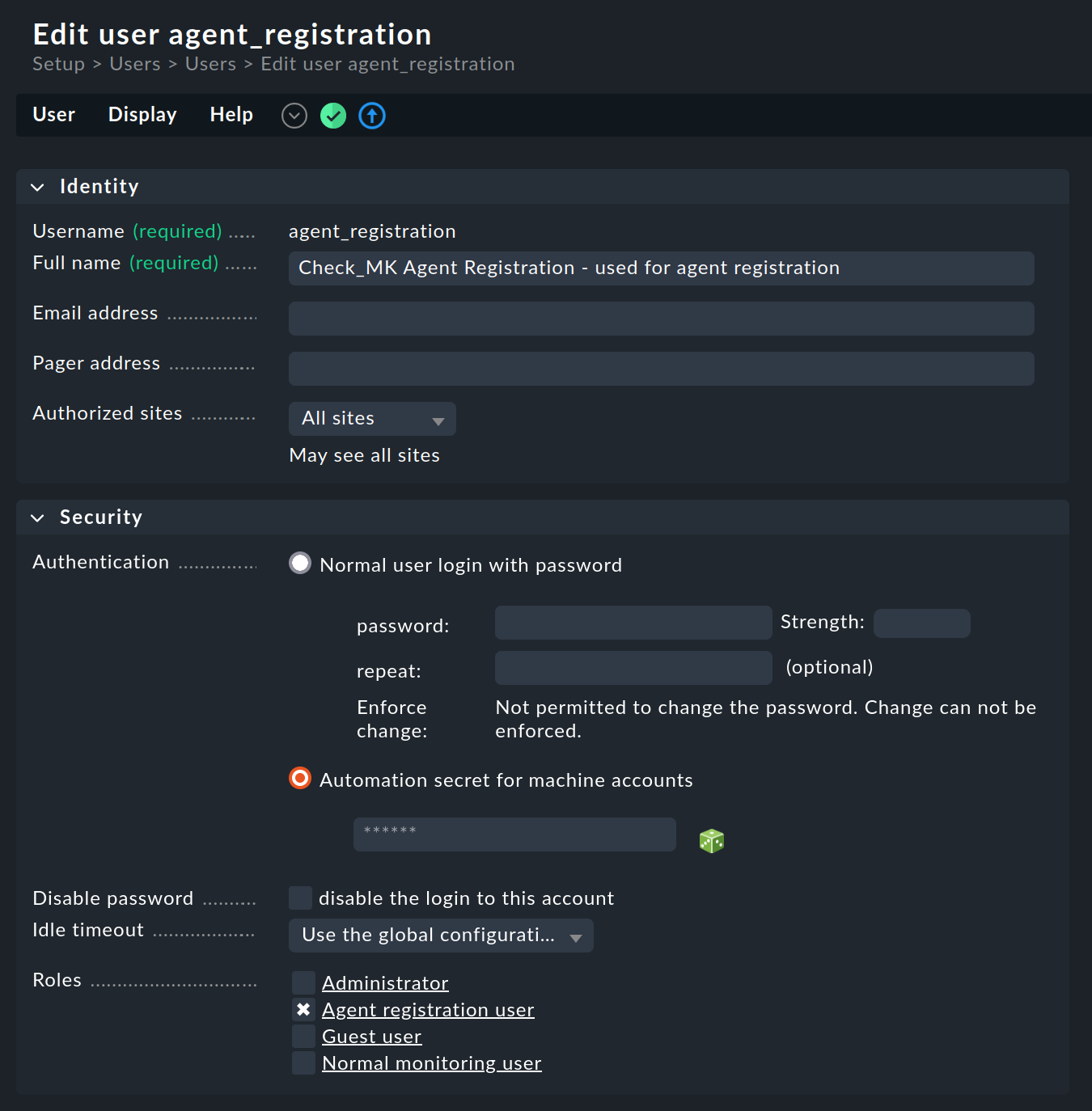

2.1. Select user for auto-registration
The permissions needed to register the agent with the Checkmk server (for TLS-encrypted data transfer) and to create hosts are contained in the role Agent registration user. The permissions to register new hosts are available in this role only in Checkmk Ultimate.
This role is assigned to the automation user agent_registration, which is set up in every Checkmk site and whose properties can be displayed via Setup > Users > Users:
Dialog with the properties of the automation user 'agent_registration'.
By default, this automation user only has the role Agent registration user
It makes sense to use this automation user for auto-registration, which is not allowed to do anything other than register hosts.

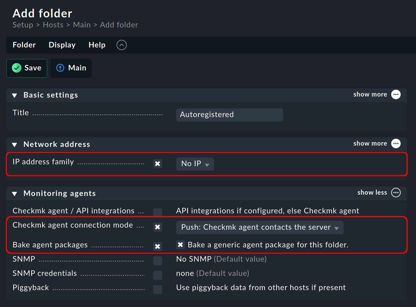

2.2. Creating a folder for the new hosts
The automatically created hosts are to be created in a new folder. Alternatively, you can use an existing folder if you configure that folder as described below.
Start the creation of a folder with Setup > Hosts > Hosts > Add folder. Give the new folder a name in the Basic settings box.
The Network address box includes the IP address family option. If you want the host’s Checkmk agents to be set up to use the pull mode, you can leave the default value IPv4 only unchanged. For push mode, select the value No IP. This prevents the host’s accessibility from being checked via Smart Ping.
In the following Monitoring agents box, you specify two important options for the auto-registration. With Checkmk agent connection mode you decide whether the Checkmk agent should work in pull mode or (as in the following image) in push mode. This option is only available in Checkmk Ultimate. Finally, in Bake agent packages, activate the Bake a generic agent package for this folder checkbox. This allows you to use the Agent Bakery, to create an agent configuration for a folder and all of the hosts it contains, and any hosts that may be added to this folder in the future.
Dialog for creating a new folder for auto-registration.
Configuring a folder for the push mode
Complete the creation of the folder with Save.

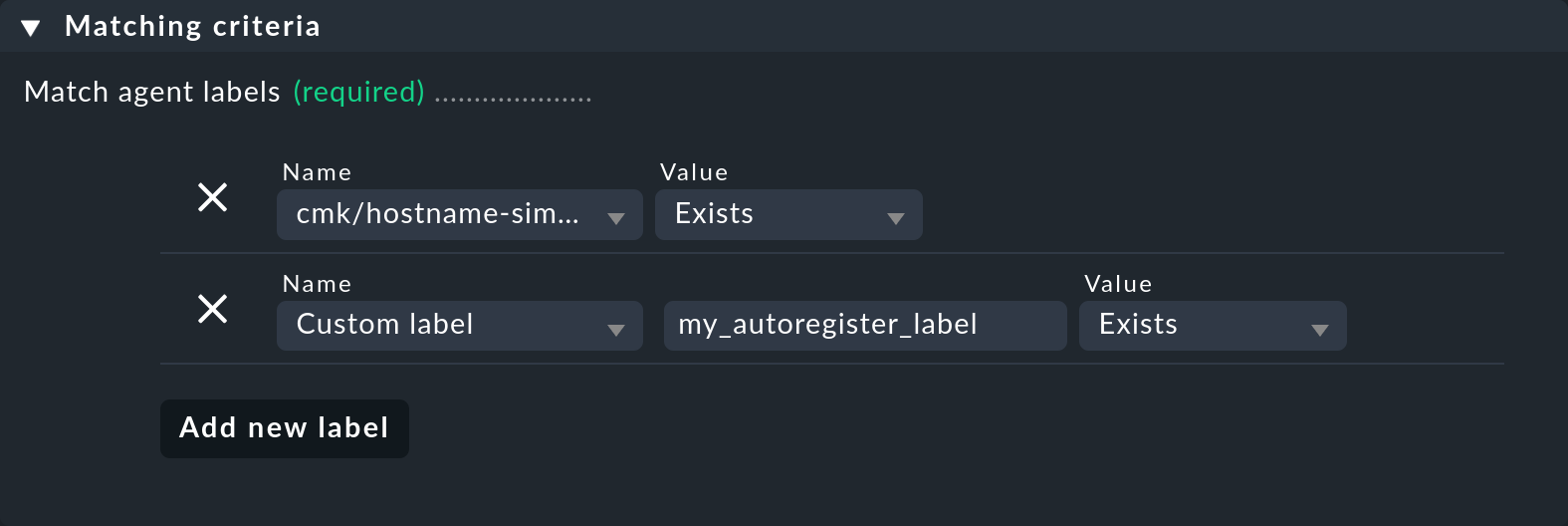

In the following Matching criteria box, you specify which labels are to be accepted when the Checkmk server receives a request for registration from an agent. These agent labels are used exclusively for auto-registration and are different from the labels otherwise used in Checkmk to identify hosts and services. Two agent labels are supplied by the Checkmk agent and can be selected from the list: cmk/os-family contains the host’s operating system which can be used, for example, to store the hosts in different folders. cmk/hostname-simple contains the host name without the domain component (hence simple) which is intended for designating a unique host name in Checkmk. There is no agent label with a Fully Qualified Domain Name (FQDN), as FQDN is not a property of the host, but of the network. You can also enter your own labels with Custom label.
The colon-separated key-value pair that makes up a label (e.g. cmk/os-family:linux) is evaluated separately. This way you can explicitly specify that a key (e.g. cmk/os-family) must exist (Exists), may not exist (Does not exist) or is only accepted with a given value (Equals). You can also enter a regular expression (Regex) as the value. If you define multiple agent labels, they will be logically linked with AND. In the following example, in addition to the predefined label cmk/hostname-simple, the custom label my_autoregister_label is also to be checked:
Auto-registration rule specifying the allowed labels.
This checks whether labels with the cmk/hostname-simple and my_autoregister_label keys exist

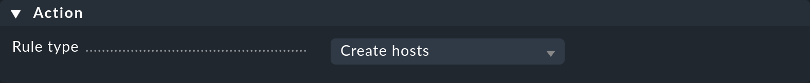

In the next box, Action, you determine what should happen when the evaluation of the labels takes effect: Create the host or not. If you select Stop and do not create hosts, the rule evaluation is then complete and the next two boxes are no longer relevant. In our example, however, hosts are to be created:
Auto-registration rule specifying the action to be performed.
The default action is the creation of the hosts

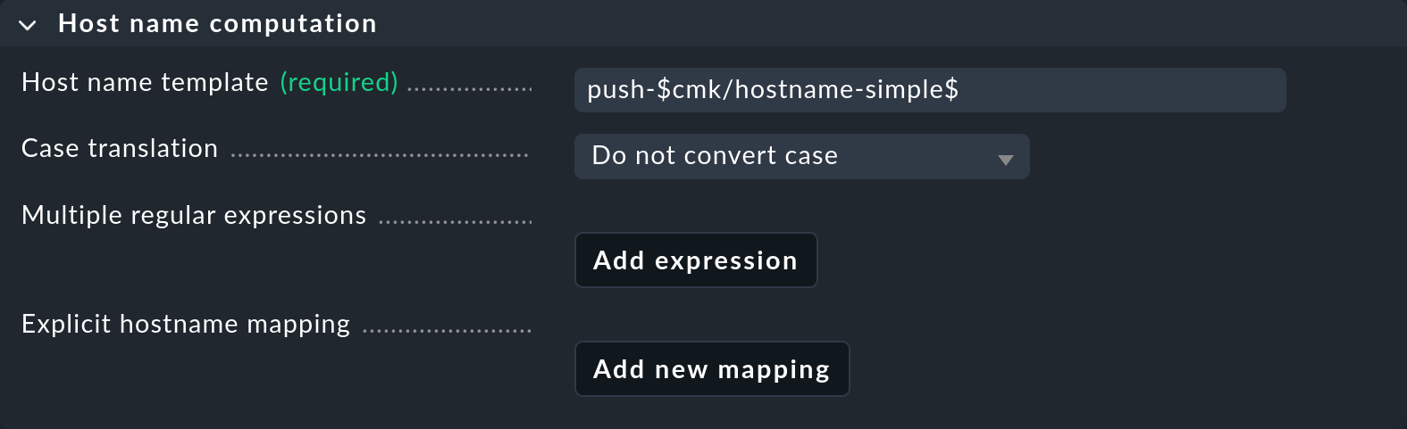

In the Host name computation box, you now specify which name the host should receive. In the Host name template box, enter the template. Here you can use macros to read the actual values from the agent labels that you selected in the Matching criteria box above — with $cmk/hostname-simple$, for example, the simple host name supplied by the Checkmk agent. You can then modify the template, if desired, by converting to lower or upper case, and substitutions with regular expressions and with explicit host names. These are, by the way, the same options that are available in customizing the names of piggyback hosts. More information can also be found in the inline help.
Auto-registration rule with host name specification.
Adoption of the simple host name, supplemented by the prefix push-

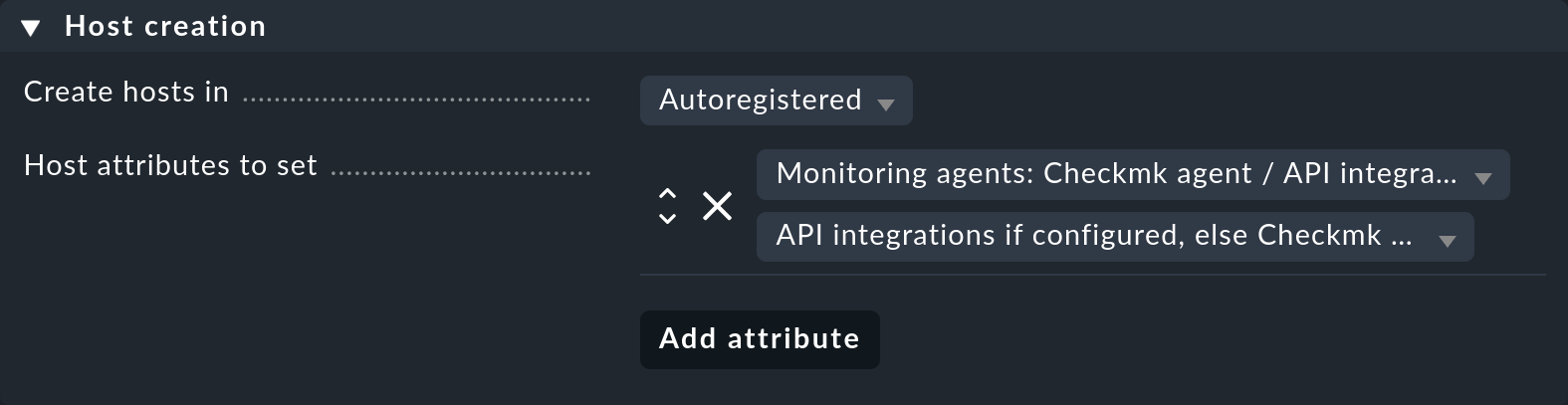

Finally, in the Host creation box, select the predefined folder in which the new hosts are to land. In addition, you can specify attributes that are to be given to the host. You can read more about these attributes in the article on host administration.
Auto-registration rule specifying the destination folder and host attributes.
The new hosts should be created in the predefined Autoregistered folder

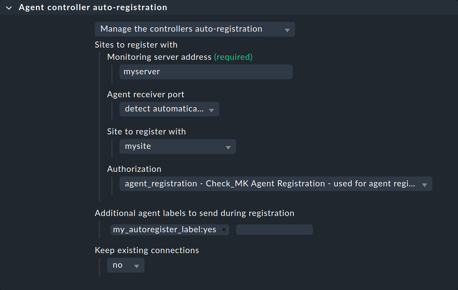

2.4. Creating a rule for the Agent Bakery
After configuring the Checkmk site in the previous section, we now deal with the Checkmk Agent Controller. For this, you use the Agent controller auto-registration rule set in the Agent Bakery, which is only available in Checkmk Ultimate. You can find the rule set in the Agent Bakery under Agent rules or the quickest way is to search for it in the Setup menu. Create a new rule.
In the Agent controller auto-registration box, provide the Agent Controller with all of the information it needs to make a registration request to the Agent Receiver: the Checkmk server (Monitoring server address), if applicable, the port number for the Agent Receiver (Agent receiver port), the automation user for auto-registration (Authorization) and the Checkmk site (Site to register with) that is to monitor the host. In a distributed monitoring, this will usually be a remote site.
You can also define your own labels here at the Additional agent labels to send during registration option. For the auto-registration to work, these labels must match the ones which you have entered under Custom label in the rule for the Checkmk site: in the example, the previously created custom label with the my_autoregister_label key.
With the final option Keep existing connections you determine whether the Agent Controller should delete (no) or keep (yes) already existing connections. If you have configured manual connections to other Checkmk sites in addition to the automatic registration of a connection, and want to keep these even after a restart of the Agent Controller cmk-agent-ctl, you should set this option to yes.
Auto-registration rule for Agent Bakery.
The values for the Agent Bakery must match those of the Checkmk site
Important: For the last box in this rule, Conditions, again select the predefined folder as Folder.

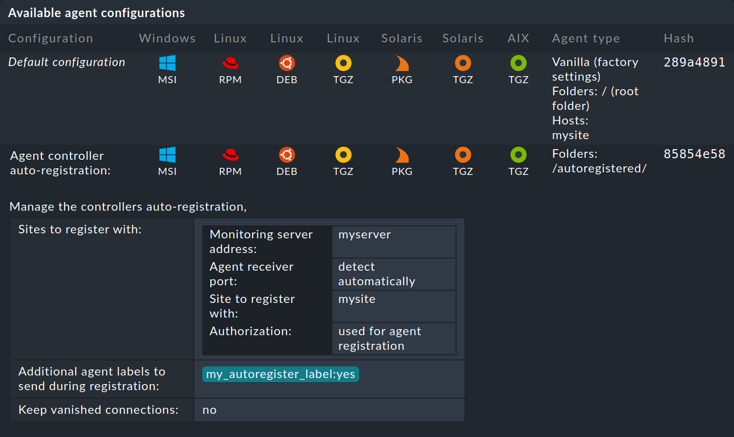

2.5. Baking an agent package
Now continue in the Agent Bakery with Setup > Agents > Windows, Linux, Solaris, AIX. Click on Button for baking agents. and bake yourself a new agent. As a result, in addition to the Vanilla (factory settings) agent configuration, you will receive a new line for the configuration in which the rule created in the previous section has been baked in:
List with the new configurations of agents for auto-registration.
The Agent type column shows that the new configuration is specific to the configured folder

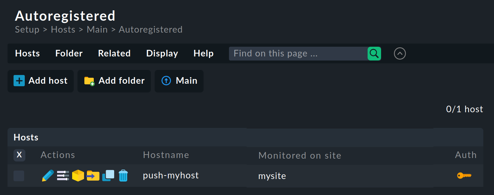

2.7. Process verification
After installing the agent package, the Agent Controller evaluates the pre_configured_connections.json file on the host and issues the registration command for a connection that it contains. If the Agent Receiver accepts this command, the connection will be set up and the host created in the Checkmk site.
Contents of the auto-registration folder containing the automatically created host.
The automatically created host in the Setup
A service discovery is then performed and the changes activated, so that the host will also be visible in the monitoring. Note that during the automatic activation, any other accumulated changes — also from other users — will also be activated.
This process can take several (up to 5) minutes from the installation of the agent package until the host appears in the monitoring. You can track the individual steps in this process in Setup > General > Audit log after selecting the wato_audit.log file.

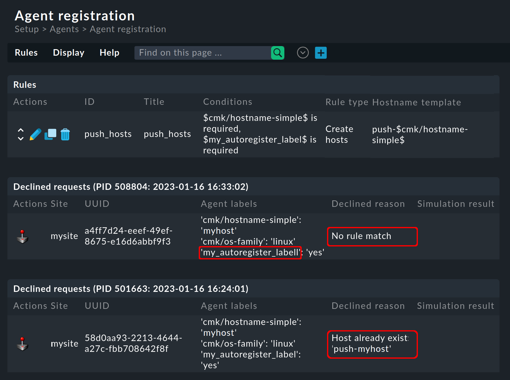

For an overview of all registration requests that have been rejected by the Checkmk site, see the Agent registration page, above, in which you created the rule for the Checkmk site. There are many possible reasons for a rejection. In the following image you can see two examples — a misspelling (my_autoregister_labell) in the agent label submitted by the agent, and a host that already exists:
List of rejected auto-registration requests.
Two rejected registration requests
For each rejected request, in the first column, Actions, you can start a simulation, the result of which is displayed in the last column, Simulation result.
