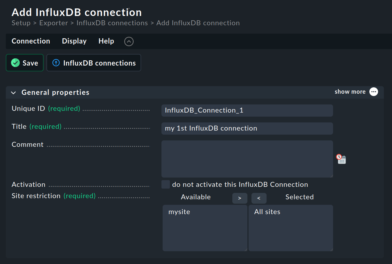

So first create a new connection with Icon to create a new connection. Add connection:
The general properties of an InfluxDB connection.
ID, title and site selection are enough for the general properties
In the General properties, you specify the internal ID and title for the connection, as usual.
If there are other sites connected to the current site, as is the case with a distributed monitoring, you can restrict the connection to specific sites under Site restriction. To do this, first move the All sites entry to the left column and then move the sites that should receive metrics from the left to the right Selected column. The sites that will not receive metrics then remain in the left column.

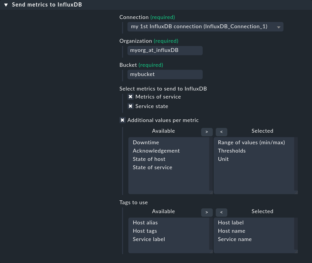

With a rule you determine in Checkmk which data is sent to the InfluxDB server and where it is stored.
The Send metrics to InfluxDB rule set can be found in Setup > Services > Service monitoring rules, can be accessed more quickly with the search in the Setup menu, and quickest by clicking in the connection list:
Rule to select metrics information to send via InfluxDB connection.
Selection of metrics information is done by rule
In the Send metrics to InfluxDB box, first select the connection created in the previous section and then specify where the data will be stored on the InfluxDB server. Here, enter the second set of collected information for the InfluxDB server. Use Organization to decide which users receive the data, and Bucket to decide how long the metrics are kept. Multiple selection is not possible, i.e. you cannot send the metrics to multiple buckets for use by different organizations, for example.
Below you select the metrics data that will be sent from Checkmk to the InfluxDB server. Metrics of service is already selected by default and enables the sending of metrics. Checking the Service state checkbox will send the service state as its own metric.
After enabling Additional values per metric you can add a number of meta-data to the metrics for display purposes, e.g. the State of service and the Thresholds. Note here that Unit currently only works for metrics from active checks if these support it. The reason is that only active checks have an option to supply the unit and the CMC has no access to others.
In the last selection menu, Tags to use, meta data such as host tags or labels are added to the metrics, which are mainly used for filtering and have been optimized for this purpose. The Host name and Service name selected by default are mandatory entries that cannot be deselected.
In InfluxDB, the Additional values per metric are stored as fields and the Tags to use are stored as tags.
Finally, activate the changes to create the connection and create the rule(s). In the event of problems with the transmission of metrics, see the information on diagnosing errors below.

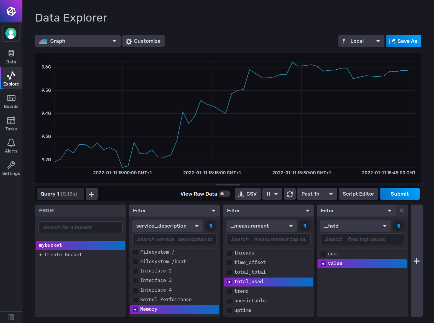

2.4. Displaying metrics in InfluxDB
Once the metrics from Checkmk have arrived at the InfluxDB server, they can be displayed in the InfluxDB GUI. As an example, the following image shows the graph for the total_used metric, which shows the amount of memory used:
Display of the used memory metric in the InfluxDB GUI.
In the InfluxDB GUI, below the graph there are lists for selection and filtering
Note: This metric can be found in Checkmk at the Memory service under the metric named Total used memory.

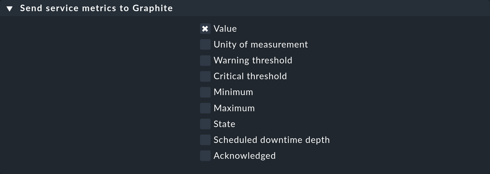

Unlike the InfluxDB connection, by default all metric data is sent as soon as a graphite connection has been enabled. If you don’t want this, you should select the metrics by rule before enabling the connection, and then enable both the rules and the connection together.
3.1. Selecting metrics information
In Checkmk under Setup > Services > Service monitoring rules you will find the two rule sets Send host metrics to Graphite and Send service metrics to Graphite. The configuration is carried out in the same way for host and service metrics. We show the configuration for service metrics here. You then set up the host metrics in the same way.
You can use the Send service metrics to Graphite rule to select the values to be sent with the metrics:
