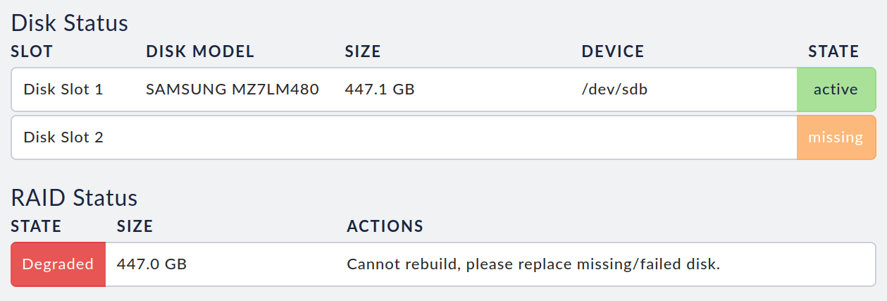

If a hard disk is detected as being defective, it is displayed in the web interface as Degraded. On the unit itself, depending on the type, the error will be indicated by a blue flashing LED lamp on the hard drive bay.
cma de rack1 raid broken
By pressing the small lever on the left side of the slide-in module, the assembly is unlocked and you can pull the tray including the hard drive out of the enclosure. Now you can loosen the screws on the bottom of the tray and remove the defective hard drive from the tray. Mount the new hard drive in the tray and push it back into the free slot in the device.

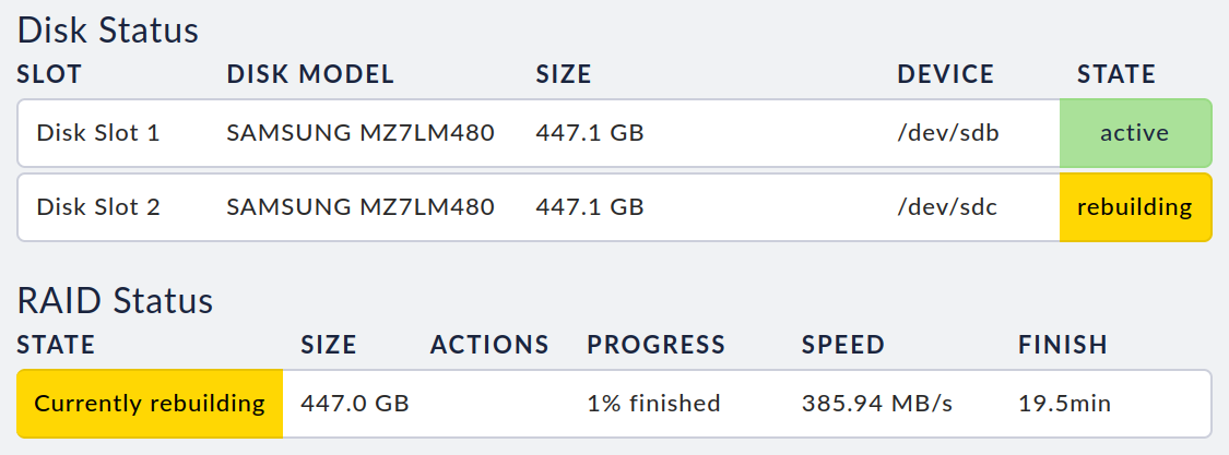

If the unit is switched on while you replace the hard disk, the RAID rebuild process will start automatically. You will be able to see the rebuild’s progress in the web interface.
cma de rack1 raid repair
The fail-safe function will only be restored after the RAID has been completely repaired.

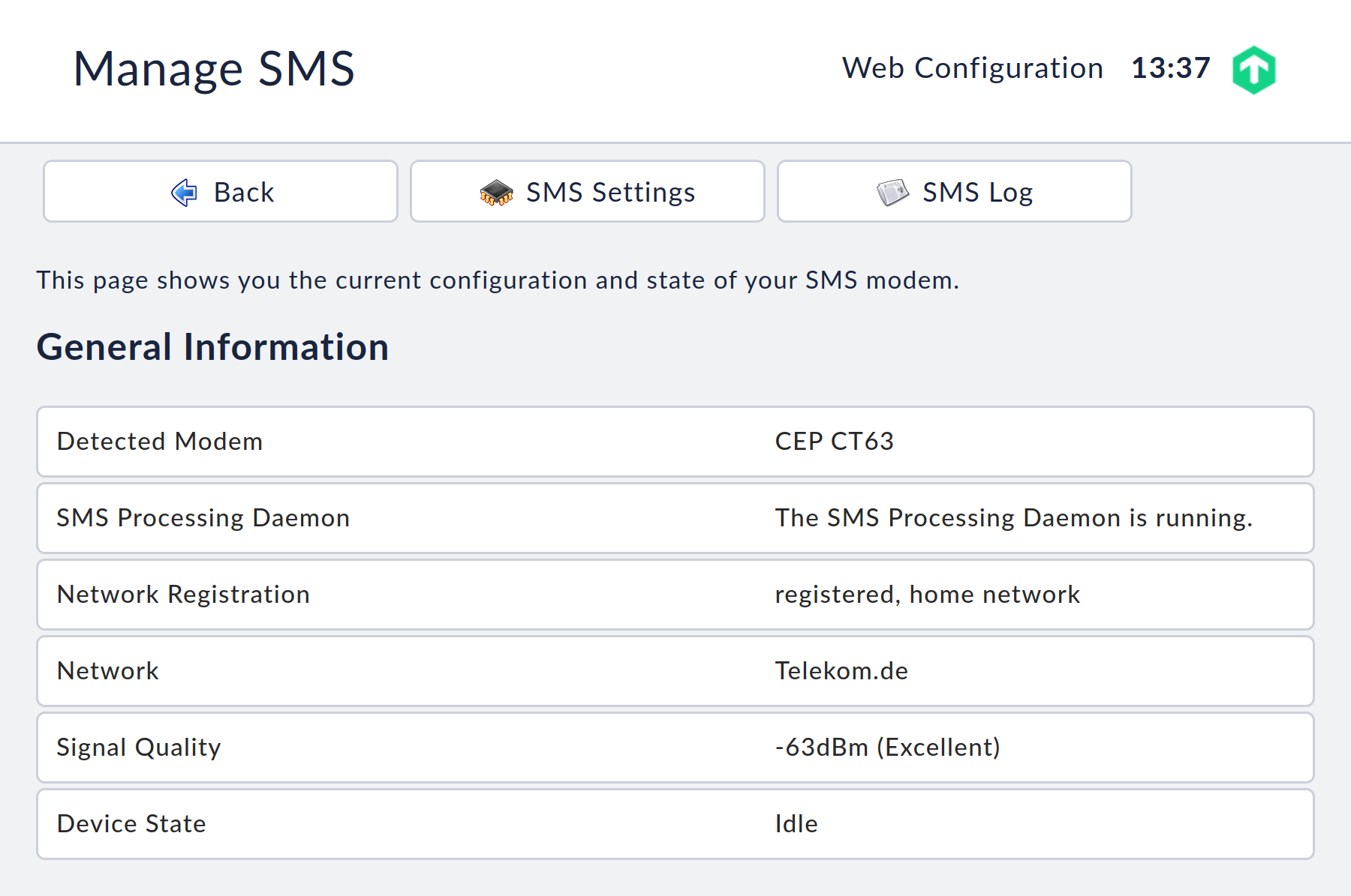

To put the modem into operation, you must insert a functioning SIM card and connect it to a free USB port on your appliance.
Once this is done, the appliance automatically detects the modem and sets it up. Open the appliance’s web interface and select the Manage SMS module. This page shows you the current status of the modem and its connection to the mobile network.
appliance usage manage sms

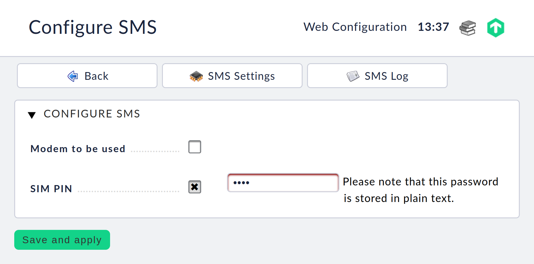

If you need to enter a PIN to use your SIM card, you can enter it under SMS Settings.
appliance usage configure sms

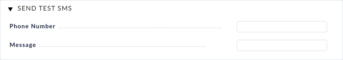

It is possible to send a test SMS to a number of your choice via the Send test SMS menu item. The phone number must be entered without leading zeros and without a leading plus sign, e.g. 491512345678 for a mobile phone number in Germany.
cma de sms 3
Further information on possible errors when sending SMS messages can be found in the SMS Log.
