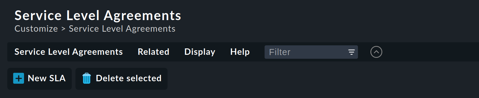

First, create the actual SLA. The configuration can be found via Customize > Business reporting > Service Level Agreements (by the way, you can only see this menu item in Show more mode):
List of Service Level Agreements (SLAs) with action bar button to create an SLA.
In the Service Level Agreements (SLAs) list you can find the action bar button to create an SLA
Create a new SLA via icon new New SLA. In the General Properties section, first give a unique ID, here MySLA, and a title, such as Filesystems:

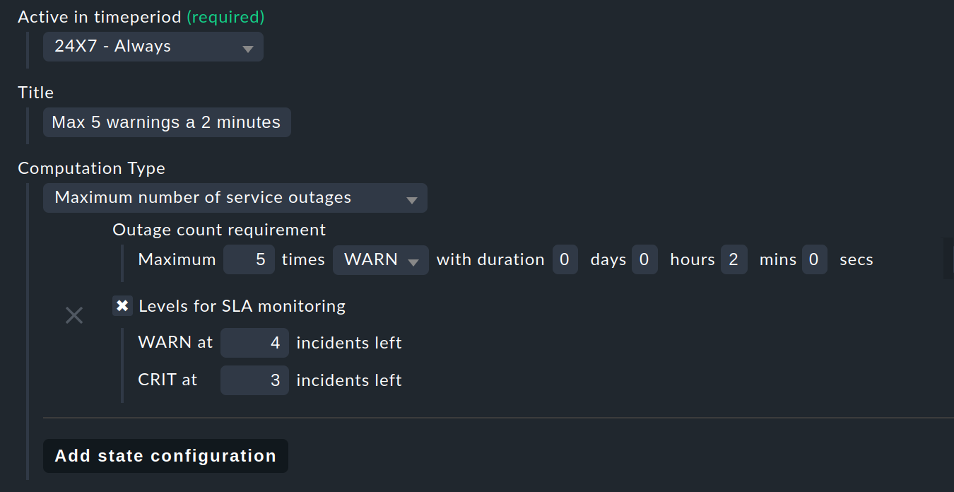

Now add a second request with Add new timeperiod. Again set the time period – under Title, for example, specify Max 5 warnings of 2 minutes as the name and in this case set the Computation Type to Maximum number of service outages: The actual request is then: Maximum 5 times WARN with duration 0 days 0 hours 2 mins 0 secs:
Dialog for defining the second SLA requirement.
The second requirement is defined as an outage SLA
According to the SLA, per SLA period the service is now allowed the specified state on a maximum of five occasions, and each occurrence for a maximum of two minutes, without the SLA being flagged as broken. Instead of WARN another state could of course also be specified at this point. And again via the Levels for SLA monitoring you may also refine and determine how many remaining incidents will trigger a warning, before the SLA actually breaks with a WARN or CRIT.
As mentioned earlier, you can add more of these requirements and knit detailed SLAs together. But there are still no services that 'react‘ to this SLA — in our example, a rule must make this connection. How to use the configuration created up to this point without such an SLA service connection is described below under column-specific SLA displays.

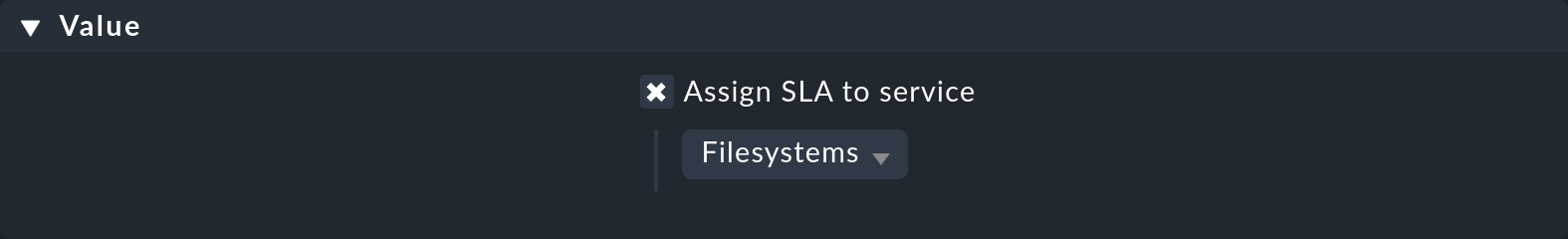

The SLA is connected to a service via the Setup > Services > Service monitoring rules > Assign SLA definition to service rule set. Create a rule, enable the only rule-specific option Assign SLA to service, and then choose your SLA definition MySLA, listed here by its title Filesystems.
Rule for selecting the SLA for the service.
The previously-created SLA is offered for selection in the list

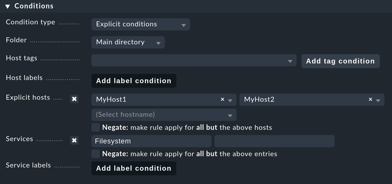

Next under Conditions in the Services section define further filters for the desired services. As always, here you can work with regular expressions, and as in this example link the SLA definition to all local file systems via Filesystem. Optionally you can still restrict everything using the rule-specific filters for folders, host tags and explicit hosts; in our example they are the hosts MyHost1 and MyHost2:
Service selection condition for the SLA.
The file system services are assigned to the SLA
Of course at this point you could also omit any service filtering and simply bind the SLA to all services. How and why it is better to do that with a column-specific SLA view is explained below.

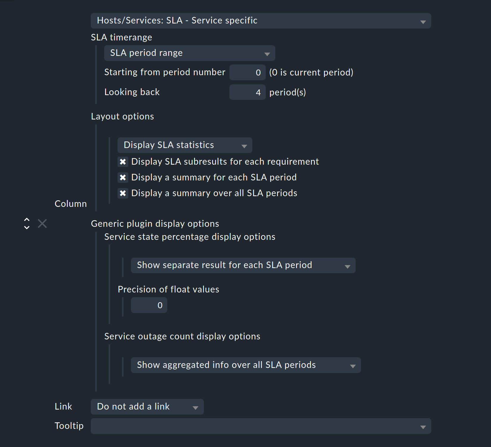

The column selector also contains two SLA-specific columns: Hosts/Services: SLA - Service specific and Hosts/Services: SLA - Column specific. The latter shows a fixed SLA definition for each service in the view — the better alternative to an SLA for all services as mentioned above. More on this later.
Add the Hosts/Services: SLA - Service specific column at this point. Here all sorts of options are now available for the presentation of the SLAs’ results:
SLA representation options when creating the view.
The numerous options for SLA representation in the view
SLA timerange: Use this to set the time frame for for which you want to see SLA results. For example, if you have the reporting period Monthly in your SLA definition and here Last Year, you receive twelve individual results. In this example the SLA period range option is used to directly specify the number of displayed reporting periods: For five periods/results set Starting from period number to 0, and Looking back to 4.
Layout options: By default, this option is set to Only Display SLA Name. To actually see the results of the SLAs, here choose Display SLA statistics. You can select up to three different elements:
  • Display SLA subresults for each requirement displays each affected SLA with name in a separate line.
  • Display a summary for each SLA period shows a graphic summary in the Aggregated result line.
  • Display a summary over all SLA periods: Shows a textual, percentage summary of all SLAs in the Summary line.
Activate all three options for this current example.
Generic plugin display options: At this point, for the display of outage/percentage SLAs, define whether summaries (texts) or respectively individual results (icons) for the reporting periods should appear. To see both in action, leave the percentage SLAs option at Show separate result for each SLA period and select Service outage count display options to Show aggregated info over all SLA periods.

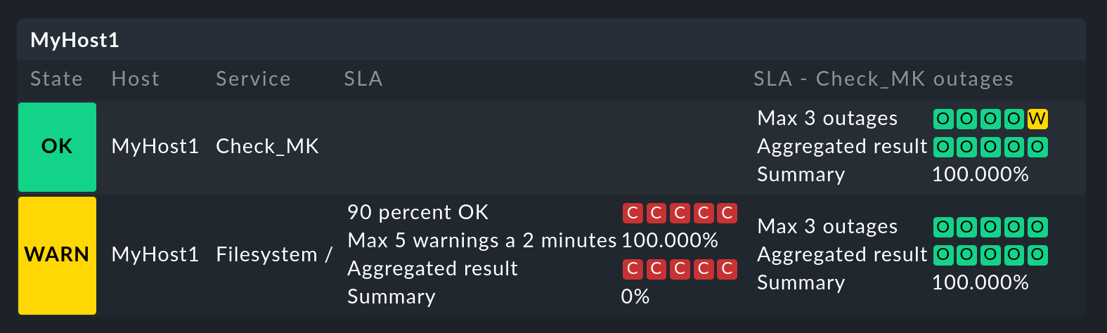

This completes the view setup. After selection in the Monitor menu as the result you will get a view with five status icons as single results from the percentage SLA, and a summary as a percentage for the outage SLA — of course only in the file system services lines, the Checkmk lines remain empty.
The view in monitoring shows two services with SLA information.
The view in monitoring shows — per host — one service with, and one without SLA information

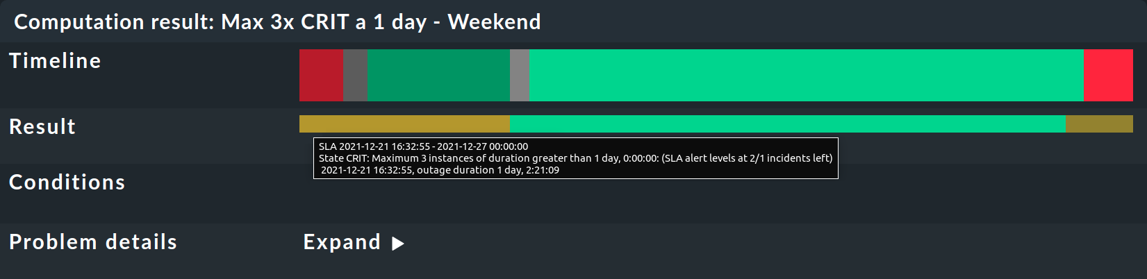

General information: Here you can see the raw availability data, and thus the SLA calculations as an overview of the state for each period, and below it the aggregated results of the SLA’s requirements.
This is followed by tables for each individual SLA requirement. The Timeline shows every single state and the Result row shows the results for each individual reporting period. A special feature here: If you, as described in the example, have set SLA levels and the SLA goes to CRIT before breaking, this will be indicated here by an orange bar and not the usual red bar. The bars will then turn red when the SLA breaks. Once you get that, move the mouse pointer to the result bar where, via a tooltip, you will be able to see the individual events that are responsible for the state. In the following picture the state is WARN — because only two out of the three permitted outages remain:
Tooltip of a result on the SLA details page.
A tooltip shows detailed information about the result row
The message SLA broken would also appear in this tooltip.
A small note about using the view: If you move the mouse over the result bar Aggregated results or Result of a period, this period will be highlighted — for all individual requirements as well as the summary under General information. With a click you can select/deselect one or more periods.

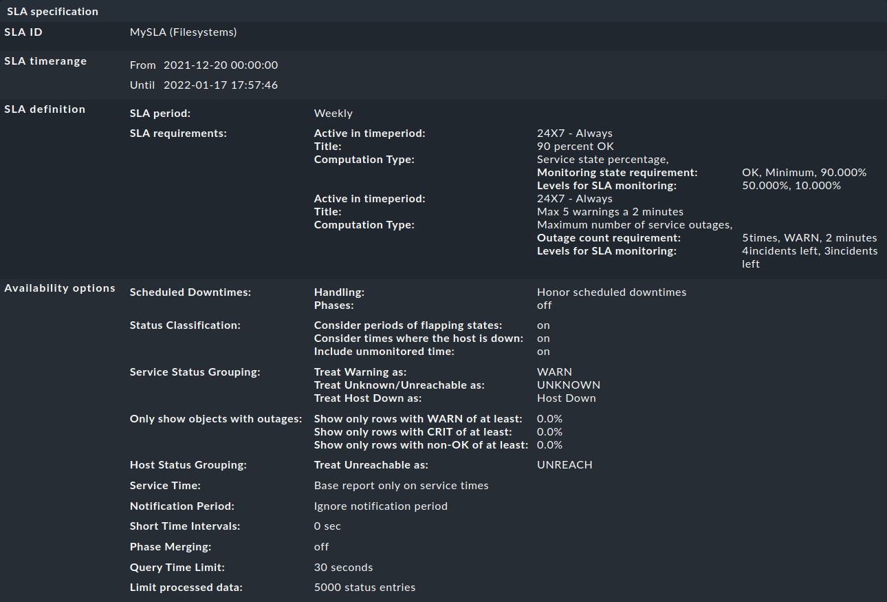

Finally, under SLA specification, the configuration data for your SLA follows, which will help you to better evaluate and understand the results presented:
The SLA specification for the service selected in the view.
The complete specification evaluated for the SLA results from the service

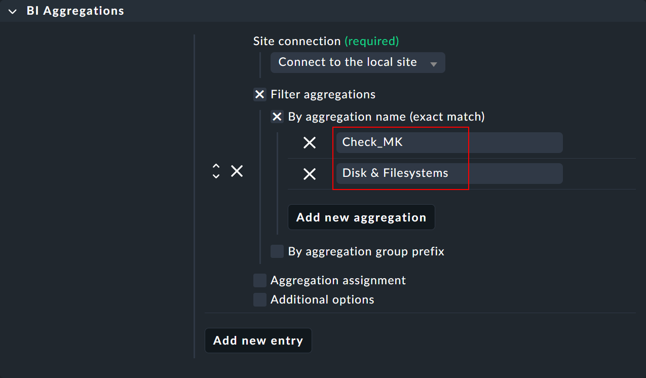

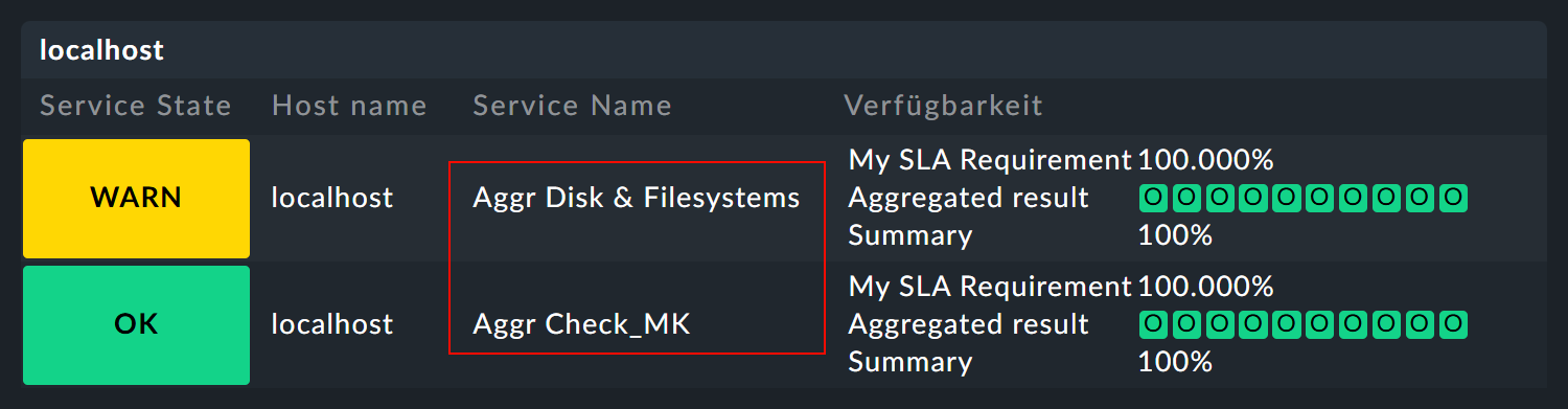

3.3. SLAs for BI aggregations
In the availability article you have already read about using the availability for BI aggregations. The SLAs are also available to the aggregations — via a small detour: The state of a BI aggregation can be monitored via the BI special agent as a normal service. This then appears, for example, as Aggr Disk & Filesystems in the views and can in turn be associated to an SLA via the Assign SLA definition to service rule already used above. As a result, it will look something like this:
A view with the SLA information for a BI aggregation.
The service shows the SLA information for a BI aggregation

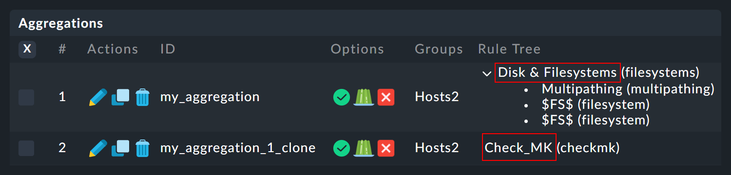

The special agent rule can be found under Setup > Agents > Other integrations > BI Aggregations, and a description of the rule set in the BI article.
The special agent requires the relevant site and, if necessary, its login data if it is a remote site. The main configuration takes place under Filter aggregations. This is where all the of the aggregations are specified that you want to include as separate services in the monitoring. Under By aggregation name (exact match) enter the title of the top-level rule of an aggregation — for example Disk & Filesystems (which is then supplemented by Aggr as a new service Aggr Disk & Filesystems).
Configuration of the BI special agent.
Configuration of the special agent
The exact names of the desired rules/aggregations can be found — for example — under Setup > Business Intelligence > Business Intelligence > Default Pack - Aggregations:
List of BI rules for selecting a rule.
The titles of the rules in aggregations
Note: There is a risk of confusion here: In the BI configuration, you create the actual aggregation, i.e. the logic, via rules — and these rules are entered here via their titles as Aggregation Name.
