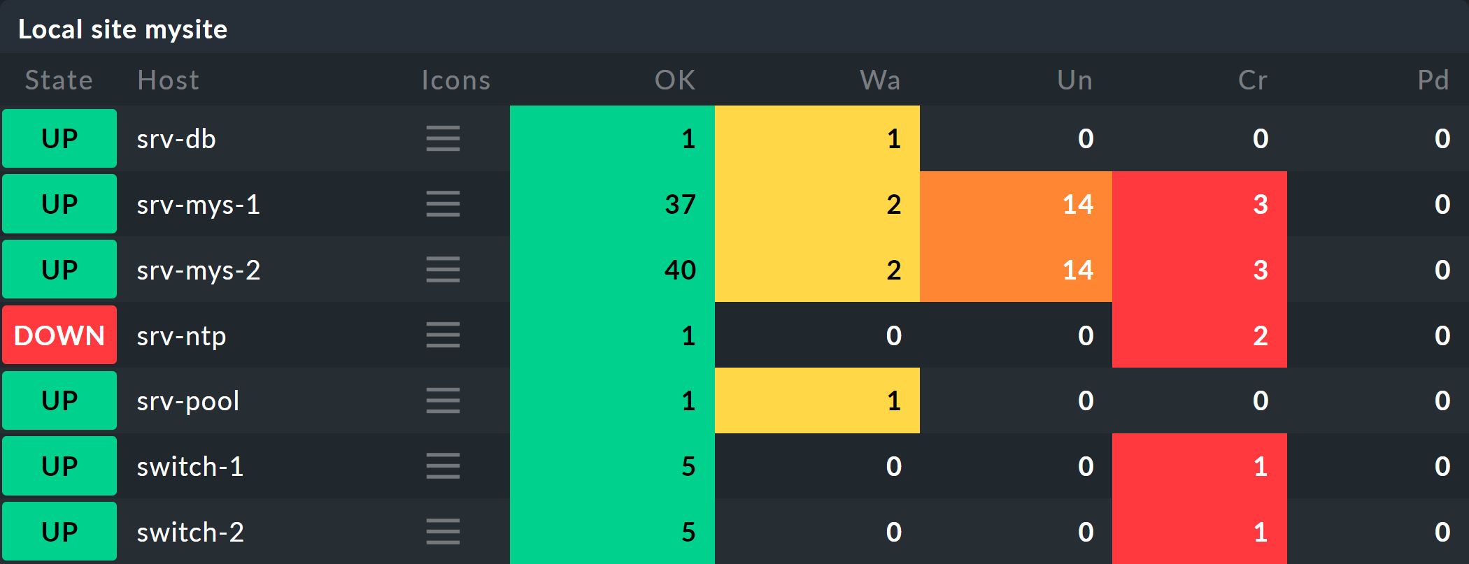

The hosts will then look something like this in the monitoring:

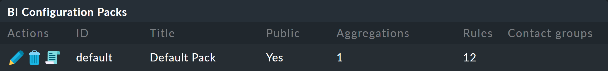

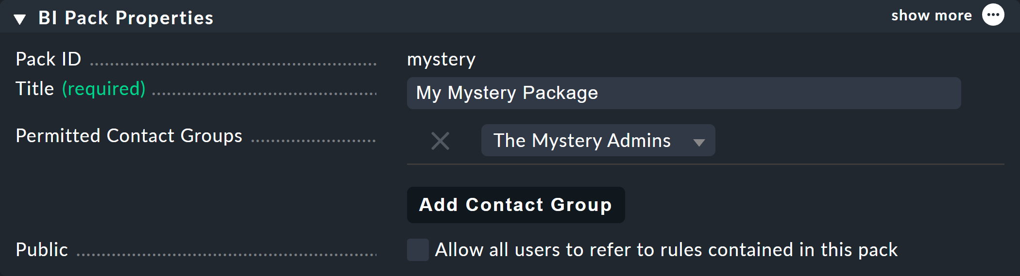

A package titled Default Pack is already present. This contains a demo for an aggregation which summarizes the data for an individual host.
For this example it is best to create a new package — with the Add BI Pack button — which you name Mystery. As always in Checkmk, specify an internal ID (mystery) which cannot be changed later, and a descriptive title. The Public option is needed by other users if there are rules in this package they want to use for their own rules or aggregations. Because you probably want do your experiments alone in peace, leave this option disabled:
bi 2 create pack
After the creation you will of course find two packages in the main list:
bi 2 two rulepacks
With each entry is a icon (Icon for editing.) for editing the properties, and an icon to open the package’s actual content (Icon for a rule.), which is where you want to go now. Once there, create your first rule right away via Add rule.

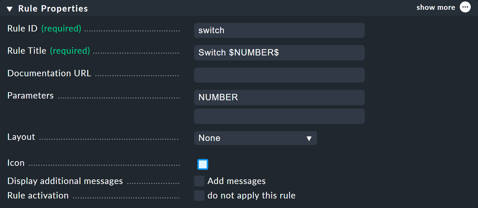

As always in Checkmk, this rule also needs to have a unique ID and a title. The title of the rule not only has a documentation function, but will later also be visible as the name of the node that will be created by this rule:
bi 2 create rule 2

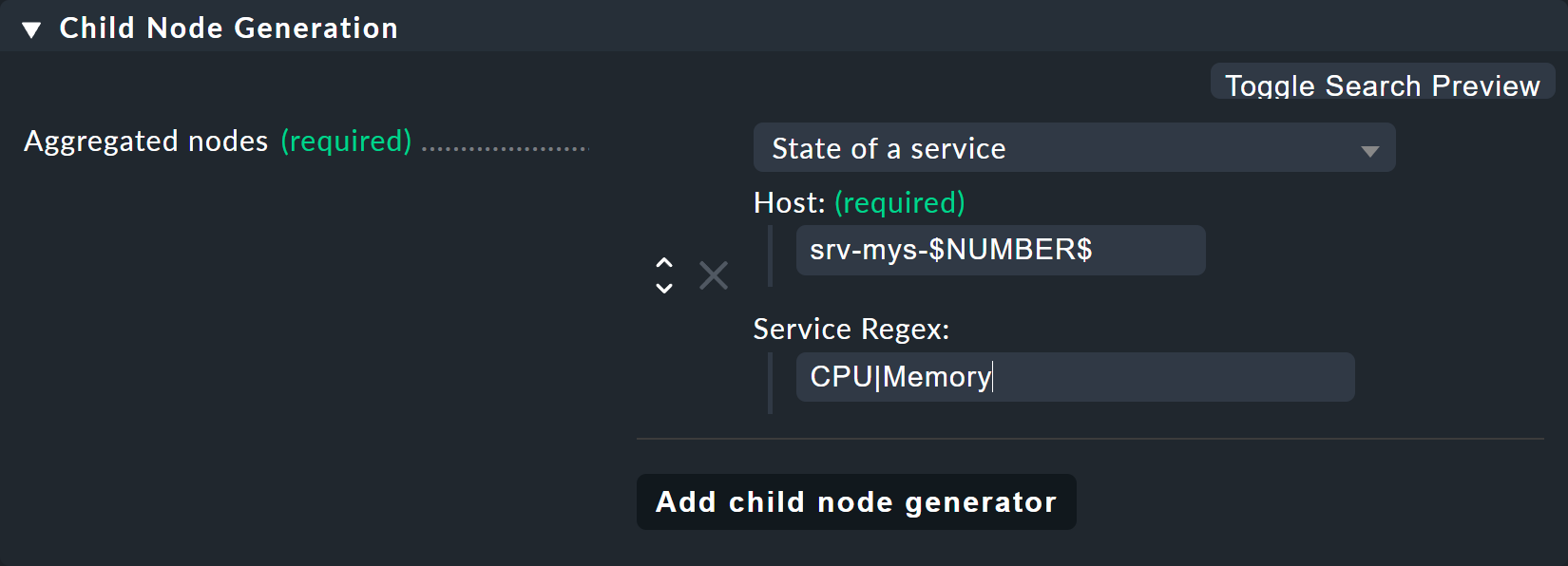

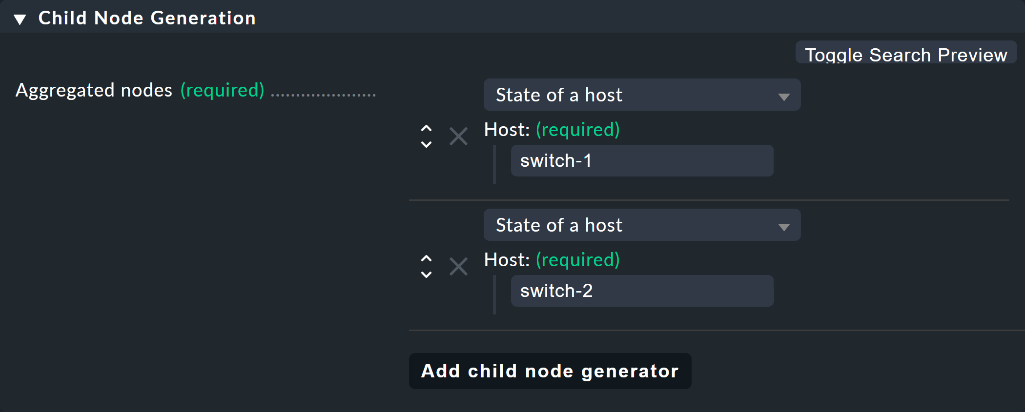

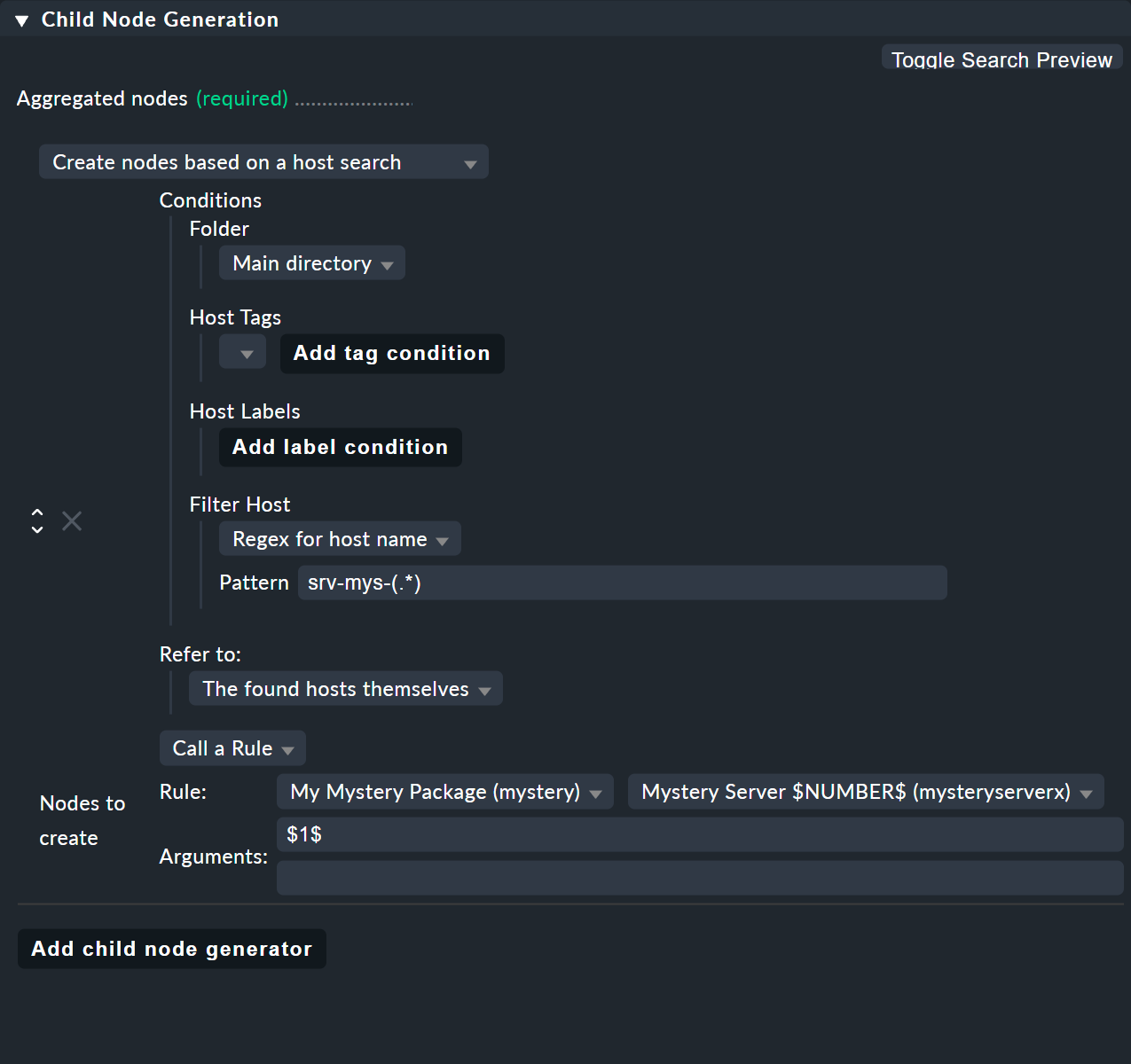

The next box is named Child Node Generation, and is the most important. Here you specify which objects in this node should be summarized. This can either be other BI nodes — for which you would choose a different BI rule — or objects being monitored, i.e., hosts or services.
For the first example select the second variant (State of a host) and create two objects as children — namely the two hosts switch-1 and switch-2. This is done with the Add child node generator button. Here you naturally choose State of a host, and enter a name for each host:

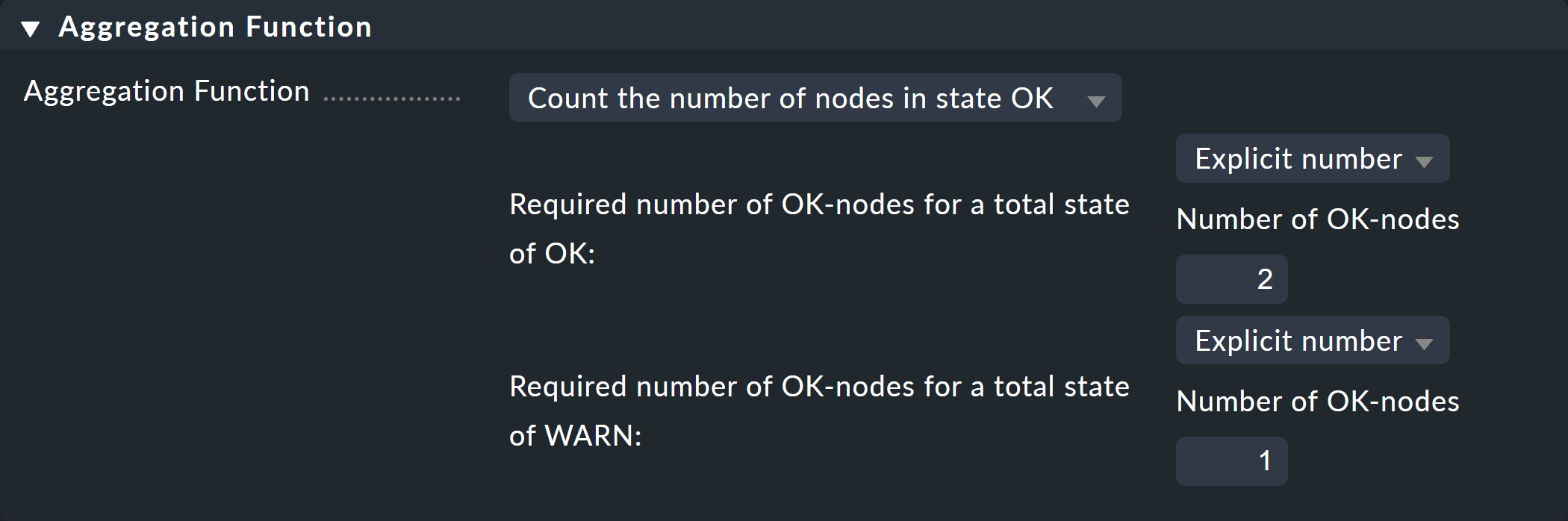

In the third and final box, Aggregation Function, you specify how the monitoring state of the node should be calculated. The basis for this is always the list of states of the subnodes. Various logical links are possible.
Pre-selected is Best — take the best of all node states. That would mean that the node becomes CRIT when all sub-nodes are CRIT or DOWN. As mentioned above this should not be the case here. Choose instead Count the number of nodes in state OK to get the number of subnodes with state OK as a yardstick. Here the numbers 2 and 1 are suggested for the thresholds. This is great because it is exactly what you need:

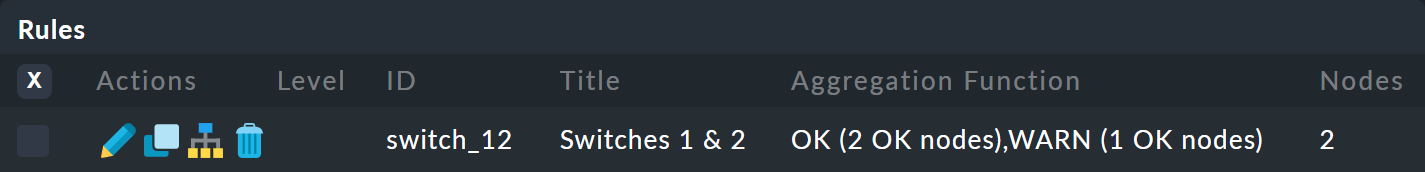

  • If both switches are UP (this is treated as OK), the node should then also be OK.
  • If only one switch is UP, the state becomes WARN.
  • And when both switches are DOWN, the state becomes CRIT.
This is how the completed form will look:
bi 2 create rule 5
With a click on Create you will have your first rule:
bi 2 create rule 6

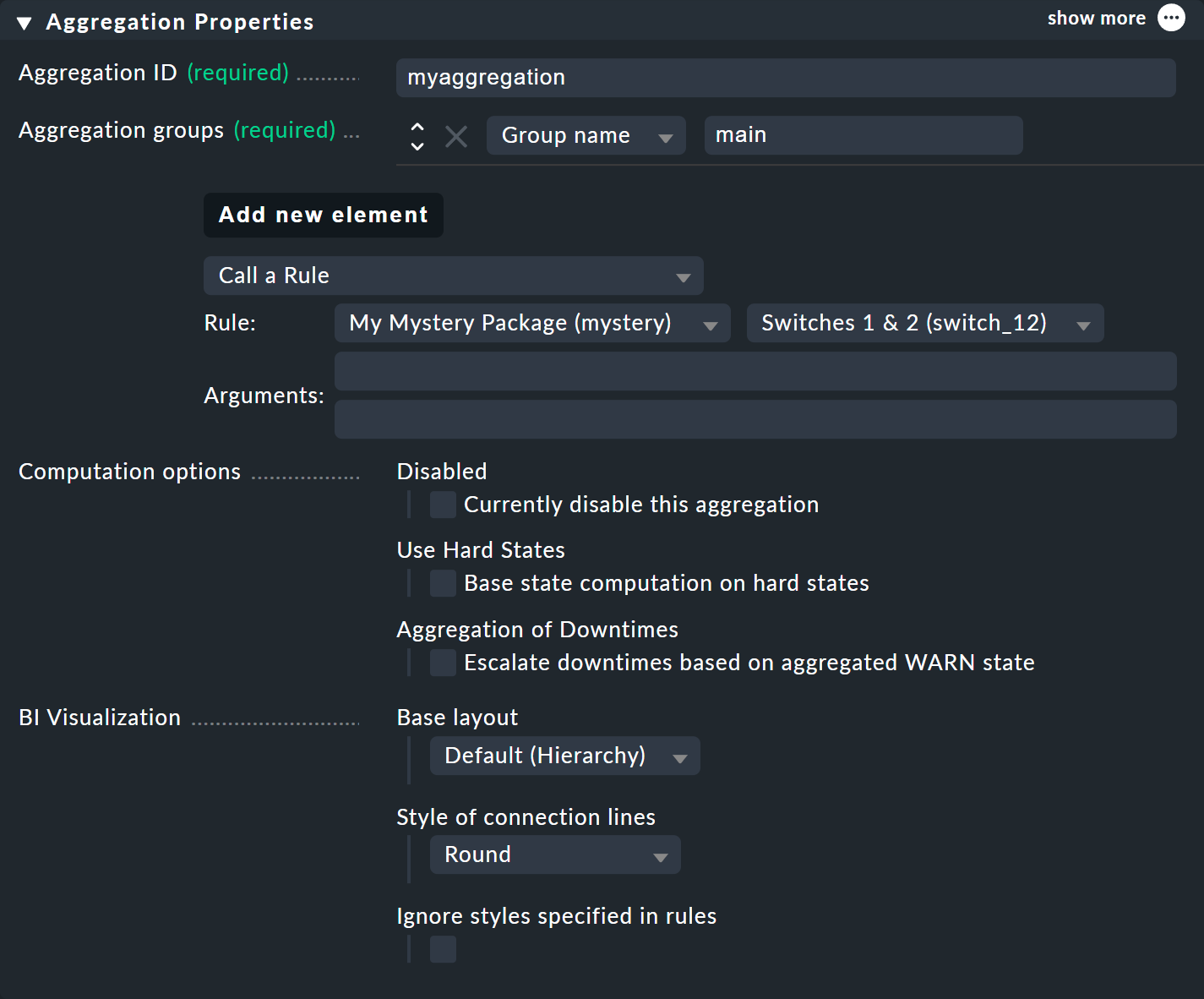

Note — it is important to understand that a rule is not yet an aggregation. Checkmk can not yet know if this is everything or just part of a bigger tree. Real BI objects will only be created and become visible in the status interface when you create an aggregation. To do this, switch to the list of The 'Aggregations' button. aggregations.

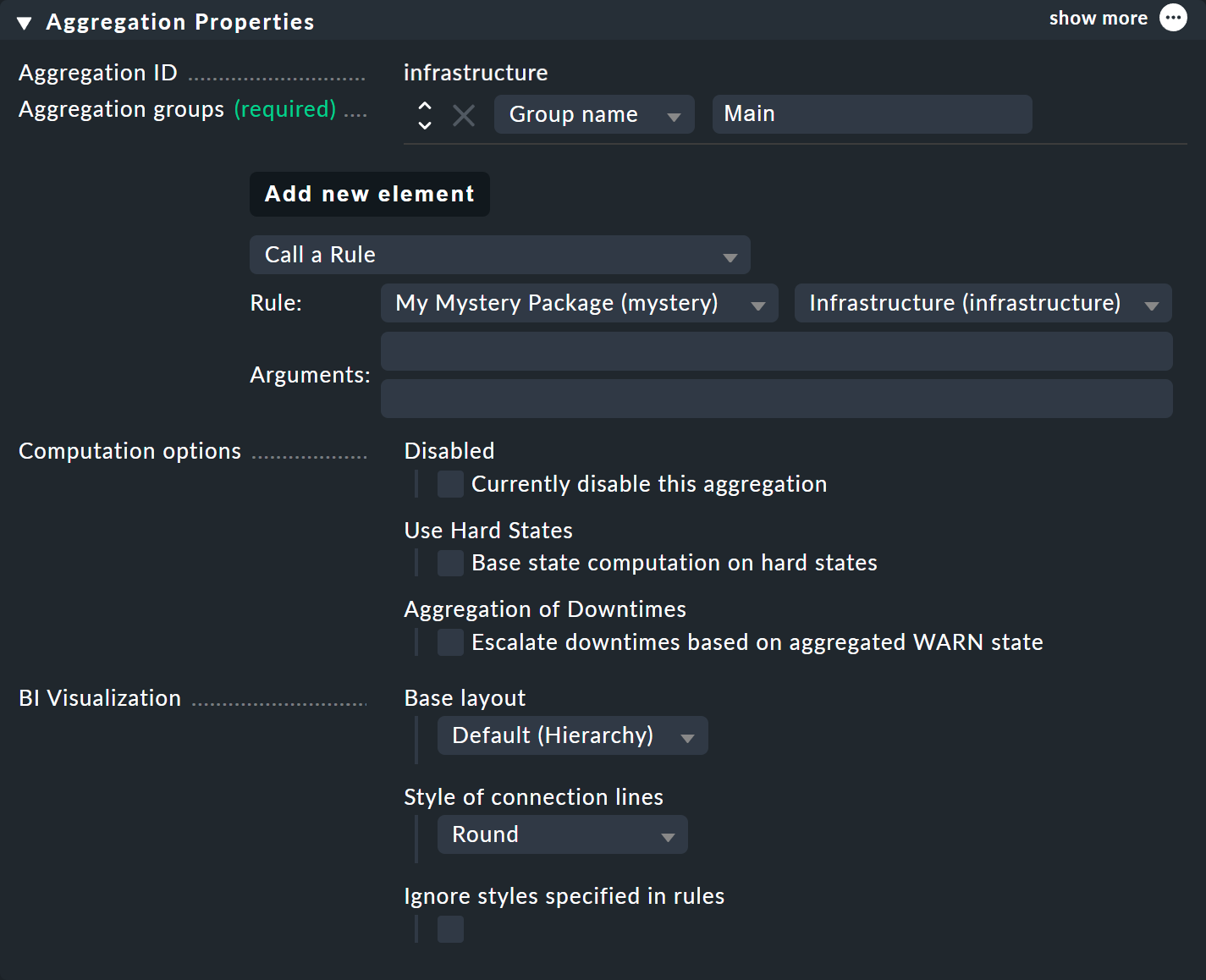

The The 'Add aggregation' button. button takes you to a form for creating a new aggregation. There is little to fill in here. In the Aggregation groups you can specify any name of your choosing. These names then appear in the status interface as groups, under which all of those aggregations which share this group name become visible. This is actually the same concept as with hashtags or keywords. You can also freely assign the Aggregation ID as usual, but cannot change it later.
You define the content of the aggregation via Add new element. Select the setting Call a rule and at Rule: the rule you just created (and before the rule package it is in).
bi 2 new aggregation
If you now save the aggregation with Icon for saving., you will be done! Your first aggregation should now appear in the status interface — assuming that you also actually have at least one of the hosts, switch-1 or switch-2.

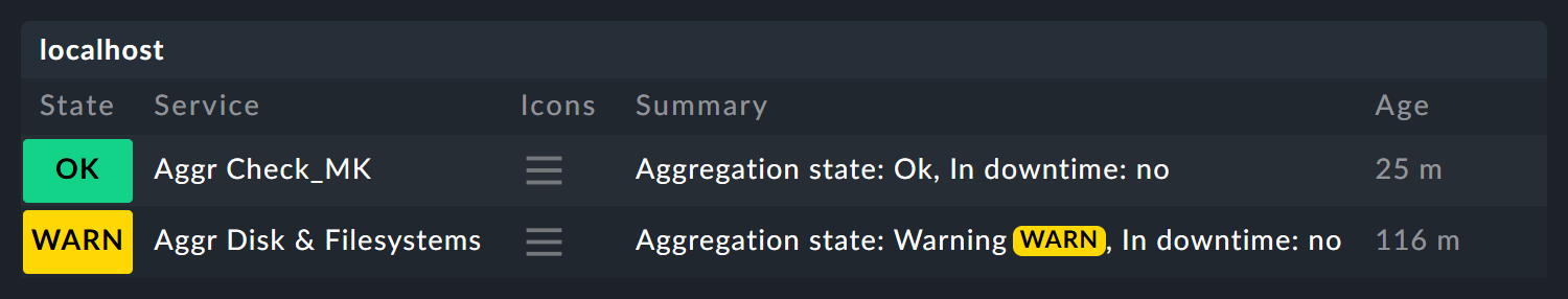

If you have done everything correctly you will now be able to see your first aggregation in the status interface. The easiest way to do this is via Monitor > Business Intelligence > All Aggregations:
bi 3 status gui 1

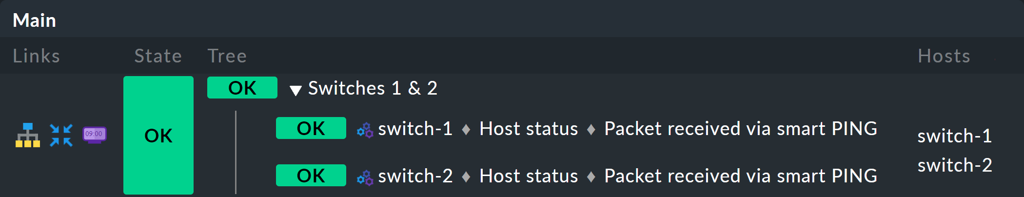

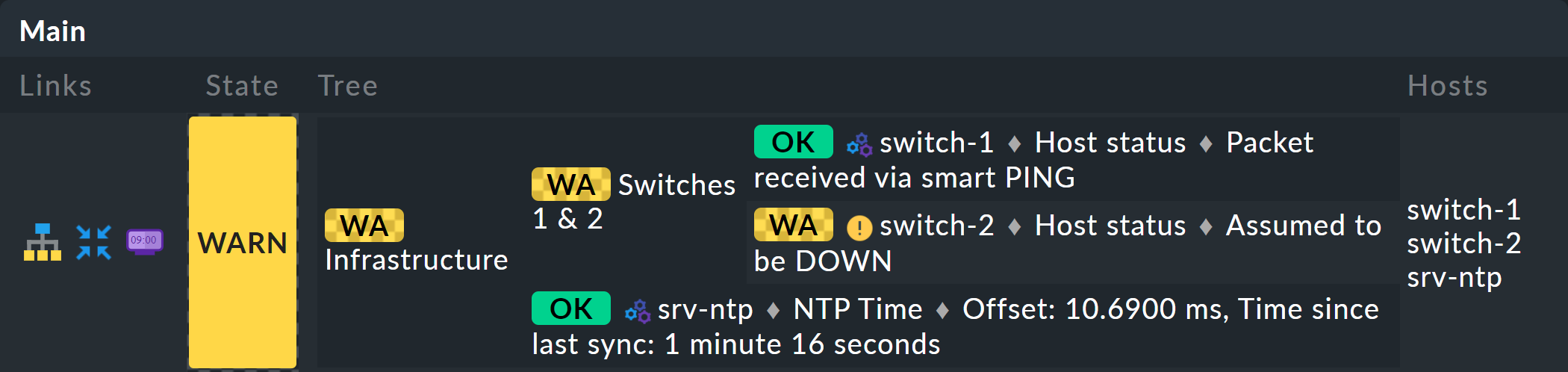

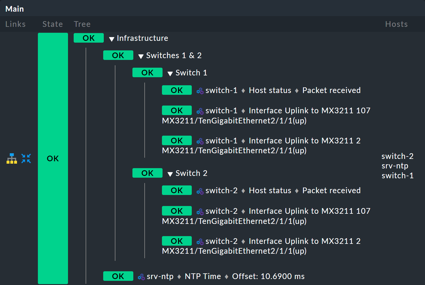

Take a closer look at the appearance of the BI tree. The following example shows your mini-aggregation in a situation where one of the two switches is DOWN, and the other UP. As desired, the aggregation enters the WARN state:
bi 3 tree minimal
You can also see that in order to standardize hosts and services, the host that is DOWN, is treated almost like a service that is CRIT. Likewise UP accordingly becomes OK.
The leaves of the tree show the states of hosts and services. The host name — and for services also the service name — is clickable and takes you to the current state of the corresponding object. Furthermore, you can also see the last output from the check plug-in.
To the left of each aggregation you will find two icons: Icon for displaying a BI aggregation. and Icon for availability.. With the first icon — Icon for displaying a BI aggregation. — you come to a page that displays just that single aggregation. This is naturally mainly useful if you have created more than one aggregation. This is, for example, well-suited as a bookmark. Icon for availability. will take you to the calculation of the availability. More on this later.

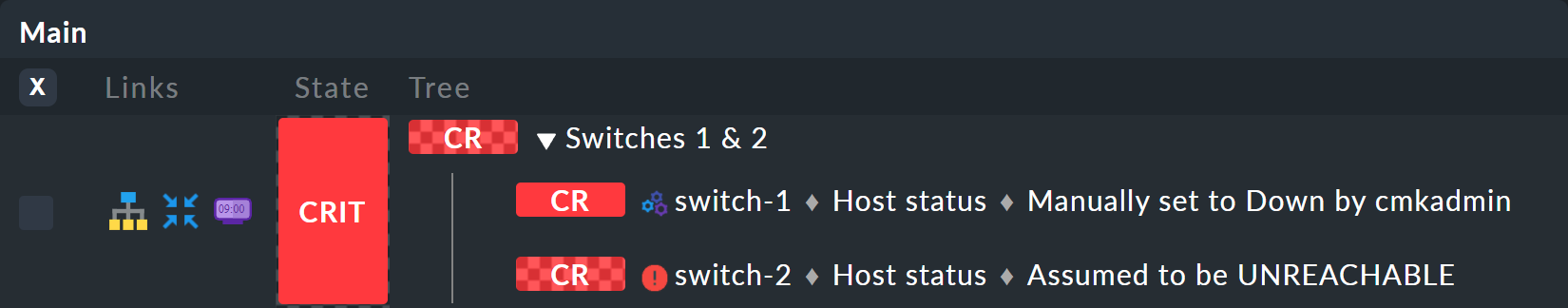

To the left of the host name you will find an interesting icon: Icon for no assumed state.. This allows a 'what if?' analysis. The idea behind this is simple: through clicking on the icon it will switch the object to another state as a test — however only for the BI interface — not for real! Multiple clicks will take you from Icon for the assumed 'OK' state. (OK) via Icon for the assumed 'WARN' state. (WARN), Icon for the assumed 'CRIT' state. (CRIT) and Icon for the assumed 'UNKNOWN' state. (UNKNOWN) back to Icon for no assumed state..
BI then constructs the complete tree based on the assumed state. The following graphic shows the minimum aggregation under the assumption that alongside switch-1 which has actually failed, switch-2 would also be DOWN:
bi 3 assume example 1
The overall state of the aggregation thereby goes from WARN to CRIT. At the same time the state’s color is backed by a checked pattern. This pattern indicates to you that the real state is actually different. This is not always the case, because some changes in a host or service are no longer relevant to the overall condition — for example, if the one in question is already CRIT.

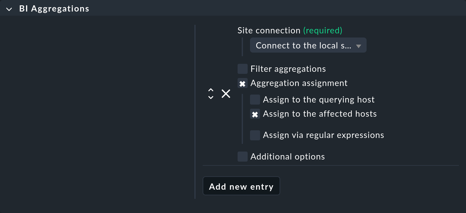

Once you have set up BI aggregations, in the context menu at your hosts and services you will find a new Icon for an aggregation. icon:
bi 3 service popup
This icon takes you to the list of all aggregations in which the affected host or service is included.

It starts with you extending the tree by one level — that is, from two levels (root and leaves) to three levels (root, intermediate level, leaves). To do this combine your existing node 'Switches 1 & 2' with the NTP time synchronization state into a top-level node 'Infrastructure'.
But one thing at a time — first of all, a preview the result:

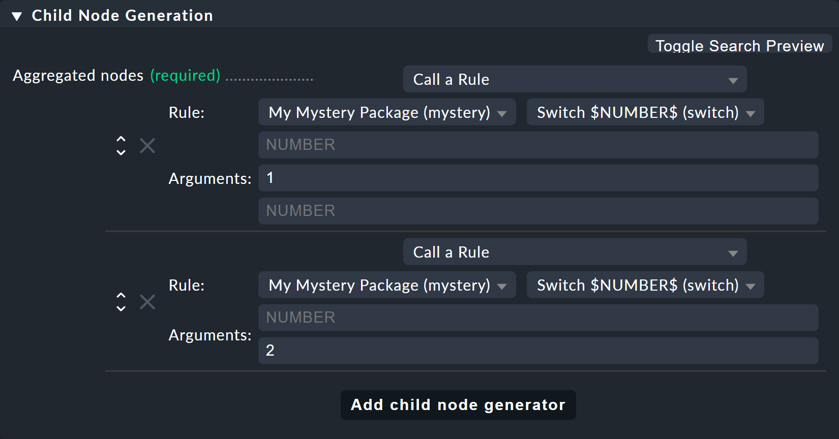

First create a BI rule which as subnode 1 receives the rule 'Switches 1 & 2', and as subnode 2 directly-receives the NTP Time service in the srv-ntp host. At the top of the rule, select infrastructure as the rule ID, and Infrastructure as its name. No more information needs to be entered at this point:
bi 4 rule infra 1

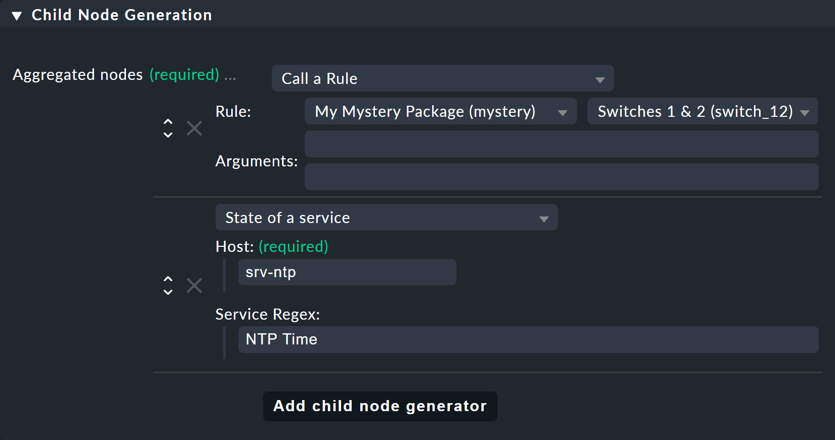

In the Child Node Generation it gets interesting. The first entry is now of the Call a rule type, and as the rule choose your rule from the above — so that you actually 'hang' these rules effectively in the subtree.
The second subnode is of the State of a service type, and here choose your NTP Time service (observe the exact spelling here, including upper and lower case characters) and the NTP Time service by regex:
bi 4 rule infra 2
This time set the Aggregation Function in the third box to Worst — i.e., take the worst state of all nodes.
In this function the state of the node is thus derived from the worst state of a service below it. In this case, if NTP Time goes to CRIT the node also goes to CRIT.

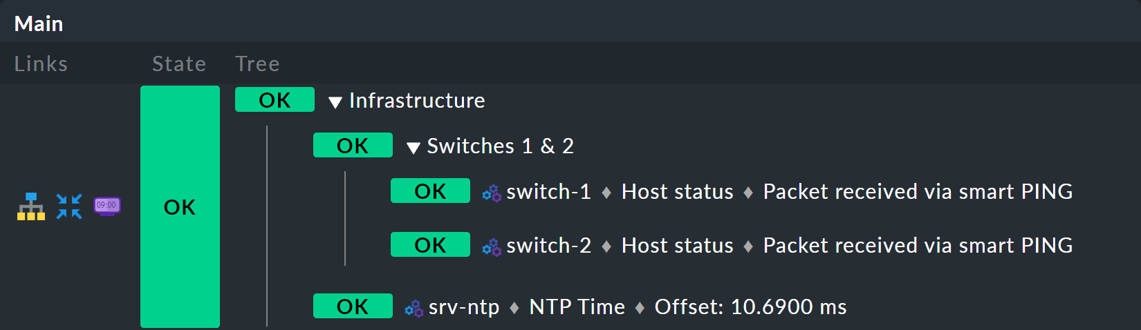

Of course to make the new, bigger tree visible, you’ll once again need to create an aggregation. It is best to simply change the existing aggregation so that from now on the new rule is used:
bi 4 rule infra 3

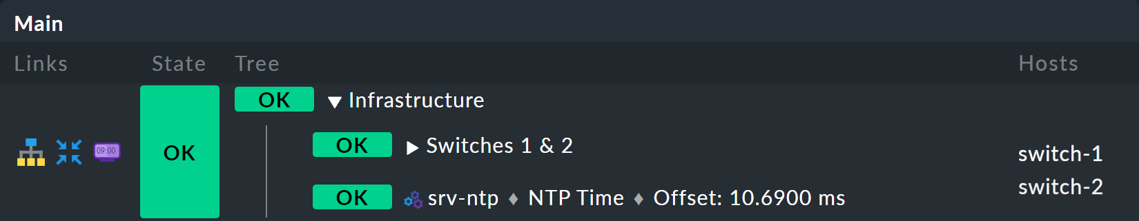

In this way you stick to a single aggregation, which then looks like as below (this time both switches are back on OK):
bi 4 rule infra 4

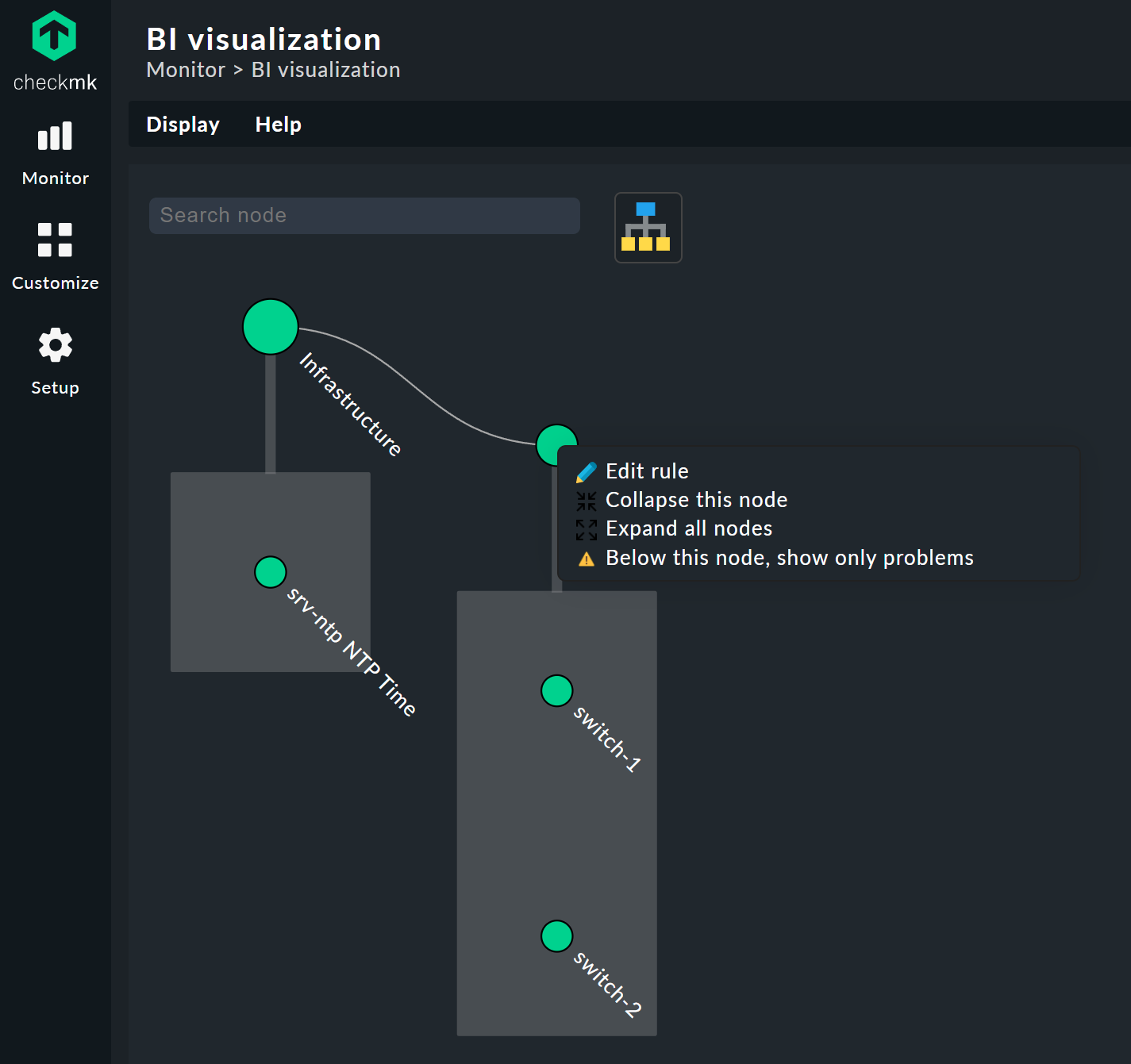

You can move the tree freely by clicking on the background, and scale the entire display using the mouse wheel. As soon as the mouse pointer is over an individual node, you get the node’s associated state information via a hover window. Use the mouse wheel to scale the length of the tree’s branches.
bi 5 visualization standard
Clicking on the leaf nodes takes you directly to the detailed views of the host or service. A right click on the other nodes — depending on the type of node — gives access to display options and, for example, the responsible rule itself — Edit rule in the below image.
bi 5 visualization context

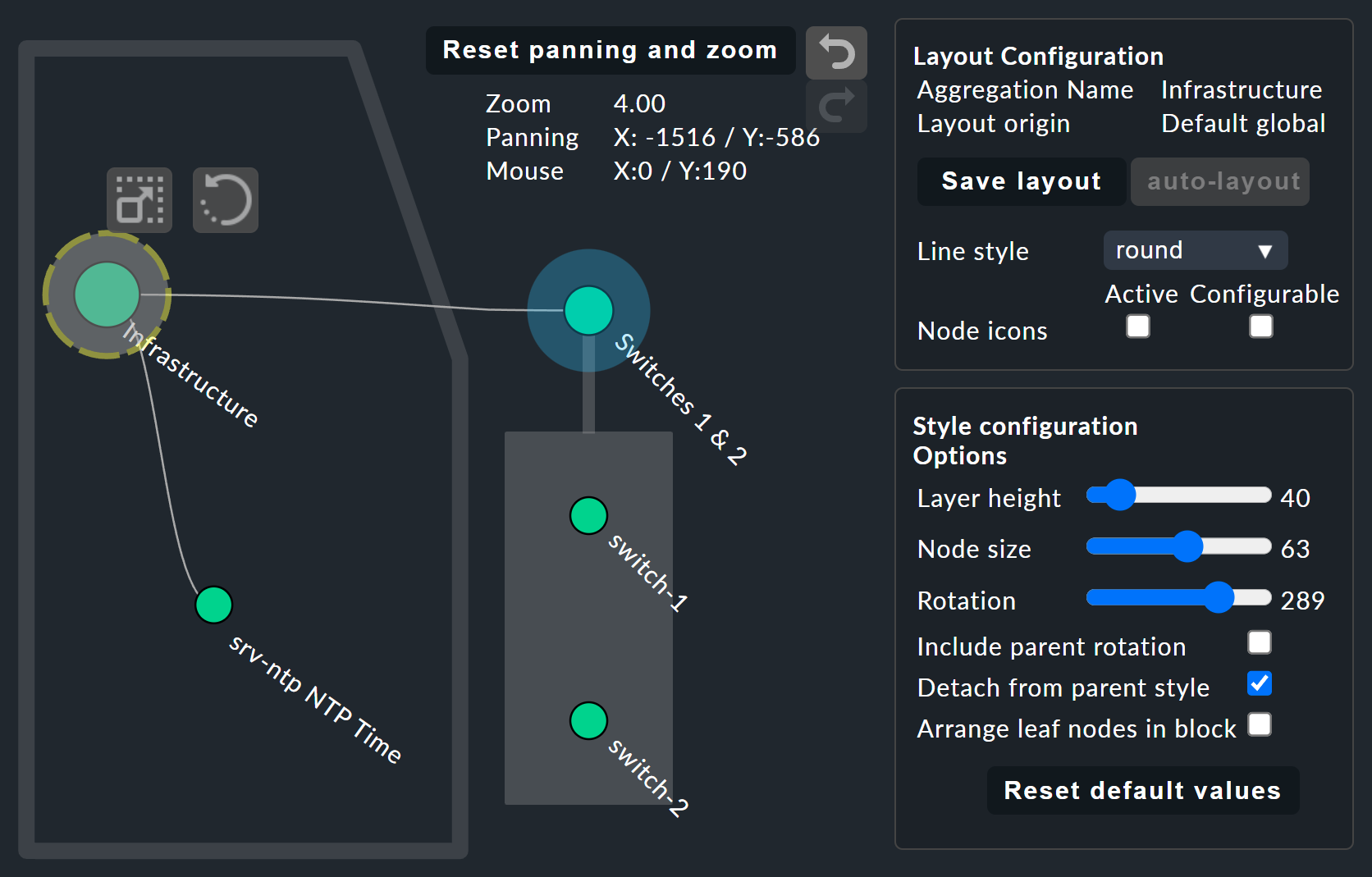

Customizing a display

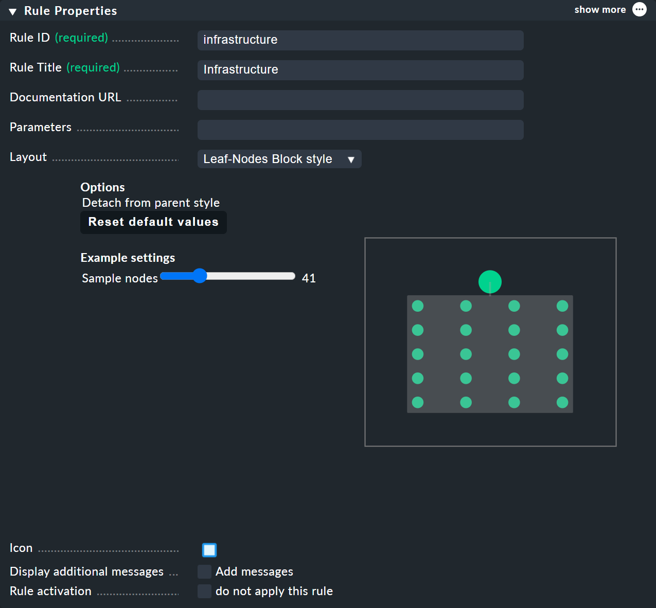

It starts getting really interesting with the Layout Designer, which is opened with Icon for an aggregation. at the top, next to the search field. First of all, you’ll see two new items — the Layout Configuration, and two new icons at the root — Icon for left-rotating. and Icon for resizing..
In a configuration you can choose between different types of line and can activate the Node icons. This will display the icons that you can specify in the rules for BI aggregations in the Aggregation Function section (this can be reached directly via the node’s context menu). Using the Icon for left-rotating. and Icon for resizing. icons the tree can be viewed, and via click & drag rotated or scaled in length and width. Further display options also appear in the Style configuration box. You can find the ones most suitable for your needs by simply trying out what is available.
bi 5 visualization designer2

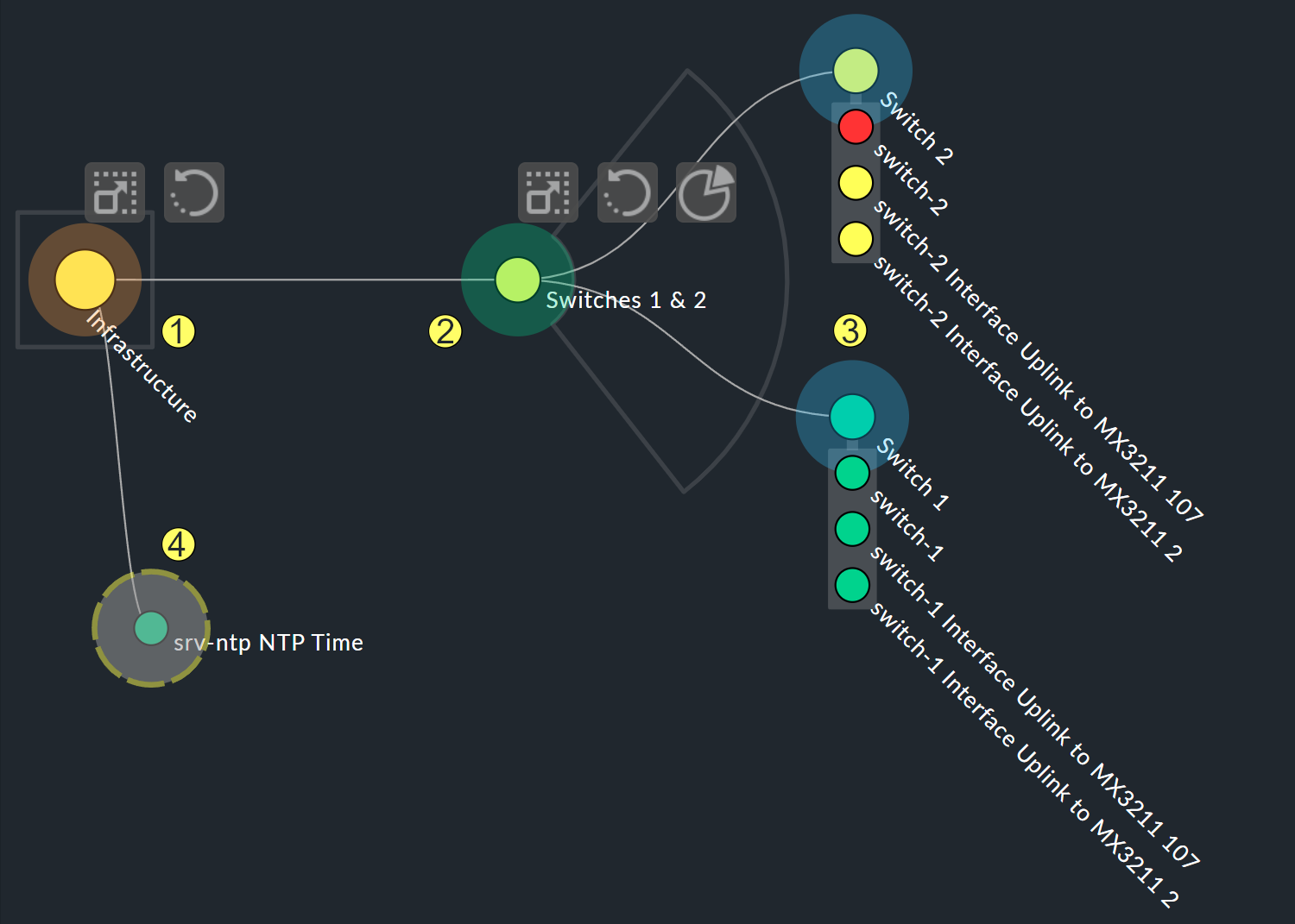

The biggest customization possibilities can be found in the nodes' context menus, which in the designer mode offer four different displays for the hierarchy from this node:
  1. Hierarchical style: The standard setting with a simple hierarchy.
  2. Radial style: A circular format with a customizable sector of a circle.
  3. Leaf-Nodes Block style: Leaf nodes are shown as a group with a gray background.
  4. Free-Floating style: A dynamic layout with options such as attraction, spacing, length of the branches.
bi 5 visualization styles
Nodes that have been assigned a style can be placed anywhere. The available options also differ depending on the style — with the Radial style, at the root node there is a third Icon for a pie chart. icon which you can use to limit the display to a sector of a circle.
With the Detach from parent style option you can detach a node’s style from the style of its higher parent node, then configure these subnodes differently and position them freely. Include parent rotation is also similarly-intended to allow you to include or exclude parent nodes when rotating.
These style options are basically all self-explanatory — only the Free-Floating style needs some explanation. This is a system of attraction and repulsion as you know it from gravitational simulations.

The following image shows a branch in the Free-Floating style — the positions of the individual leaves result dynamically depending on the options specified.

Specifying layout styles for BI rules
For BI rules — which you can access from the nodes' context menu — in the Rule Properties menu you can assign the Hierarchical, Radial or Leaf-Nodes Block layouts, and likewise set the relevant options.
bi 5 visualization rule
The search function
The search function is of enormous help with larger trees. In the Search node search field you can simply enter a part of the name of the desired node and get a list of hits directly and live. If you now use the mouse to run over this list of suggestions, the tree’s node under the mouse pointer will be highlighted by a blue border — this makes a first orientation easier. Clicking on a node in the list will center the tree there. In this way, even in displays with hundreds of nodes you can quickly find the right section in the infrastructure.
bi 5 visualization search

Let’s start with the parameters. Take the following situation: you not only want to know if the two switches are UP, but also want know the states of the two ports that are responsible for the uplink. In overall terms, this depends on the following four services:
bi 6 switch service
Now the node Switch 1 & 2 should be extended to replace the two host states for switches 1 and 2 so that each has a subnode showing the host state and the two uplink interfaces. These two subnodes should be Switch 1 or Switch 2.
In fact you will now need two new rules — one for each switch. It is better to do this by creating a new switch rule, and equip it with a parameter. This parameter is a variable that you call when you call the rule from the parent node — which here can be provided by the old Switch 1 & 2 rule. In this example you can simply pass either a 1 or a 2. The parameter gets a name which you can choose freely. Take here, for example, the name NUMBER. The spelling with capital letters here is purely arbitrary, and if you find lowercase letters more beautiful you are also free to use these.
The rule’s heading will then look like this:
bi 6 rule with parameter
You can choose switch as the ID for the new rule. At Parameters simply enter the name of the variable: NUMBER. Also important now is that the variable is used in the rule’s Rule Title so that both nodes are not just called switch and thus have the same name. When using the variable a leading and trailing dollar sign is set — as is usual at many places in Checkmk. As a result the two nodes will then be called Switch 1 and Switch 2.
Prefix match is the default for service names
For the Child node generator, the first thing to do is to insert the host state. Instead of the 1 or 2 in the host name you may simply use your variable, again each with a leading and trailing $.
The same thing happens with the host names of the uplink interfaces. And here comes the second trick — because as you might think from the small service list seen above, the services for the uplink are named differently at each switch. But that is no problem, because BI always interprets the service name as a prefix match using regular expressions — completely-analogous to the well-known service rules. So by simply writing Interface Uplink, you catch all of the services on the respective host which start with Interface Uplink:

Now modify the old Switch 1 & 2 rule so that instead of the host states this new rule is only ever invoked once for each of the two switches. And here is also where the values 1 and 2 are provided as the parameters for the variable NUMBER:
bi 6 rule with parameter 3
And voilà — you now have a pretty tree with three levels:
bi 6 rule with parameter 4

The resulting child-node generator will look like this:
bi 6 mystery server rule
What follows is remarkable:
  • The host name srv-mys-$NUMBER$ will use the number from the parameter.
  • With Service Regex, the sophisticated regular expression CPU|Memory which uses a vertical bar to allow alternative service names (prefixes) is used, and this matches all services that begin with CPU or Memory. This saves a doubling of the configuration!
Incidentally, this example is of course not necessarily perfect. For example, the state of the host itself has not been recorded at all. So if one of the servers goes DOWN, the services on this will become obsolete (go stale), but the state will remain OK, and the aggregation will not 'notice' that failure. If you want to know something like that, you should in any case record the state of the host as well as the states of its services.

This rule is interesting — it summarizes the two mystery servers together into a node. Now it should be possible that the number of servers is not fixed, and later there can sometimes be three or more, or it could be that there are dozens of sites in the mystery application — each with a different number of servers.
The trick is in the child node generator type Create nodes based on a host search. This searches for existing hosts and creates nodes based on the hosts found. It looks like this:
bi 6 mystery server rule2
The whole thing works like this:
  1. You formulate a search condition to find hosts.
  2. A child node is created for each host found.
  3. You can cut parts out of the found host names and provide these as parameters.
Finding is the beginning. As usual there are host tags available. In the example you can omit this and instead use the regular expression srv-mys-(.*) for the host name. This matches to all host names starting with srv-mys-. The .* stands for any string.
It is important that the .* is bracketed, thus (.*). By using the parentheses the match forms a so-called group. With this the text which exactly matches .* is captured (and stored) — here 1 or 2. The match groups are numbered internally. Here there is only one that receives the number 1. You can then later access the matched text with $1$.
The search will now find two hosts:
Host name Value for $1$
srv-mys-1
1
srv-mys-2
2
For each host found you will now create a subnode with the Call a rule function. Select the rule Mystery Server $NUMBER$ which you just created. As the argument for NUMBER now pass the match group: $1$.
Now the sub-rule Mystery Server $NUMBER$ is called twice — once with 1 and once with 2.
If in the future a new server with the name srv-mys-3 is added into the monitoring, this will automatically appear in the BI aggregation. The state of the host does not matter. Even if the server is DOWN, it will of course not be removed from the aggregation.
Granted, it is a very steep learning curve here. This method really is complex. But once you have tried it and understood it, you will realize just how powerful the whole concept is — and so far we have only scratched the surface of the available possibilities!

The new top-level node The Mystery Application is now simple: a new rule which has two child nodes of the Call a rule type is additionally necessary. These two rules are the existing Infrastructure rule, and the just newly-created Mystery Servers rule.
Similar to the host search, there is also a child generator type called Create nodes based on a service search. Here is an example:

The first rule is the rule for the root of the tree. The Icon for an aggregation. icon for this rule takes you to a tree view. Here you can see how the rules are nested among each other:
bi 7 host tree tree
Back in the list of rules, with the The 'Aggregations' button. Aggregations button you can access the list of aggregations in this rule package — which consists of only one aggregation. In the Icon for editing. Details simply uncheck the checkbox at Currently disable this aggregation and immediately get, per host, an aggregation titled Host myhost123. The result will then look like this, for example:
bi 7 host aggregation

Again, back to the rule packages. For all editing actions in BI you usually need to have the administrator role. More precisely, for BI there are two permissions, to be found under Setup > Users > Roles & permissions:
bi 8 wato permissions
In the normal monitoring user role, only the first of the two permissions is active by default. Normal monitoring users can therefore only work in such rule packages for which they have been defined as a contact. This is done in the Icon for editing. Details of the rule package.
In the following example Permitted Contact Groups the The Mystery Admins contact group has been authorized — thus all members of this group can now edit the rules in this package:
bi 8 pack properties
By the way, with Public > Allow all users to refer to rules contained in this pack you can allow other users to at least use the rules contained here — i.e., to (elsewhere) define their own rules — which can then invoke these rules as subnodes.

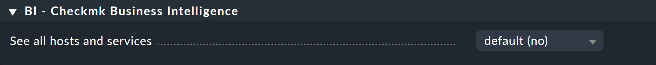

Well, you cannot assign any permissions in the BI aggregations themselves. This is performed indirectly through the visibility of the hosts and services, and it is governed by the See all hosts and services option under Setup > Roles & Permissions:
bi 8 see all
In the User role, this permission is by default disabled. Normal users can see only shared hosts and services, and in BI these are expressed in such a way that they can see exactly all of the BI aggregations which contain at least one shared host or service. Such aggregations however contain only these authorized objects, and they may therefore be somewhat 'thinned out'. And this in turn means that they can have different states for different users.
Whether that is good or bad depends on what you want. If in doubt you can toggle the permission, and through a detour via BI allow some or all users to see hosts and services for which they are not contacts — and thus ensure that the state of an aggregation is always the same for everyone.

To understand with which rule BI calculates the 'in downtime' state, it helps you to be reminded about what the real idea behind scheduled downtimes is: The object in question is currently being worked on. Failures can be expected. Even if the object is currently OK, you should not rely on it. It can become CRIT at any time. This is known and documented — it should therefore not trigger a notification.
This idea can be transferred 1:1 into BI: In the aggregation there may be a few hosts and services that are currently in downtime. Whether these are just OK or CRIT does not play a role, because it is actually a coincidence if during the maintenance work the objects sometimes go off and on again, or not. Just because there is a downtime object in the aggregation it does not immediately mean that the application that maps the aggregation is itself 'threatened' and must also be marked as 'in downtime'. The application can also have an installed redundancy which compensates for the failure of the objects in downtime. Only if such a failure would actually lead to a CRIT state for the aggregation — so there is not not enough redundancy and the aggregation really is threatened — only then will Checkmk mark it as 'in downtime'. Where here as well the current state of the objects generally does not matter.
To put it more concisely, the exact rule is as follows:
If a CRIT state of a host/service would result in a CRIT state of the aggregation, an 'in downtime' state of that host/service results in an 'in downtime' state for the aggregation.
Important: the real current state of the hosts/services plays no role in the calculation — what is in downtime is assumed to be CRIT in the BI logic. Why? Because an UP or OK state during a scheduled downtime is pure coincidence, for example if a host reports UP for a few seconds in between several restarts.
And here we have another example. To save space, this is a variant with only one mystery server instead of two:
bi 9 downtimes
First, the host switch-1 is in downtime. For the Infrastructure node this has no effect, because switch-2 is not in downtime, and thus Infrastructure is also not in downtime. There is therefore no Icon of a scheduled downtime derived from the host. icon for derived downtimes.
But, the service Memory on srv-mys-1 is also in downtime. This one is not redundant. The downtime is therefore inherited by the parent node Mystery Server 1, and then continues up to Mystery Servers, and finally to the top node The Mystery Application. This top node will therefore also be in downtime.

Here is an example: A switch with 6 ports should be OK when 5 of its services/ports are OK. However, as part of a firmware update, 2 of the ports are renamed and their associated services disappear from the monitoring.
The aggregation would then consist of 4 services with the OK state, but the aggregation itself would be WARN or CRIT — without providing any indication of the reason. This is exactly where frozen aggregations come in: You freeze the current state, and later you can click to list what has changed since then, i.e. which nodes have been added or dropped out. In other words, while the rules of an aggregation indicate its state, frozen aggregations provide information on state changes.

You can use the special agent BI Aggregations for this. You will find the appropriate rule set under Setup > Agents > Other integrations > BI Aggregations. First create a new entry in the BI Aggregations box with Add new entry.
bi 12 datasource program
Here you can specify different options for which hosts the services should be added. They do not necessarily have to be attached to the host to which the special agent is assigned (Assign to the querying host). It is also possible to assign to the hosts which are included in the aggregation (Assign to the affected hosts). That however only makes sense if it concerns only a single host. Regular expressions and substitutions can make you even more flexible with assignments. The whole thing is then performed via the piggyback mechanism.
Important: If the host to which you assign this rule should continue to be monitored through the normal agent, ensure in its settings that agent and special agents are run:
bi 12 agent and all ds program
The new service then shows — with a delay of up to one check interval of course — the state of the aggregation. Here are two examples of new services, automatically supplemented by the prefix Aggr:
bi 12 active check output 2
As usual you can assign this service to contacts and use it as a basis for notifications.
