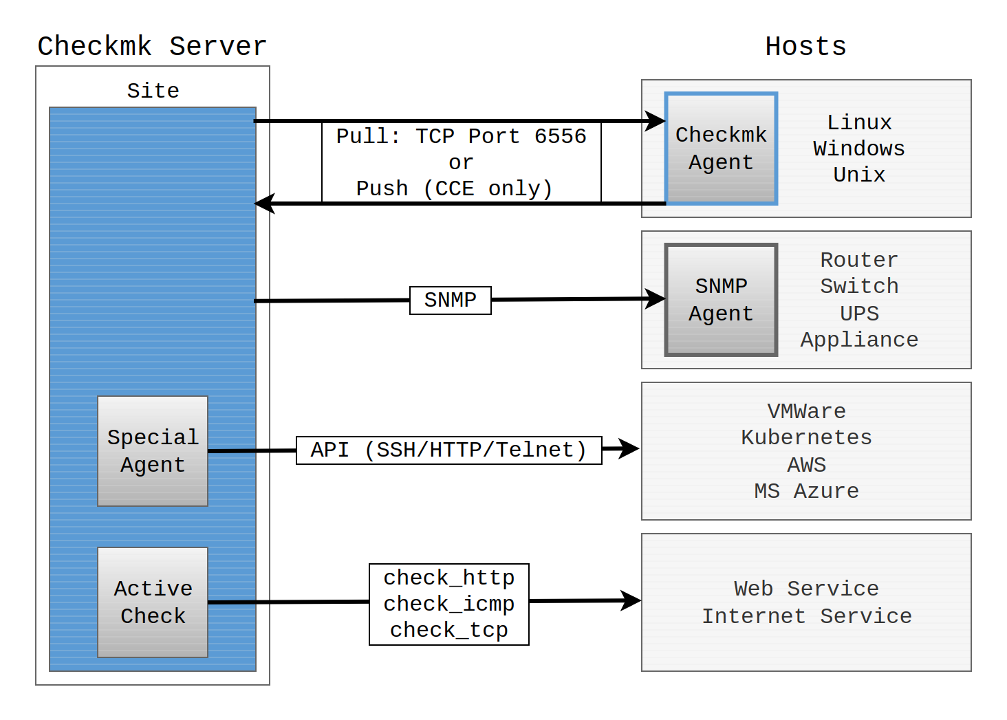

The following image shows the various ways that Checkmk can access systems to be monitored:
Illustration of the ways Checkmk accesses monitored systems.

For the monitoring of a server or workstation, you need a small program that must be installed on the host: the Checkmk agent.
This agent is a simple shell script that is minimalist, secure and easily extendable. The Agent Controller, which handles transport encryption, authentication and compression, is located upstream of the agent script. In order to establish a mutual trust relationship, the controller registers itself with the Agent Receiver, which runs on the Checkmk server. The Agent Receiver is also — as its name suggests — the component on the Checkmk server that receives the agent output.
Illustration of the communication between an agent and a site.
Interaction of the software components
This architecture is identical in the Linux agent and the Windows agent, and only the technical implementation is specific to each operating system.
The agent script is responsible for collecting the monitoring data and making it available to the Agent Controller. This script is:
  • minimalist, because it utilizes minimal RAM, CPU, disk space and network resources.
  • secure, because it does not allow any access from the network.
  • easily extendable, because you can write plug-ins in any programming or scripting language and have these executed by the agent script.
The Agent Controller is the agent component responsible for transporting the data collected by the agent script. In pull mode, it listens on TCP port 6556 for incoming connections from the Checkmk site and queries the agent script.
The software architecture of the agent with the Agent Controller is the prerequisite for offering new functions, that could not have been achieved with the minimalist design of the agent script, such as encryption of the communication via Transport Layer Security (TLS), data compression and the reversal of the communication direction from pull mode to push mode.
In the pull mode, the Checkmk server initiates the communication and requests the data from the agent. In the push mode, the initiative comes from the agent. Push mode is required for a cloud-based configuration and in some compartmentalized networks. In both cases, the Checkmk server cannot access the network where the hosts to be monitored are located. The agent therefore automatically transmits the data to the Checkmk server on a regular basis.
The Agent Receiver is the Checkmk server component that serves as the general endpoint for the communication of the Agent Controller, e.g. for registering the connection and for receiving the data sent by the Agent Controller in the push mode. In the push mode, the received data is stored by the Agent Receiver in the file system and is thus made available to the site’s fetchers. in the commercial editions these are the Checkmk fetchers. In contrast, in the pull mode, the data exchange takes place directly between the site’s fetchers and the Agent Controller without requiring an Agent Receiver.
TLS encryption and data compression are achieved via the Agent Controller and the Agent Receiver. The first step after the installation is the registration of the Agent Controller with the Checkmk site’s Agent Receiver, which establishes a trust relationship between these two components. The TLS encryption of the communication will be configured during this registration.

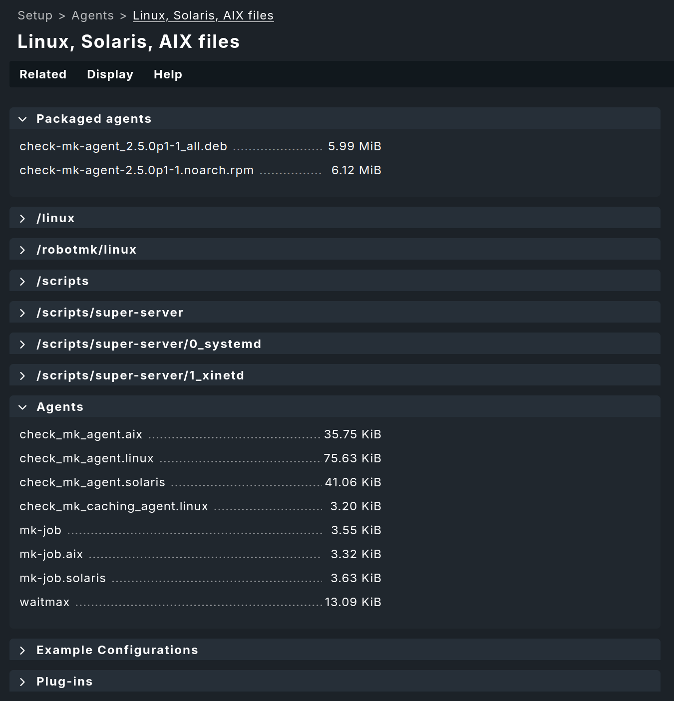

The packaged agents for Linux (in RPM and DEB file formats) and for Windows (in MSI file format) are found right in the first box of the corresponding download page. In these software packages you will find the agent with Agent Controller. The installation and configuration is described in detail in the articles on Linux agents and Windows agents.
In the Agents box you can find the appropriate agent scripts for the various operating systems. For operating systems on which the agent must be set up in the legacy mode (i.e., without an Agent Controller), there are the articles on Monitoring Linux in legacy mode and Monitoring FreeBSD.

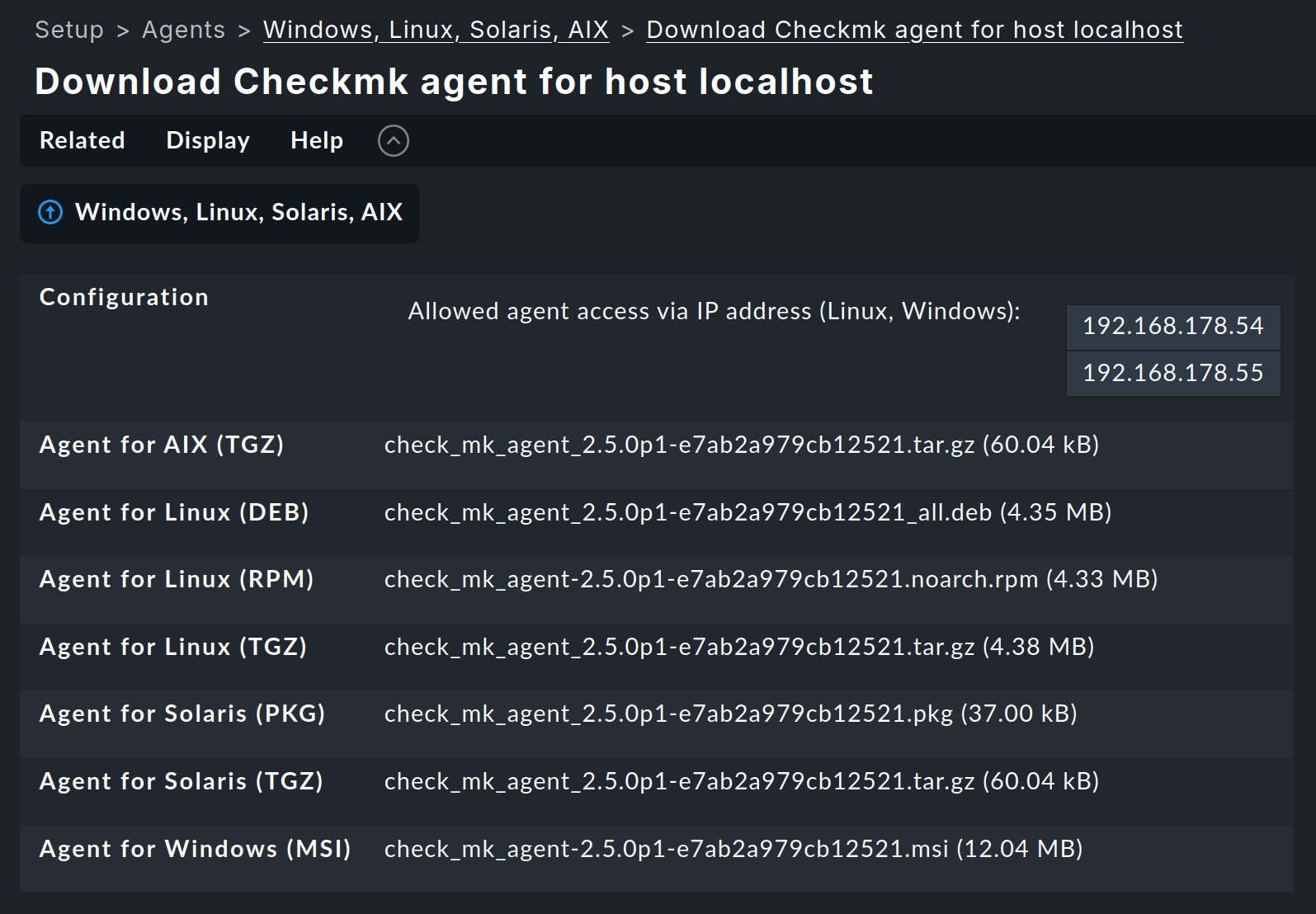

4.2. Downloading the agent

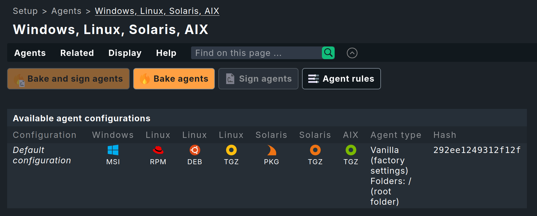

You can access the Agent Bakery via Setup > Agents > Windows, Linux, Solaris, AIX:
Entry page to the Agent Bakery.
In the Agent Bakery, you can download agent packages
Checkmk supports Windows, Linux, Solaris and AIX operating systems with the Agent Bakery. For Linux you have a choice between the package formats RPM (for Red Hat Enterprise Linux (RHEL) based systems, SLES) and DEB (for Debian, Ubuntu), as well as a so-called 'tarball' in the TGZ file format that is simply unpacked as root under /. Likewise, a tarball is available for AIX, however this does not include automatic integration into the inetd. The integration must be performed manually as a one-off action. For Solaris there is again the tarball and a PKG package.
If you have not yet made any settings for specific hosts, there is only one default agent configuration. An explanation of the various possible agent configurations will be provided in the next two sections.
Every agent configuration has an explicit ID: its hash. A hash’s first eight characters are displayed in the GUI. This hash will be a part of the package version and embedded in the package file name. Whenever you change something in a package’s configuration or update Checkmk, the package’s hash will also be changed. In this way the operating system’s package manager recognizes that it is a different package and perform an update. Checkmk’s version number would not suffice to distinguish here.
Baked packages for Linux and Windows are installed in the same way as the packages available on the Checkmk download page.

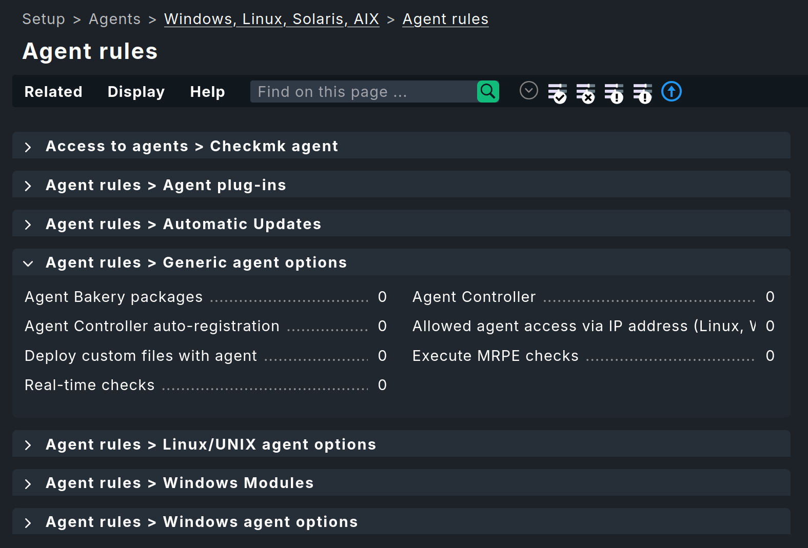

4.3. Configuration using rules
The agent’s configuration can be altered — as is so often the case in Checkmk — via rules. These offer you the possibility of equipping different hosts with differing settings or plug-ins. The Agent rules button takes you to a page which lists all of the rule sets that affect the agents:
List of rules for the agents.

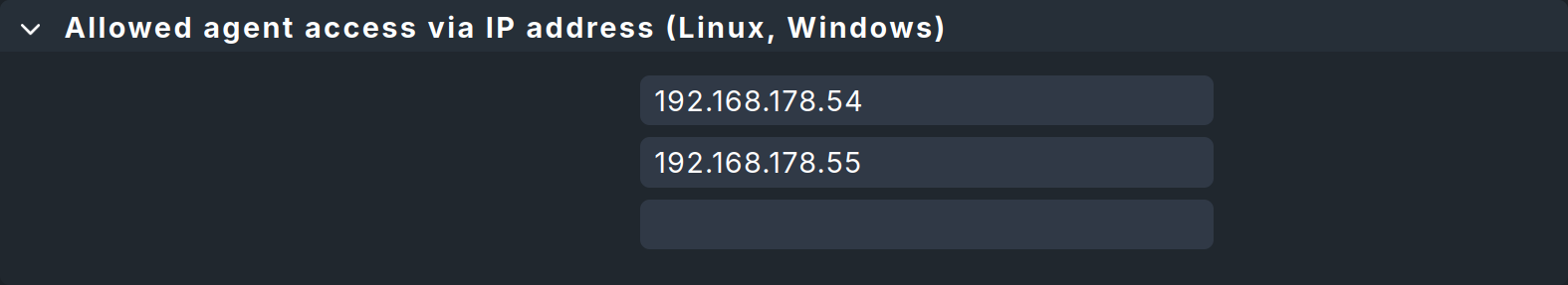

Let’s take the following example: you wish to limit the list of IP addresses that are permitted to access the agent. For this you select the Generic agent options > Allowed agent access via IP address (Linux, Windows) rule set. Enter one or more IP addresses as the rule’s value:
Rule to restrict IP addresses to access the agent.
Leave the default values in the Conditions box unchanged so that this rule applies to all hosts. Save the new rule.
4.4. The agent configurations

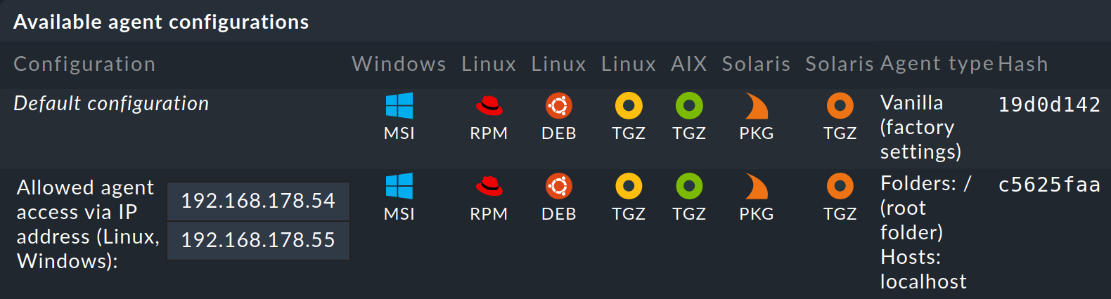

After saving, go back to the Windows, Linux, Solaris, AIX page. The Icon for baking the agents. button ensures that the agent will be freshly-baked. The result — you now have two individual configurations:
List with two agent configurations to download.
In the Agent type column you can read which hosts the respective configuration is assigned to.
Vanilla (factory settings)
The agent packages contain only the default configuration and thus no single agent rule.
Folders
The agent packages contain all agent rules in which no conditions are defined for hosts and which apply to the listed folders.
Agent packages are created specifically for a folder if the attribute Bake agent packages is set to Bake a generic agent package for this folder in the Folder properties. This attribute applies only to the folder and is not inherited.
This entry is useful for creating agents for hosts that do not yet exist in Checkmk. The folder can even be empty to create hosts automatically there later. By default, agent packages are only created for the Main (or root folder).
Hosts
The agent packages contain all of the agent rules that apply to the hosts in the the list.
For the example shown above, the Allowed agent access via IP address (Linux, Windows) rule was created without conditions for hosts. The new agent configuration therefore applies to the Main folder and to localhost, currently the site’s only host.
The more host-specific rules you deploy, the more different variants of agents will be built. The Agent Bakery takes care to build only those configurations that are used by at least one of the existing folders or hosts.
By the way, you can also access a host’s agent packages conveniently via the host’s properties by clicking on the host in Setup > Hosts > Hosts and selecting Monitoring agent in the Hosts menu:
List of agents for a host to download.

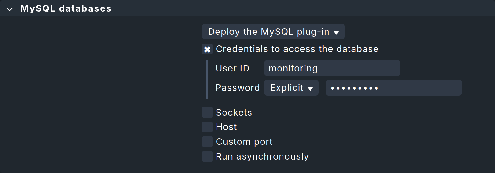

4.5. Extending via plug-ins
Many agent rules are concerned with the installation of various plug-ins. These extend the agent for the monitoring of quite specific components. Most of these are special applications such as databases, for example. Alongside the rule that activates a plug-in you will also find the settings for configuring the plug-in. Here, for example, is the MySQL databases rule for monitoring MySQL:
Rule for the MySQL plug-in of the agent.

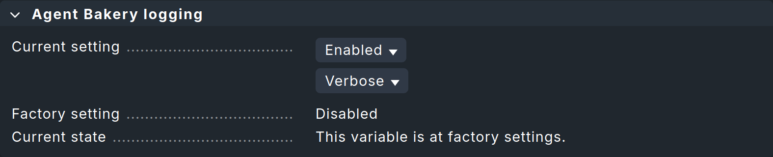

4.7. Activate logging
In the global settings you can enable logging for the bakery processes under Agent Bakery logging. The results can be found in the file ~/var/log/agent_bakery.log.
Option to enable bakery logging.
Without logging enabled, you will only see this information if you bake agents with cmk --bake-agents -v on the command line.

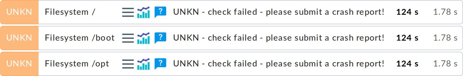

In order for this to be possible a general rule applies in Checkmk: Newer versions of Checkmk can basically handle the output of older agents.
Important: the reverse is not necessarily true. If an agent’s Checkmk version is newer than that of the monitoring server it is possible that the check plug-ins there cannot interpret the agent’s output correctly. In such a case the affected services go into an UNKNOWN status:
List of services in UNKNOWN status due to a failed check.
Even if the output in the above image suggests otherwise, please do not send a crash report in such a case.

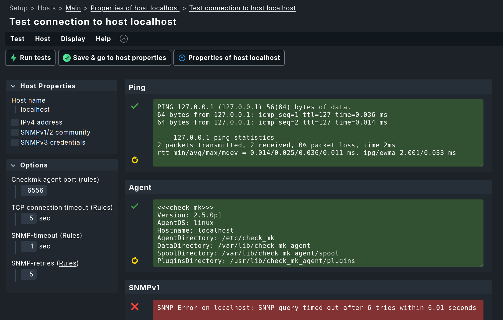

6.2. Testing the agent via the web interface
You can also conduct a diagnosis of the agent via the web interface. This takes all settings into consideration and also supports SNMP devices and those queried using special agents. In effect, Checkmk always attempts to query via TCP port 6556 and SNMP simultaneously.
You can access the connection test via the host properties: On the Properties of host page, select Host > Test connection from the menu, and start the test by clicking Run tests:
Result of the connection test to a host.
You can try out quite a few of these settings (for example, the SNMP community) right away, and save them when successful.
