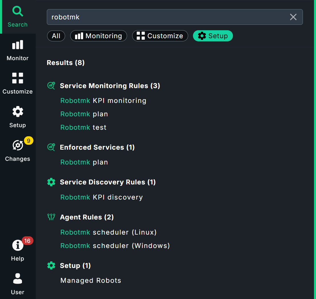

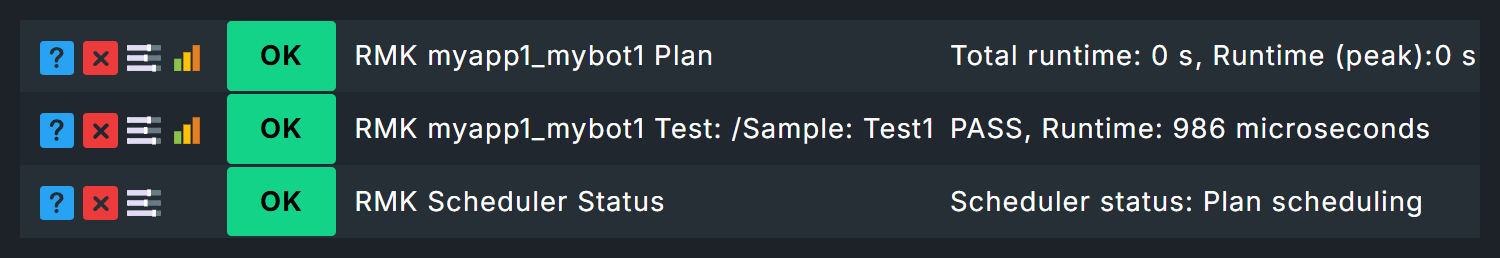

In the monitoring, a number of new services will be generated: RMK Scheduler Status shows the status of the scheduler itself, i.e. whether test suites could be started successfully. There are also services for all configured test plans (such as RMK MyApp1 Plan) and individual tests from test suites (such as RMK MyApp1 Test). The services of the individual tests also include the original Robot Framework reports.
Then there are two optional service rules: Robotmk plan and Robotmk test provide for fine-tuning the plan and test services — for example, to effect status changes at certain runtimes.

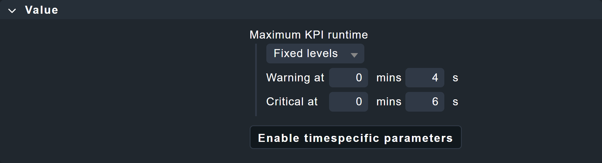

Last but not least, there are two rules for KPI monitoring: KPI stands for Key Performance Indicator and in this context means individual keywords. Using the Robotmk KPI discovery rule, keywords can be brought into the monitoring as separate services and evaluated accordingly via Robotmk KPI monitoring. We will show you exactly how keyword monitoring works in a separate chapter below.
Somewhat apart from the normal rules, there is also the Managed robots feature in the Setup area. The short version: Robots that are managed on the Checkmk server and deployed via the Checkmk agent — again, a separate chapter is available for more details on this.
Robotmk rules in the Setup menu.
The Robotmk rules in Checkmk

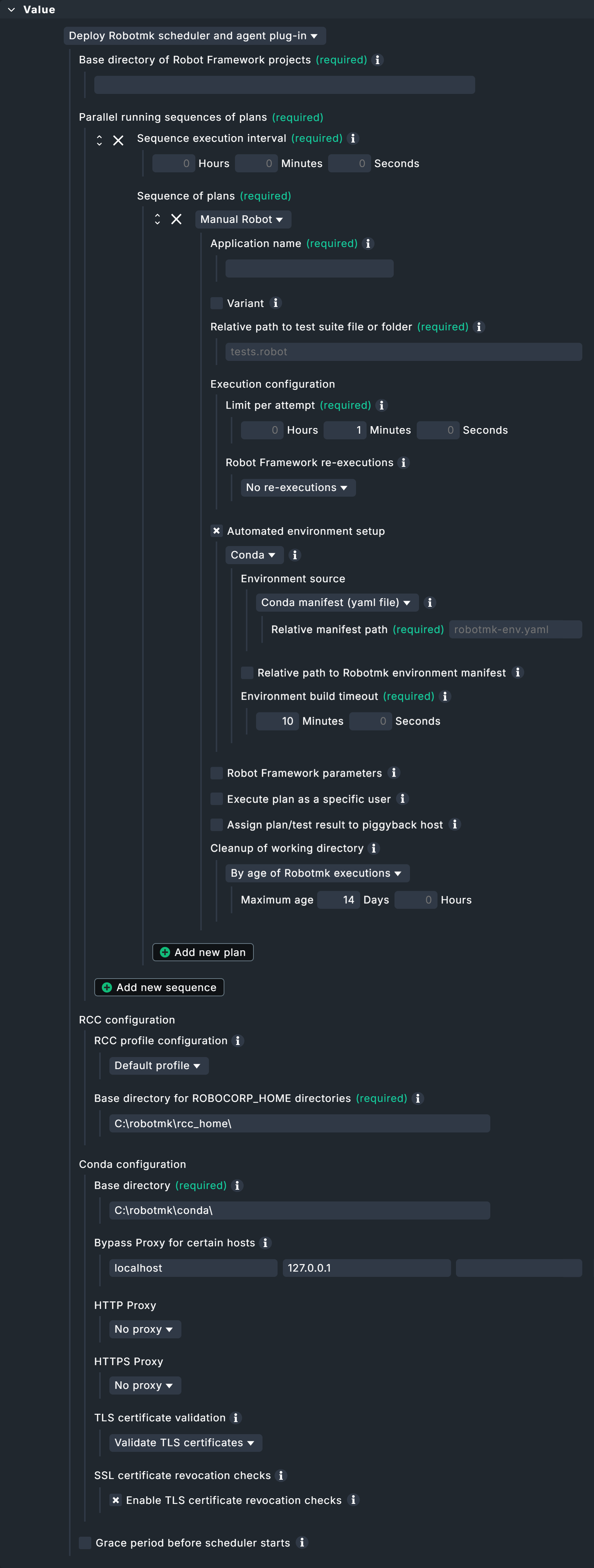

2.2. Configure a rule for the agent plug-in

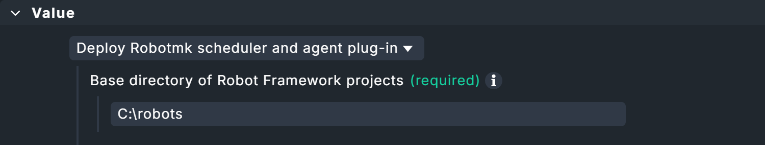

You can find the Robotmk scheduler under Setup > Agent rules > Robotmk scheduler (Windows). As the rule is quite extensive, here is a look at the empty configuration:
Empty Robotmk scheduler rule.
Configuration of the agent plug-in
First, the scheduler requires the base directory in which all your test suites are located. Enter this arbitrary, explicit file path under Base directory of suites, for example C:\robots.
Path for test suites.
Base directory for all Robot Framework projects

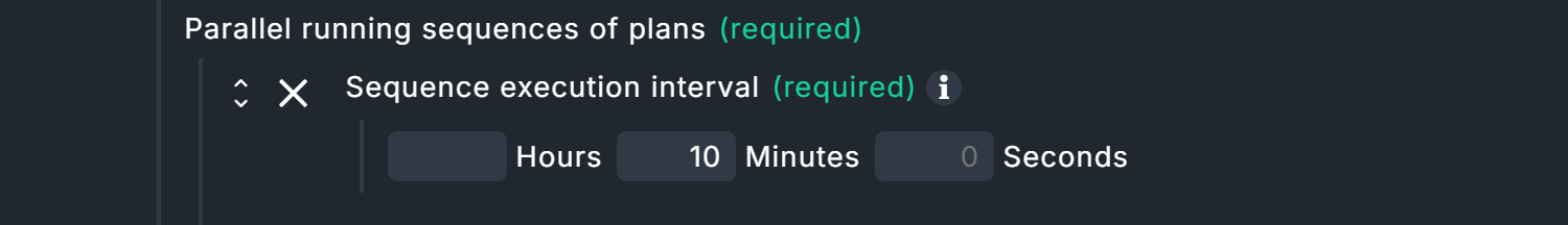

The Parallel running sequences of plans that are shown now are a Checkmk-specific concept.
To explain this, we must first go down one hierarchy level: Here you can see the item Sequence of plans. Such a sequential plan defines which suites are to be executed with which parameters. Robot Framework will process these suites one after the other. The reason for this is simple: in practice, tests are sometimes run on the desktop and several test suites could get in each other’s way at the same time (think of them stealing each other’s control of the mouse cursor).
The Parallel running sequences of plans are now an encapsulation for multiple of such sequences — and are themselves executed in parallel. Again, the reasoning is simple: this allows test suites that do not rely on the desktop to be executed in their own sequences without delay — the test suite used in this article is a good example of such processing.
Back to the dialog: The only explicit setting is the execution interval, which you set under sequence execution interval.
Execution interval for sequences.
Interval for the (parallel) execution of plan sequences
Important
The plans in the sequence naturally have their own runtimes, determined by the timeout of a single execution and the maximum number of repeated executions in the event of failed tests. The execution interval of the sequence sequence must therefore be greater than the sum of the maximum runtimes of all plans in the sequence. The maximum runtime of a sequence is calculated as follows: Limit per attempt × (1 + Maximum number of re-executions).

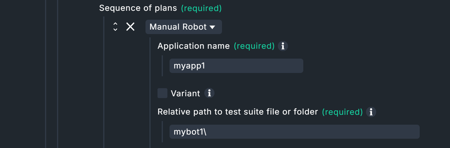

Now it’s time to configure the first plan. You can enter any name under Application name. This name does not have to be unique! The name of the application to be monitored makes sense here, for example OnlineShop, or here in this example simply MyApplication. Of course, it can happen that this online store is tested several times, either by other test suites or by the same test suite with different parameters. In such cases, the Variant field is used to achieve unambiguous results despite identical names. For example, if the application OnlineShop is tested once in German and once in English (via corresponding parameters), you could use corresponding abbreviations here. The monitoring will then return results for My OnlineShop_en and My OnlineShop_de.
However, the specification under Relative path to test suite file or folder is necessary. The path is relative to the base directory specified above, e.g. mybot\test.robot for C:\robots\. Alternatively, a directory (with several robot files) can also be specified here, in which case it would simply be mybot.
Name and path of the suite.
Sequence for the execution of suites

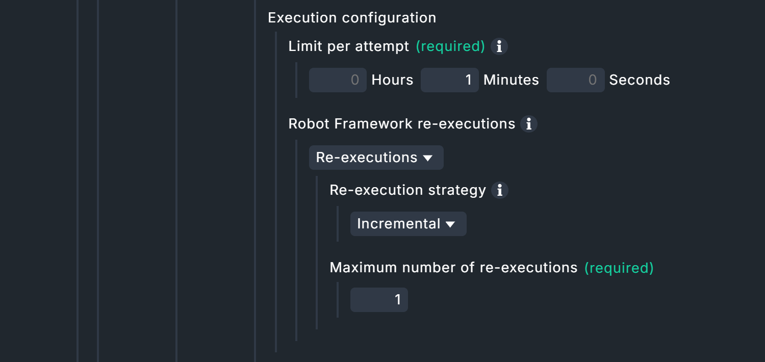

Continue with the Execution configuration. Under Limit per attempt you define the maximum elapsed time — per attempt — that a test suite may run. With Robot Framework re-executions you can now instruct Robot Framework to repeat test suites completely or incrementally if tests fail. If the individual tests in a test suite are independent of each other, the incremental strategy is the best way to save time. If, on the other hand, the test suite tests a logical sequence, such as "Login > Call up product page > Product in shopping cart > Checkout", the test suite must of course be completely reprocessed. In the end, there is always only one result.
In the case of complete retries, only the results from self-contained suites are taken into account for the final result: If a test fails on its final retry, the test suite is counted as a failure. In the case of incremental retries, the final result is made up of the best partial results: If some tests only run successfully on the third attempt, the final result is also counted as a success. Reminder: The combination of attempts and maximum run times of all plans in a sequence determines their minimum execution interval.
Configuration of execution runtimes and repetitions.
Failed tests/suites can be repeated

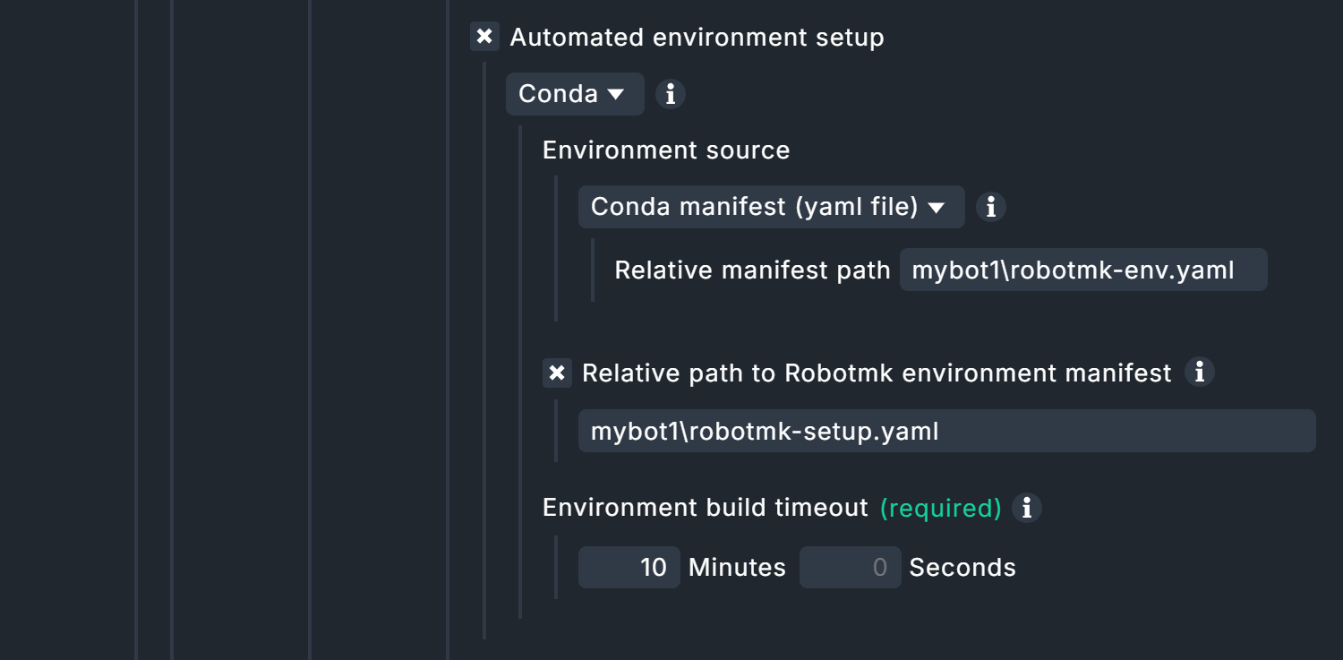

By default, execution via Conda is activated under Automated environment setup, for which you must enter three values. Firstly, Conda requires the specification of where the robotmk-env.yaml file is located. This file is responsible for setting up the Python environment, i.e. installing Python and dependencies. This specification is relative to the base directory that you have set above under Relative path to test suite file or folder. The YAML files can be saved in subdirectories, but best practice is the top suite directory. For the above base directory C:\robot\ and the suite directory C:\robot\mybot1 it is accordingly mybot1\robotmk-env.yaml.
This is followed by the path specification for robotmk-setup.yaml, which contains instructions to be executed after the Conda environment has been built — but only if you are using this file, of course.
With regard to the following time limit Environment build timeout for building the Python environment, please note that large volumes of data may need to be downloaded and set up. The required browsers in particular can quickly add up to several hundred megabytes — but only during the initial run.
Configuration of the suite.
Time limit for building virtual environments

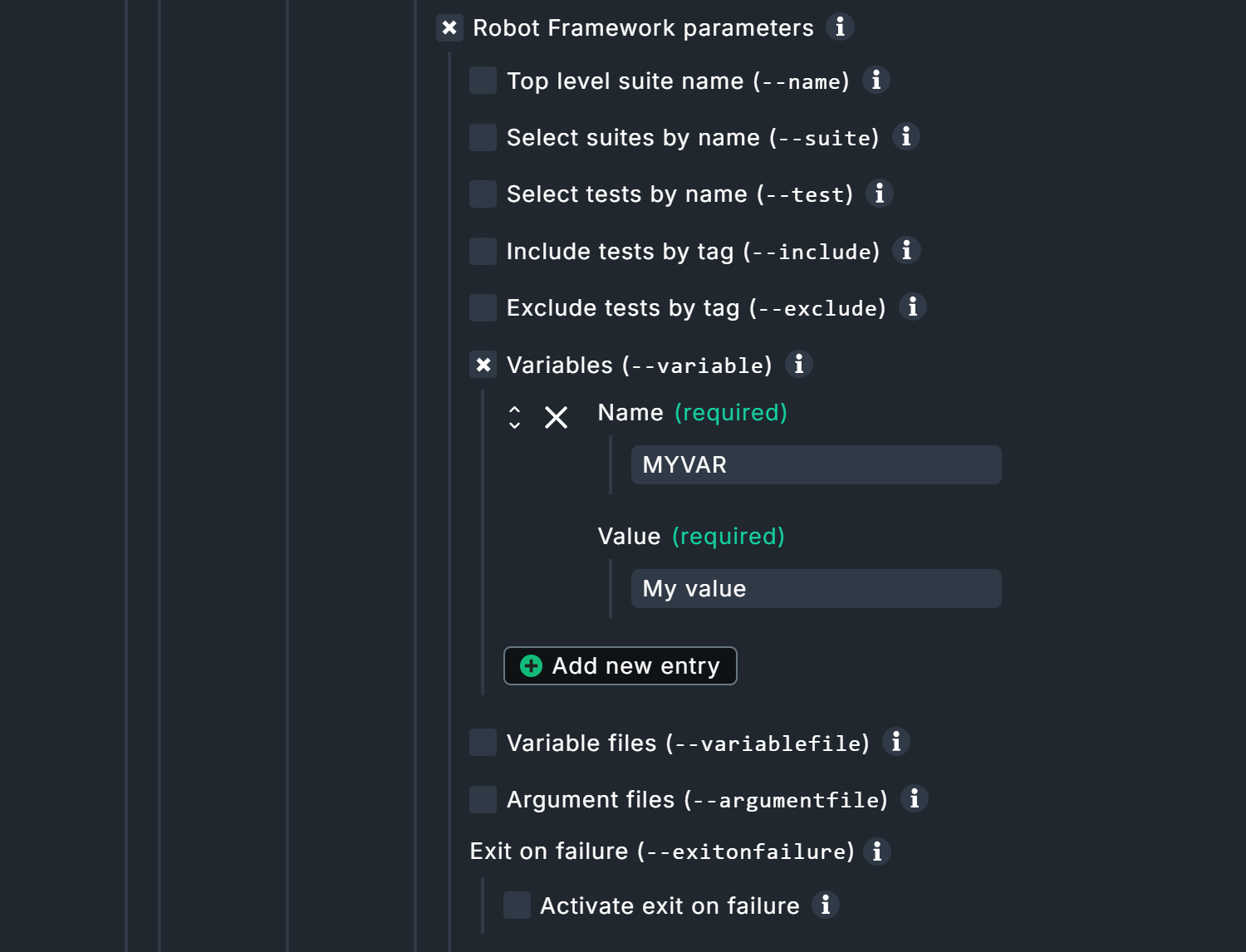

Under Robot Framework parameters you have the possibility to use some of the command line parameters of Robot Framework (which are also displayed by the command robot --help). If you want to use additional parameters, the option Argument files will help. A file specified here can contain any robot parameters. Further information about the individual parameters can be found in the inline help.
For our example project, only the option Variables is activated and a variable MYVAR with the value My Value is set. Remember the command Log ${MYVAR} at the top of the file sample.robot? This is the corresponding reference.
Command line parameters of Robot Framework.
Some options of the robot command

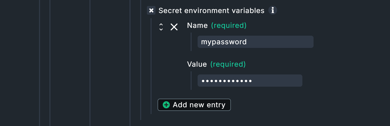

The Secret environment variables option deserves special attention as it is not an original Robot Framework function. You can set secret environment variables here, intended for example for passwords in conjunction with the CryptoLibrary Robot Framework library. The variables set here do not appear in logs, but are written in plain text to the Checkmk configuration files on the respective test hosts.
Option for secret environment variables in the Robotmk scheduler.
Secret passwords for the CryptoLibrary

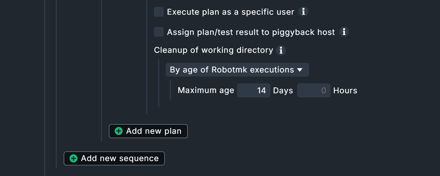

At the end of the suite configuration, there are three largely self-explanatory options.
The first option exists exclusively for Windows hosts. Execute plan as a specific user allows Robotmk to be executed in the context of a specific user account. Background: By default, Robotmk is executed in the context of the Checkmk agent (LocalSystem account), which has no authorization to access the desktop. Here a user can be specified who must be permanently logged in to a desktop session and who has access to graphical desktop applications accordingly.
However, do not be too hasty: browsers are an exception here! They can run and render web pages in headless mode. You should only check the box for a specific user if a dedicated desktop application is launched outside of browsers — not least for security reasons.
With Assign plan/test result to piggyback host the results of the plan/test can be assigned to another host. For example, if Robot Framework is testing the ordering process of an online store, the results can be assigned to the corresponding web server.
Each test run produces data that is stored under C:\ProgramData\checkmk\agent\robotmk_output\working\suites\. By default, results from the last 14 days are retained, but you should bear in mind that large volumes of data can quickly accumulate here. At least 500 kilobytes of data are generated per run — with more complex test suites and embedded screenshots, for example, this can quickly add up to several megabytes of data. Depending on the execution interval, the size of the report and your documentation requirements, you should intervene in such a situation.
Options for user context, host assignment and automatic cleanup
Automatic cleanup of the large volume of generated data
Once here, you can now create further plans in this sequence or further sequences.

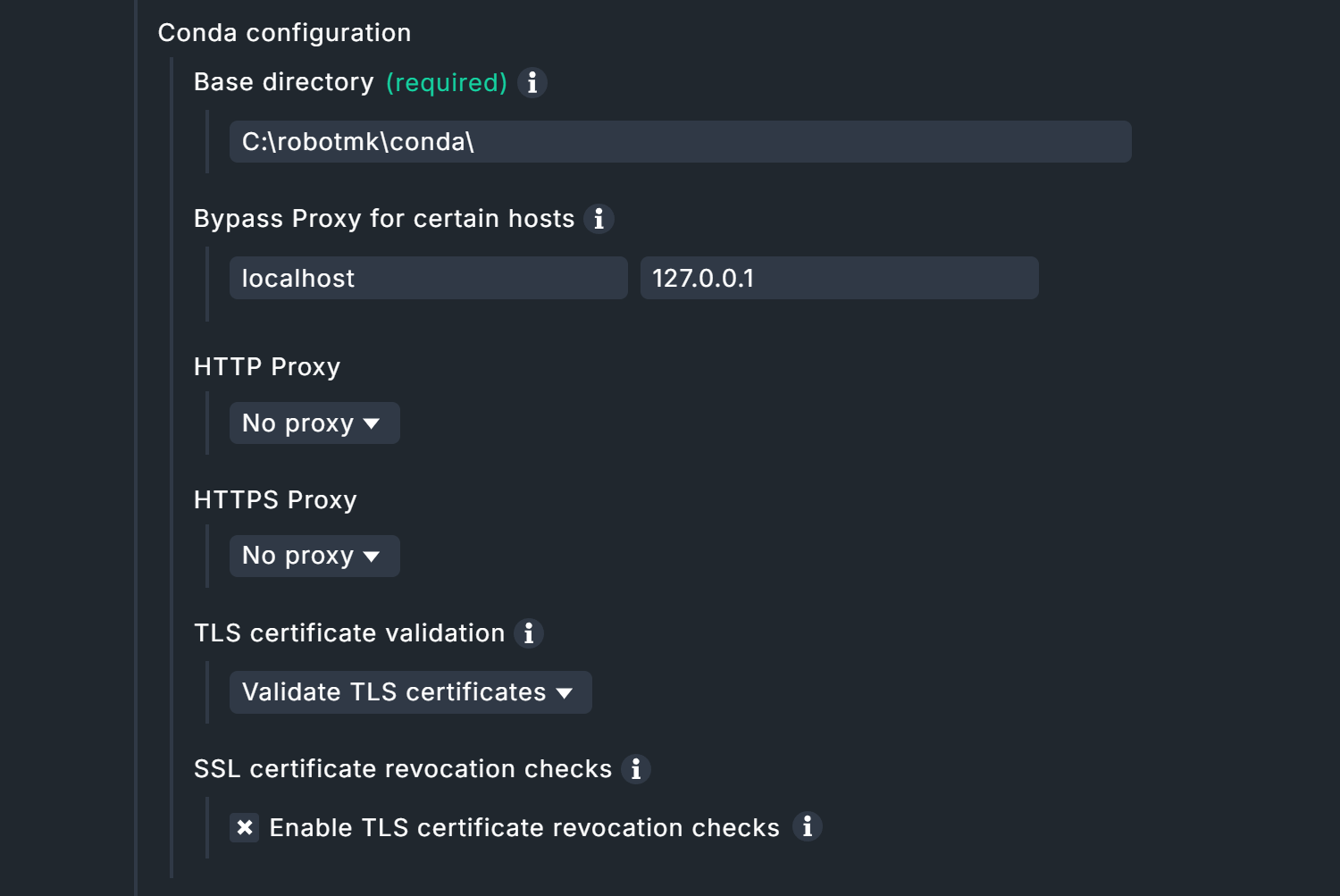

At the end there are two more options, which in turn relate to the complete Robotmk scheduler configuration.
Conda configuration allows you to specify proxy servers, TLS and SSL certificates, as well as hosts to be excluded.

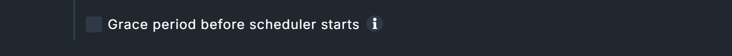

Option for a grace period for the scheduler start.
Options for proxies and certificates
Grace period before scheduler starts can also be very useful: The scheduler starts when the test host is restarted together with the Checkmk agent before the desktop logon — which, of course, means that any tests on the desktop must fail. A grace period can be used to delay the start manually so that, for example, the technical user’s desktop becomes active (again) via Autologin (Windows function for logging in without manual password entry).
Options for proxy server and a grace period for the scheduler start.
A 'period of grace' prevents failures
This completes the configuration and you can bake a new agent with the plug-in, and then deploy, manually or via the automatic agent updates.
Data in the agent output
The output in the agent is quite extensive: error messages, status, configuration and test data are transmitted in several sections. The latter can be found in the robotmk_plan_execution_report section, here is an abbreviated excerpt:

Two areas are of particular interest here. Firstly, rebot: The rebot tool has produced the actual status report for Robot Framework from several partial results (hence re-bot). Secondly, the last line html_base64: The HTML reports from Robot Framework are then base64-encoded. Screenshots taken via tests are also transferred in this way — the output/data volume in the agent can be correspondingly extensive.
Data in monitoring
As soon as the Robotmk scheduler and the test suite have been run, the service discovery will produce three new services:
Robotmk-Services im Monitoring
The newly discovered Robotmk services
The service RMK Scheduler Status exists once and immediately after deployment. The services for plans and tests, here RMK myapp1_mybot1 Plan and RMK myapp1_mybot1 Test: /Sample: Test1, are added to the monitoring as soon as the associated suites have been run for the first time.

2.3. Configuring service rules
Creating a rule for the plan status
Reminder: Maximum runtimes for plans were defined in the agent rule above. These runtimes can be evaluated with the Robotmk plan rule.
On the one hand, using the Runtime-limit ratio (peak attempt) option you can set the service to CRIT, for example, if an execution attempt exceeds 90 percent of the set threshold value.
“Configuration dialog for threshold values for test suite runtimes.”
Threshold values for status changes based on runtimes
On the other hand, Runtime limit (total) can be used to evaluate the total runtime, i.e., the combined times of all execution attempts, including repeated executions of entire plans or individual tests. If plans are to be re-executed in their entirety or incrementally after individual tests have failed, the total execution time may vary considerably.

Creating a rule for the test status
Additional data can also be retrieved for individual tests in the test suites via the Robotmk test rule. Here you will again find the option to monitor runtimes, both for tests and keywords. The monitoring of keywords is a Checkmk-specific function. Therefore, the suite-internal status in the Robot Framework report could also be OK because the test suite was processed within the maximum permitted runtime — in Checkmk, however, WARN or CRIT, because a status change takes place at, for example, 80 percent of this maximum permitted runtime.
In addition, the Enable metrics for high-level keywords option can be used to generate metrics for higher-level keywords. This is particularly useful if your tests are organized in such a way that the higher-level keywords describe the 'what' and the lower-level keywords describe the 'how' — this gives you more abstract evaluations.
In this example, the threshold values for the maximum runtime of a test are 2 and 4 seconds. You will see the effects below in the chapter Robotmk in monitoring.
Rule for monitoring keywords with example values.
Monitoring can be expanded using keyword metrics
Once again, there is an explicit filter option in the Conditions box, here for individual tests.
Dialog with option to restrict to tests.
Optional restriction to certain tests
2.4. Robotmk in monitoring
In monitoring, you will find services for the status of the Robotmk scheduler as well as the individual plans and tests — even if you have not created any separate service rules.
Scheduler status
The service RMK Scheduler Status is OK if the scheduler is running and has successfully built the execution environments.
Status of the scheduler in monitoring.
Micromamba was able to build the environments — in 33 seconds
Here in the image you can see the note Environment build took 33 seconds. This is not the first build of the environment, so Micromamba can reuse previously downloaded packages. The first build would have taken much longer.

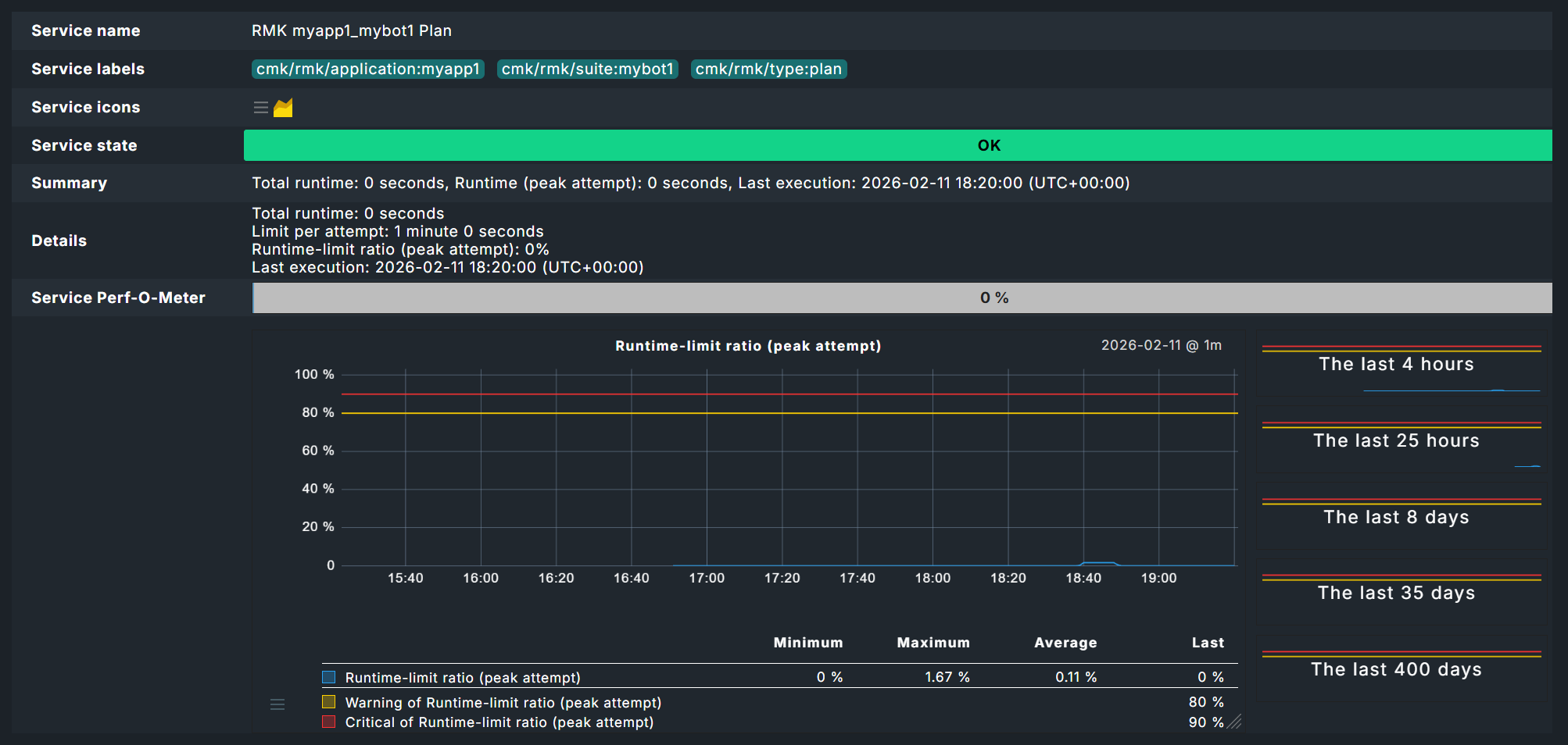

Plan status
The status of a plan is reflected in a service named by application name and suite, for example MK myapp1_mybot1 Plan.
Status of the test suite in monitoring.
The execution of a plan — especially relevant for administrators
Test status
The evaluation of the tests is where it gets really interesting. In the image you can now see the effect of the threshold values set above for the runtime of tests — here the 2 seconds for the WARN status. As the Sleep 3 Seconds instruction in the test itself already ensures a longer runtime, this service must go to WARN here, although the test was successful. The fact that the test was successful is shown by the Robot Framework report, which you can access via the icon log log icon.
Status of the test in monitoring.
Results of a specific suite — especially relevant for developers
The report now clearly shows that the test and test suite have run successfully.

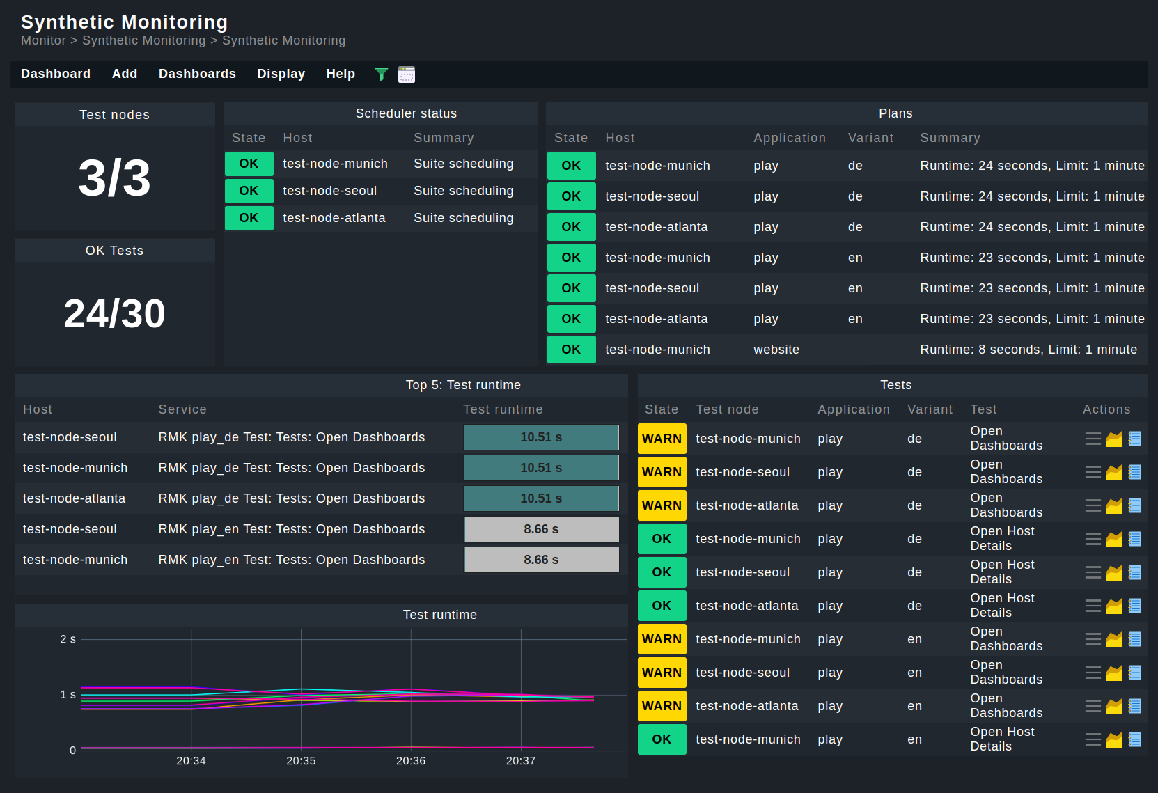

Dashboards
Of course, you can build your own dashboards as usual — but you can also find two built-in dashboards under Monitor > Synthetic Monitoring.
Robotmk dashboard in the web interface.
The complete Checkmk Synthetic Monitoring at a glance (shortened)
Prerequisite: For dashboards to work, HW/SW inventory must be activated on the hosts concerned.
3. Managed robots
We have so far assumed a scenario in which the test suites are already available on the test hosts. However, with the managed robots feature, robots can also be managed centrally on the Checkmk server and distributed via Checkmk agents.
From the above procedure you already know the entire configuration for existing robots using the Robotmk scheduler (Windows|Linux) rule.
In addition, simply enter the archive file (see below) with the packed robot. Here in the screenshot, under Plan Settings you can see the upload field for the robot — the same options as in the scheduler. Pay attention to the name at the top under Properties. This is mandatory, as the robot will later be configured in the scheduler using this name.
Configuration of a managed robot.
The robot itself is simply transferred as an archive
To use such a Managed robot, the Robotmk scheduler (Windows|Linux) rule is again used. But instead of scheduling the execution of the robot here, simply specify the desired, preconfigured robot under Sequence of plans. If required, you can still adapt the plan’s configuration for the preconfigured robot for this application here. In practice, the feature is therefore usually limited to outsourcing the known configuration and having the robot archive files distributed by the agent.
Configuration of the scheduler with a managed robot.
The mybot_managed managed robot is scheduled using the default plan configuration
The agent then transfers the specified archives to the desired hosts and stores them in the agent directory under robomk_output/managed, where they are then unpacked and finally executed.

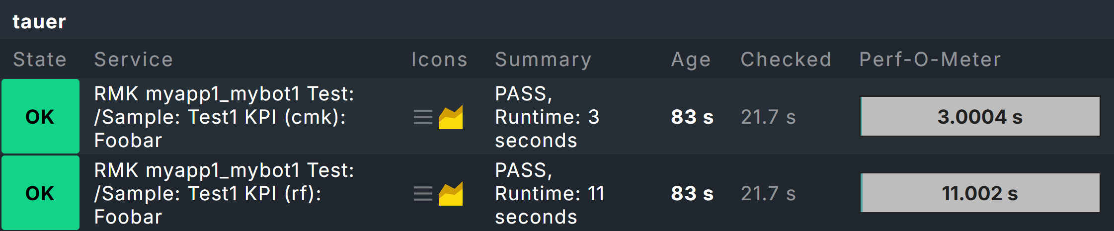

4.4. Keywords in monitoring
The keyword services appear in monitoring under one of these two patterns:
  1. Pattern-based: RMK myapp1_mybot1 Test: /Sample: My Test1 (cmk): Foobar
  2. Marker-based: RMK myapp1_mybot1 Test: /Sample: My Test1 (rf): Foobar
The difference is therefore only in the indication of origin in brackets directly before the keyword.
Pattern- and marker-based keywords in monitoring.
As shown in the above screenshot with two Foobar keyword services, the suite needed to be extended somewhat:

5. Offline mode for test environments
By default, Micromamba takes care of setting up the environments by reading the YAML configuration and downloading the corresponding packages and dependencies from the network.
But what if the hosts on which the tests are to run have no, or very limited, internet access?
Checkmk, or more precisely the Robotmk scheduler, can help here by setting up Conda environments even without an internet connection. To put it briefly: the environments can be set up in advance on any computer and then distributed as a tgz archive. Thanks to CSM, this can be done in four simple steps.
Step 1: In order for a packaged robot to work, the configuration file robotmk-env.yaml must be supplemented with the entry conda-pack:
C:\robots\mybot1\robotmk-env.yaml
channels:
  - conda-forge
dependencies:
  - python=3.12.3
  - pip=23.2.1
  - pip:
    # Python packages installed via pip
    - robotframework==7.3
    - conda-pack
Step 2: Next, the environment must be rebuilt and then packaged:
PS C:\mybot1> csm create
PS C:\mybot1> csm pack
Copy command(s) to clipboard
CSM uses the conda-pack tool stored in the configuration to pack the environment into an archive. That gives you the mybot1.tar.gz file.
Step 3: In Checkmk, in Robotmk scheduler (Windows|Linux) you usually set the Environment source option to Packed Conda environment, and specify the path to the archive mybot1.tar.gz — instead of robotmk-env.yaml as usual. The same configuration applies, of course, when used as a Managed robot.
