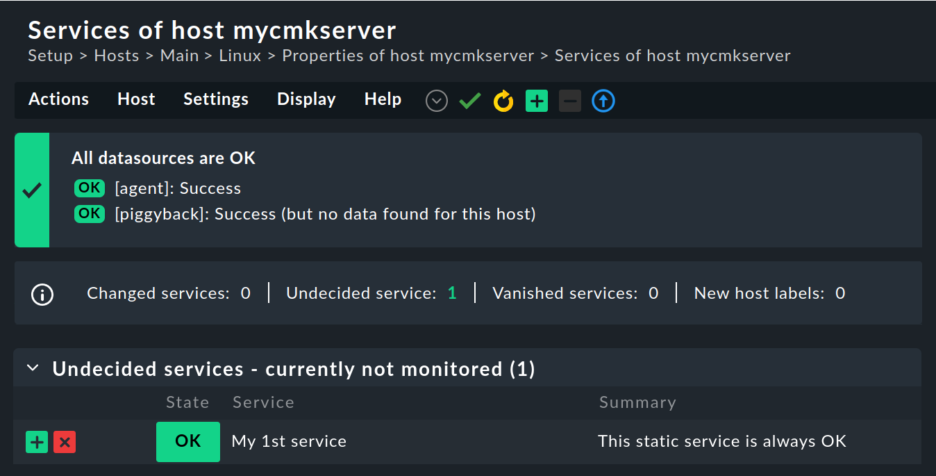

2.3. Adding the service to the monitoring
At every invocation of the Checkmk agent the local check contained in the script will also be executed and appended to the agent’s output. The service discovery also functions automatically like with other services:
The local check found by the service discovery.
Once the service has been added to the monitoring and the changes have been activated, the implementation of the self-created service with the aid of a local check will be complete. Should a problem arise during the service discovery, the Error analysis can be of help.

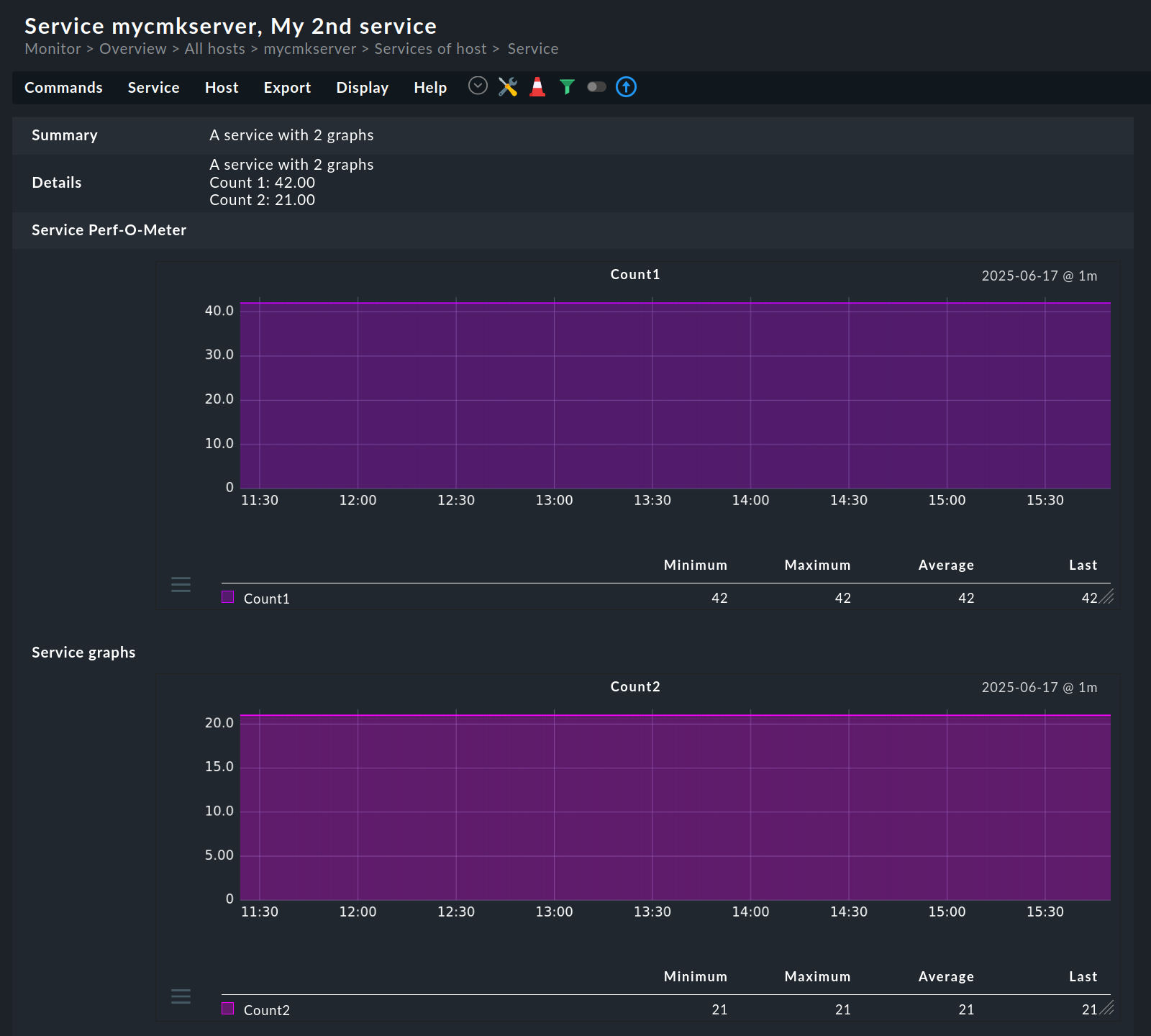

3.3. Multiple metrics
You can also output multiple metrics. In the definitions these are separated by the 'pipe' character (|), for example like this:
count1=42|count2=23
On Windows hosts you must prefix these pipes in the script with a circumflex (^) so that these pipes also appear in the output:
mylocalcheck.bat
@echo off
echo 0 "My 2nd service" count1=42^|count2=23 A service with 2 graphs
A complete output with two metrics will then look something like this:
root@linux# /usr/lib/check_mk_agent/local/mylocalcheck
0 "My 2nd service" count1=42|count2=23 A service with 2 graphs
Copy command(s) to clipboard
Once you have also added the new service to the monitoring, in the service list you will see the text for the state detail in the Summary field. Clicking on the service will display the page with its service details. The metrics are shown in the Details field, and below that you will see the service graphs that are automatically generated by Checkmk:
The service details with the two graphs.
This example uses an evaluation on the host (0, 1 or 2) instead of dynamic calculation (P). Any additional threshold values passed would be ignored here in the graph.

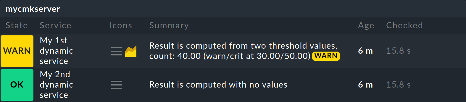

3.4. Dynamically calculating the state
In the previous sections, you learned how to provide values for metrics and use these to generate graphs. The logical next step is now to use additionally passed threshold values for a dynamic calculation of the service state. This is exactly what Checkmk enables in order to make the preparation of the data received consistent with many of the states generated via plug-ins.
If in the first field of the output, which determines the state, you pass the letter P instead of a number, the service state will be calculated based on the threshold values that are passed. In addition to the actual value, the transferred threshold values are then also displayed as a yellow and red line in the graph.
This dynamic calculation does not mean that any threshold values can be modified via the monitoring rules defined in Checkmk. The threshold values supplied in the local check are always used for the actual calculation.
The output would then look like this:
P "My 1st dynamic service" count=40;30;50 Result is computed from two threshold values
P "My 2nd dynamic service" - Result is computed with no values
… and the display in a service view like this:
“The service list with two dynamically calculated services.”
This display differs from the previous one in two respects:
  • For services in the WARN or CRIT state, the Summary of the service shows all of the important information of the metrics (name, value, thresholds). This means you can always see how this state was calculated from a value. For all other states, the metrics information is only displayed in the Details field.
  • If no metrics are transferred, the service state will always be OK.

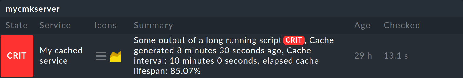

4. Executing asynchronously
The output of local checks, like that of agent plug-ins, can be cached. This can be necessary if a script has a longer processing time. Such a script is then executed asynchronously and only in a defined time interval and the last output is cached. If the agent is queried again before the time expires, it uses this cache for the local check and returns it in the agent output.
Caching is only available for AIX, FreeBSD, Linux, OpenWrt and Windows. On other platforms, use cronjobs in combination with the spool directory.
4.1. Configuring Linux
Under Linux or another Unix-like operating system, any plug-in can be executed asynchronously. For a local check, the necessary configuration is very similar to that of a plug-in. To do this, create a subdirectory called the number of seconds you want the output to be cached and put your script in that subdirectory.
In the following example, the local check will be executed only every 10 minutes (600 seconds):
root@linux# /usr/lib/check_mk_agent/local/600/mylocalcheck
2 "My cached service" count=4 Some output of a long running script
The cached data is written to a cache directory.
For a service that provides cached data, the cache-specific information is added to the service view:
“A service that outputs cached data.”

P "My service" humidity=37;40:60;30:70 My service output\nA line with details\nAnother line with details
cached(1618580356,600) 2 "My cached service" count=4 Some output of a long running script
In the last line, you can recognize a cached service by the preceding cached information with the current Unix time and the execution interval in seconds.

As a last step the processing of the script output can also be tested on the Checkmk server with the cmk command — once for the service discovery:
OMD[mysite]:~$ cmk -IIv --detect-plugins=local mycmkserver
Discovering services and host labels on: mycmkserver
mycmkserver:
+ EXECUTING DISCOVERY PLUGINS (1)
  2 local
SUCCESS - Found 2 services, no host labels
… and also the processing of the service output with a similar command:
OMD[mysite]:~$ cmk -nv --detect-plugins=local mycmkserver
+ FETCHING DATA
Get piggybacked data
My cached service    Some output of a long running script(!!), Cache generated 6 minutes 30 seconds ago, cache interval: 10 minutes 0 seconds, elapsed cache lifespan: 68.71%
My service           My service output, Humidity: 37.00 (warn/crit below 40.00/30.00)(!)
[agent] Success, [piggyback] Success (but no data found for this host), execution time 3.3 sec ...
For both commands we have shortened the output by lines not relevant for this topic.
Alternatively, you can open the service list of the host in the monitoring, navigate to the service Check_MK and its column Icons. There you can choose the menu entry Download agent output to retrieve a text file containing the complete agent output.
If there are errors in a local check, Checkmk will identify them in the service output. This applies as well for erroneous metrics, for false or incomplete information in the script output, or an invalid state. These error messages should aid in quickly identifying errors in a script.
