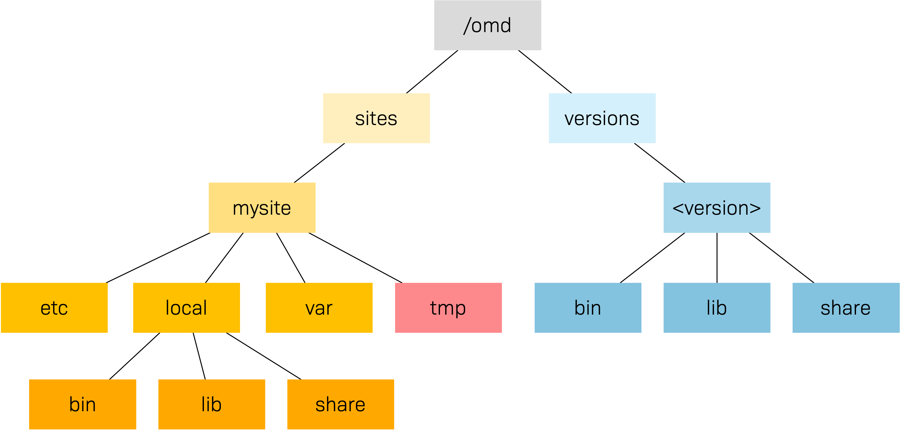

3. The directory structure
3.1. The separation of software and data
The following graphic shows the most important directories in a Checkmk installation with a site named mysite and a <version> called for example 2.5.0-2026.04.28.pro:
The basis for this structure is provided by the /omd directory.
Without exception, all of the files for Checkmk are found here.
/omd is in fact a symbolic link to /opt/omd, while the actual physical data is located in /opt
– but all data paths in Checkmk always use /omd.
Important is the separation of data (highlighted yellow) and software (blue).
The site’s data is found in /omd/sites/, and the installed software in /omd/versions/.

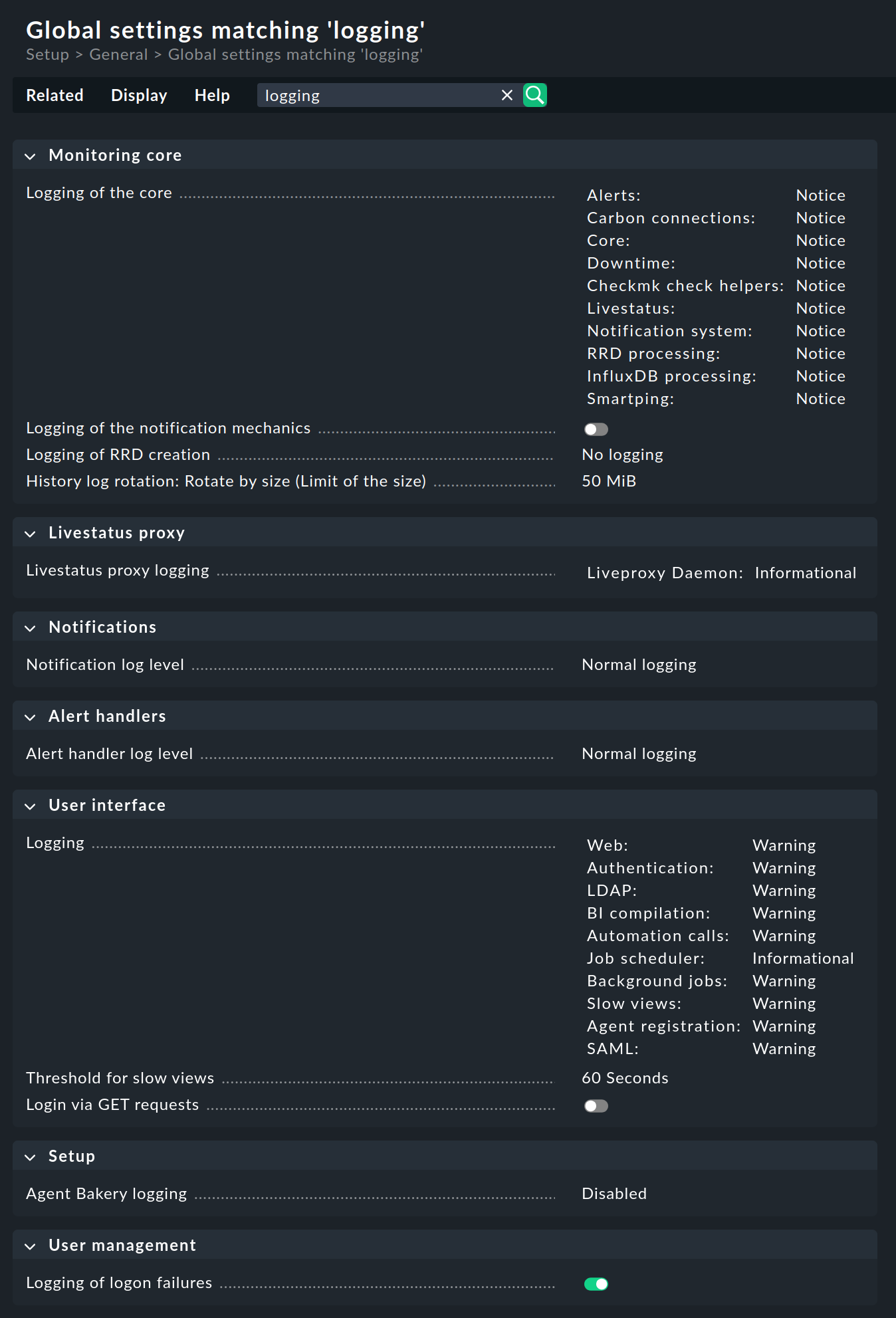

On the web interface you can easily configure the extent to which data should be written to the log files
by searching in Setup > General > Global settings for all entries with logging:
Log files can quickly become very large if a high log level has been set. It is generally advisable to use such settings for a temporary customization, as an aid in problem identification for example. |

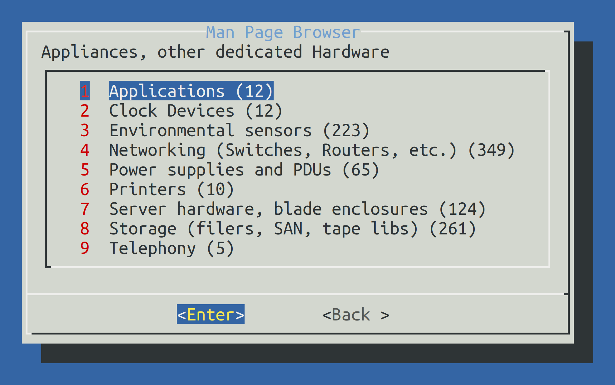

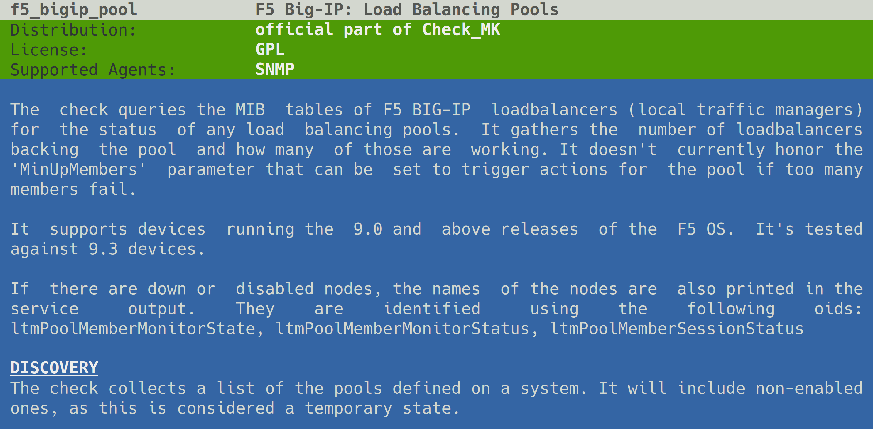

If you want more information on a certain plug-in, documentation as manual page can be called up with cmk -M:
This produces the following output:
Using cmk -m with no further options will access a complete catalog of all check plug-ins manual pages.
You can navigate interactively in this catalog:

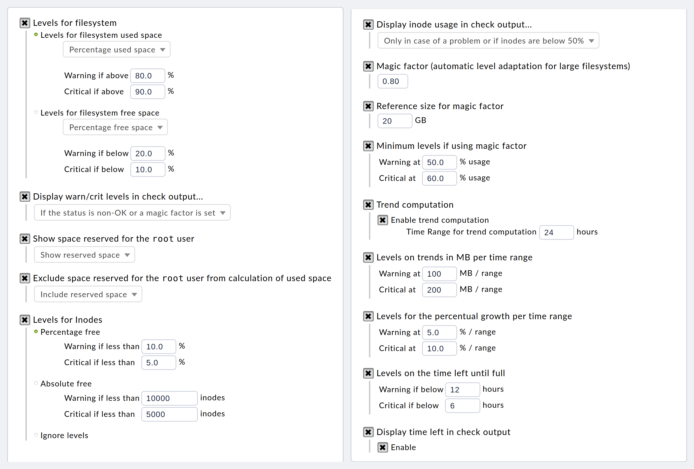

The following example shows a complete set of parameters for the check plug-in that monitors file systems in Checkmk (here in an older version). Due to the large number of parameters, the screenshot has been split into two parts and set in a small font:
The corresponding section in the actual configuration file looks like this (formatted a little more neatly):
{ 'inodes_levels' : (10.0, 5.0),
'levels' : (80.0, 90.0),
'levels_low' : (50.0, 60.0),
'magic' : 0.8,
'magic_normsize' : 20,
'show_inodes' : 'onlow',
'show_levels' : 'onmagic',
'show_reserved' : True,
'subtract_reserved' : False,
'trend_mb' : (100, 200),
'trend_perc' : (5.0, 10.0),
'trend_perfdata' : True,
'trend_range' : 24,
'trend_showtimeleft' : True,
'trend_timeleft' : (12, 6)},As can be seen, there are more than 10 different parameters here, each of which follows its own logic.
Some are configured using floating point numbers (0.8), others using integers (24), some using keywords ('onlow'), others using Boolean values (True), and finally some using tuples such as ((5.0, 10.0)).
This example shows just one of over 2,000 plug-ins. In addition, Checkmk recognizes other configurations as check parameters: Just think of time ranges, Event Console rules, user profiles, and much more.
