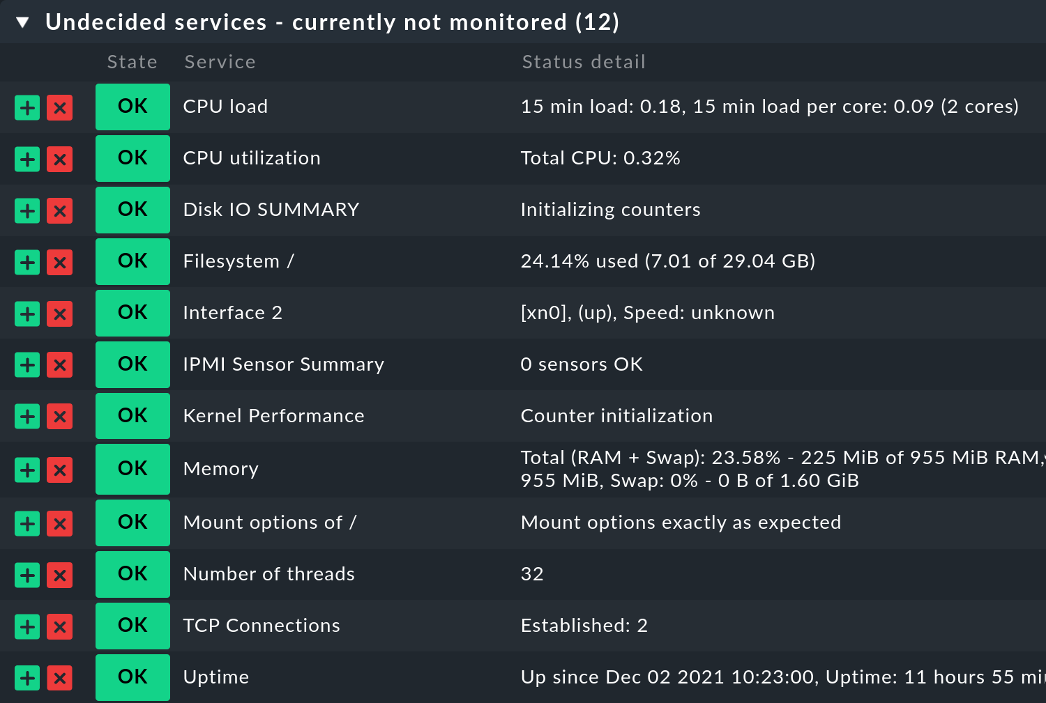

4. Inclusion into the monitoring
The inclusion into the monitoring is performed by an automatic service discovery, as with all other systems. For a 'bare' FreeBSD with no server services configured yet, at least 11 services should be discovered, and ten additional ones for file system information if installed on ZFS:
List of 12 automatically discovered services.
The service discovery in Checkmk will find at least 11 services.

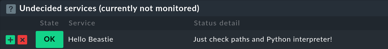

For testing, a simple local check is suitable, with which the evaluation of whether the monitored service is OK, WARN or CRIT is done directly on the monitored host. While we’re at it, let’s use a two-liner to test the Python interpreter. Again, note the different default paths compared to Linux:
/usr/local/lib/check_mk_agent/local/hello.py
#!/usr/local/bin/python3
print("0 \"Hello Beastie\" - Just check paths and Python interpreter!")
Don’t forget to make the script executable:
root@bsd:/root # chmod 0755 /usr/local/lib/check_mk_agent/local/hello.py
Copy command(s) to clipboard
Also in this case the service is found immediately:
List with the newly detected service Hello Beastie.
The new service "Hello Beastie" was found
