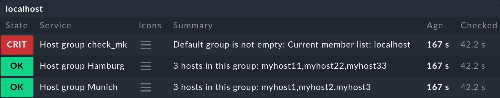

As the new myhostgroups_advanced check plug-in provides new services, you must perform a service discovery for this check plug-in and activate the changes in order to see these services in the monitoring:
The two new services created by the advanced check plug-in in the monitoring.
Two new services in the monitoring:
Proceed as described in the simple check plug-in chapter. Do not execute the first two commands for myhostgroups, instead execute them for the new myhostgroups_advanced check plug-in.

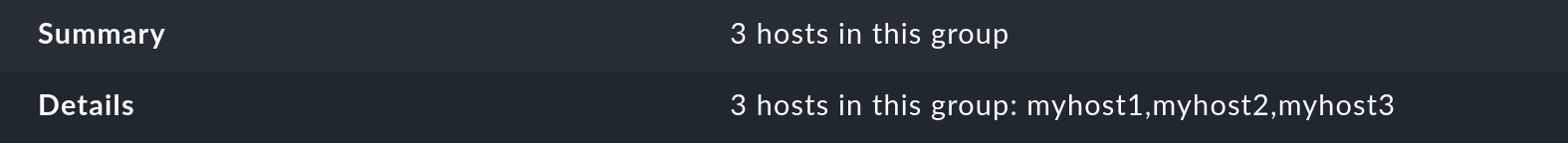

4.3. Summary and details
In the monitoring of Checkmk, each service has a state — OK, WARN, etc.. — as well as a line of text. This text is located in the Summary column — as can be seen in the previous screenshot — and therefore has the task of providing a brief summary of the service’s state. The concept is that this text should not exceed a length of 60 characters. That ensures a concise table display without annoying line breaks.
There is also the Details field, in which all details on the state of the service are displayed, which also includes all of the summary information. Clicking on the service opens the service page, in which the two fields Summary and Details can be seen alongside many others.
When calling yield Result(...), you can determine which information is so important that it should be displayed in the summary, and for which it is sufficient for it to appear in the details.
In our example, you have always used a call of the following type:
~/local/lib/python3/cmk_addons/plugins/myhostgroups/agent_based/myhostgroups.py
    yield Result(state=State.OK, summary=f"{attr['num_hosts']} hosts in this group: {attr['members']}")
This means that the text defined as summary always appears in the Summary — and also in the Details. You should therefore only use this for important information. If a host group contains many hosts, the summary list can become very long — longer than the recommended 60 characters. If a piece of information is of secondary importance, you can use details to specify that its text only appears in the details:
    yield Result(
        state = State.OK,
        summary = f"{attr['num_hosts']} hosts in this group",
        details = f"{attr['num_hosts']} hosts in this group: {attr['members']}",
In the example above, the list of hosts is therefore only displayed in the Details. The Summary then only shows the number of hosts in the group:
'Summary' and 'Details' shown in the service details.
Different content for summary and details in the monitoring
In addition to summary and details, there is a third parameter. With notice you specify that a text for a service in the OK is only displayed in the details — but also in the summary for all other states. This makes it immediately clear from the summary why the service is not OK. The notice parameter is not particularly useful if texts are permanently bound to states, as in our example so far.
In summary, this means:
  • The total text for the summary should not be longer than 60 characters for services that are OK.
  • Always use either summary or notice — at least one or the other, but not both.
  • If required, add details if the text for the details is to be an alternative.

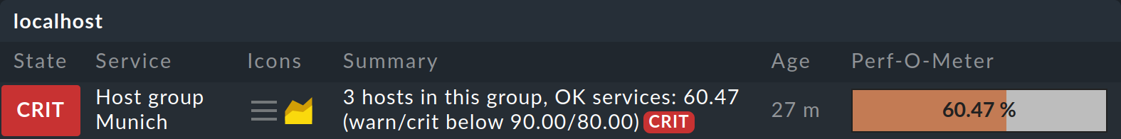

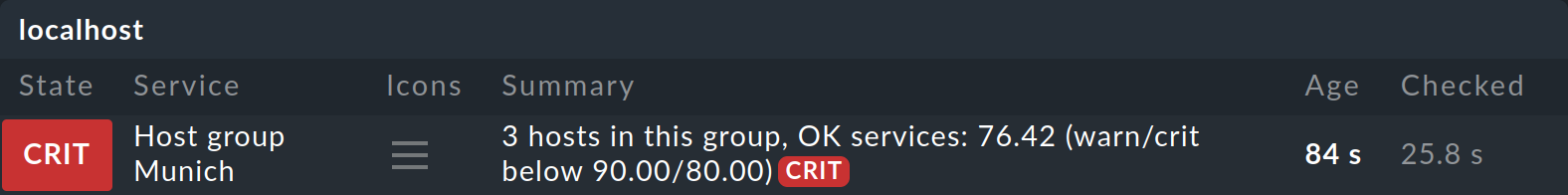

The service for a host group now evaluates three results and displays the worst state from these in the monitoring, as in the following example:
The summary shows the text for the critical state.
The summary displays the text for the critical state

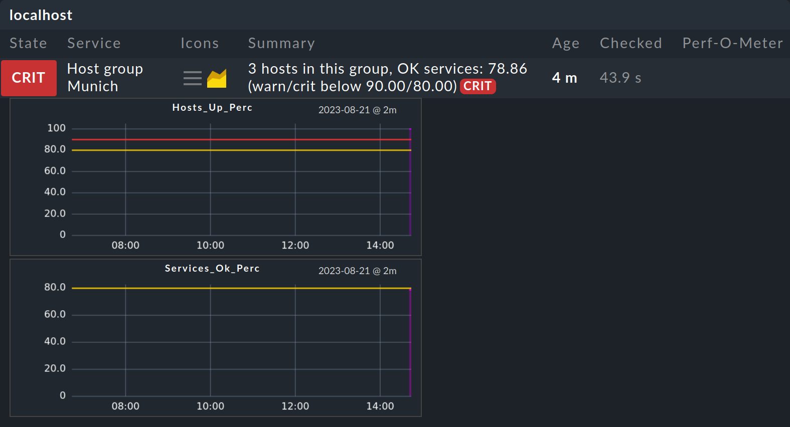

You can now define the metric services_ok_perc in the same way. The last lines of the check function will then look like this:
    hosts_up_perc = 100.0 * num_hosts_up / num_hosts
    yield from check_levels(
        hosts_up_perc,
        levels_lower = ("fixed", (90.0, 80.0)),
        metric_name = "hosts_up_perc",
        label = "UP hosts",
        boundaries = (0.0, 100.0),
        notice_only = True,
    services_ok_perc = 100.0 * num_services_ok / num_services
        services_ok_perc,
        metric_name = "services_ok_perc",
        label = "OK services",
        notice_only = True,
With the extended check function, both graphs are visible in the monitoring. In the service list, the Icon for displaying the graphs for a service. icon now shows that there are graphs for the service. If you point to the icon with the mouse, the graphs will be displayed as a preview.
The service list with 2 graphs as a preview.
The names of the metrics are used as the titles for the graphs

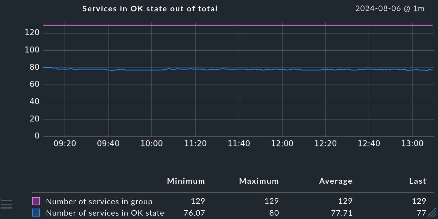

An overview of all graphs including their legends and more can be found in the service details.

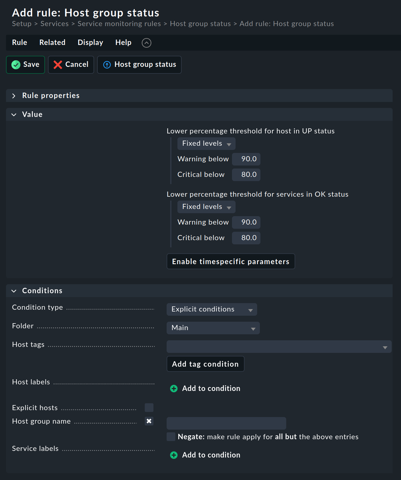

The rule set you have just defined will look like this in the GUI:
“The newly created rule set in the setup.”
In the Conditions box, you will find the Host group name input field defined via the HostAndItemCondition for restricting the rule for host groups.
Create a rule and try out different values, as shown in the screenshot above. If this works without errors, you can now use the check parameters in the check function.

If a rule has been configured, you can now monitor the host groups of the example with the threshold values set via the GUI. However, if no rule has been defined, this check function will crash, since the default parameters in the check plug-in will have not been filled, and the plug-in will generate a KeyError in the absence of a rule.
However, this problem can be solved if the default values are defined when the check plug-in is created:
check_plugin_myhostgroups_advanced = CheckPlugin(
    name = "myhostgroups_advanced",
    sections = [ "myhostgroups" ],
    service_name = "Host group %s",
    discovery_function = discover_myhostgroups_advanced,
    check_function = check_myhostgroups_advanced,
    check_default_parameters = {"hosts_up_lower": ("fixed", (90, 80)), "services_ok_lower": ("fixed", (90, 80))},
    check_ruleset_name = "myhostgroups_advanced",
You should always pass default values in this way (and not intercept the case of missing parameters in the check plug-in), as these default values can also be displayed in the Setup interface. For example, in the service discovery of a host, on the Services of host page, in the Display menu, there is the Show check parameters switch.
On GitHub you can find both the file with the rule set as well as the check plug-in extended by the rule set.
5.4. Testing and enabling the extended check plug-in
The changes made in the previous chapter affect both the monitoring core and the graphical user interface, as well as its supporting processes. Therefore, after running cmk-validate-plugins, you must first regenerate the configuration and then restart the site:

6. Customizing the metric displays
In the example above, you had the check plug-in myhostgroups_advanced generate metrics for all measured and calculated values. We have presented two ways of doing this. First, the metrics of the calculated values were created as part of the check_levels() function with the metric_name argument, for example like this:
        services_ok_perc,
        notice_only = True,
Then you have generated the measured metrics directly with the Metric() object — for the number of services in the OK state, for example, like this:
    yield Metric(name="num_services_ok", value=num_services_ok)
Metrics will become immediately visible in the Checkmk graphical user interface without you having to do anything. There are, however, a few restrictions:
  • Matching metrics are not automatically combined in a graph, but each appears individually.
  • The metric will not have a proper title, instead the internal variable name of the metric is shown.
  • No unit is used that allows a meaningful representation (e.g. GB instead of individual bytes).
  • A color is selected at random.
  • A 'Perf-O-Meter', i.e. the graphic preview of the metric as a bar, does not automatically appear in the service list (for example in the view that shows all services of a host).
To complete the display of your metrics with such details, you will require metric definitions.

6.2. Graphs with multiple metrics
If you want to combine several metrics in one graph (which is often very useful), you will need a graph definition that you can add to the graphing file created in the previous section.
For our example, the two metrics num_services and num_services_ok are to be displayed in a single graph. The metric definitions for this are created in the same way as in the previous section for services_ok_perc and look as follows:
~/local/lib/python3/cmk_addons/plugins/myhostgroups/graphing/graphing_myhostgroups.py
metric_myhostgroups_services = Metric(
    name = "num_services",
    title = Title("Number of services in group"),
    unit = Unit(DecimalNotation("")),
    color = Color.PINK,
metric_myhostgroups_services_ok = Metric(
    name = "num_services_ok",
    title = Title("Number of services in OK state"),
    color = Color.BLUE,
Now add a graph that draws these two metrics as lines. This is done via an instance of the class Graph, whereby the instance’s name must again begin with a predefined prefix (graph_):
graph_myhostgroups_combined = Graph(
    name = "services_ok_comparison",
    title = Title("Services in OK state out of total"),
    simple_lines=[ "num_services", "num_services_ok" ],
    minimal_range=MinimalRange(0, 50),
The parameter minimal_range describes the minimum range covered by the vertical axis of the graph, regardless of the actual values of the metric. The vertical axis will be extended if the values exceed the minimum range, but it will never be smaller.
The result is the combined graph in the Checkmk GUI:
“The graph shows both metrics in the service details.”
6.3. Metrics in the Perf-O-Meter
Would you like to display a Perf-O-Meter for a metric in the row of the service list? It could look like this, for example:
“The Perf-O-Meter shows the percentage of services in ‘OK’ state.”
The Perf-O-Meter shows the percentage of services in OK state
To create such a Perf-O-Meter, you will need another instance, this time of the class Perfometer, whose name begins with the prefix perfometer_:
perfometer_myhostgroups_advanced = Perfometer(
    focus_range = FocusRange(Closed(0), Closed(100)),
    segments = [ "services_ok_perc" ],
Perf-O-Meters are a little trickier than graphs, as they have no legend. It is therefore difficult to display a range of values, especially when absolute values are being displayed. It is easier to display a percentage. This is also the case in the above example:
  • The metric names are entered in segments, in this example the percentage of services in the OK state.
  • The lower and upper limits are entered in focus_range. Closed limits are intended for metrics that can only accept values between the specified limits (here 0 and 100).
Further, even more sophisticated options for implementing metrics in Perf-O-Meters can be found in the Graphing API documentation, for example, with the classes Bidirectional and Stacked, which allow several Perf-O-Meters to be displayed in one.
The graphing file for this chapter can be found at GitHub. Among other things, this file contains the metric definitions for the four measured values and the two calculated values.
