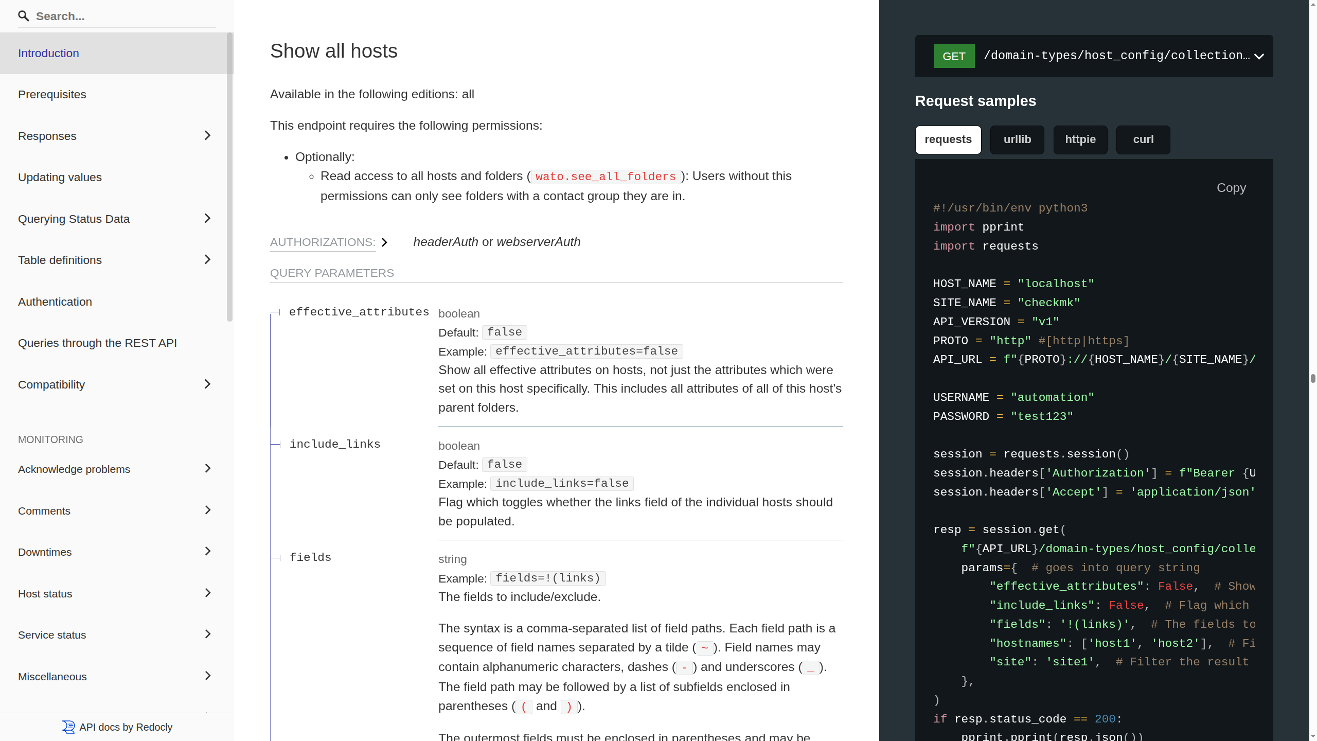

3.2. Structure and Content
The API documentation uses a responsive web design with three sections:
The left navigation panel is used for navigation, searching, and quickly jumping to the detailed description of the entries in the middle panel. The table of contents contains an entry for each API endpoint. An endpoint identifies, via a URL, the resource provided by the API (e.g., hosts), along with the method used to access the resource (e.g., GET to display a host). The endpoints are organized into multiple folders.
The central content area contains the key facts in the documentation: all information regarding the definition of a request (including parameters, value ranges, default values, and descriptions) and the corresponding responses (also with all details). The possible responses are displayed in different colors, depending on whether the returned HTTP status code indicates success or an error.
The right-hand example section (Request samples) shows the method and URL for the endpoint selected in the content area, followed by several request examples: the payload in JSON format (if relevant for the endpoint) and code examples, e.g., for Python with
requests, Python withurllib, Bash with Httpie, and Bash with Curl. Below that are the responses corresponding to the HTTP status code. All code examples can be copied to the clipboard using the Copy button.
The navigation area is scroll-synchronized with the other two areas; in other words, when you scroll up or down in the content area, the navigation area automatically scrolls to the corresponding entry in the table of contents.
The responsive web design ensures that in a narrow browser window, the example area disappears (the examples are then displayed below the corresponding method) and the navigation area is converted into a menu.
In all sections, you will find content that you can show or hide, such as the entries for the endpoints in the navigation section and nested parameters in the content section. By clicking > or Expand all, you can show the hidden content, and by clicking ∨ or Collapse all, you can hide it again.

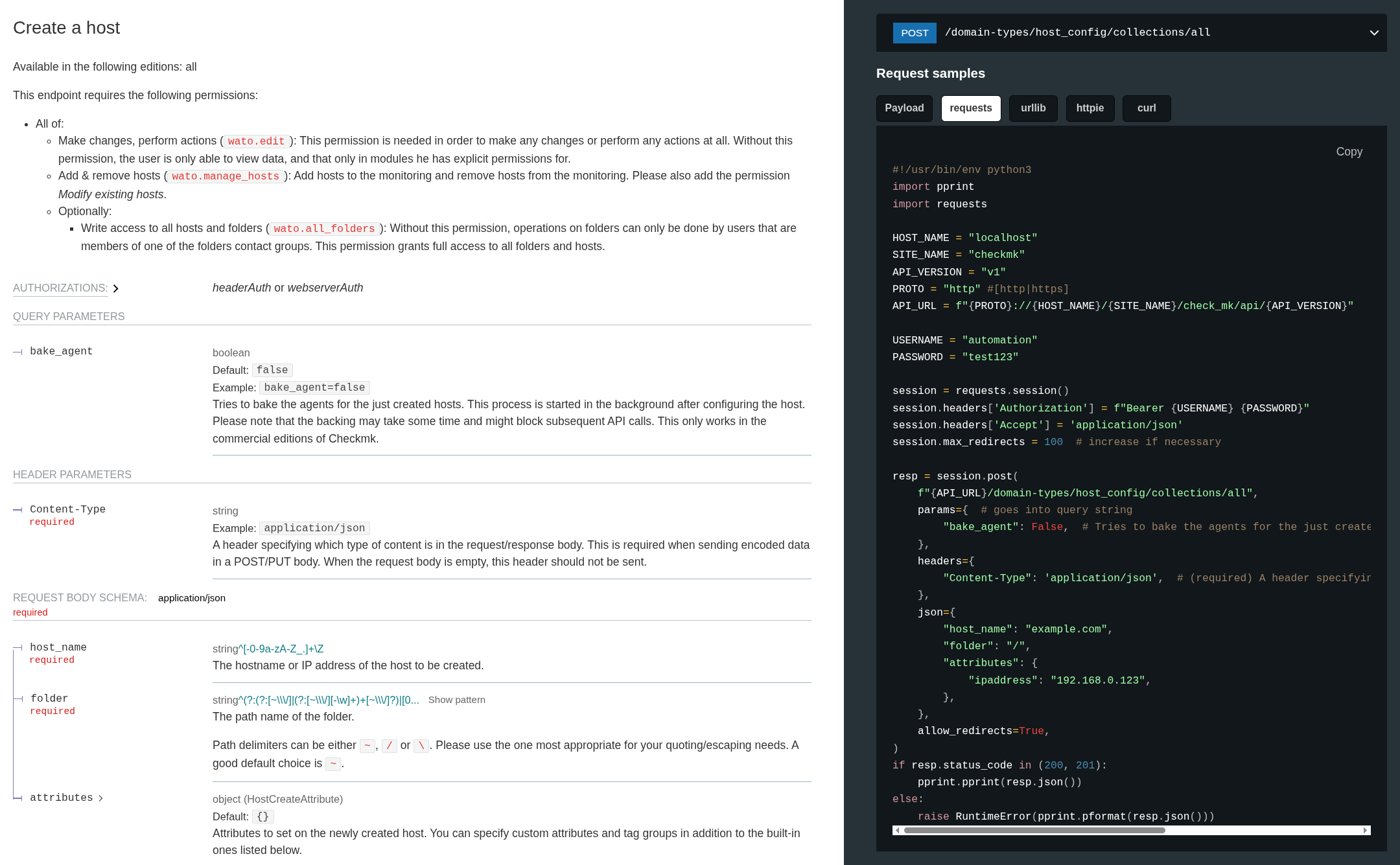

Creating a host
Open the API documentation and look for the entry on creating a host (Create a host) in the left navigation pane:
In the middle pane, you’ll see the details for the selected request: which HTTP authentication is required (this is the same for all requests via the REST API) and the required and optional parameters. Required are the host name and the folder in which it should be created. By default, the host is created in the Main folder. If you want to create the host in a different folder, you may first need to use another API request (Show all folders) to display the existing folders in order to find the ID of the desired one.
In the right-hand pane, you will see the path for the API request for the currently visible endpoint, as well as a series of sample requests and sample responses. For the scripts you prepared above, you can copy the appropriate sample request to the clipboard by clicking Copy.
- Python with requests
In the API documentation, click the requests button in the right-hand example pane, and then click Copy to copy the requests example code to the clipboard. Open the prepared script
create_host.pyand paste the contents of the clipboard:In the first part of the sample code, you will find the environment variables and the configuration for HTTP authentication.
Below that is the
postrequest to the resource located at the specified path, in this case the REST API endpoint/domain-types/host_config/collections/all. The arguments for thepostcall include the parameters for the request; in this case, these include the name of the new host to be created, the folder in which it should be created, and its IP address.If the request was successful (HTTP status code 200 or 201), the
postcommand is followed by a simple output of the API’s response to the request. Otherwise, an exception is generated, whose description contains the API’s response.- Bash with curl
In the API documentation, click the curl button in the right-hand example area and then click Copy to copy the curl example code to the clipboard. Open the prepared script
create_host.shand paste the contents of the clipboard:The first part of the sample code contains the environment variables.
Below that is the
curlcommand using the POST method to access the resource whose URL is listed on the last line. After the header lines (one of which defines HTTP authentication) comes the data section, where the parameters for the new host are specified.The API’s response to the request is output as a JSON object. The
--write-outoption also provides a final line containing the HTTP status code.
In this example, the host myhost123 with the IP address 192.168.0.42 is to be created in the main folder.
Note that the sample code from the API documentation may contain more parameters than you might need in a specific case.
However, this is not the case for the current example, and you only need to change the two existing parameters host_name and ipaddress.
Also insert the correct values for the environment variables to properly access your specific Checkmk site.
Your customized script should look something like this:

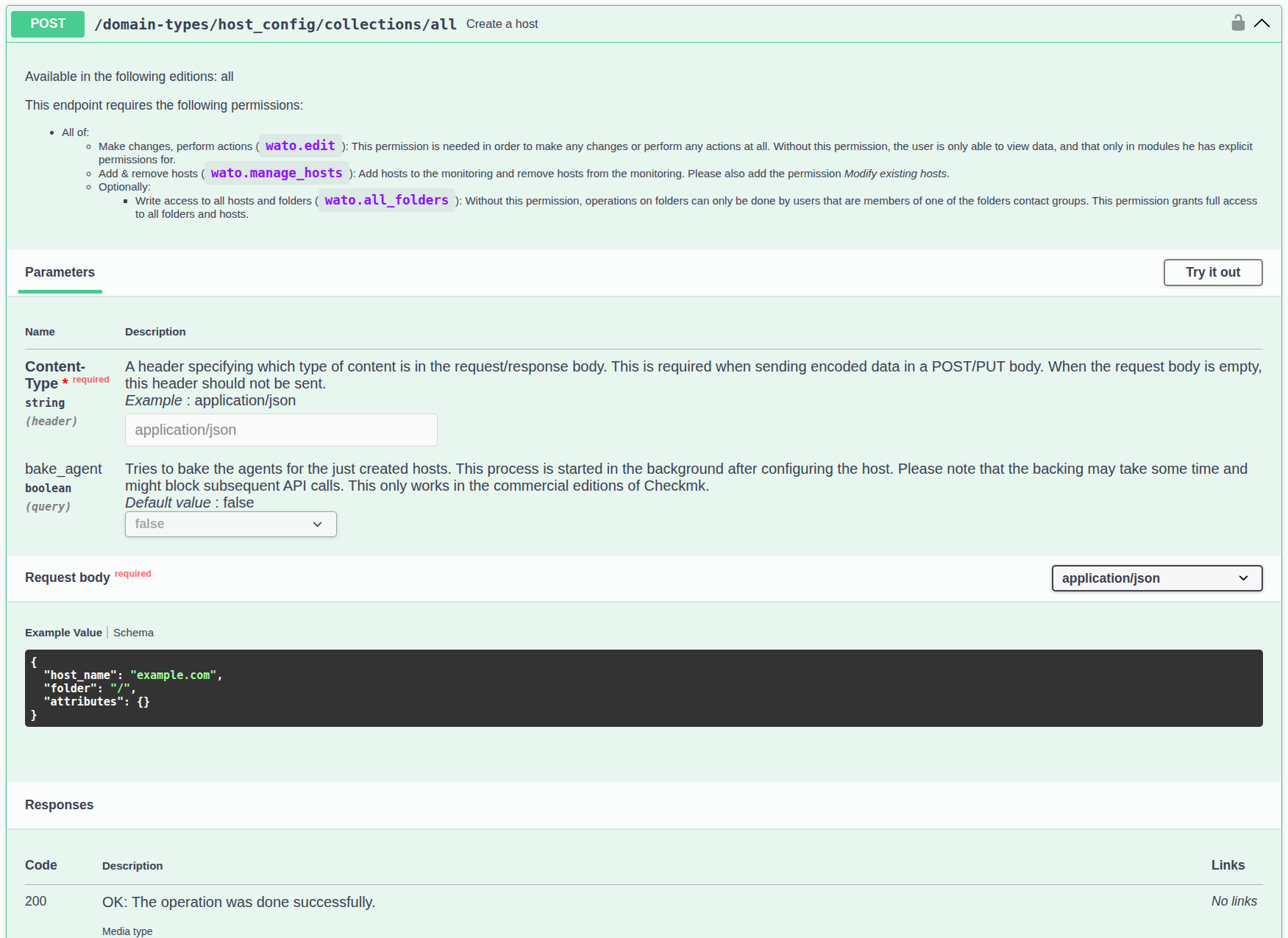

You can open the interactive GUI from the Checkmk GUI via the navigation bar in the Help > Developer resources > REST API > Version 1 > Interactive GUI menu. The interactive GUI will be displayed in a new browser window (or browser tab):
Below, we outline how you can execute the first request from the example above (create a host) using the REST API’s interactive GUI instead of a script:
Authenticate: After clicking the Authorize button (on the right side above the entry for the first endpoint folder), the interactive GUI displays a dialog box for entering authentication information. However, if you are logged in as a user in the Checkmk web interface, you do not need to enter anything in the GUI, since as a Checkmk user you are already authorized to use the REST API via Cookie Authentication, meaning you will then have access to all API functions for which your user account has the necessary permissions.
Select an endpoint: In the Hosts folder, select the Create a host endpoint and click Try it out.
Enter parameter values: In the Request body, overwrite the example value for
host_name. In theattributes: {}field, you can enter the desired IP address:"ipaddress": "192.168.0.42".Send request: Click Execute.
Check the response: Under Responses, you will first see the Curl command that was sent, along with the endpoint URL. Below this, the response is displayed under Server response, including the HTTP status code, and the (multi-line formatted) REST API response is shown under Details.
The REST API’s interactive GUI thus allows you to quickly and easily try out the API’s functions and familiarize yourself with the details of the input values and the specific responses.
