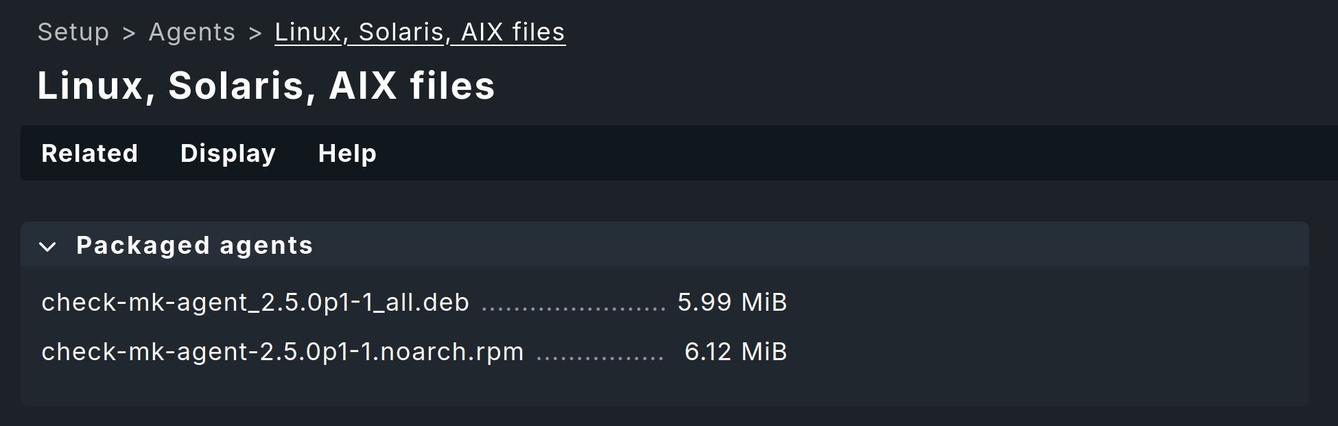

In CRE Checkmk Community you can find the agent’s Linux packages via Setup > Agents > Linux. In the commercial editions, you first get to the Agent Bakery in the Setup menu via Agents > Windows, Linux, Solaris, AIX, where you find the individually prepared packages. From there, the Related > Linux, Solaris, AIX files menu item will take you to the list of agent files:
Download page with the RPM/DEB packages.
You will find the RPM and DEB packages on the download page
Everything you need can be found right in the first box named Packaged Agents: the ready-made RPM and DEB package files for installing the Linux agent with its default settings.

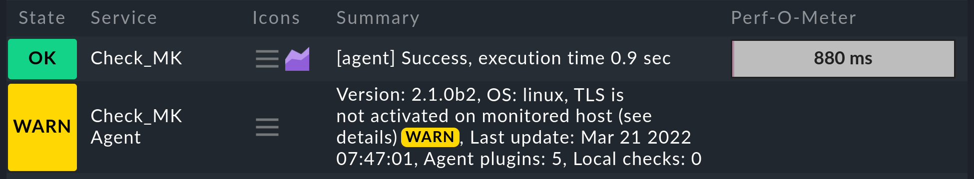

There is a special feature when the agent was installed with the Agent Controller for the first time. Then the agent switches to the unencrypted legacy pull mode so that the Checkmk server is not cut off from the monitoring data and can continue to display it. This applies to both a new installation and an update of a very old agent (older than version 2.1.0).
You will receive a notice of the activated legacy pull mode in the command output during the installation of the agent. It will look like this in the monitoring:
The WARN state of the 'Check_MK' service due to missing encryption.
Warning in Checkmk monitoring that TLS is not yet active
The Checkmk site recognizes from the agent output that the Agent Controller is present and thus TLS encryption is possible — but not yet enabled. The Check_MK Agent service changes to the WARN state and remains so until you register it. After registration, only encrypted pull mode is used for communication. The legacy pull mode is switched off and will remain so. However, it can be switched on again by command if necessary.

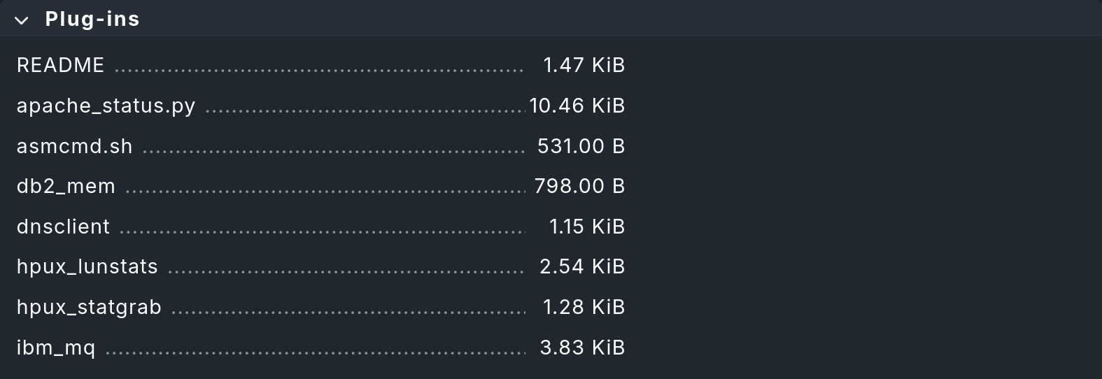

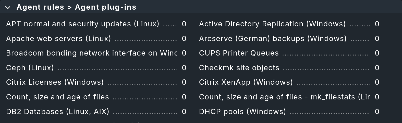

9.2. Manual installation
The plug-ins included with Linux and Unix can all be found on the agents download page in the Setup menu (as described in the installation chapter) in the Plugins box:
Download page with agent plug-ins.
The beginning of the long list of available agent plug-ins
The plug-ins can also be found on the Checkmk server under ~/share/check_mk/agents/plugins.
For all of the agent plug-ins we provide, there are matching check plug-ins that can evaluate the agent’s data and create services. These are already installed, so that newly found services can be detected and configured immediately.
Note: Before you install a plug-in on a host, take a look at its corresponding file. Often you will find important information there about the correct use of the plug-in.
The actual installation is then simple: Copy the file to /usr/lib/check_mk_agent/plugins. Make sure that it is executable. If not, use a chmod 755, otherwise the agent will not execute the plug-in. Note that especially if you do not transfer the files via scp but fetch them via HTTP from the download page, the execution permission will be lost.
Once the plug-in is executable and located in the correct directory, it will be automatically invoked by the agent and a new section will be created in the agent output. This section usually has the same name as the plug-in. Complex plug-ins, such as mk_oracle for example, even create a whole series of new sections.

9.5. Installation using the Agent Bakery
CEE In the commercial editions, the included plug-ins can be configured via the Agent Bakery. This takes care of both the installation of the actual plug-in and the correct creation of its configuration file, should one be needed.
Each plug-in is configured via an agent rule. You can find the appropriate rule sets in Setup > Agents > Windows, Linux, Solaris, AIX > Agent rules > Agent Plugins:
Page with rules for configuring agent plug-ins.
List of rules for the agent plug-ins

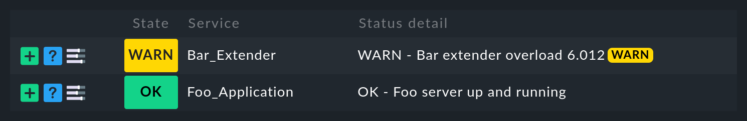

The rest will now be done automatically by Checkmk. Once you invoke a service discovery for the host, the two new services will show up as available. It will look like this:
List of detected services for the plug-ins set up via MRPE.
One service is detected for each of the two MRPE plug-ins

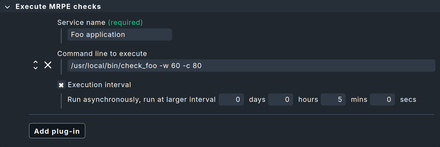

10.3. MRPE with the Agent Bakery
CEE Users of the commercial editions can also configure MRPE with the Agent Bakery. Responsible for this is the rule set Setup > Agents > Windows, Linux Solaris, AIX > Agent Rules > Generic agent options > Execute MRPE checks. There you can configure the same things as described above. The file mrpe.cfg will then be generated automatically by the Agent Bakery.
Rule for MRPE configuration in the Agent Bakery.
MRPEs can be conveniently configured using a rule

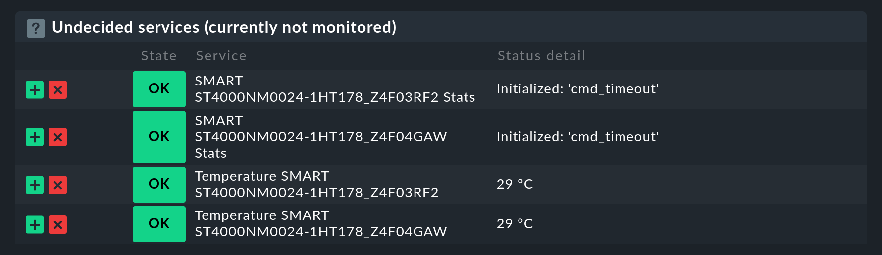

If these requirements are met and the plug-in is installed, the data is automatically retrieved and appended to the agent’s output. In Checkmk you can then also activate the new services directly:
List of SMART services found in service discovery.
SMART services found by service discovery
As seen in the screenshot, if cmd_timeout occasionally occurs, switch the plug-in to asynchronous execution at intervals of a few minutes.
