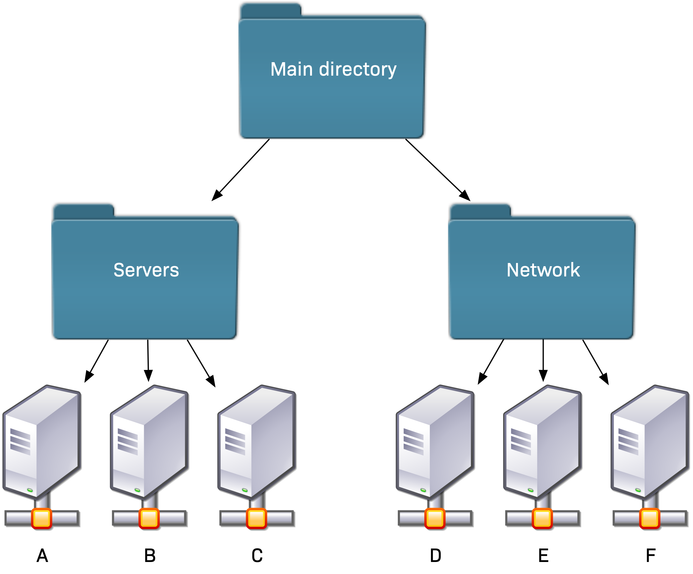

2.1. Folder hierarchy
The user is completely free in the design of their own tree structure. Any form of differentiation is possible. However, there are three common criteria for the structure of the host tree:
  • Location (e.g. Munich versus Shanghai)
  • Host type (e.g. switch versus load balancer)
  • Organization structure (e.g. database versus network groups)
The criteria can of course be mixed, split by location in the first level of the tree and then by host type in the second for example.
If you like simplicity, you should put hosts only in the 'leaves' of the tree (even if Checkmk allows hosts in middle folders). The following example shows a simple tree structure by host type: Hosts A, B, and C are placed in the Servers folder, and D, E, and F are placed in the Network folder:
Illustration of a folder structure with two subfolders.

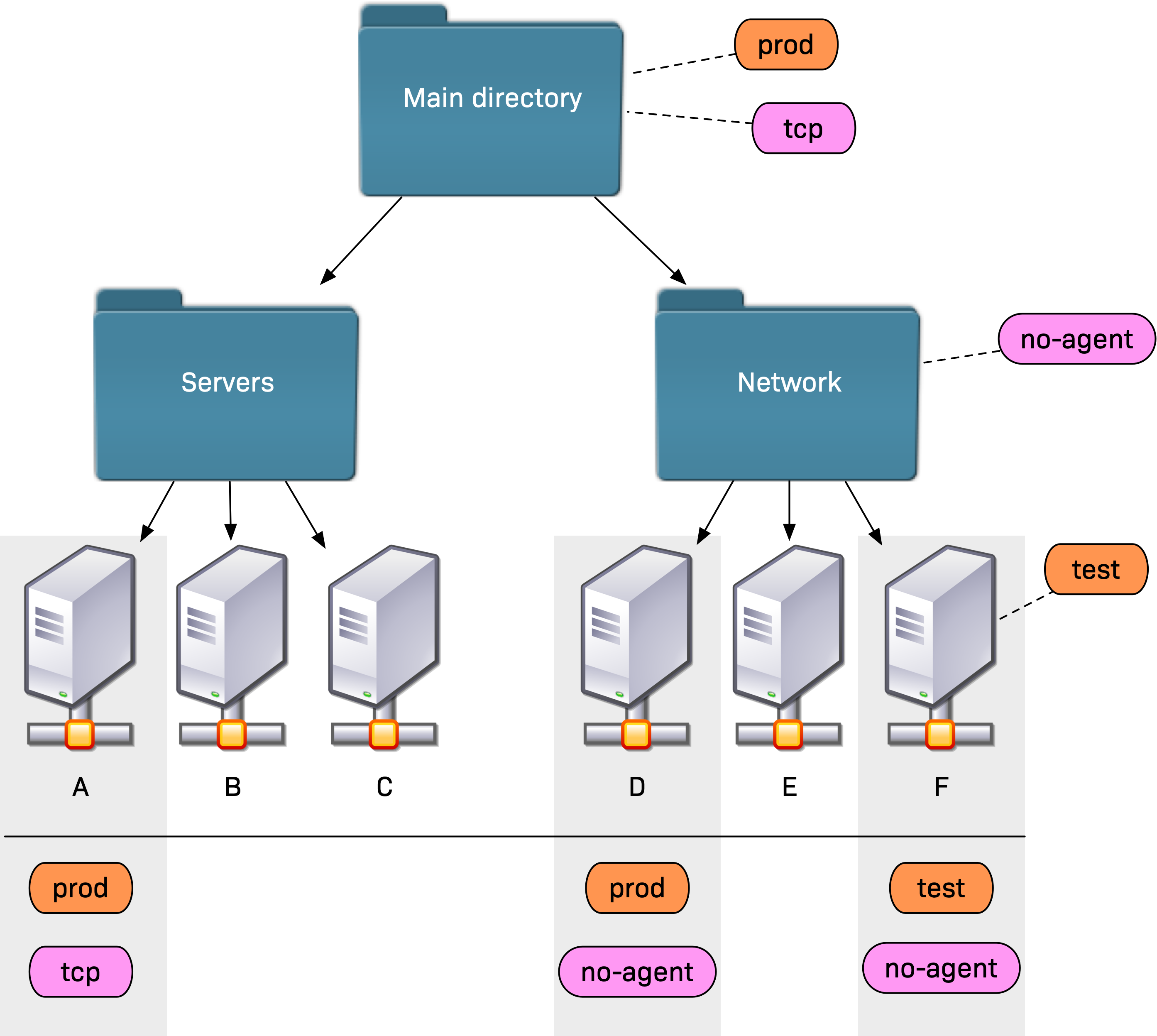

2.2. Inheriting attributes
If you build the tree cleverly, you can use it to inherit attributes in a meaningful way. This is especially useful for those attributes that are common to large groups of hosts, such as the SNMP community or host tags that you use to determine whether the host should be monitored by a Checkmk agent or by SNMP.
The following example shows the inheritance of the tag groups 'Criticality' (with the values prod and test) and 'Checkmk agent / API integrations' (with the values tcp and no-agent). The tcp auxiliary tag is automatically set when the Checkmk agent and/or an API integration is selected, while no-agent is the option of choice when monitoring via SNMP.
Illustration of a folder structure with attributes assigned at different levels.
Attributes defined further down the tree always take precedence. So values defined directly at the host override anything coming from the folders. In the above example, this results in prod and tcp for host A, prod and no-agent for D, and test and no-agent for host F because of the explicitly assigned attribute.
A major advantage of this scheme over the widely used 'copy & paste' approach of database-oriented configuration systems is that any specified attributes will be received by hosts added in the future. This makes work easier for you and your colleagues: Just drop a new host into the appropriate folder and all the predefined attributes will automatically be correct.

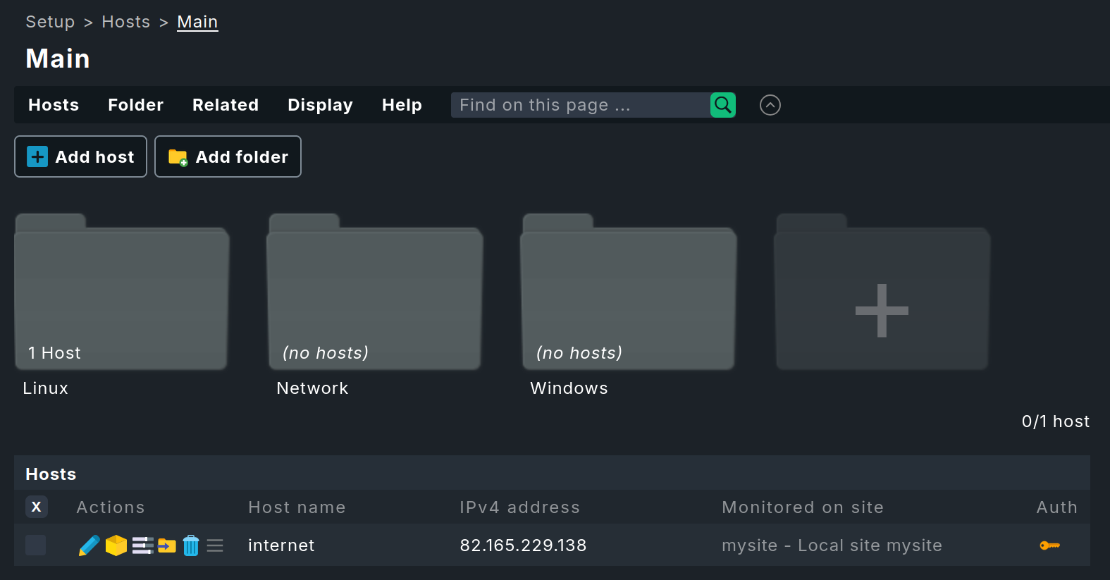

3. Creating and editing hosts in the Setup menu
To manage folders and hosts, go to Setup > Hosts > Hosts:
Folder view 'Main' with multiple subfolders.
Here in the default view you can see an overview of the folders and below these, in tabular form, the hosts already present in the current folder. Creating a new host with the icon new Add host action button, the Icon to clone a list entry. clone or the Icon to edit a list entry. edit of an existing host will bring you to the Properties of host page. This lists the attributes of the host. These attributes are grouped into several sections, the most important of which we present here.

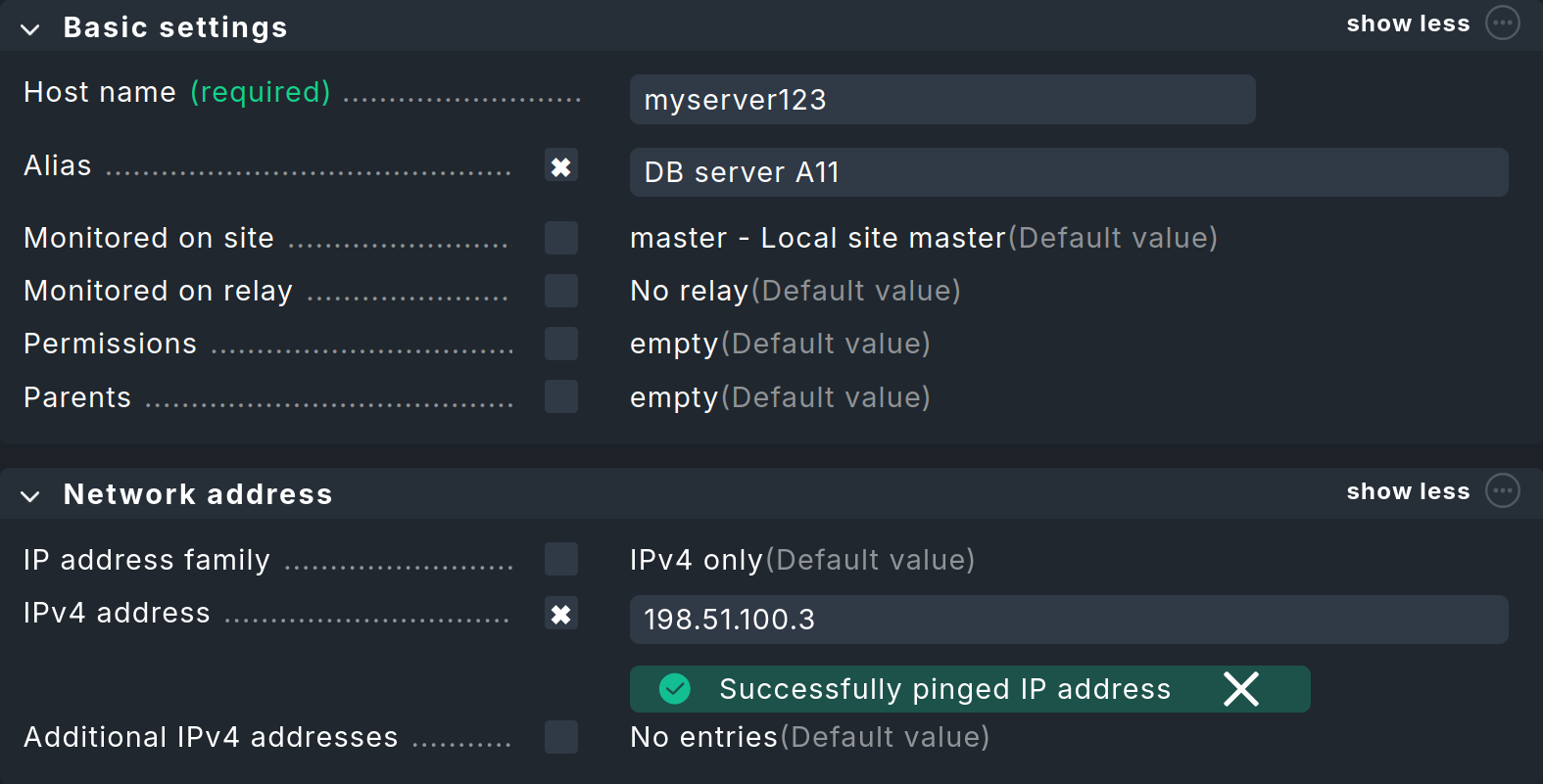

3.1. The host name
The Host name field is used everywhere within Checkmk to uniquely identify the host.
Dialog with host properties: the host name.
The basic settings of a host in Checkmk Ultimate
Whenever possible, you should use the host’s DNS name. Checkmk checks for you whether the host can be found by its name in the DNS. Even as you type the host name into the input field, Checkmk checks in the background whether the name can be resolved and then tests whether the host can be reached.
If the DNS name is too bulky, an easier to recognize alias name can be assigned later. Note, however, that Checkmk allows a maximum length of 240 characters for the host name.
Changes to the host name are in principle also later possible, however since the host name is used in many places in Checkmk, later changes are more complex and time-consuming when monitoring data has already been accumulated by the time the change is to made.
In the Basic settings box, you have two options for specifying where the host should be monitored from. With Monitored on site, you select the Checkmk site, and with Monitored on relay, you select the Checkmk Relay. The selection of a site is relevant in distributed monitoring, and you can only select a Checkmk Relay if it has already been set up.
3.2. Alias and IP address
You can assign an alternative, descriptive name for the host under Alias, which is displayed in many places in the GUI and in reports. If you do not assign an alias, the host name will be used instead.
Dialog with properties of a host: alias and IP address.
Assigning an alias and an IP address to the host
You do not necessarily have to specify an IP address. However, if you enter an IP address, Checkmk skips the check for host name resolvability and directly tests the connectivity of this IP address. You will then see the result in the field containing the IP address.

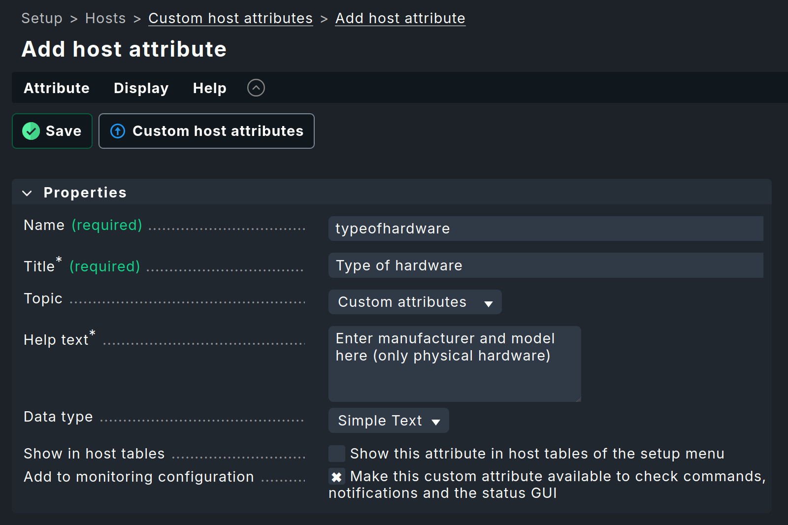

3.4. Custom attributes
In the Custom attributes box, you can display any freely-coded text fields that you have previously created as your own custom attributes. By default, Labels and the two predefined host tag groups Criticality and Networking Segment are present here:
Dialog with the properties of a host: Custom attributes.
The attributes available by default
You can define custom attributes using Setup > Hosts > Custom host attributes.
Form for creating a custom attribute.
An attribute for the hardware type
Custom attributes can be, for example, an on-site contact, a branch number, hardware information, inventory numbers, or geographic coordinates. Custom attribute values should primarily help users to keep track, but can also be used in rules and filters when, for example, labels or host tags are too inflexible.
Custom attributes can be assigned to any box in a host’s properties by selecting Topic (topic).

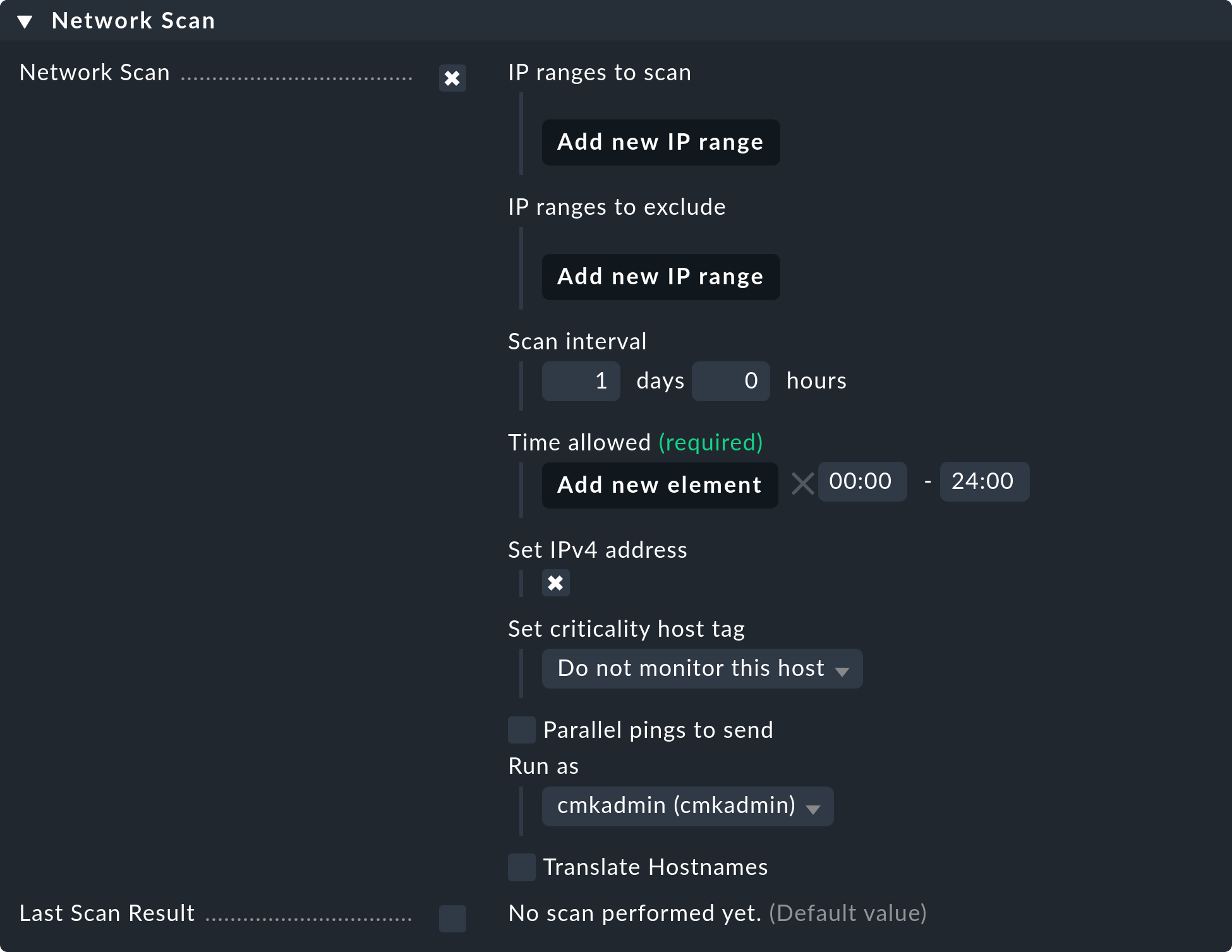

  • Network scan: The host was found during an automatic network scan.

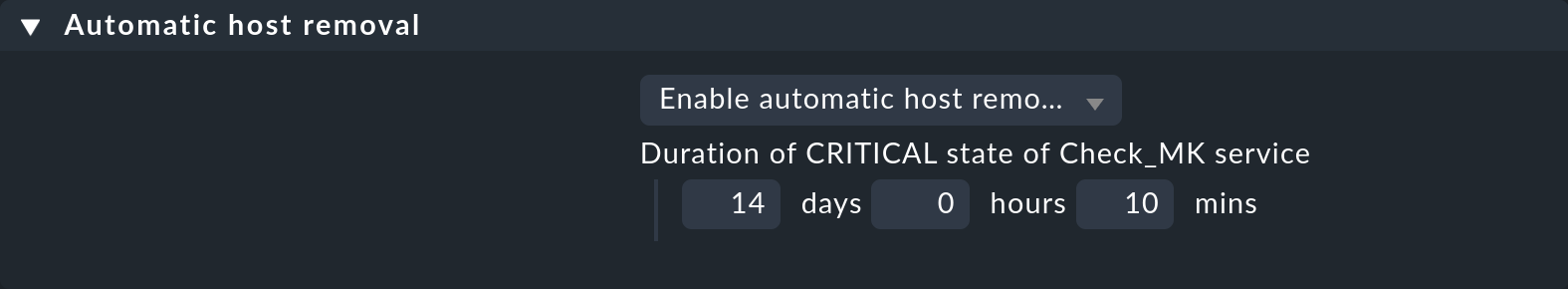

4. Automated host removal
You can have hosts that no longer exist automatically removed from the configuration environment and the monitoring environment. Upon automatic removal the mutual trust relationship (mTLS) is also deleted, which means that in case of reappearance of a host the registration procedure must be performed again.
The criterion used to decide whether a host is actually still there is the state of the Check_MK service. This service is responsible for the state of the monitoring agent running on the host during operation. If there is no longer a connection to the agent — and thus no current monitoring data — the service will switch to the CRIT state.
Hosts whose Check_MK service has been CRIT for a specified period of time can be removed automatically. This is done with the Automatic host removal rule, which can be found under Setup > Hosts > Host monitoring rules. This rule is simple. You simply define the time period in which the Check_MK service needs to be in the CRIT state before its associated host is removed:
Rule specifying the time period triggering automatic removal of hosts.
Here, hosts are automatically removed after 14 days
To remove the hosts not only from the Setup but also from the monitoring, the changes are activated automatically. Note that during the automatic activation, any other pending changes will also be activated.
This rule is available in all Checkmk editions. However, it fits particularly well as a counterpart to the option to have hosts created automatically, which is included in the scope of functions of Checkmk Ultimate. If you want to have automatically created hosts automatically removed again, you can restrict the rule’s condition to hosts with the cmk/agent_auto_registered:yes host label. Checkmk attaches this label to all automatically created hosts.
Note that the dynamic host management also provides the option to have hosts removed automatically. Both options for lifecycle management work independently of each other, i.e. a host will be removed if one of the two conditions is met.

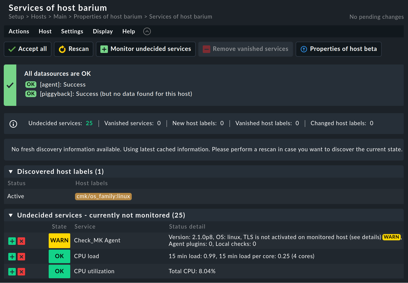

5. Configuring services
The next step after creating a host is to configure the services to be monitored on it. You can learn all the details covering the automatic discovery and configuration of services in the article Understanding and configuring services. We will describe only the most important points here.
The list of a host’s configured services can be accessed in the following ways:
  • In Setup, via the host list:
    Select Setup > Hosts > Hosts. In the host list, click Icon to display the configured services..
  • In Setup, via the properties of a host:
    Select Setup > Hosts > Hosts. In the host list, click the required host. On the Properties of host page, select Host > Save & run service discovery. If you select Host > Run service discovery from the menu instead, you will also go to the service list — but without saving the host properties.
  • In monitoring, via the list of services of a host:
    Select the Host menu, and in the Setup section select the Run service discovery entry. A small gear symbol at the icon shows that this menu entry leads into a page in the Setup. This will take you directly to the service configuration.
Whichever method you choose, the result should look something like this:
List of services found on the host.
The most important actions are available to you in the action bar, others can be found in the Actions menu. Some notes on the possible actions:
  • The Accept all button is usually the best action for a new host. This is also the right choice for existing hosts in which services are found that are not currently being monitored. These can be found in the Undecided services (currently not monitored) section. Accept all adds the missing services, removes vanished services and accepts any host labels found.
  • The Rescan button ensures that fresh, complete data is fetched from the target device. To enable faster page loading, Checkmk works with cached files that are recorded during normal monitoring. For SNMP devices, the button therefore triggers an active search for new check plug-ins and may also find additional services.
  • The Monitor undecided services button transfers the corresponding services to the monitoring, but without transferring the host labels.
  • Remove vanished services removes services that no longer exist. This is useful for services that remember a current state on discovery (e.g., the current state of a switch’s ports or of file systems and their mount points).
  • After each modification an activate changes is required to make them effective.

As mentioned above, the network scan is set up at the folder level. First open Setup > Hosts > Hosts. Then navigate to any folder or stay in the Main folder. Via the Folder > Properties menu you will find the Network Scan box.
Disabled _Network Scan_ box in the properties of a folder.
Enable the network scan using the corresponding checkbox.
Activated but unconfigured _Network Scan_ box.
Then, at IP ranges to scan, specify the IP addresses that Checkmk should automatically monitor for you. For this definition you have the choice between single IP addresses, IP ranges and whole networks. We recommend not selecting too large an address range, otherwise the network scan may take a very long time. When choosing a network, we also recommend not to exceed the net mask of /21, which corresponds to 2048 IP addresses. You should not exceed the number of 2048 IP addresses even when selecting via IP-Range. Of course, this can only be a rough recommendation, since your (organizations) network may be able to handle larger address ranges without any problems.
The following IP ranges to exclude option allows you to exclude parts from the address range configured above. This option is also useful for excluding hosts or IP addresses from the network scan that are already known and being monitored. In this way, you can prevent duplicate hosts from being created.
The following two options Scan interval and Time allowed allow you to specify how often the scan should run and at what time you want to allow it.
One of the most important considerations when setting up network scanning is how you want to handle any hosts that are found. The Set criticality host tag option plays a central role here:
  • By default, Do not monitor this host is selected. This specifies that the hosts found are only included in the host administration for the time being. An actual monitoring does not take place. One approach could be to manually move the discovered hosts into your existing host structure — for example using the Move this host to another folder function. After moving, you will then need to customize or remove the Criticality host tag. If you have a large number of hosts, you can use the Remove explicit attribute settings function in Setup > Hosts > Hosts.
  • If you instead select Productive system as the host tag here, the hosts found — if configured appropriately with the Periodic service discovery rule set — will also be included directly in monitoring.

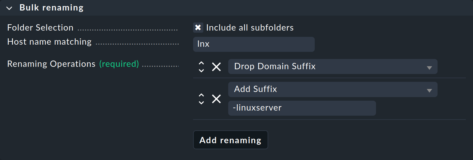

The Bulk renaming of hosts allows simultaneous, systematic name matching for multiple hosts:
Dialog for renaming multiple hosts.
In the Host name matching field, first optionally specify a regular expression that matches the beginning of the host names you want to rename — so here in the example, all hosts whose names start with lnx. Then add one or more operations with Add renaming. These are applied in sequence to the host names. In the above example, first Drop Domain Suffix truncates everything following the first . from all host names, and then Add Suffix adds the -linuxserver suffix to the names.
Further operations are available, most of which are self-explanatory. Otherwise you can get more information via the inline help.

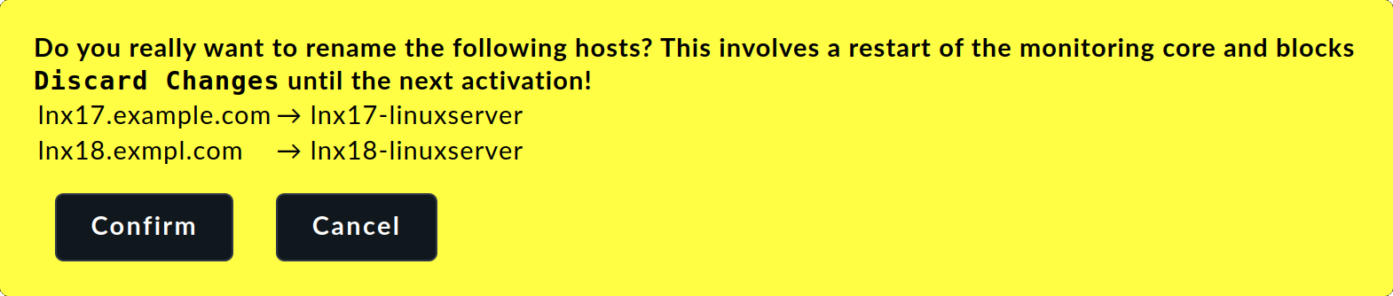

After starting the renaming procedure with Icon to save input. Bulk rename and confirming the obligatory "Are you sure…​?" question …
Dialog to confirm host renaming.
… completing the process may take a while. During the renaming process the monitoring will be completely stopped! This is necessary to maintain everything in a consistent state. At the end of the process you will get an overview of exactly where renames were performed:
Result of host renaming.
