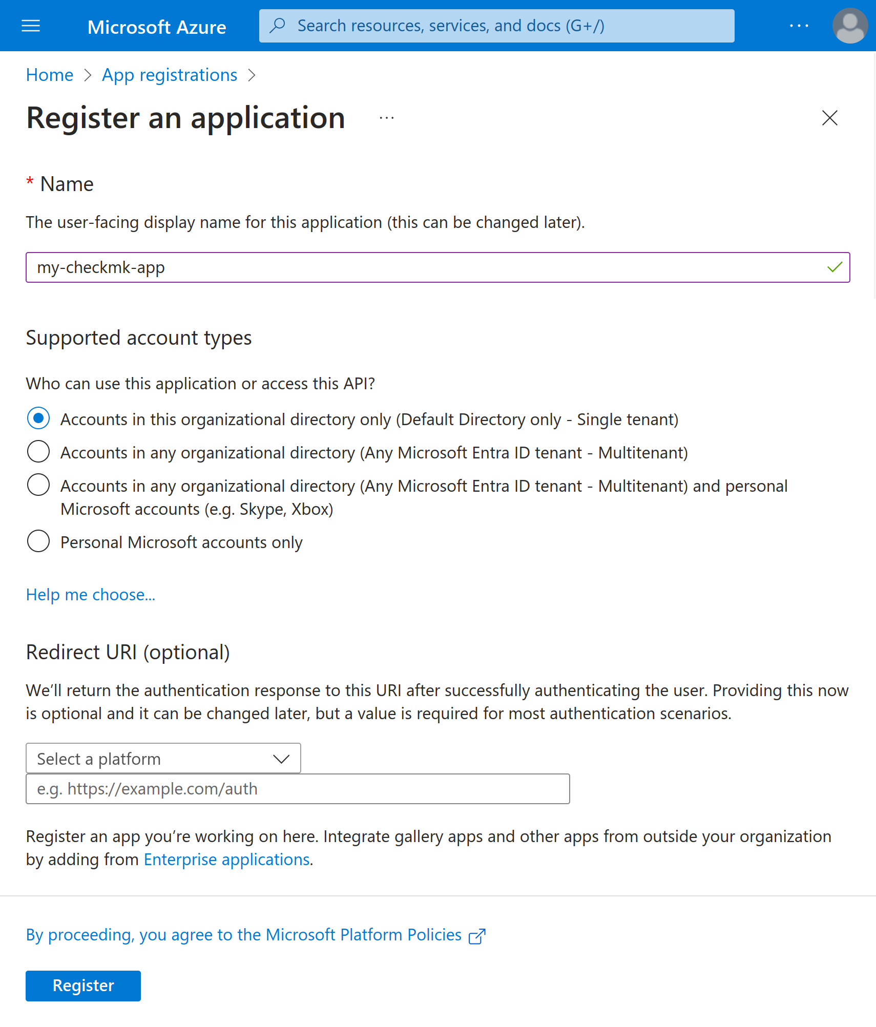

3.1. Creating an app
First register an app in Azure. This app will be used by Checkmk to read the desired data from Azure. You will find the option for this in the Azure portal under (All services > Identity > Identity management > ) App registrations. Alternatively, here you can use the portal search and enter App registrations. Once on the page, you must now click on New registration.
Assign an identifying name of your choice. In the example, we use my-checkmk-app. This name is only for information purposes, however. Instead, the reference to the app is made via the application ID, which you will see in the next step. You do not need to change anything in the Supported account types section and the Redirect URI field must remain empty. Confirm your entries by clicking on Register.
azure register 1
Once you have created the app, you should see an overview of this new app. If this is not the case, you will find the new app in the list of all App registrations described above in the All applications tab. In the details for the app, you will now find both the Application (client) ID and the Directory (tenant) ID, which you must enter later in Checkmk.
azure register 2

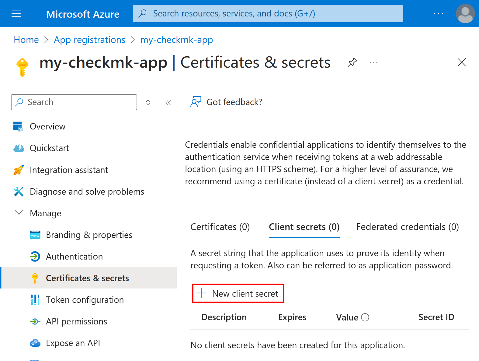

3.2. Creating a client secret for the app

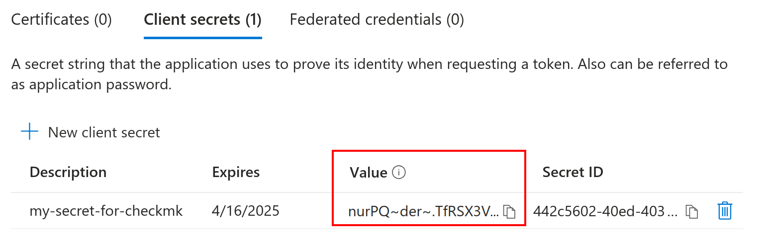

Next you will also need a client secret with which Checkmk can log in to the Azure API. To generate such a secret, click on Certificates & secrets in the app overview, then on the Client secrets tab and finally on New client secret.
azure register 5

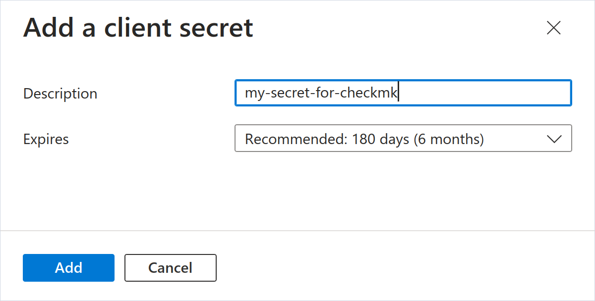

This opens the Add a client secret dialog. Assign any name and select for how long the secret should be valid. If you later activate the App Registrations option in the rule for the special agent, you will receive a practical service that reminds you when this validity period is coming to an end. Confirm the dialog by clicking on Add.
azure register 6
It is important now that you copy the Value content in this new secret immediately, since after a certain time, only the first three characters of such secrets will be displayed in the Azure portal.
monitoring azure copy secret

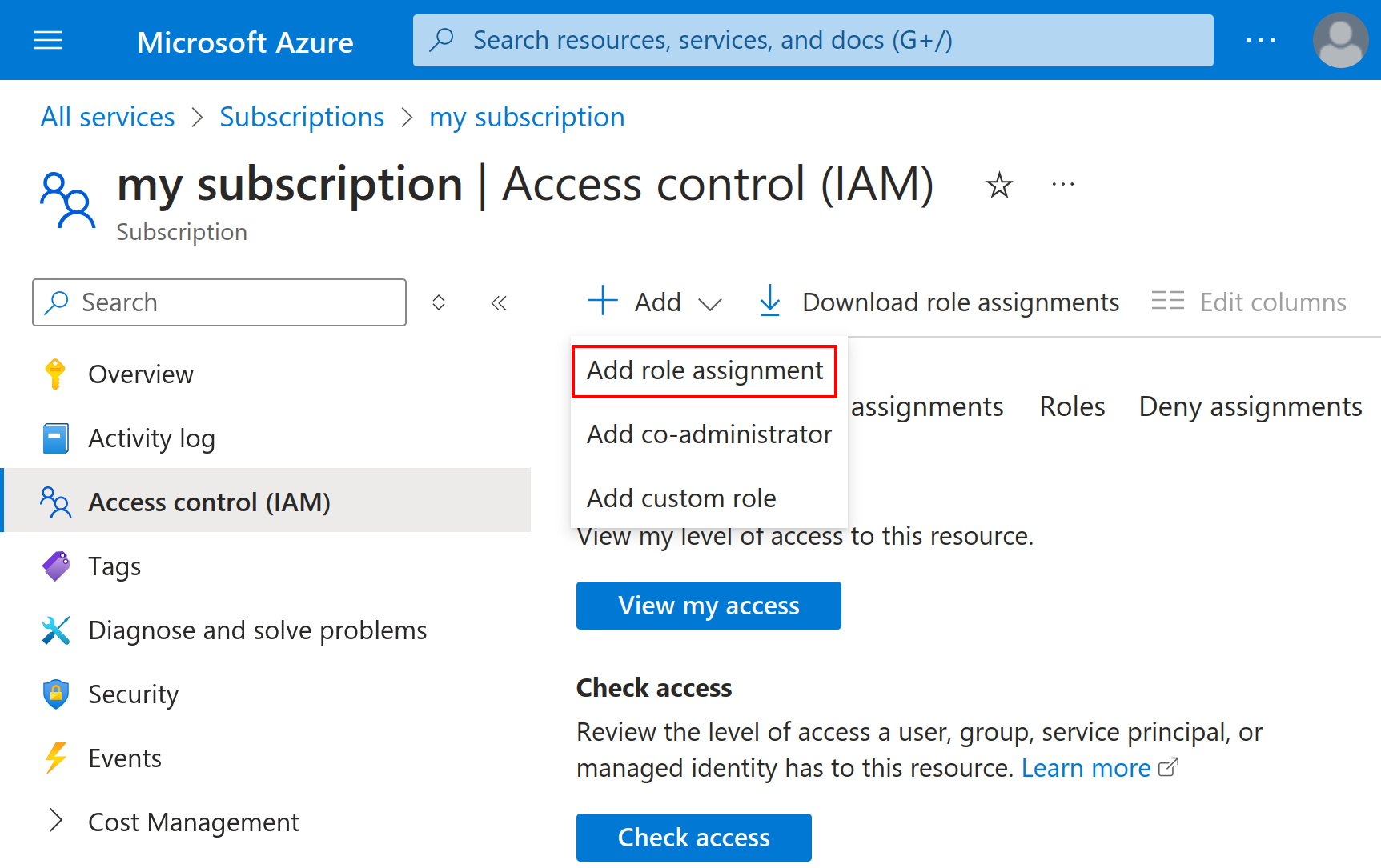

3.4. Assigning a role to the app
To enable Checkmk to access the monitoring data via the new app, you must assign a role to the app at the subscription level. To do this, select All services in the main navigation on the left-hand side and then under General the Subscriptions entry. Again, you can use the search function in the portal if you cannot find the relevant button.
If you have multiple subscriptions, you will now need to click on the name of the subscription you wish to monitor. You will then be taken to an overview page for your subscription. Make a note of the Subscription ID here. You will need to enter this later in the special agent rule.
Then click on Access Control (IAM) and then on Add and then on Add role assignment:
azure access control
Now select the role named Reader and with the Type BuiltInRole. As there are in total over 100 roles with the word 'Reader' in their name, it is important to be careful here. Then click on Next to go to the Members tab.
Click here on + Select members.
azure role assignment
In the Select members dialog, enter the name of the app as you created it earlier into the search field, select this app and click Select. After two more clicks on Review + assign, the setup in the Azure portal will have been completed.

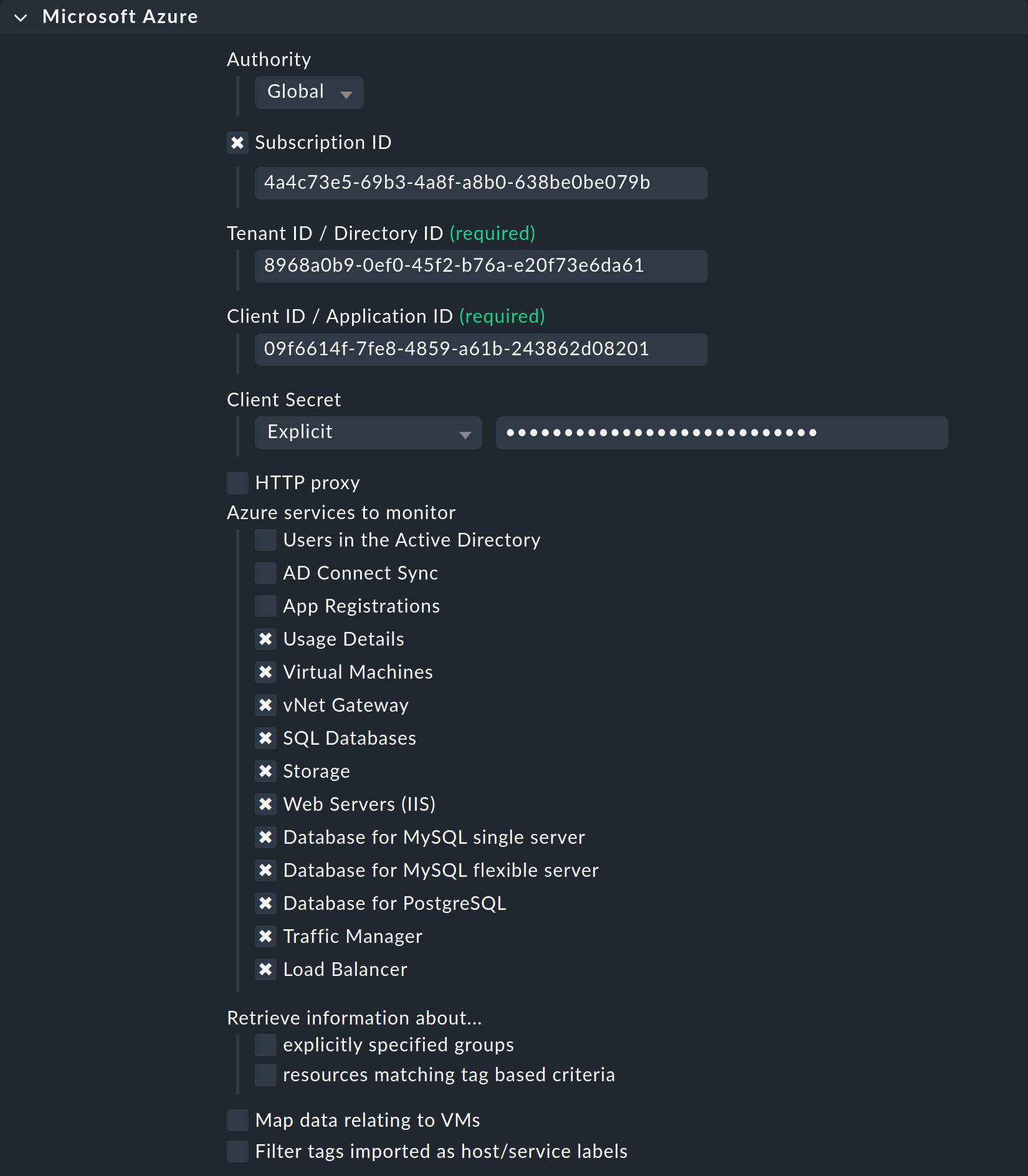

Since Azure cannot be queried through the regular Checkmk agent, you now set up the Azure special agent. In this situation Checkmk does not contact the target host over TCP port 6556 as usual, instead it calls a utility that communicates with the target system via Azure’s application-specific API.
To do this, under Setup > Agents > VM, cloud, container > Microsoft Azure create a rule whose conditions apply exclusively to the Azure host that has just been created. There you will find the input fields for the IDs and the secret:
azure agent rule
Here you can also select the resource groups or resources that you want to monitor. If you have not checked explicitly specified groups, all resource groups are automatically monitored.

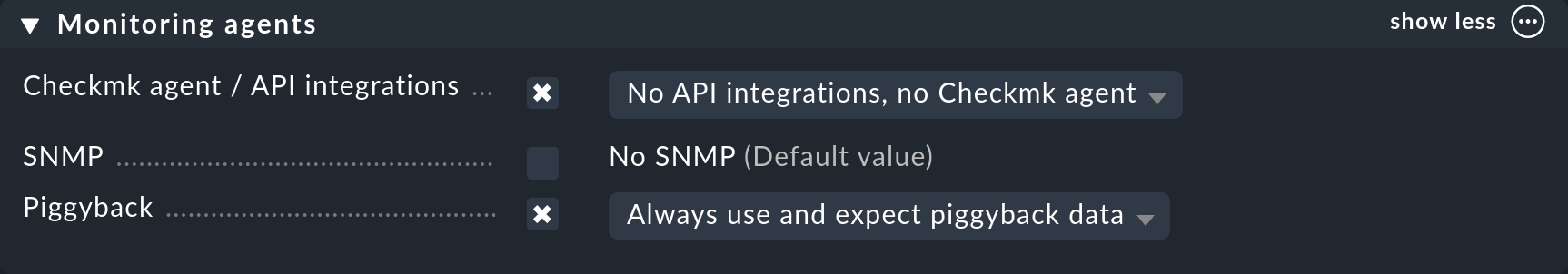

Configure the resource group hosts without an IP address (analogous to the Azure host), and select No API integrations, no Checkmk agent as the agent and Always use and expect piggyback data as piggyback.
wato host no agent
If you now perform a service discovery on one of these resource group hosts, you will find there are additional services that specifically relate to this resource group:

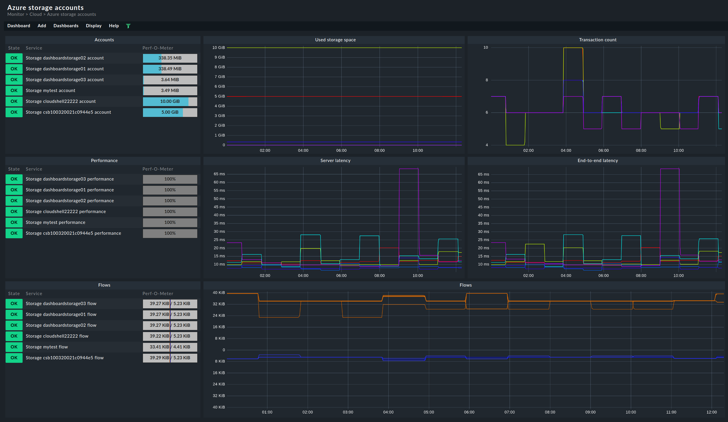

CEE For a convenient start into Azure monitoring, Checkmk ships in Checkmk Ultimate the two built-in dashboards, Azure VM instances and Azure storage accounts. Both of these can be found as menu items in the monitoring under Monitor > Cloud.
To provide a clearer impression, following are two examples of how these dashboards are structured. First, the VM instances dashboard, in which you can compare the current state on the left side and the chronological history of the most important metrics on the right side:
Dashboard for the Azure VM instances.
The dashboard for the storage accounts is structured very similarly. On the left-hand side, you will find current data for the respective buckets. On the right, the most important metrics are again displayed chronologically:
Dashboard for the Azure storage accounts.
