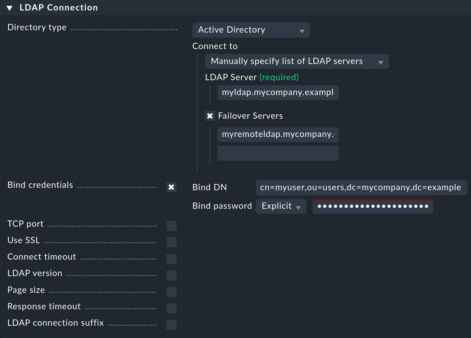

Next, under LDAP Connection the LDAP server can be defined, as well as one or more failover servers if they are available. Then only the Directory type needs to be selected, and the user data for the read-access defined under Bind credentials. Note that the username with its full LDAP path must be entered. Upper and lower case must not does not need to be taken into account. The configuration should then look something like this:
ldap new connection ldap connection
Checkmk supports more than just Active Directory. To alter the directory to, e.g., OpenLDAP, select it in the Directory type field — further configuration alterations resulting from this action occur in only a few locations.
The Failover Servers are used when the actual server is not accessible, or when a time limit has been exceeded. This makes sense if there is no local own server in use, but it is desired to create a redundant connection.
The connection of Checkmk with the LDAP server is always maintained until the LDAP server is no longer accessible due to a timeout or other problems. Only then is the switch to the failover server made. The same applies after the switchover: The connection will only revert to the actually configured server if the failover server becomes unavailable.

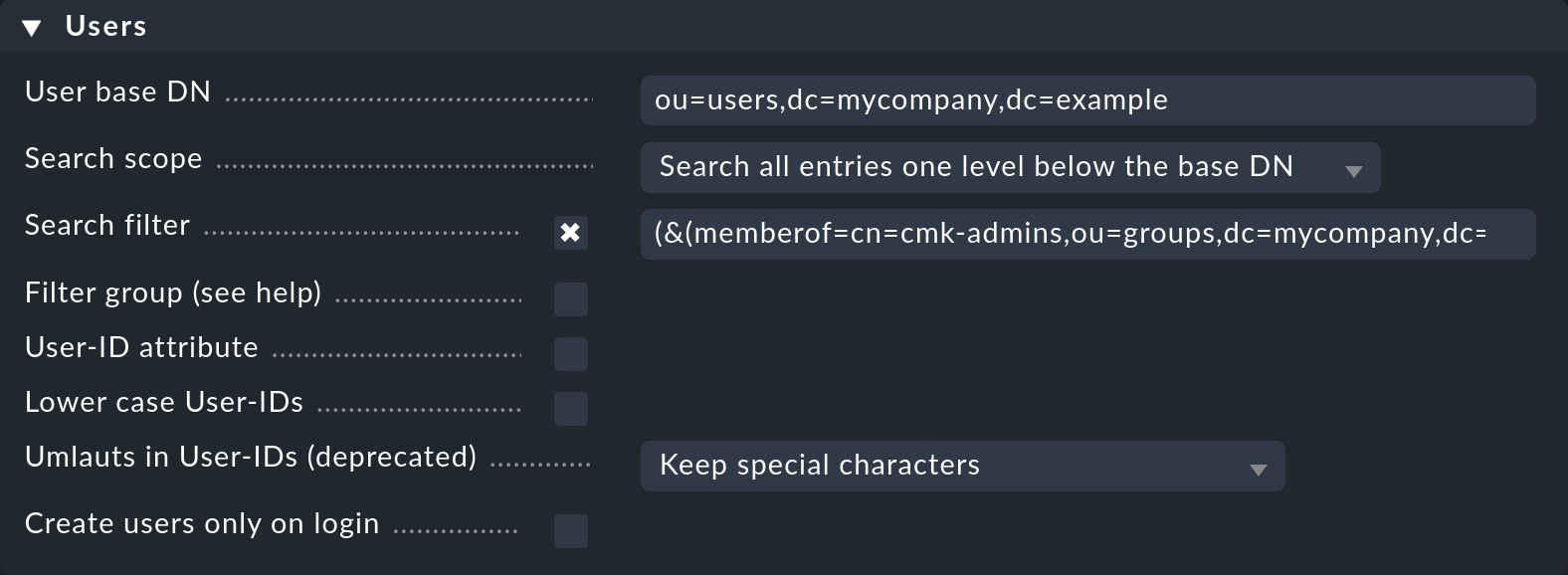

Next the paths to the users and groups will be defined, and the filters set. In User base DN, first enter the path via which the users are to be found. Make sure here that the Operational Unit (OU) is set so that all desired users and as few others as possible are included. The more users that are queried, the slower the synchronization will be to process.
Next set the Search scope option. Here you can recursively filter for all users located in the OU and in those units below it, or restrict the search to those located directly in this OU. If you have entered a user directly in the path, you should select Search only the entry at the base DN — only this user will then be included.
With the help of the option Search filter you can narrow down the selection of users to be imported even further. If for example you want to synchronize only the users belonging to a specific group, set an LDAP query as shown in the following screenshot. The prerequisite for this is that the users have the memberof attribute. How to filter by group membership, without this attribute, can be learned below.
ldap new connection users
The standard filter can also be combined with the memberof, or with other filters:
(&(objectclass=user)(objectcategory=person)(memberof=cn=cmk-admins,ou=groups,dc=mycompany,dc=org))

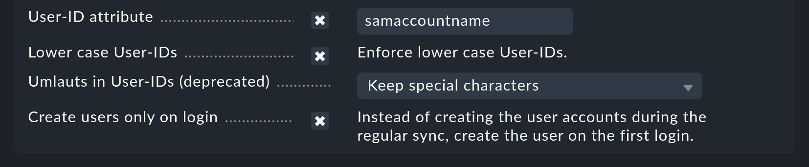

As can be seen in the Users box, there are further options for a user search. With the User-ID attribute option it is possible to specify which attribute the user is to utilize as its login ID in Checkmk. The user will subsequently use this login when signing in. As a rule, in Active Directory it will be the sAMAccountName attribute, which is used as standard in Checkmk. Under OpenLDAP it is often the uid attribute.
With the Lower case User-IDs options you can convert the synchronized IDs to lower-case letters. This is possibly sensible, since as already mentioned, Active Directory/LDAP does not differentiate between upper and lower case letters, but Checkmk does. That can lead to confusion which this option can solve.
The Umlauts in User-IDs (deprecated) option was only provided for compatibility reasons and should no longer be used/altered.
Last but not least the option Create users only on login allows you to create new users only once they login to Checkmk instead of during the synchronization with LDAP.

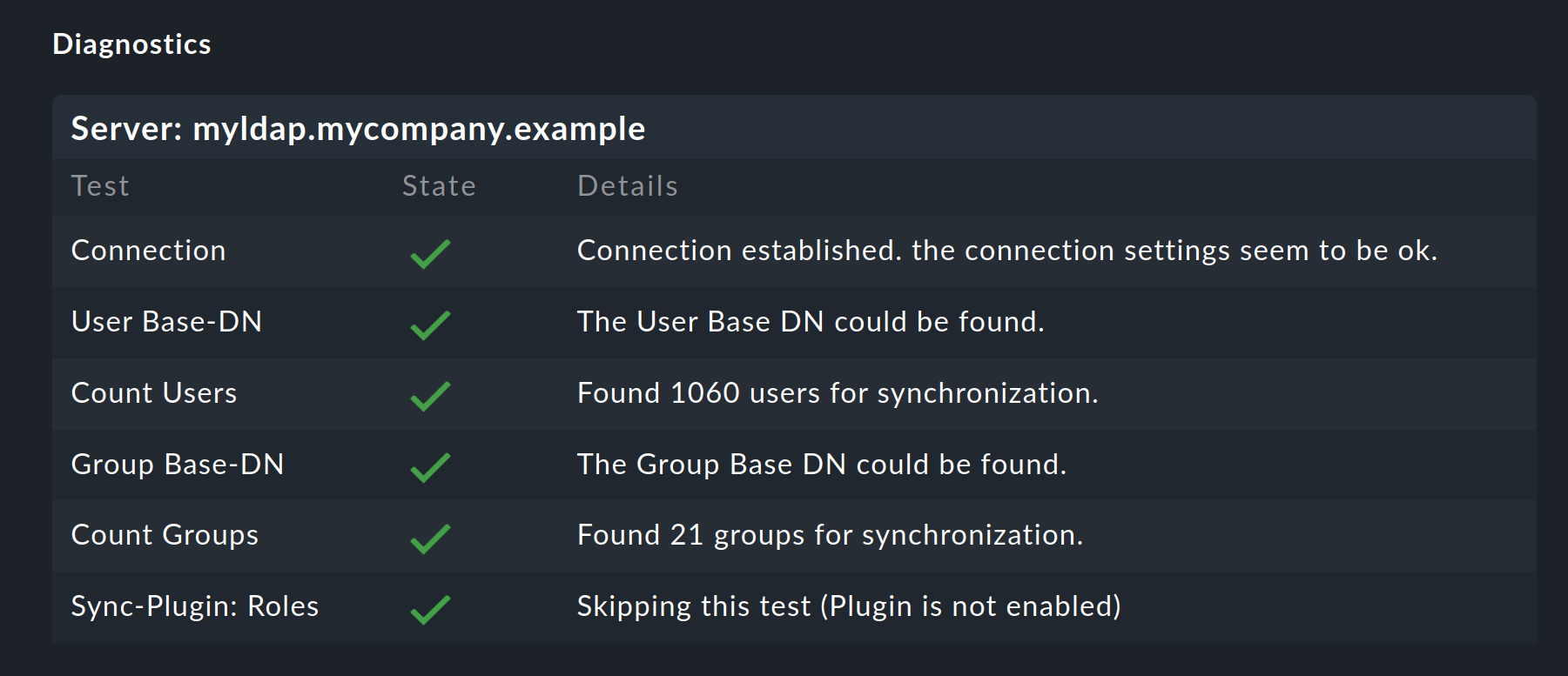

2.4. Testing the configuration
The first setup is now complete, and for diagnosis the configuration can now be saved and tested via the Save & test button.
ldap new connection diagnostics
You don’t need to specify groups to produce a functioning configuration. However, if there are only users for Checkmk in the OU, it makes sense to restrict the selection via one or more groups.

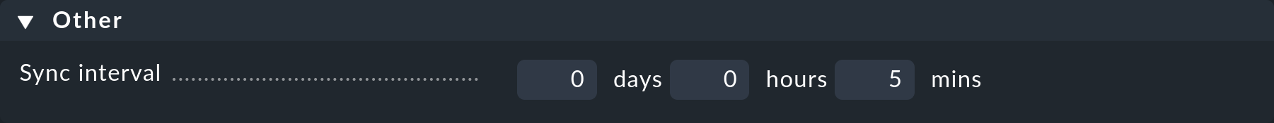

2.5. The synchronization interval
Finally, you can also define how often the users are to be automatically synchronized. In an environment in which changes seldom occur the standard is perhaps too tight. The time frame should not not be too long however, so that any changes can be reflected promptly in Checkmk.
ldap new connection other
A synchronization can be manually initiated at any time in Setup > Users > Users > Synchronize users. In addition, a user will be synchronized if required when they attempt to log in and have not yet been synchronized.

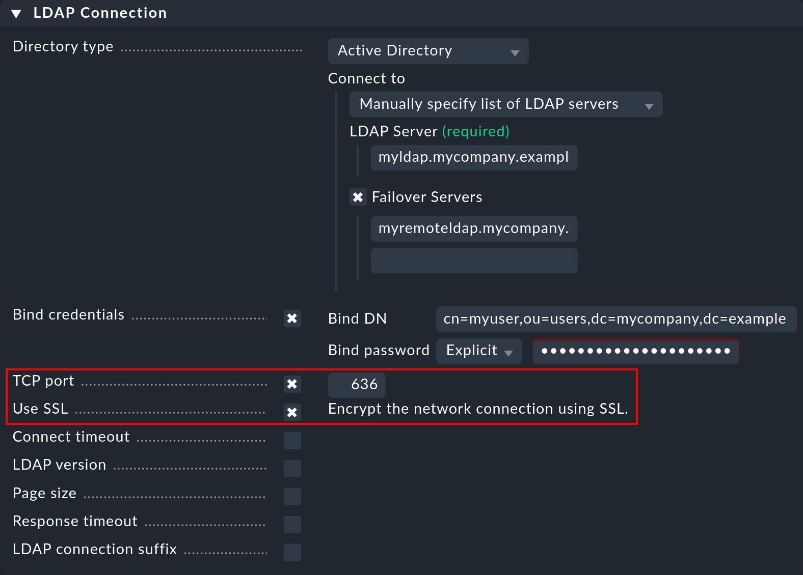

5. Securing LDAP with SSL
In order to secure the LDAP connection with SSL, simply activate the Use SSL checkbox in the connection data and match the TCP port (usually 636 for SSL in LDAP).
ldap new connection ldap connection ssl

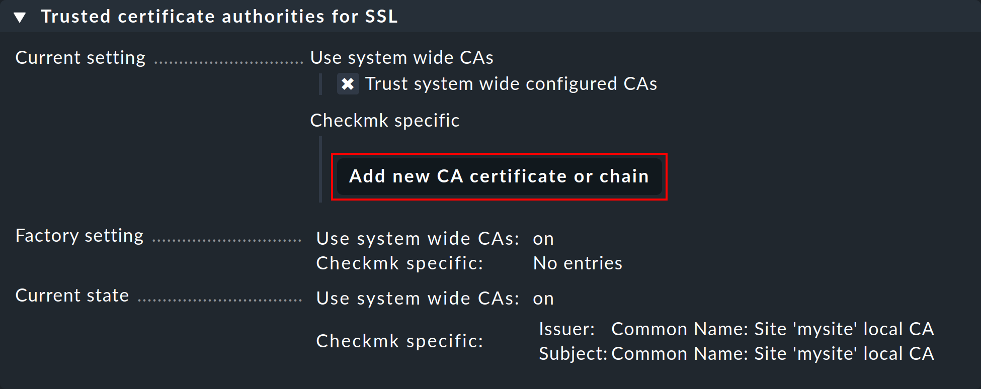

If the LDAP server(s) use a certificate signed by a trustworthy certification authority, everything necessary to establish an encrypted connection is already done.
If a self-signed certificate is to be used, the connection can only be established after the certificate has been imported into the certificate store. Only then will it be classified as trustworthy and the connection established.
In order to do so, simply go to Setup > General > Global settings > Site management > Trusted certificate authorities for SSL. Click Add new CA certificate or chain and either paste in the content of your CRT or PEM file or choose Upload CRT/PEM File and do just that.
ldap add new ca certificate
