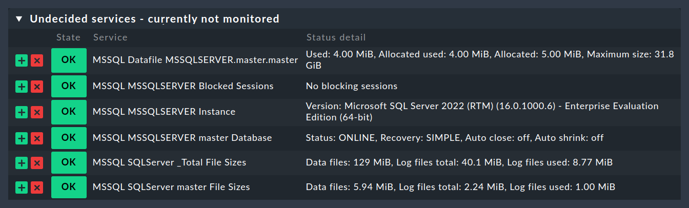

Now that you have installed and configured the plug-in, you can perform a service discovery for this host. The following screenshot shows only a selection of the services that can be found:
Excerpt from the service discovery results.

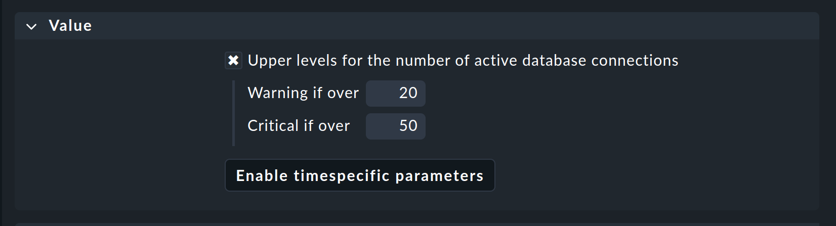

Monitoring connections
You can specify your own threshold values for the utilization of the maximum number of simultaneous connections specified by MSSQL, as these are much more dependent on the structure of your MSSQL instance than with other services. You can set up the appropriate threshold values in no time at all using a rule from the MSSQL Connections rule set.
Setting the upper thresholds for active connections.

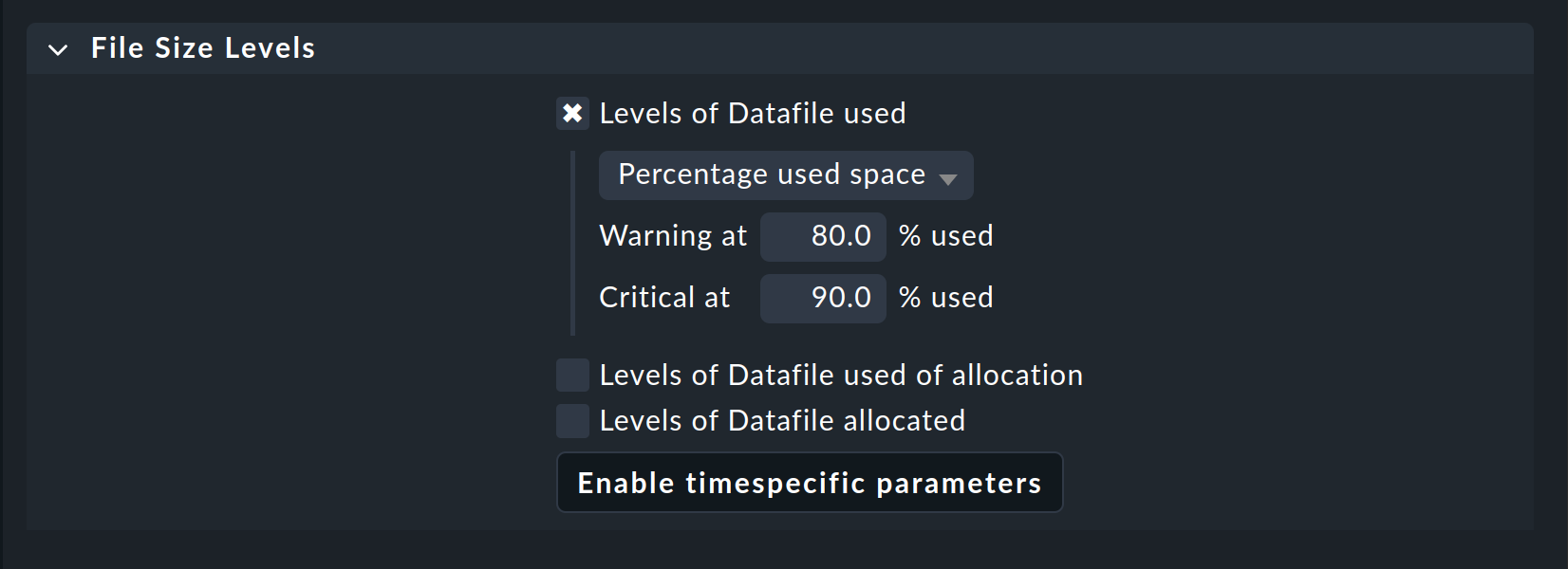

Monitoring file sizes
You can also define threshold values for the size of individual files in MSSQL. To do this, use the MSSQL datafile sizes rule set.
Setting the file sizes used.

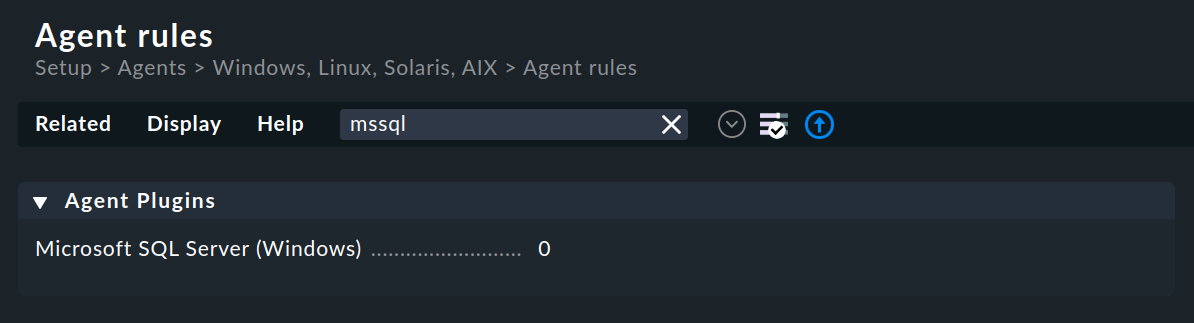

For the initial setup, it is sufficient to setup the database user on the MSSQL host and create a corresponding rule in the Agent Bakery. You can find the rule set under Setup > Agents > Windows, Linux, Solaris, AIX > Agent rules. You can then search for mssql in the search field:
The rule 'Microsoft SQL Server' in the agent rules.
