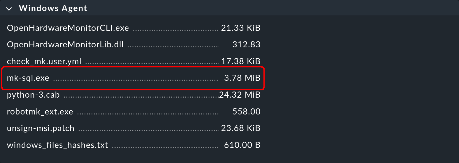

Installing the agent plug-in
The mk-sql plug-in can be found…​

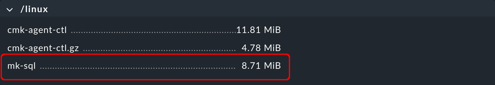

…​in Checkmk Community under Setup > Agents > Linux and in the commercial editions …​under Setup > Agents > Windows, Linux, Solaris, AIX > Related > Linux, Solaris, AIX files:
Selection of the agent plug-in in Checkmk.
Download the mk-sql file and place it on the Linux host in the /usr/lib/check_mk_agent/plugins/ directory.

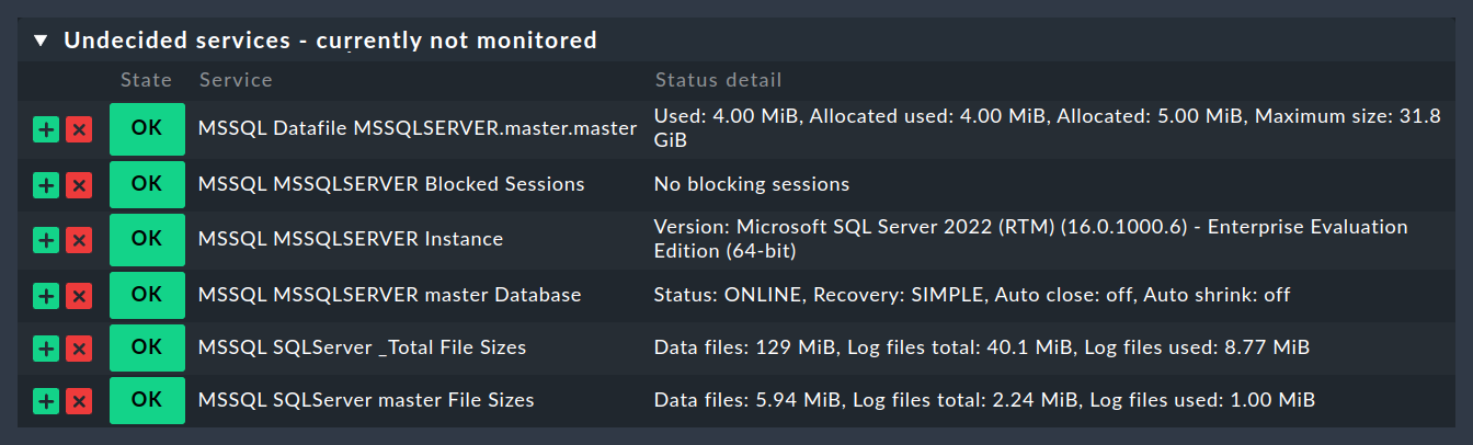

Now that you have installed and configured the agent plug-in, you can perform a service discovery for this host. The following screenshot shows only a selection of the services that can be found:
“Excerpt of the service discovery.”

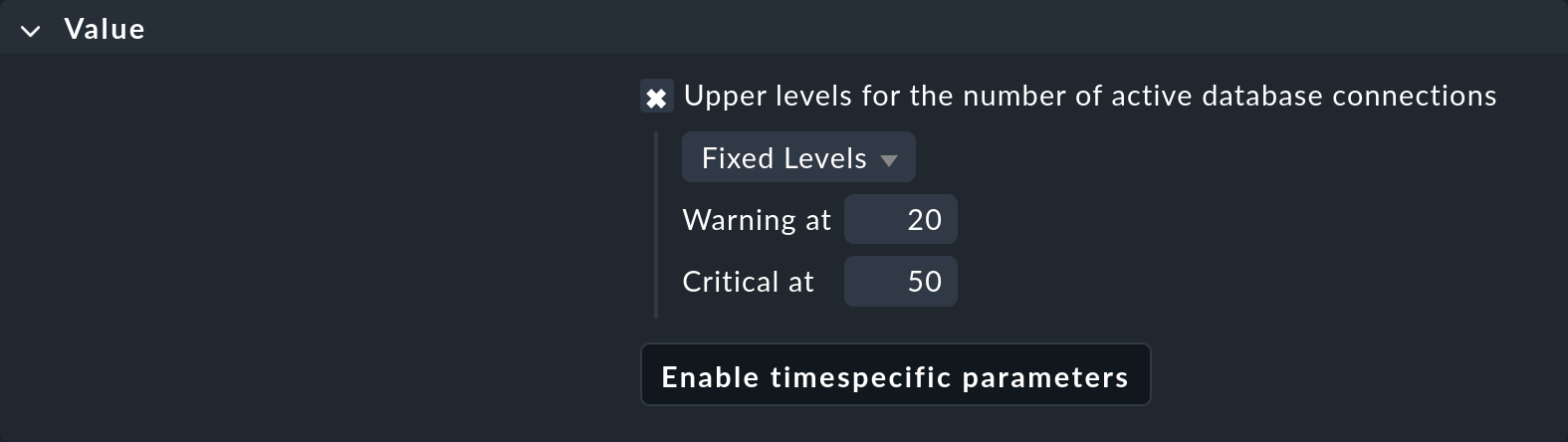

You can specify your own threshold values for the utilization of the maximum number of simultaneous connections specified by MSSQL, as these are much more dependent on the structure of your MSSQL instance than with other services. You can set up the corresponding threshold values in no time at all using a rule from the MSSQL Connections rule set.
“Setting the upper threshold values for active connections.”

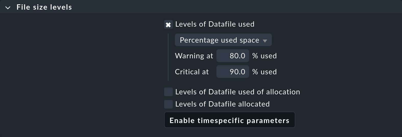

Monitoring file sizes
You can also define threshold values for the sizes of individual files in MSSQL. To do this, use the MSSQL datafile sizes rule set.
“Setting the sizes of files in use.”

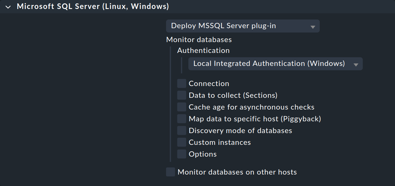

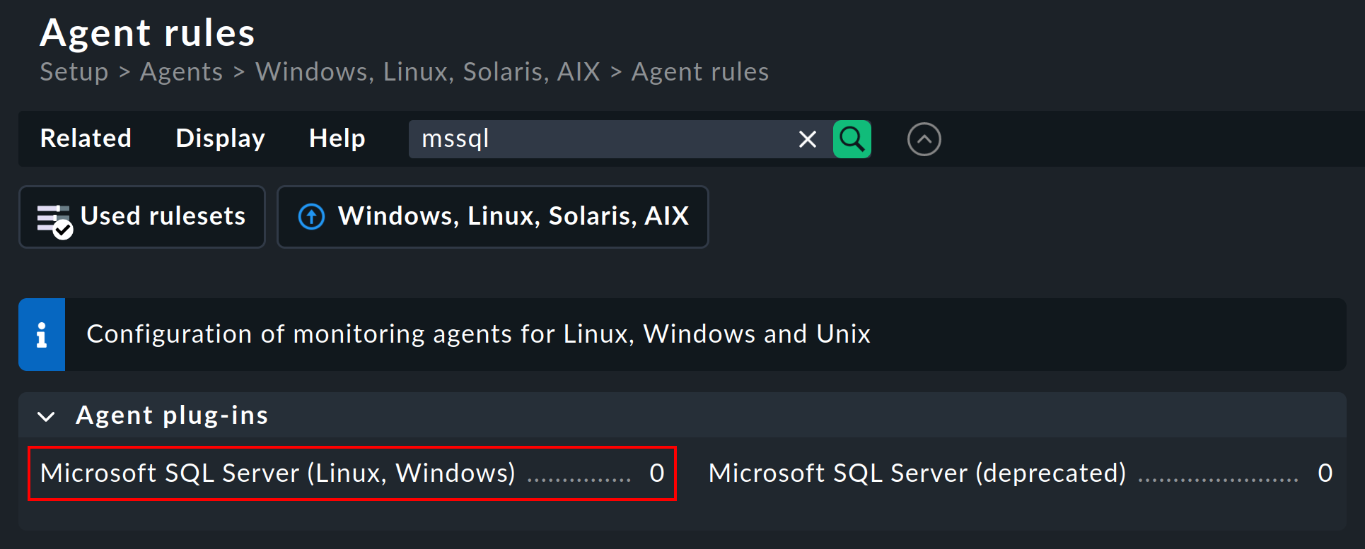

For the initial setup it is sufficient to create a corresponding rule in the Agent Bakery. You can find the rule set under Setup > Agents > Windows, Linux, Solaris, AIX > Agent rules. There search for mssql in the search field:
The rule ‘Microsoft SQL Server (Linux, Windows)’ in the agent rules.

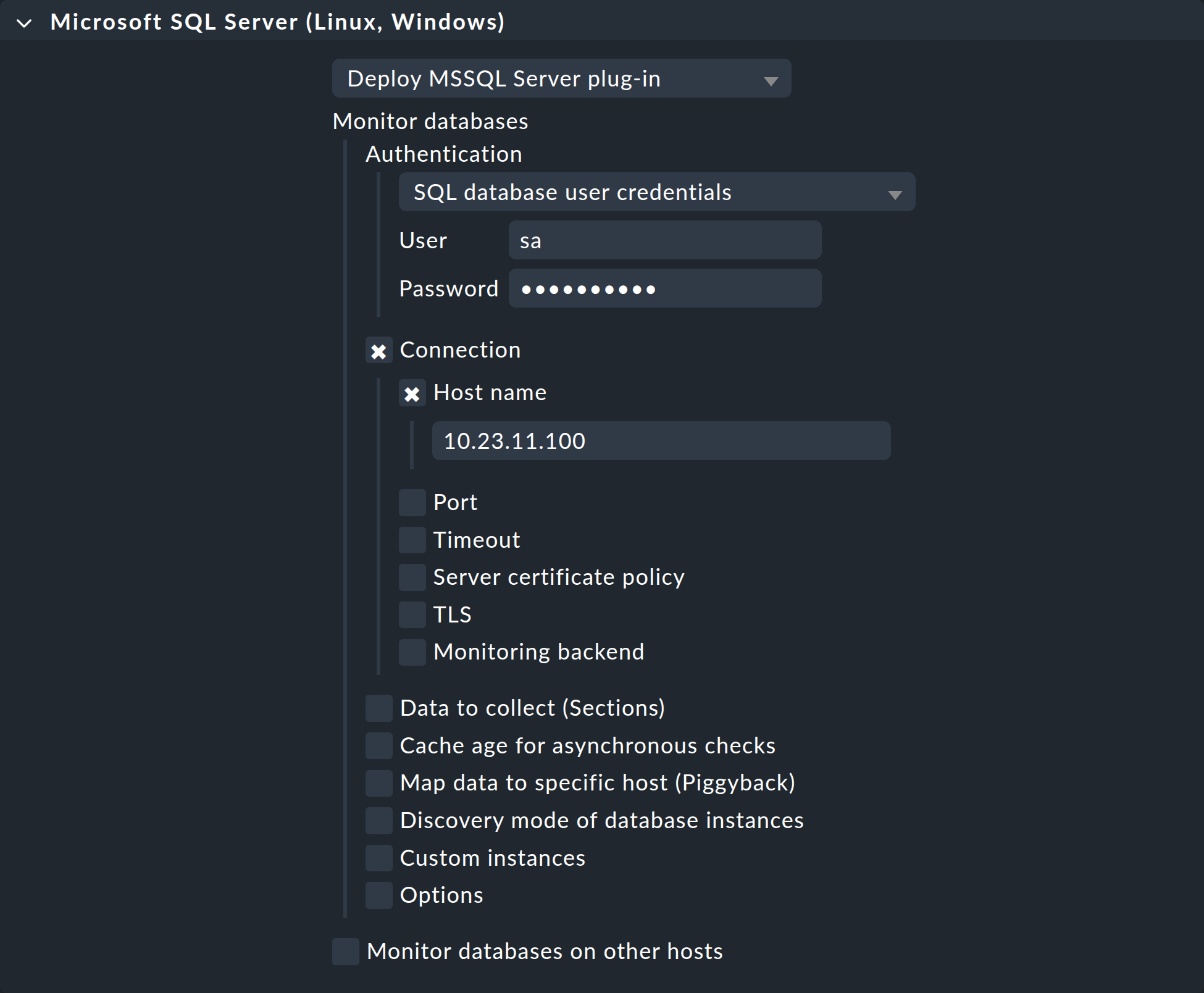

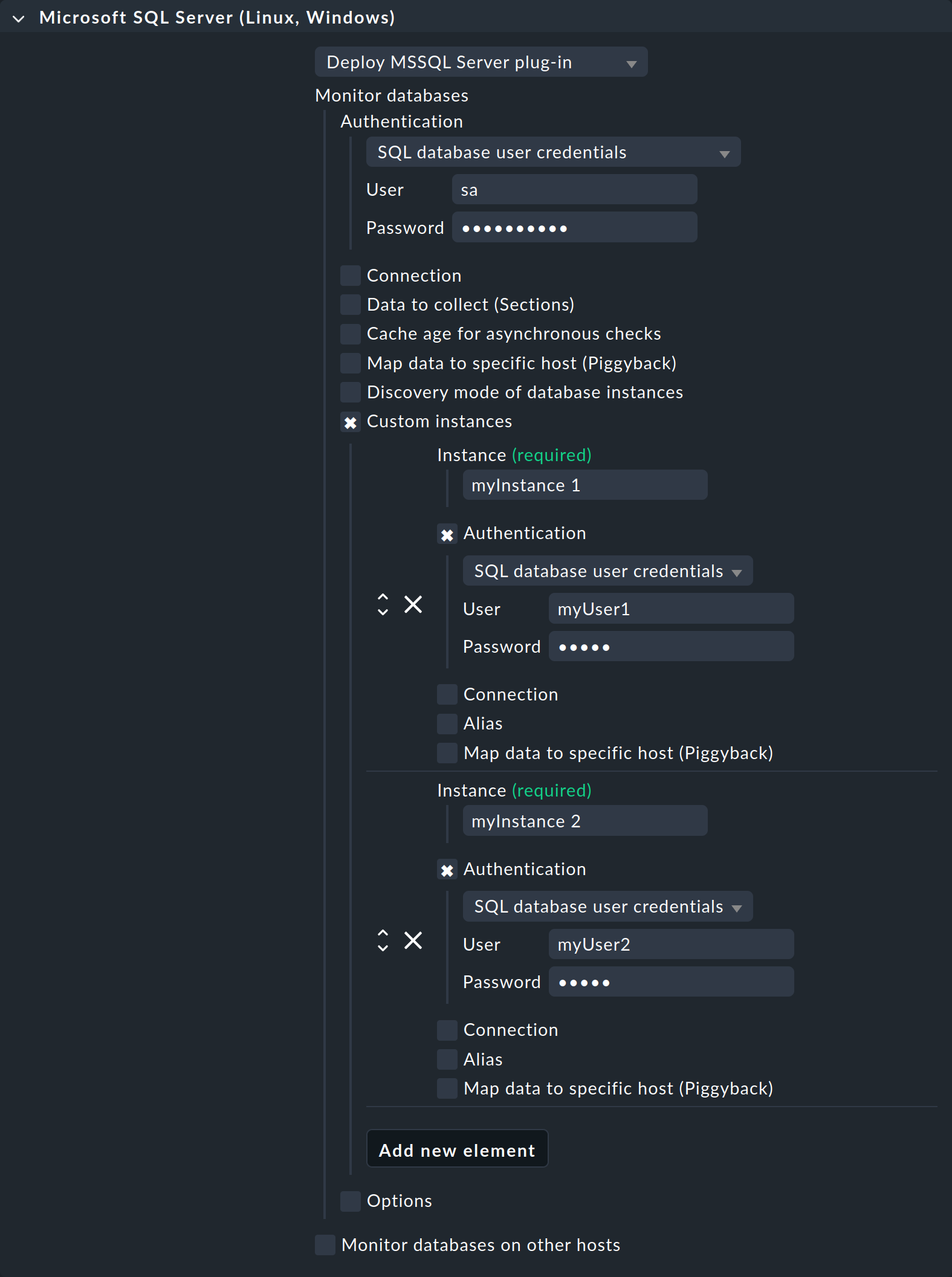

Under Authentication select the SQL database user credentials option.
“Possible settings for the MSSQL server in the Agent Bakery.”
Then enter the Login name in the User field and add the corresponding Password. For the Connection, add the Host name.
If you are running multiple MSSQL instances with different usernames and passwords on the host, select the Custom instances option. Use Add new element to access the details for the first — and then each additional — instance to be monitored. Enter the access data for each instance here, as described above.
“Multiple MSSQL instances in the Agent Bakery rule.”
