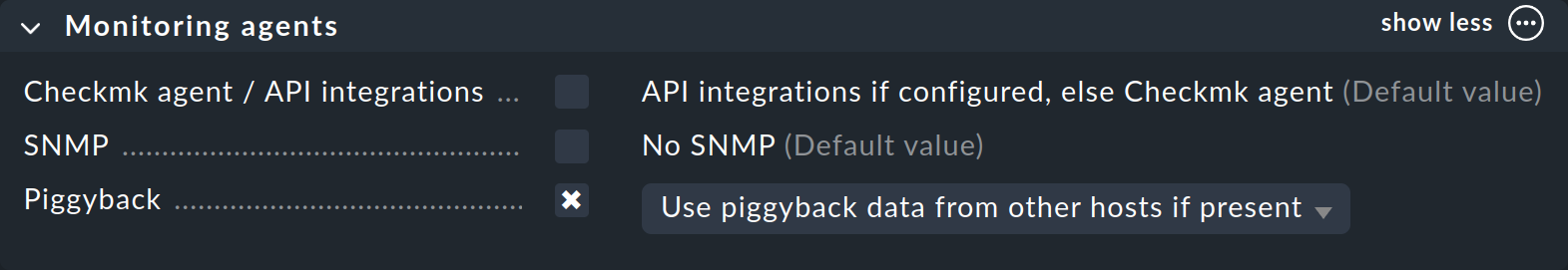

However — as usual in Checkmk — everything is configurable. Namely, in the properties of a host (such as host B) in the Monitoring agents box you can set how it should react to existing or missing piggyback data:
Piggyback data redirection is defined in the agent settings.
The default is Use piggyback data from other hosts if present. If available, piggyback data is used, and if none is there the host just uses its ‘own’ monitoring data.
With the Always use and expect piggyback data setting you force the processing of piggyback data. If the data is missing or outdated the Check_MK service will issue a warning.
And with Never use piggyback data any piggyback data found is simply ignored — a setting that you’ll only need in exceptional cases.

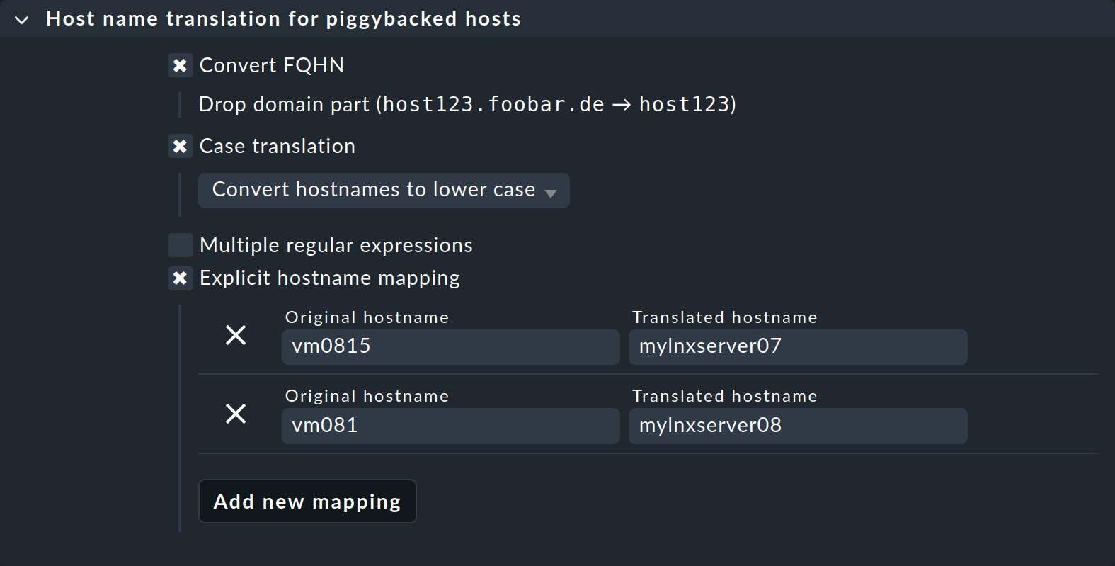

But what happens if the names of objects in the piggyback data are inappropriate or undesirable for monitoring? Unsuitable are, for example, names of piggybacked hosts that consist only of a dot or begin with a dot, such as .myhostname, as these are not processed in Checkmk. There is a special rule set Host name translation for piggybacked hosts, which you can find in the Setup menu under Setup > Agents > Agent access rules.
To configure a rename you will need to do two things:
  1. Create a rule and set the condition to access the piggyback host – i.e. host A.
  2. Create a suitable name assignment value in the rule.
Here is an example of the value in a rule. First, the domain part of host names is removed with Convert FQHN. Then, all host names from the piggyback data are converted to lowercase letters. Finally, the two hosts vm0815 and vm081 are converted to the Checkmk hosts mylnxserver07 and mylnxserver08:
Options for host name translation, removing the domain part, conversion to lowercase and explicit mapping.
More flexible is the method using regular expressions found under Multiple regular expressions. This is useful if the renaming of many hosts is necessary, and it is done according to a specific scheme. Proceed as follows:
  1. Activate the Multiple regular expressions option.
  2. Add a translation entry with the Add expression button — two fields will appear.
  3. In the first field — Regular expression — enter a regular expression that matches the original object name and which contains at least one subgroup – that is, a sub-expression enclosed in parentheses. For a good explanation of these groups see the article on regular expressions.
  4. In Replacement specify a schema for the desired target host name in which the values that were ‘captured’ with the subgroups will be replaced by \1, \2, etc.
An example of a regular expression would be, for example vm(.*)-local. The substitute value myvm\1 would then translate the name vmharri-local into myvmharri.
