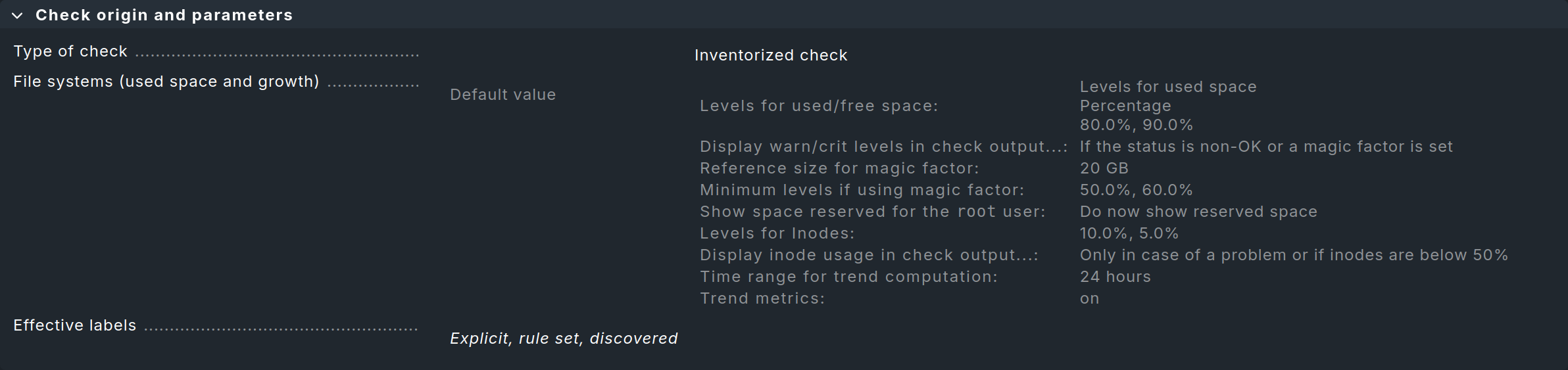

The rule sets for the service
In the first box entitled Check origin and parameters, the File systems (used space and growth) entry takes you directly to the set of rules for the file system monitoring thresholds. However, you can see in the overview that Checkmk has already set default values, so you only need to create a rule if you want to modify those defaults.

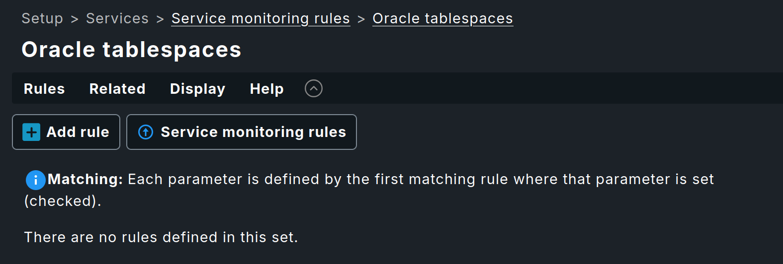

The overview page for the rule set
This rule set does not yet contain any rules. You can create the first rule with the Add rule button. Creating — and later editing — this rule opens a form with three boxes: Rule properties, Value and Conditions. We will look at each of these three in turn.

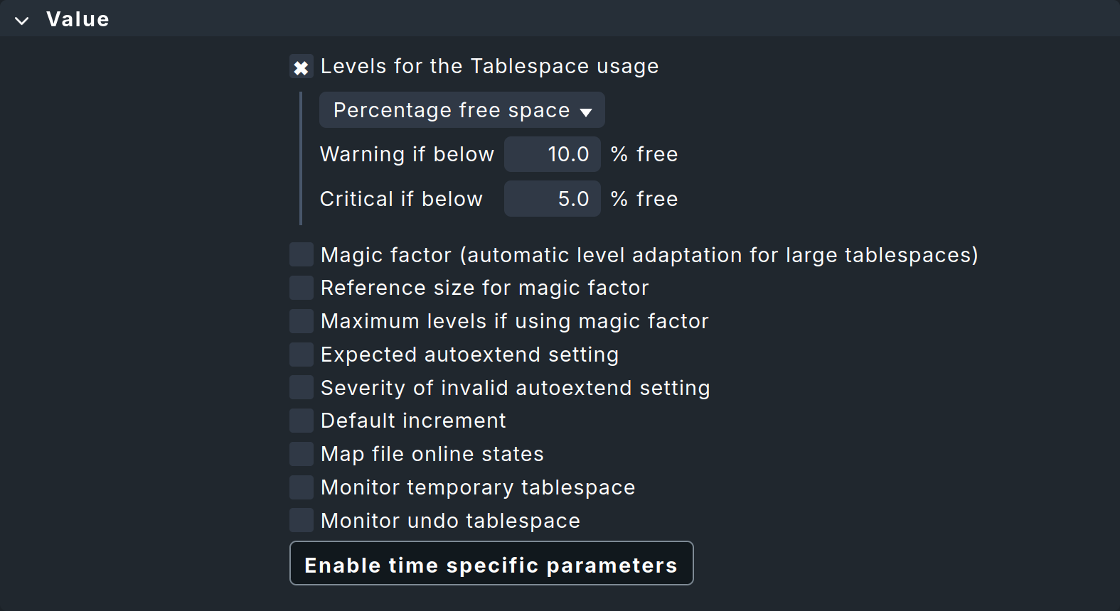

What you find in the Value box depends in each specific case on the content of what is being regulated:
Dialog for setting the values for the new rule.
Selecting the parameter for tablespace usage thresholds
As you can see, this can be quite a number of parameters. The example shows a typical case — each individual parameter can be activated by a checkbox, and the rule will then only apply to this parameter. You can, for example, let another parameter be determined by a different rule if that simplifies your configuration. In this example, only the threshold values for the percentage of free space in the tablespace will be defined.

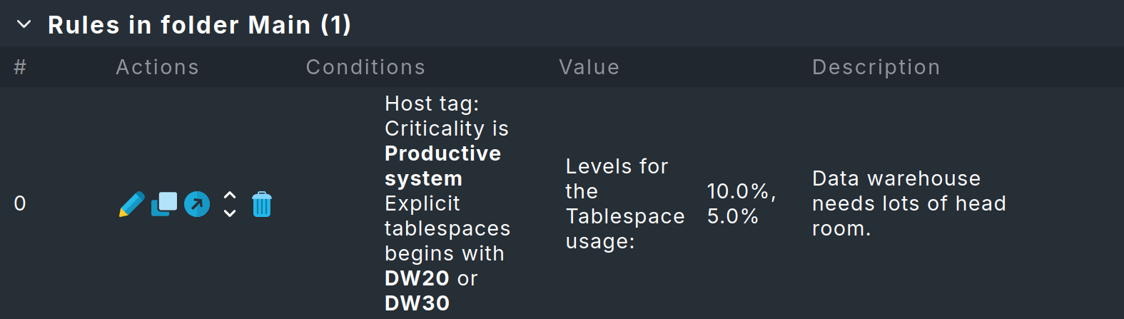

List of rules with the new rule created.
After saving, there will be exactly one new rule in the rule set

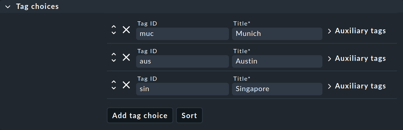

The second box Tag choices is about the actual tags, i.e. the selection options in the group. Click Add tag choice to create a tag and assign an internal ID and a title for each tag:
Dialog for setting the tags for the new host tag group.
Then the individual tags are defined

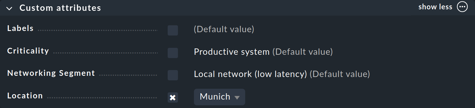

5.3. Assigning a tag to a host
You have already seen how to assign tags to a host — in the host properties when creating or editing a host. In the Custom attributes box — or in a separate one if you have created a Topic  — the new host tag group will appear and there you can make your selection and set the tag for the host:
Dialog with properties of a host with the new host tag group.
Host tag groups are displayed in a host’s properties

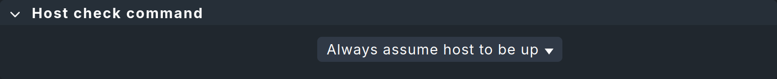

You can tell Checkmk that it is perfectly OK for a host to be powered off. To do this, find the Host check command rule set, create a new rule, and set its value to Always assume host to be up:
Dialog for setting the 'Host check command' in the rule of the same name.
This rule specifies how to check whether hosts are UP
In the Conditions box, make sure that this rule is really only applied to the appropriate hosts — depending on the structure you have chosen. For instance, you can define a host tag and use it here, or you can set the rule for a folder in which all the printers are located.
Now, all printers will always be displayed as UP — no matter what their actual status is.

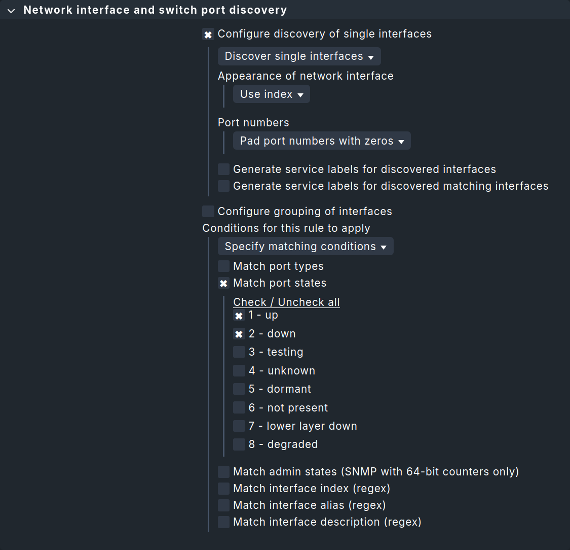

The first rule set Network interface and switch port discovery defines the conditions under which switch ports are to be monitored. Create a rule for the desired switches and select whether individual interfaces (Configure discovery of single interfaces), or groups (Configure grouping of interfaces) are to be discovered. Then, under Conditions for this rule to apply > Match port states, activate 2 - down in addition to 1 - up:
Dialog for defining the monitoring of switch ports in a rule.
Defining the valid states up and down
In the service configuration of the switches, the ports with the down state will now also be presented, and you can add these to the list of monitored services.
Before you activate the change, you will still need the second rule that ensures that this state is evaluated as OK. This rule set is called Network interfaces and switch ports. Create a new rule and activate the Operational state option, deactivate Ignore the operational state below it and then activate the 1 - up and 2 - down states for the Allowed operational states (and any other states as may be required).

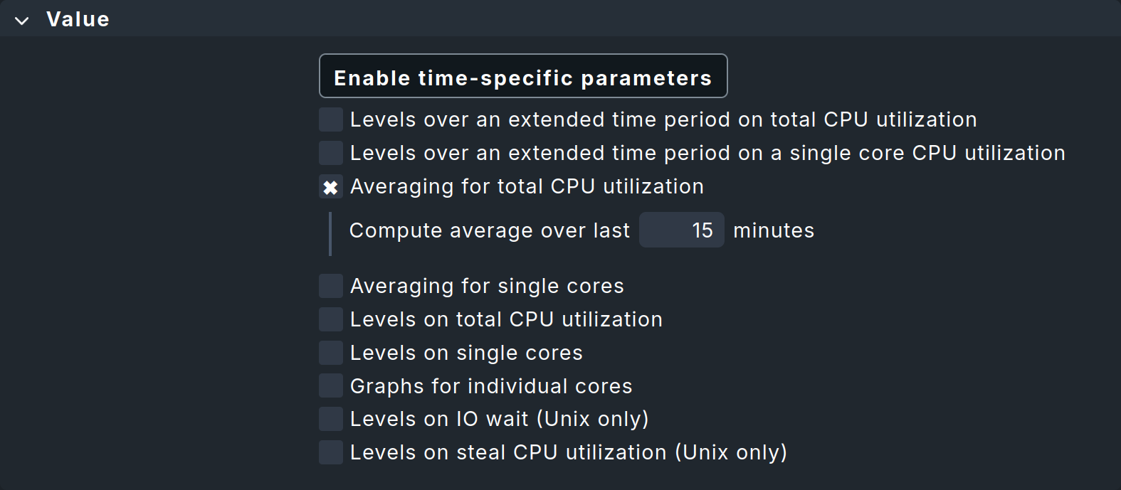

Sporadic notifications are often generated by threshold values on utilization metrics — such as CPU utilization — which are only exceeded for a short time. As a rule, such brief peaks are not a problem and should not be faulted by the monitoring.
For this reason, quite a number of check plug-ins have the option in their configuration that their metrics are averaged over a longer period of time before the thresholds are applied. An example of this is the rule set for CPU utilization for non-Unix systems called CPU utilization for simple devices. For this there is the Averaging for total CPU utilization parameter:
Dialog for setting mean values for CPU utilization in a rule.
Setting a mean value for CPU utilization
If you activate this and enter 15, the CPU utilization will first be averaged over a period of 15 minutes and only afterwards will the threshold values be applied to this average value.

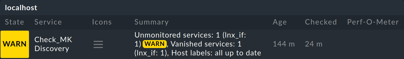

Service list with the 'Check_MK Discovery' service.
The Check_MK Discovery service displays service discovery changes
By default, every two hours this service checks whether new — not yet monitored — services have been found or existing services have been dropped. If this is the case, the service go to WARN. You can then call up the service discovery (on the Services of host page) and bring the services list back up to the current status.
Detailed information on this discovery check can be found in the article on configuring services. There you can also learn how you can have unmonitored services added automatically, which makes the work in a large configuration much easier.
With Monitor > System > Unmonitored services you can call up a view that shows you any new or dropped services.
