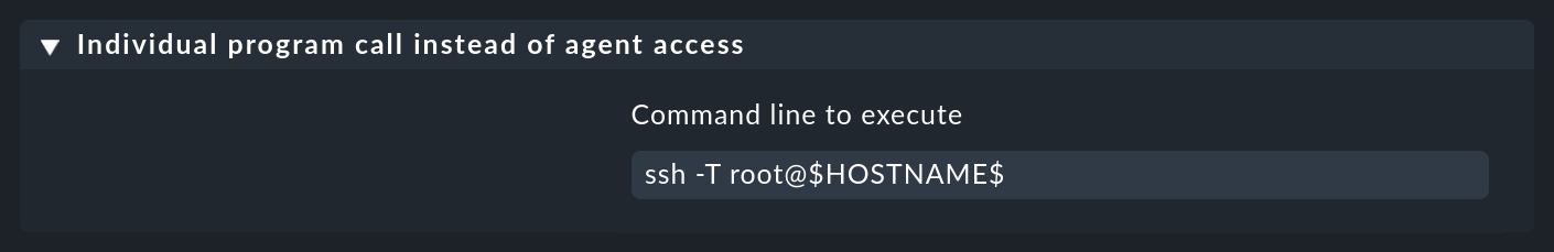

6.4. Changing the access from Checkmk to SSH
The target system has now been prepared. Now only the configuration of Checkmk itself is missing. This is done via the Setup > Agents > Other integrations> Custom integrations > Individual program call instead of agent access rule set. Create a rule here for the affected hosts and enter ssh -T root@$HOSTNAME$ or ssh -C -T root@$HOSTNAME$ (for additional compression of the agent data) as command:
rule for calling the agent via SSH.
Calling the agent via SSH is done by rule
You can run the connection test in the GUI under Setup > Hosts > Properties of host > Test connection to host with the Run tests button. If the test fails with timeout or access denied, check whether you used the host name in the same spelling as when testing on the command line — OpenSSH differentiates between short host name, FQDN and IP address. Alternatively you can access the host using it’s IP address. In this case you have to use the macro $HOSTADDRESS$ that is replaced by the cached (by Checkmk) IP address of the host.
After saving and executing Activate changes the host is added to the monitoring. In the monitoring the service Check-MK Agent is now displayed with the note 'Transport via SSH'. For further diagnostics the commands cmk -D and cmk -d can be used, which are explained in the article on the command line.

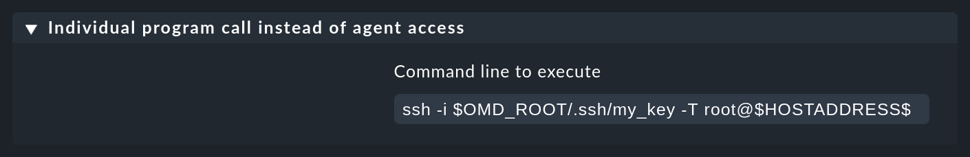

6.5. Multiple SSH keys
You can also work with more than one SSH key. Place the keys in any directory. In the Individual program call instead of agent access rule you must then specify the path to the respective private key with the -i option. It is best to use $OMD_ROOT here as a replacement for the path to the site directory (/omd/sites/mysite). The full command could then be ssh -i $OMD_ROOT/.ssh/my_key -T root@$HOSTADDRESS$, and thus the configuration would also be executable in a site with a different name:
Rule to invoke the agent with multiple SSH keys.
To use multiple SSH keys, the above command usually needs to be extended
This allows you to use different SSH keys for different groups of hosts by using multiple different rules.

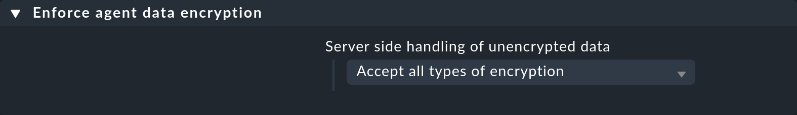

Configuring the Checkmk server
In the third and last step, use the Enforce agent data encryption rule to specify how the Checkmk server should handle unencrypted data.
You have the following options:
  • Accept all incoming data, including unencrypted: Data from agents with and without encryption will be accepted.
  • Accept all types of encryption: Only encrypted data will be accepted, either via TLS or via symmetric encryption, as activated in the first step.
  • Accept TLS encrypted connections only: Only data encrypted by TLS will be accepted.
Rule to define which agent data the Checkmk server accepts.
With this selection symmetrically encrypted data as well as TLS encrypted data will be accepted
It makes sense to start with Accept all incoming data, including unencrypted. Once you think all agents have been switched to encryption, set Accept all types of encryption to find any hosts that may still be sending data in plain text. Hosts that send unencrypted data will be detected and flagged 'red'.
