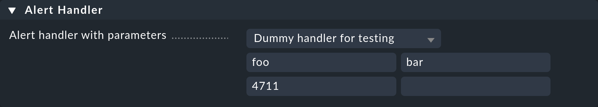

The form for selecting the alert handler allows direct access and shows the title which is logged in the second line of the script. Additionally you may add arguments, which you enter in the text fields. These will be interpreted as command line arguments in the script. On your shell you may access them with $1, $2, etc.
alert handler arguments
After saving the rule the alert handler will be immediately active and will run with every change of status for any host or service!

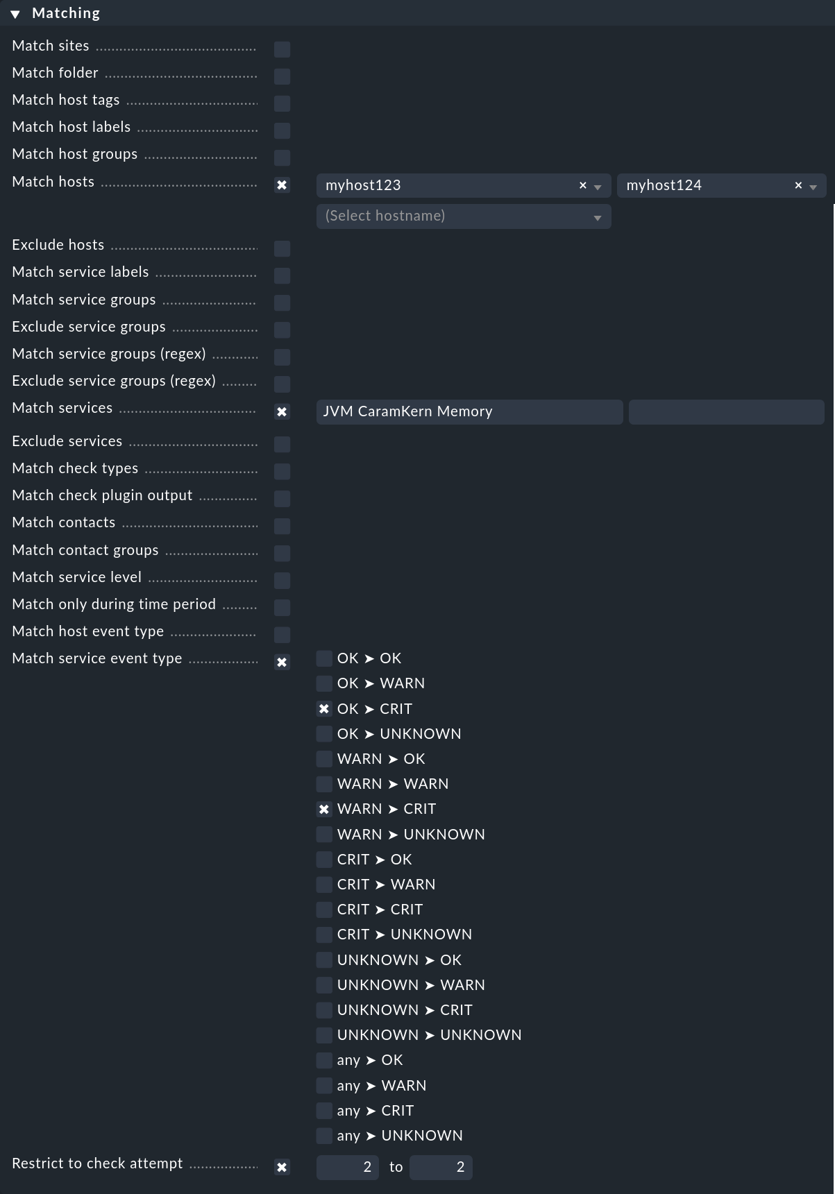

3. Rule-based configuration
As shown in the introductory example, which events should trigger alert handlers are defined via rules. This functions completely analogous to notifications, only somewhat simplified. In the example we specified no conditions, which is naturally unrealistic in practice. The following example shows a condition that an alert handler defines for specific hosts and services:
alert handlers rule condition
The alert handler will only be triggered
  • for the hosts myhost123 and myhost124,
  • for the service JVM CaramKern Memory,
  • if the state changes from OK or WARN to CRIT,
  • and then only at the second check attempt.
In order for the handler to be triggered, in this example it is necessary to use a rule Maximum number of check attempts for service to set the minimum number of check attempts at 2. In order to suppress a notification in the case of a successful garbage collector the number should be set to 3 — since if the handler can solve the problem directly following the second attempt, the third attempt should detect an OK state and therefore no further notification will be necessary.
Unlike other places in Checkmk every alert handler rule will be executed if the conditions are matching. Even if two rules calling the same handler these handler will indeed run two times. The alert helper (explained in the next chapter) will suppress the second execution with an error message since the same handler must not run multiple times at the same time. Still it is recommended to set up the rules that this case will not appear.

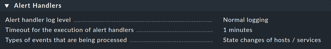

4.6. Global settings
There are a number of global settings for executing alert handlers:
alert handlers options
The Alert handler log level influences the logging in the alert helper log file (~/var/log/alerts.log).

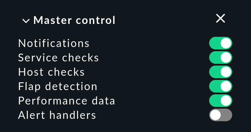

4.7. Master control
alert handlers master control off
With a click in the Master control snap-in you can deactivate alert handlers globally. Currently running handlers will not be affected and will run to completion.
Do not forget to reset the small switch to green as soon as practicable! Otherwise you could be deceived by a false sense of security that the monitoring is fixing everything…​

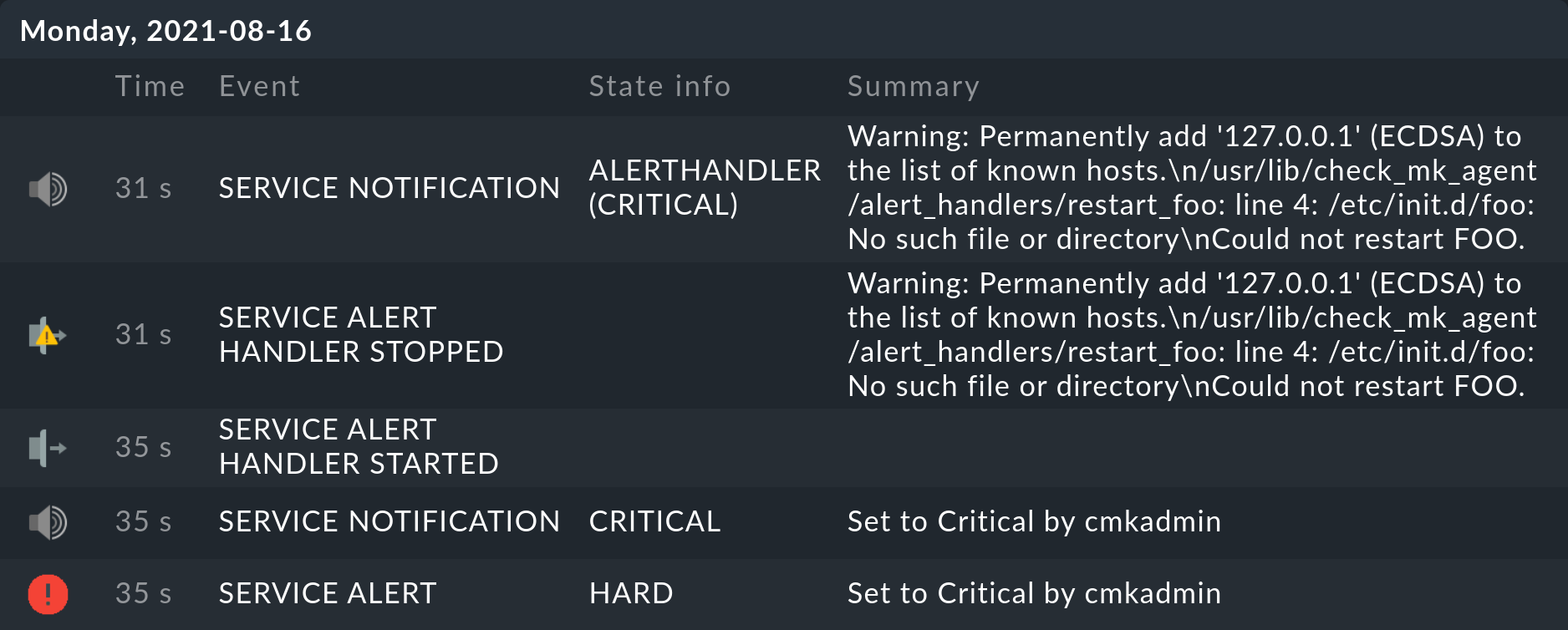

5. Alert handlers in the history
Alert handlers create entries in the monitoring history. With this you have a better traceability compared to only having the alerts.log log file. An entry is created as soon as an alert handler starts and another when it ends.
The alert handlers are thus regarded in the same way as typical monitoring plug-ins — that means they should produce one line of text and return one of the four exit codes 0 (OK), 1 (WARN), 2 (CRIT) or 3 (UNKNOWN). All errors that from the outset prevent a handler’s execution (abortion due to duplicate execution, script missing, timeout, etc.) are automatically flagged with UNKNOWN.
For example - calling this very simple handler…​
~/local/share/check_mk/alert_handlers/dummy
#!/bin/bash
# Dummy handler for testing
sleep 3
echo "Everything is fine again"
exit 0
... produces a result as above in the relevant service’s history (as always the newest message is at the top):

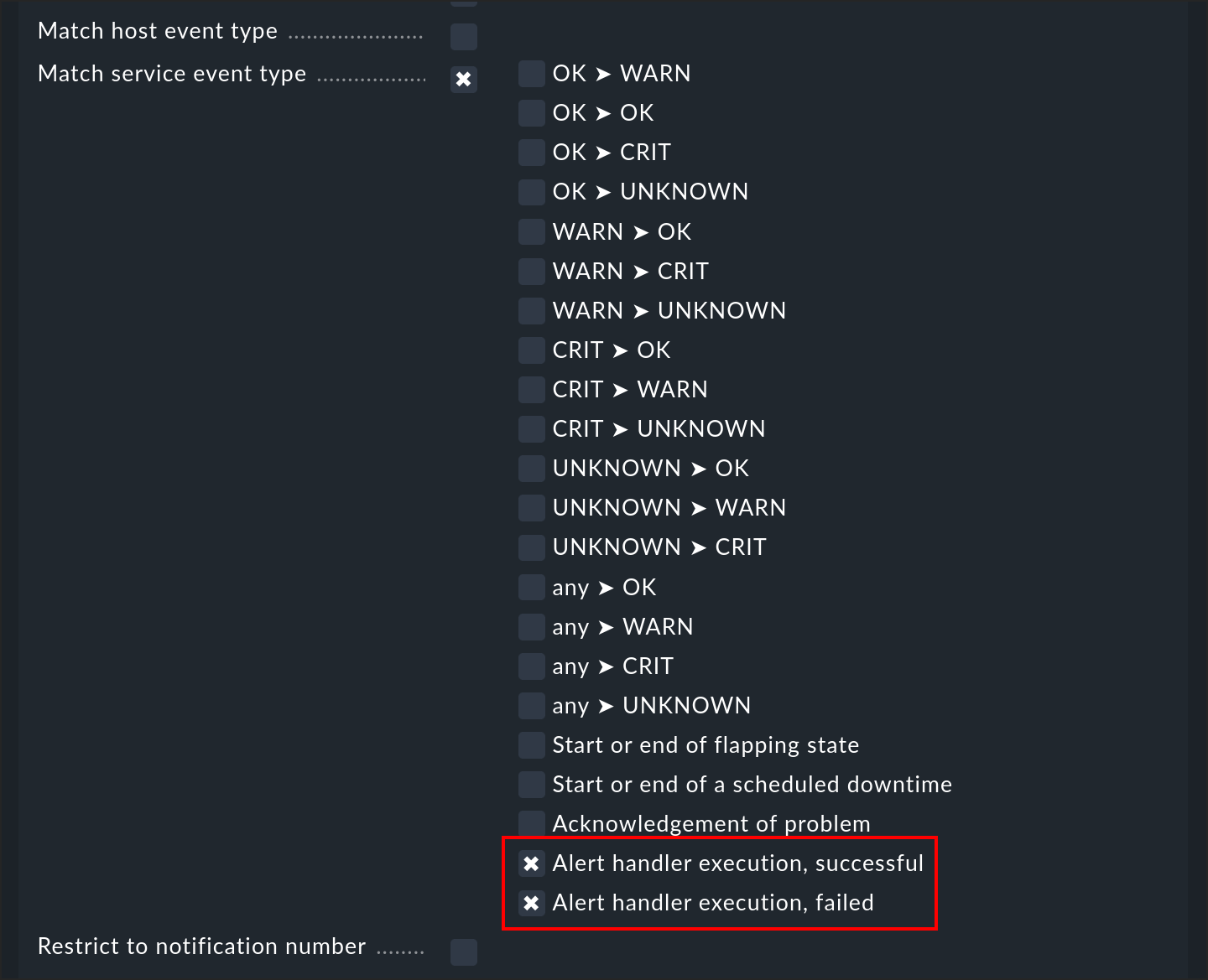

6. Notification via alert handlers
The execution of an alert handler — or more exactly, the completion of an execution — is an event that triggers a notification. This way you can be informed that a handler has completed its task. There are two types of event that you can filter in a notification rule:
alert handler notif condition
You can thus differentiate between successfully executed handlers (exit code 0 - OK), and failures (all other codes). The email notification from Checkmk does not show the output of the check, but the output of the alert handler.

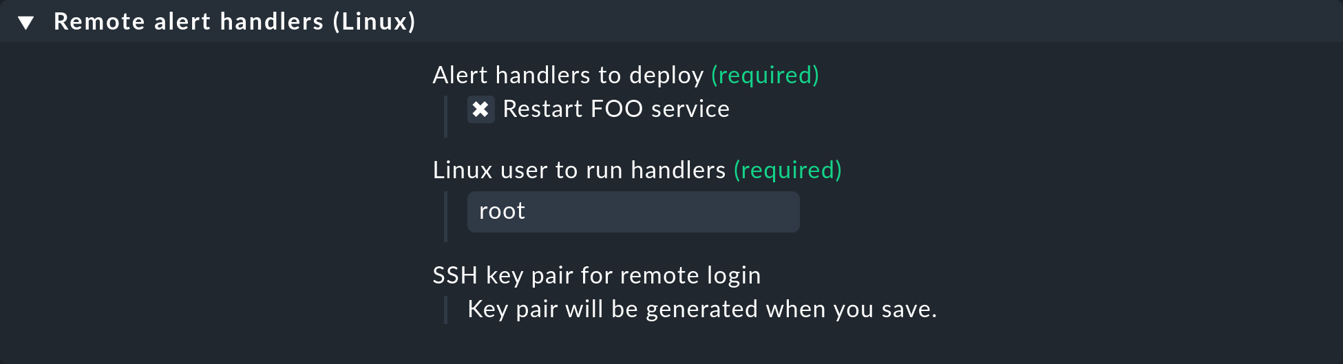

  • Rules in Setup > Agents > Windows, Linux, Solaris, AIX > Agent rules > Linux Agent > Remote alert handlers (Linux) that generate SSH keys.
  • Alert handler rules that call up linux_remote.
8.2. Setting up
Assuming one wants to run the /etc/init.d/foo restart script on the myserver123 Linux system whenever the Process FOO service becomes critical (which we have already set up). Proceed as follows:
Coding the remote handler
Next, write the script to be executed on the target system. Since we are working with the Agent Bakery, install the script on the Checkmk server (not on the target system!). The correct directory for this is ~/local/share/check_mk/agents/linux/alert_handlers. Here as well the comment in the second line provides a title for selection in the user interface:
~/local/share/check_mk/agents/linux/alert_handlers/restart_foo
#!/bin/bash
# Restart FOO service
/etc/init.d/foo restart || {
    echo "Could not restart FOO."
    exit 2
Make the script executable:
OMD[mysite]:~$ cd local/share/check_mk/agents/linux/alert_handlers
OMD[mysite]:~/local/share/check_mk/agents/linux/alert_handlers$ chmod +x restart_foo
Copy command(s) to clipboard
Our example script is so constructed that in the case of an error it ends with a Code 2 so that the alert handler assesses it as CRIT.

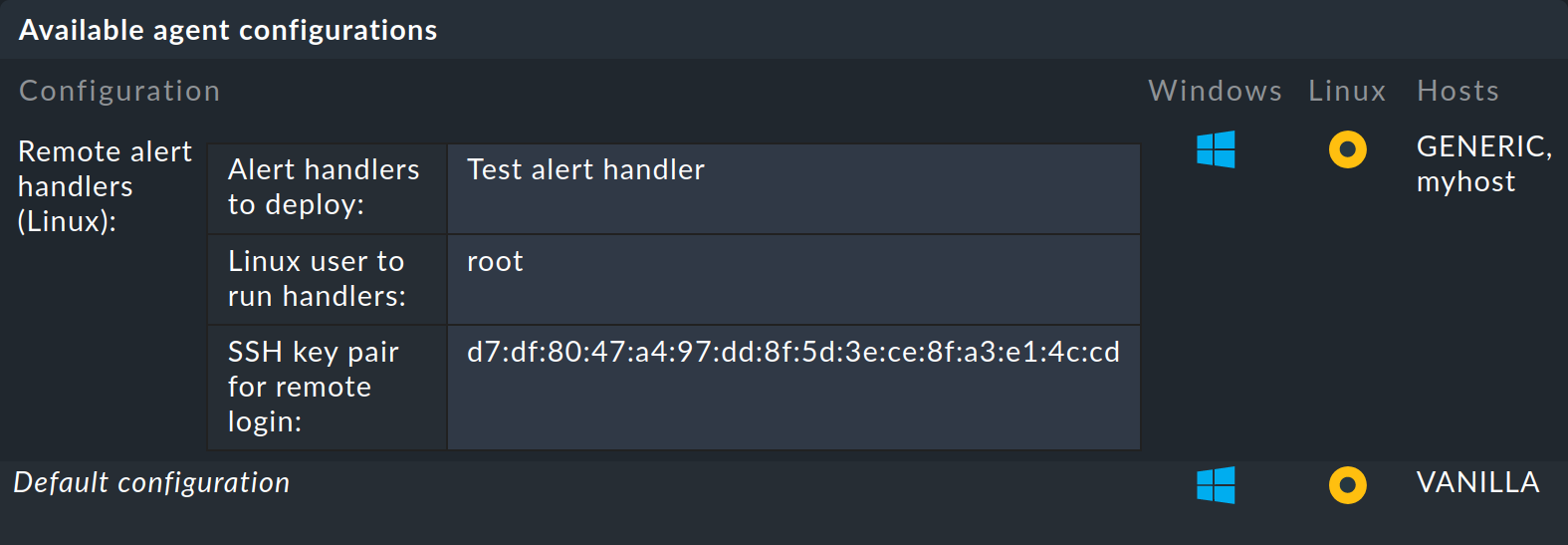

Preparing agent package with the handler
Here we will describe the procedure with the Agent Bakery. Tips for installing by hand can be found further below.
Define a rule under Setup > Agents > Windows, Linux, Solaris, AIX > Agent rules > Linux Agent > Remote alert handlers (Linux). In the properties, the remote handler Restart FOO service you have just defined can be seen. Select this for installation:
alert handlers install remote
Once you have saved it you will see the rule in the list: an SSH key pair for calling up the handler was automatically generated and the fingerprint of which will appear in the rule. The fingerprint itself has been shortened to fit the width in this screenshot:
alert handlers install remote2
The public key is intended for the agent. The private key will later be required by the Checkmk server so that a script installed in this way can be called up without needing to enter a password.
One can also utilize another user as root - naturally only when they have the appropriate rights for the required action. The Checkmk agent will only install the SSH key on systems where this user already exists.
Baking agent
Now bake new agents with button bake agents. In the list of ready agents an entry should now appear in which your remote handler and SSH key can be seen. The screenshot has also been shortened here. This time by the amount of possible packages that may be downloaded:
alert handlers baked handler

Calling the handler using a rule
We have almost reached our objective. The agent is ready. Now all that is missing is a rule to actually summon the alert handler. The procedure is as described at the beginning of this article and is achieved through the creation of an appropriate rule. This time choose Linux via SSH as the handler, enter the user for whom the SSH key should be installed, and select your remote handler:
alert handlers rule foo
Set also a sensible condition in the rule, otherwise an SSH connection will be attempted with every service alert!
Testing
When, e.g., you now set the relevant service manually to CRIT, in the service’s history you will shortly see:
alert handlers foo failing
Naturally if no foo service exists, then /etc/init.d/foo restart also cannot work. It can however be seen that this command has been processed and also that the error status has been correctly reported. Likewise that Checkmk has triggered a notification which was stopped by an alert handler.
The Warning: Permanently added '127.0.0.1' (ECDSA) to the list of known hosts. message is harmless by the way and only appears on first contact with the host. To avoid the time-consuming manual exchange of the host key, SSH is called with -o StrictHostKeyChecking=false. At the first connection the key will be stored for future use.
