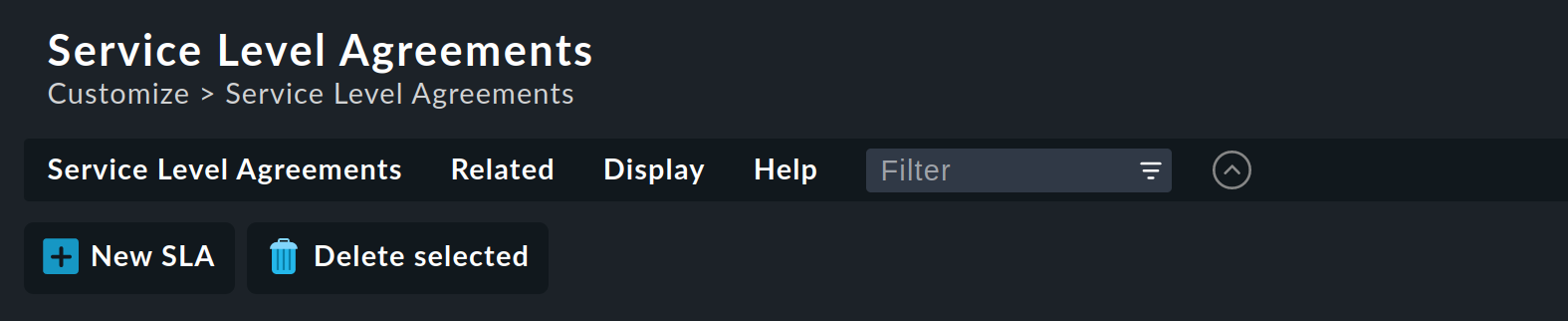

First, create the actual SLA. The configuration can be found via Customize > Business reporting > Service Level Agreements (by the way, you can only see this menu item in Show more mode):
List of Service Level Agreements (SLAs) with action bar button to create an SLA.
In the Service Level Agreements (SLAs) list you can find the action bar button to create an SLA

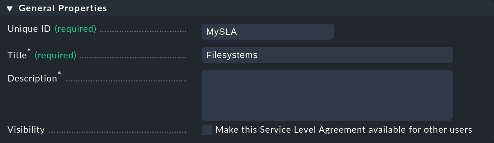

Create a new SLA via icon new New SLA. In the General Properties section, first give a unique ID, here MySLA, and a title, such as Filesystems:
Dialog for defining the general properties of an SLA.
ID and title are used to define the general SLA properties

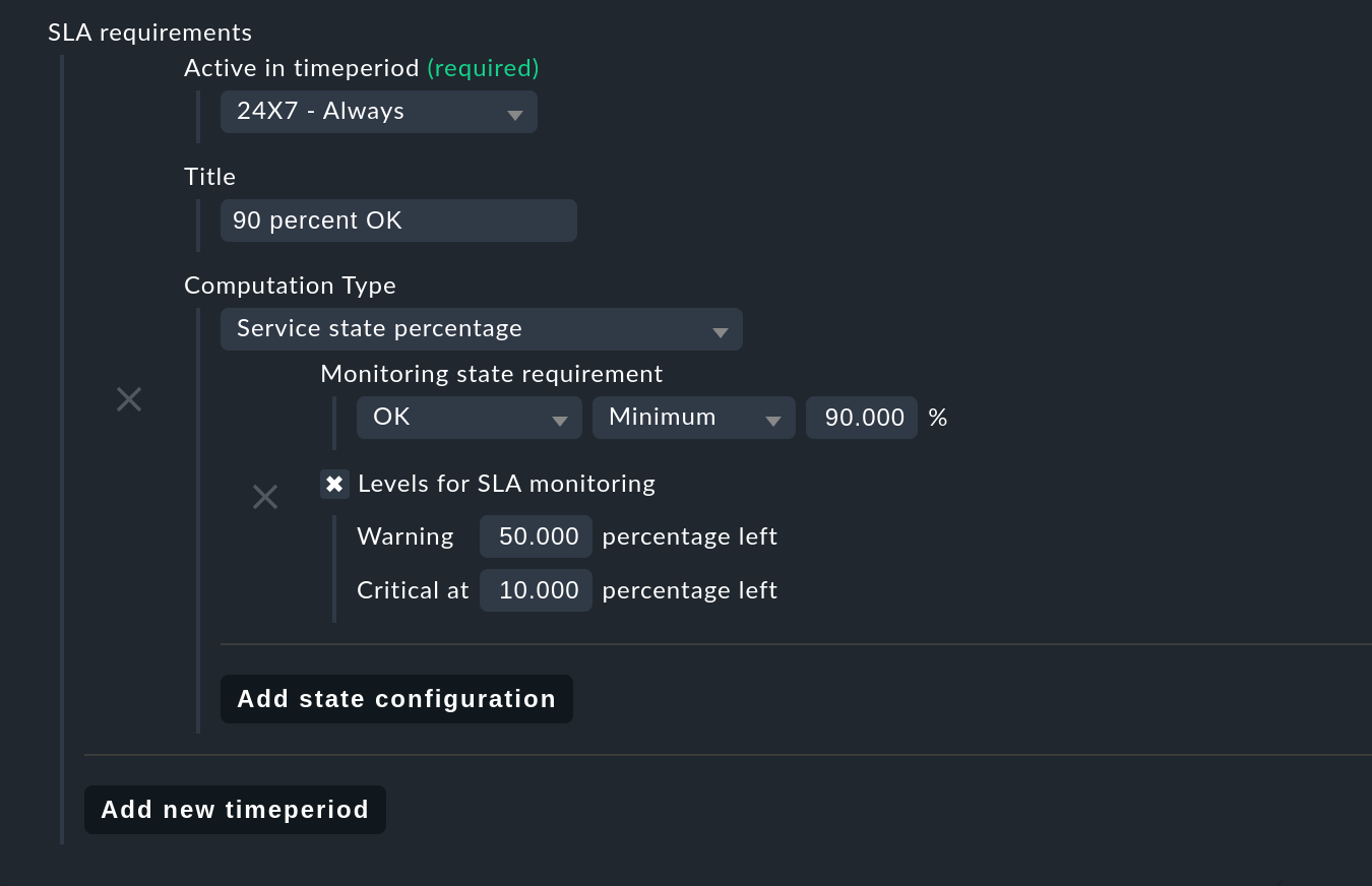

Next specify the actual requirements in the SLA requirements section with Add new timeperiod. As long as you have specified time periods, these can also be used with the SLAs, as already mentioned for general availability. Select a time period under Active in timeperiod, or as here in the example 24X7 - Always to define the requirements for a 24/7 operation. Under Title, give a meaningful name, say 90 percent OK:
Dialog for defining the first SLA requirement.
The first requirement is defined as a percentage SLA
For Computation Type, for the first request select Service state percentage and add a new criterion via Add state configuration. A new paragraph opens for the Monitoring state requirement. To ask for at least 90 percent availability, set this record to OK, minimum, 90. If this value falls short, the SLA is considered broken and assumes the state CRIT, as will be seen later on the results page.
Perhaps the SLA should not wait until it breaks and then go to CRIT, but directly to WARN as soon as 50 percent of the buffer is consumed, and then to CRIT if there are 10 percent buffers left. The thing really breaking the SLA would then produce broken but no further state changes (more on this below in section SLA detail page). For such a configuration check the box at Levels for SLA monitoring. Here you can enter residual values for the transition to WARN and CRIT. This completes the first request.

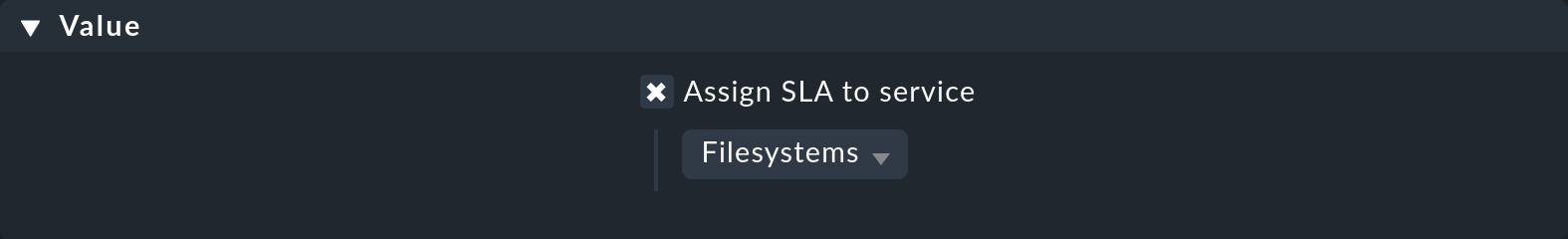

The SLA is connected to a service via the Setup > Services > Service monitoring rules > Assign SLA definition to service rule set. Create a rule, enable the only rule-specific option Assign SLA to service, and then choose your SLA definition MySLA, listed here by its title Filesystems.
Rule for selecting the SLA for the service.
The previously-created SLA is offered for selection in the list

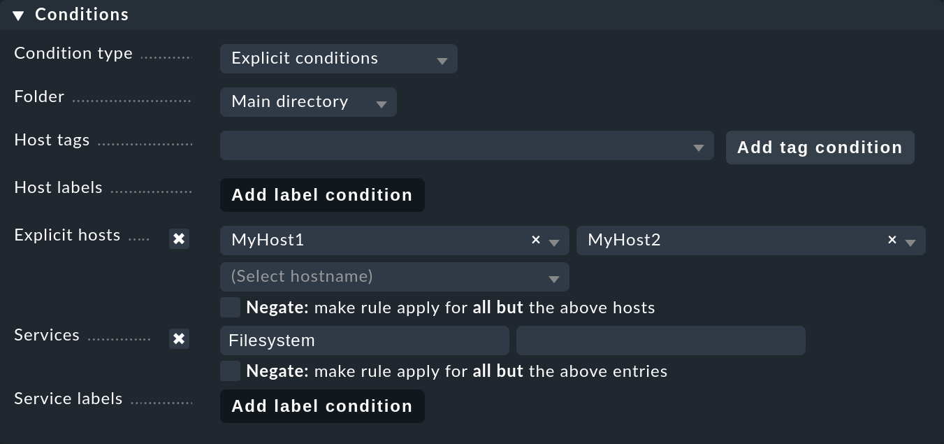

Next under Conditions in the Services section define further filters for the desired services. As always, here you can work with regular expressions, and as in this example link the SLA definition to all local file systems via Filesystem. Optionally you can still restrict everything using the rule-specific filters for folders, host tags and explicit hosts; in our example they are the hosts MyHost1 and MyHost2:
Service selection condition for the SLA.
The file system services are assigned to the SLA
Of course at this point you could also omit any service filtering and simply bind the SLA to all services. How and why it is better to do that with a column-specific SLA view is explained below.

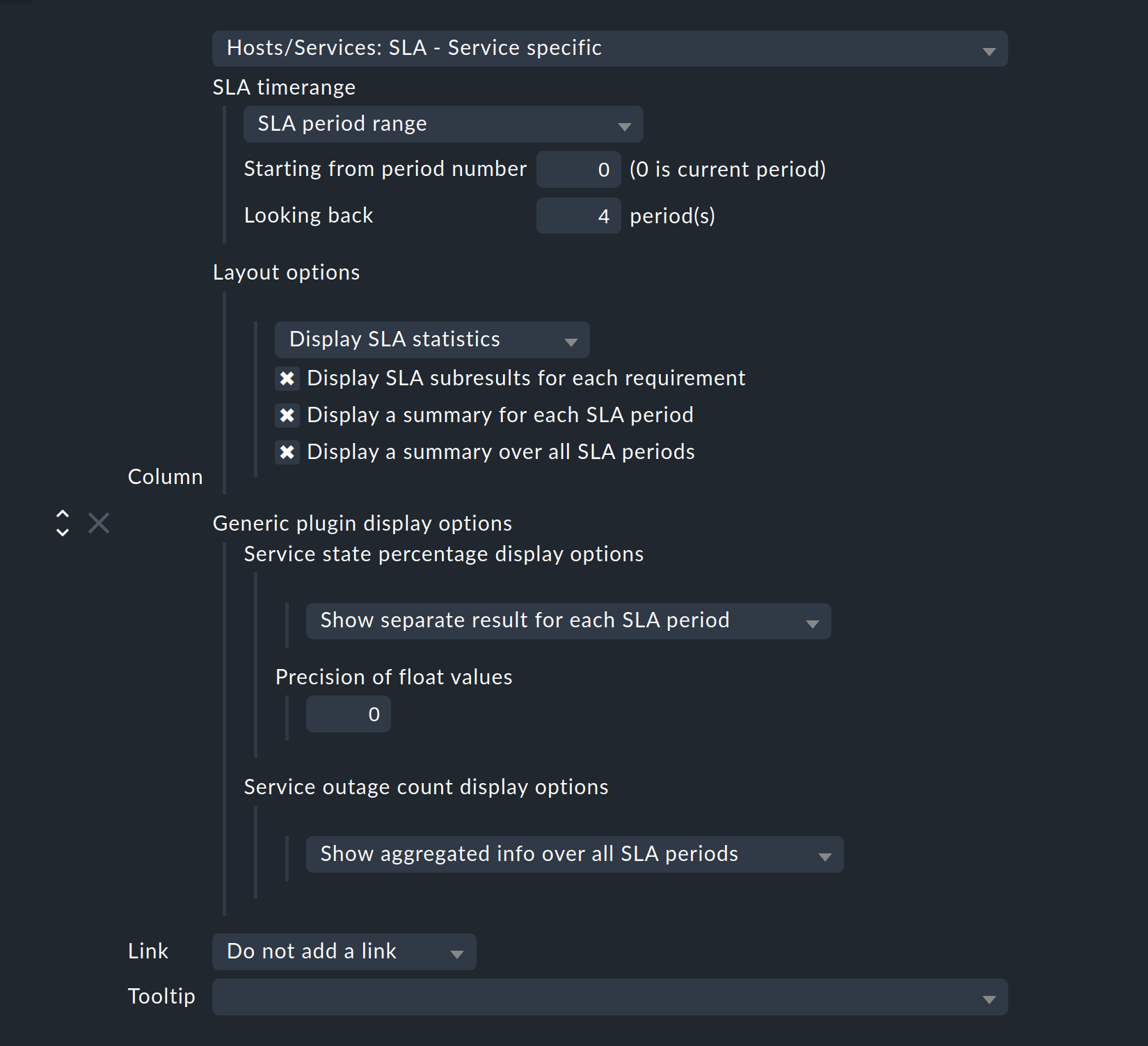

Add the Hosts/Services: SLA - Service specific column at this point. Here all sorts of options are now available for the presentation of the SLAs’ results:
SLA representation options when creating the view.
The numerous options for SLA representation in the view
SLA timerange: Use this to set the time frame for for which you want to see SLA results. For example, if you have the reporting period Monthly in your SLA definition and here Last Year, you receive twelve individual results. In this example the SLA period range option is used to directly specify the number of displayed reporting periods: For five periods/results set Starting from period number to 0, and Looking back to 4.
Layout options: By default, this option is set to Only Display SLA Name. To actually see the results of the SLAs, here choose Display SLA statistics. You can select up to three different elements:
  • Display SLA subresults for each requirement displays each affected SLA with name in a separate line.
  • Display a summary for each SLA period shows a graphic summary in the Aggregated result line.
  • Display a summary over all SLA periods: Shows a textual, percentage summary of all SLAs in the Summary line.
Activate all three options for this current example.
Generic plugin display options: At this point, for the display of outage/percentage SLAs, define whether summaries (texts) or respectively individual results (icons) for the reporting periods should appear. To see both in action, leave the percentage SLAs option at Show separate result for each SLA period and select Service outage count display options to Show aggregated info over all SLA periods.

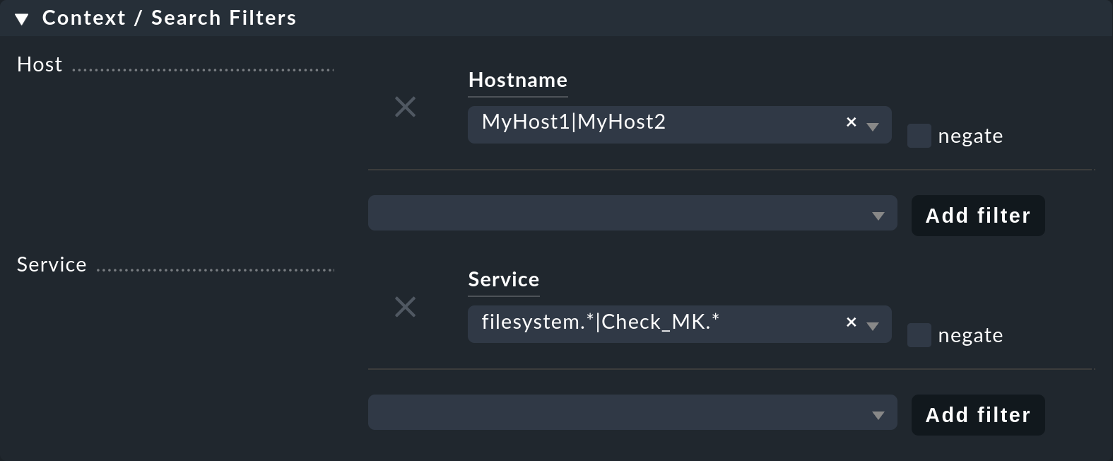

Since the view should only show the MyHost1 and MyHost2 hosts, in the last step you have to set a filter under Context / Search Filters for the Hostname: MyHost1|MyHost2. For a slightly clearer example view you can still set a filter under Service, for example filesystem.*|Check_MK.*. You then get the SLA-monitored file system services, and as an unmonitored counterpart the Checkmk services – in this way the results from using the service-specific SLA display will simply be clearer.
Filter selecting hosts and services for the view.
The view is narrowed down to the hosts and services of interest

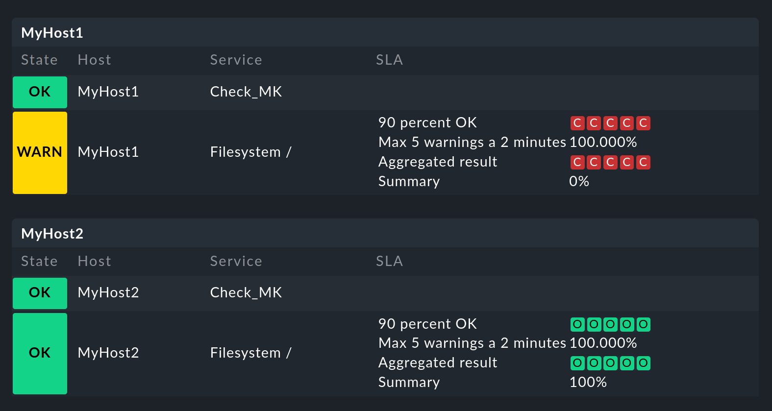

This completes the view setup. After selection in the Monitor menu as the result you will get a view with five status icons as single results from the percentage SLA, and a summary as a percentage for the outage SLA — of course only in the file system services lines, the Checkmk lines remain empty.
The view in monitoring shows two services with SLA information.
The view in monitoring shows — per host — one service with, and one without SLA information

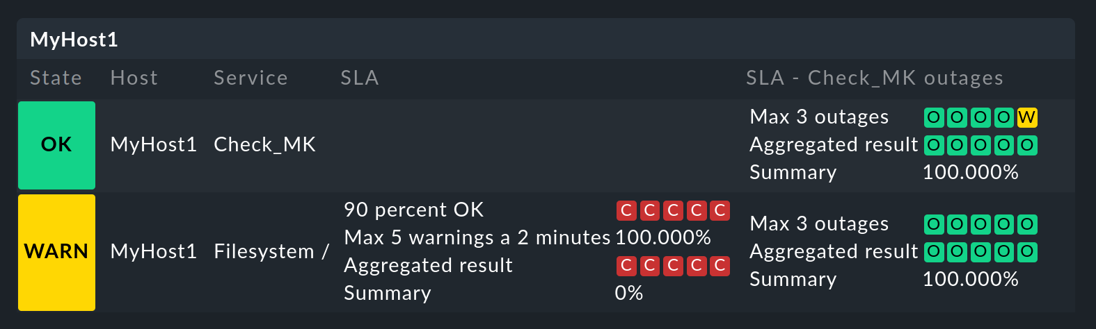

3.1. Column-specific SLA displays
The service-specific view has a disadvantage: you can indeed create multiple rules that assign the same service to different SLAs, however you can only display the SLA assigned to the first of these rules – there is no way the SLA of a second controlling rule can be displayed in a second column.
You can however easily show several columns with different fixed, specified SLAs. Such column-specific views are useful, for example, if you need multiple SLAs which should apply for all services of some or all hosts. So it could be about defining something like gold, silver and bronze SLAs, each in a separate column next to the services of a host. Then at a glance it will be clear which SLA definitions a service/host meets. In short: the column-specific view allows you to display more than just a single SLA for services.
In the example completed above, those three steps mentioned at the beginning were executed — create an SLA, bind it to a service, install it in a view. For column-specific views you can just leave out the second step. Create only the SLA, and arrange a view with the Hosts/Services: SLA - Column specific column. The SLA results will then be displayed in each line independently of the respective service.
The following image shows the above SLA view for MyHost1 with an additional column showing SLA results (maximum three outages of Checkmk services) for each service:
The view with an additional SLA column for each service.
The view with a new SLA column for each service
The difference between service and column-specific displays is thus clearly visible. What should also become clear: the SLA designed specifically for Checkmk services of course makes only moderate sense in the file system columns. It is therefore worth planning this thoroughly before beginning an implementation!

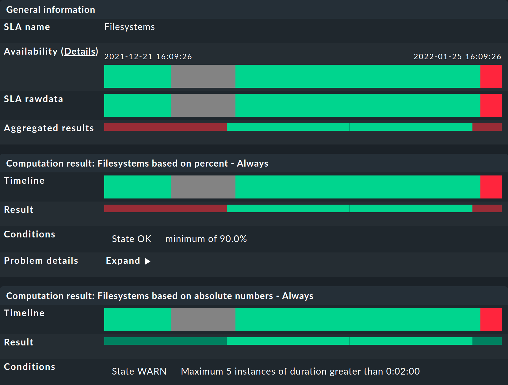

3.2. The SLA detail page
Integrating the SLA information into tables provides a fast overview, but of course you can also consider the results in detail. In a view, a click on the cell with the SLA data takes you directly to the detail page of the SLA results for the affected service:
sla view details bars
The details will be displayed by clicking a table cell containing SLA information
Here four different types of information can be found:
  • raw data of the availability,
  • a summary of all of the requirements of an SLA,
  • individual results of all of the requirements of an SLA and
  • the SLA specification.
General information: Here you can see the raw availability data, and thus the SLA calculations as an overview of the state for each period, and below it the aggregated results of the SLA’s requirements.

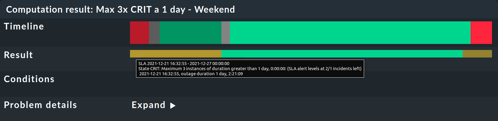

This is followed by tables for each individual SLA requirement. The Timeline shows every single state and the Result row shows the results for each individual reporting period. A special feature here: If you, as described in the example, have set SLA levels and the SLA goes to CRIT before breaking, this will be indicated here by an orange bar and not the usual red bar. The bars will then turn red when the SLA breaks. Once you get that, move the mouse pointer to the result bar where, via a tooltip, you will be able to see the individual events that are responsible for the state. In the following picture the state is WARN – because only two out of the three permitted outages remain:
Tooltip of a result on the SLA details page.
A tooltip shows detailed information about the result row
The message SLA broken would also appear in this tooltip.

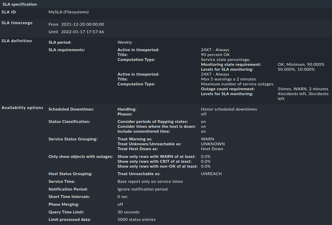

Finally, under SLA specification, the configuration data for your SLA follows, which will help you to better evaluate and understand the results presented:
The SLA specification for the service selected in the view.
The complete specification evaluated for the SLA results from the service

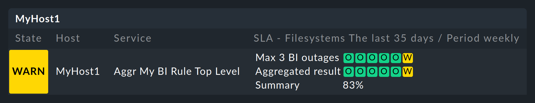

A view showing the SLA information for a BI aggregation.
The service shows the SLA information for a BI aggregation

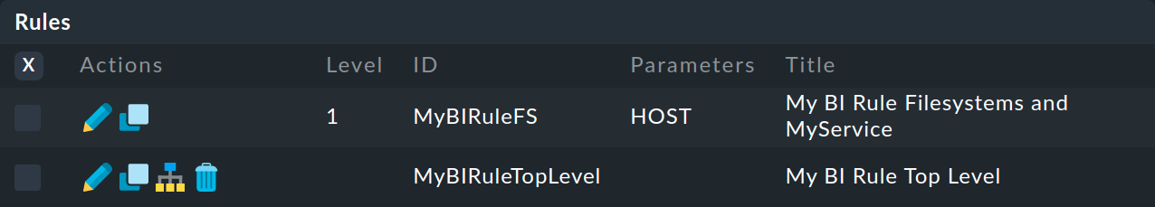

You will find this rule under Setup > Services > Other services > Check State of BI Aggregation and a description of the rule set in the BI article. The rule is also designed to query BI aggregates on remote Checkmk servers. For this you will need to connect the URL to the server and specify an automation user — and of course the desired BI aggregation: In the Aggregation Name field, enter the title of a top-level rule from your BI package, in the following example the rule with the My BI Rule Top Level title:
List of BI rules for selecting a top-level rule.
From the BI rules list you can read the title of the top-level rule
Note: There is a risk of confusion here: In the BI configuration, you create the actual aggregation, i.e. the logic, via rules — and in this example one of the top-level rules is entered via its title as Aggregation Name.
