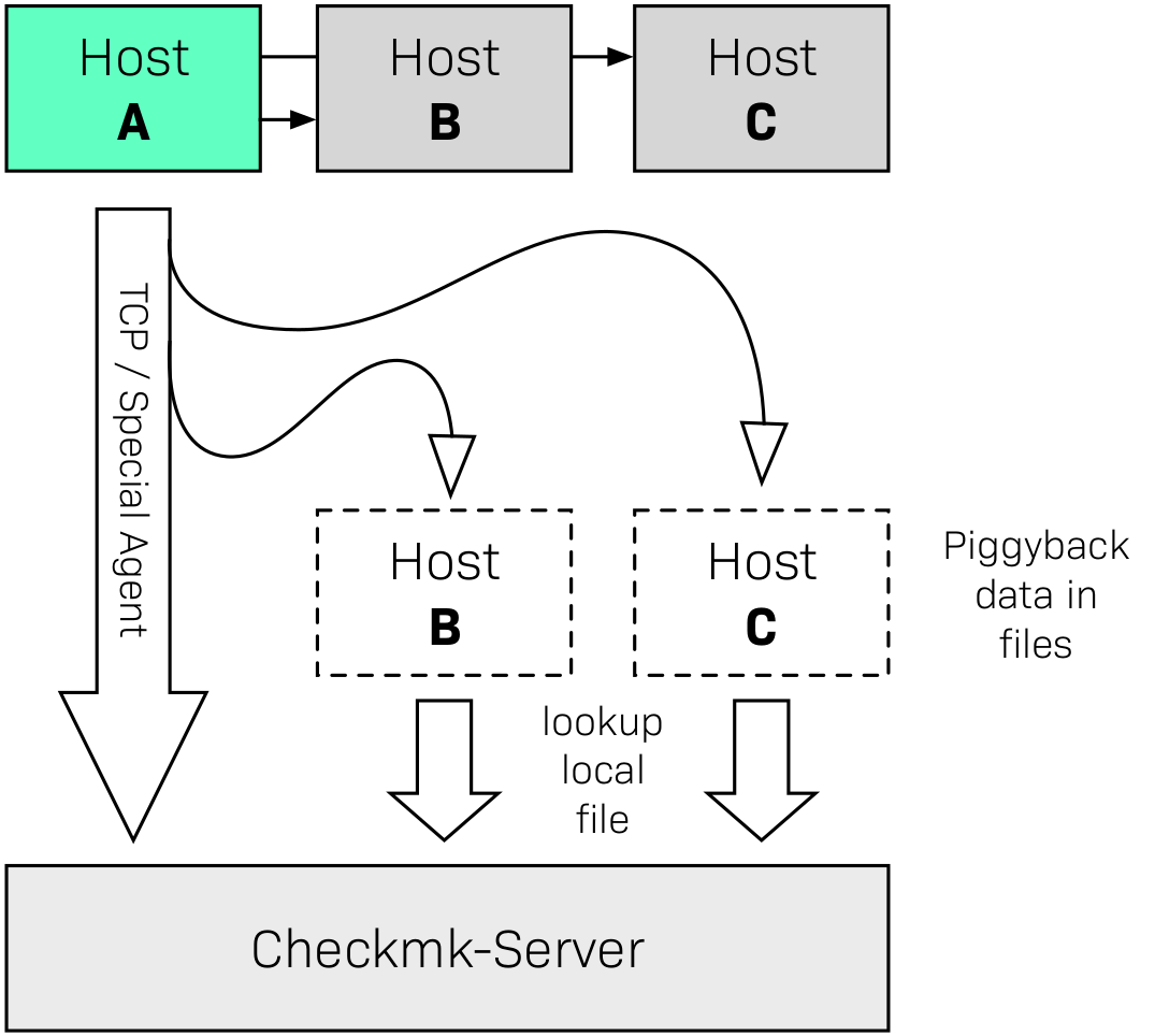

The basic principle of piggyback works as shown in the following diagram: Host A not only has its own monitoring data, but also that from other hosts — or more generally from other objects. For example, an ESX host records the state and many current metrics for each of its virtual machines (VMs). This host A is sometimes referred to as the source host in this context.
If Checkmk now retrieves the monitoring data from A in its regular one-minute intervals — be it from the normal Checkmk agent or from a special agent via a manufacturer’s API — in the response it also receives specially-marked reporting data from the other hosts/objects B, C, and so on. This piggyback data is then placed in files on the Checkmk server for later processing. The hosts B, C, and so on are referred to as piggyback hosts.
If Checkmk later requires the monitoring data from B or C, they are already in the local files and can be processed directly without having to query an agent:
Schematic representation of indirect data forwarding via the piggyback mechanism.

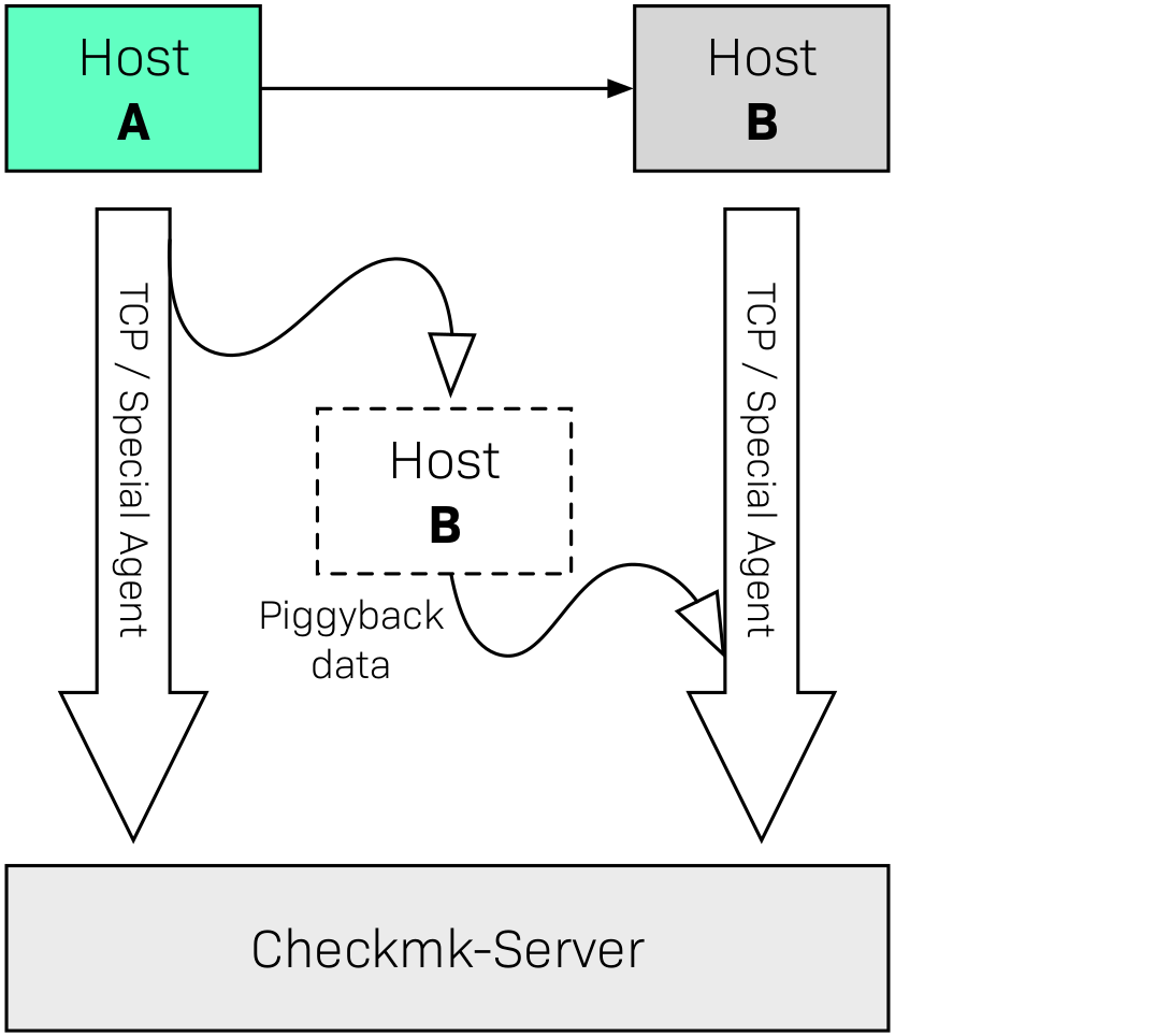

It is also possible and useful to combine normal monitoring and piggybacking. Let’s take the example of VMware again: You may have installed a Checkmk agent in your VM B which evaluates local information from the VM that is not known to the ESX host (e.g., processes running in the VM). In this case not only will the agent be queried, but its data will also be combined with the piggyback data received from host A:
Schematic representation of combined data forwarding: part of the data comes via Piggyback, the rest directly from the monitored host.

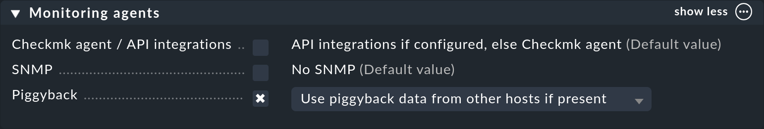

However — as usual in Checkmk — everything is configurable. Namely, in the properties of a host (such as host B) in the Monitoring agents box you can set how it should react to existing or missing piggyback data:
Piggyback data redirection is defined in the agent settings.
The default is Use piggyback data from other hosts if present. If available, piggyback data is used, and if none is there the host just uses its ‘own’ monitoring data.
With the Always use and expect piggyback data setting you force the processing of piggyback data. If the data is missing or outdated the Check_MK service will issue a warning.
And with Never use piggyback data any piggyback data found is simply ignored — a setting that you’ll only need in exceptional cases.

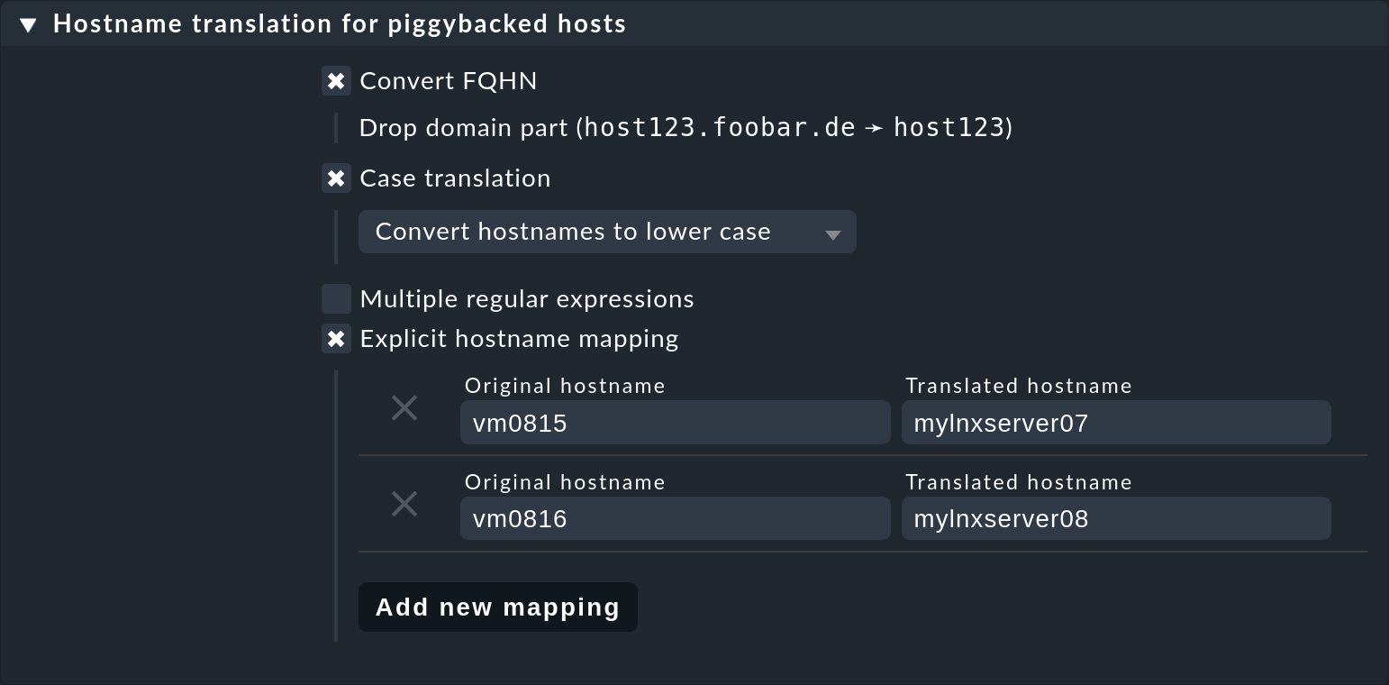

Here is an example of the value in a rule. Two things are configured: first, all host names from the piggyback data are converted to lowercase letters. Then the two hosts vm0815 or vm0816 are also converted to the Checkmk host’s mylnxserver07 or mylnxserver08:
Options for 'hostname translation', removing the domain part, conversion to lowercase or explicit mapping.
More flexible is the method using regular expressions found under Multiple regular expressions. This is useful if the renaming of many hosts is necessary, and it is done according to a specific scheme. Proceed as follows:
  1. Activate the Multiple regular expressions option.
  2. Add a translation entry with the Add expression button — two fields will appear.
  3. In the first field — Regular expression — enter a regular expression that matches the original object name and which contains at least one subgroup – that is, a sub-expression enclosed in parentheses. For a good explanation of these groups see the article on regular expressions.
  4. In Replacement specify a schema for the desired target host name in which the values that were ‘trapped’ with the subgroups will be replaced by \1, \2, etc.
An example of a regular expression would be, for example vm(.*)-local. The substitute value myvm\1 would then translate the name vmharri-local into myvmharri.

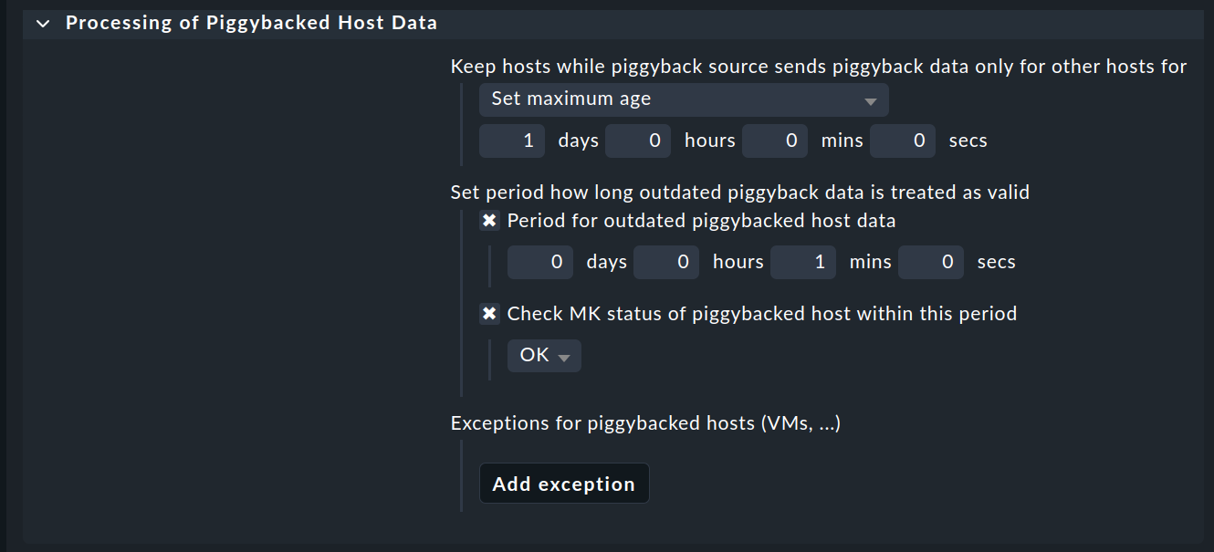

If your network changes, the piggyback data may also change. This raises new questions. How does monitoring react if a host is not accessible? What happens if piggyback data becomes obsolete, for example because the object is temporarily - or even permanently - no longer available? Is all piggyback data treated in the same way or are there differences? As with many other topics in Checkmk, the behavior here is also a matter of settings and therefore rules. With the rule Processing of piggybacked host data, which you can find under Setup > Agents > Agent access rules, you can set various options.
In the section Processing of piggybacked host data you enter the actually interesting details for processing the piggyback data.
Defining the rules for outdated piggyback data.
Checkmk makes your work easier when managing piggyback data. Among other things, it automatically removes all hosts/objects for which no piggyback data is (or is no longer) supplied by a source host. With the option Keep hosts while piggyback source sends piggyback data only for other hosts you specify the time after which the affected files with piggyback data are deleted. Make sure that this period is at least as long as the check interval for the piggyback hosts.
Use the two options in Set period how long outdated piggyback data is treated as valid to define for how long existing piggyback data should still be considered valid if the host no longer supplies new data. After the defined period has expired, the services based on the piggyback data are displayed as stale. You also define the status of the Check_MK service during this period. You can use this to avoid unnecessary warnings, especially if there are repeated short-term connection interruptions.
Once you have defined the handling of piggyback data in general, you can define separate handling (according to the same scheme) for individual hosts under Exceptions for piggybacked hosts using the options described.
Finally, you must always specify the name of the source host in the Explicit hosts option in the Conditions.
