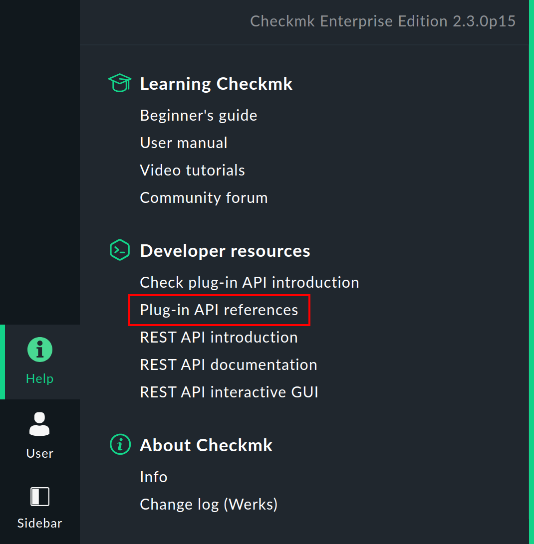

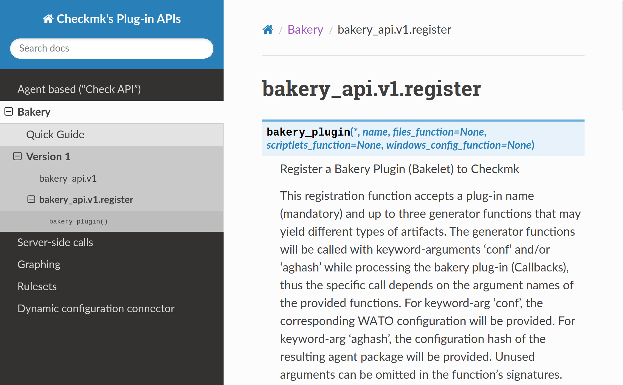

2.3. Access to the API documentation
The Bakery API documentation is available in HTML format for viewing in a web browser and can be opened from the Checkmk GUI: from the navigation bar in the Help > Developer resources > Plug-in API references menu:
Help menu in the navigation bar.

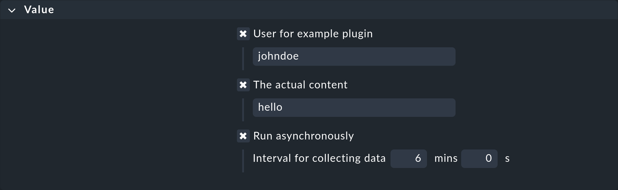

Extended rule set
However, in the example scenario, we have specified that an execution interval should be chosen and the two variables user and content should be set. These variables are defined as keys in the Dictionary, which is returned by the function specified as parameter_form.
~/local/lib/python3/cmk_addons/plugins/hello_world/rulesets/ruleset_hello_world_bakery.py

The GUI resulting from this rule set is shown in the following screenshot:
GUI des Regelsatzes zur Konfiguration des Plugins.

3.6. Registration
Registering the plug-in with Checkmk with a plug-in name and its functions is accomplished with the register.bakery_plugin function:
~/local/lib/check_mk/base/cee/plugins/bakery/hello_world.py
register.bakery_plugin(
    name = "hello_world",
    files_function = get_hello_world_plugin_files,
    scriptlets_function = get_hello_world_scriptlets,
    windows_config_function = get_hello_world_windows_config,
The get_hello_world_windows_config, get_hello_world_scriptlets and get_hello_world_plugin_files functions specified here are explained in more detail in the following chapters.
