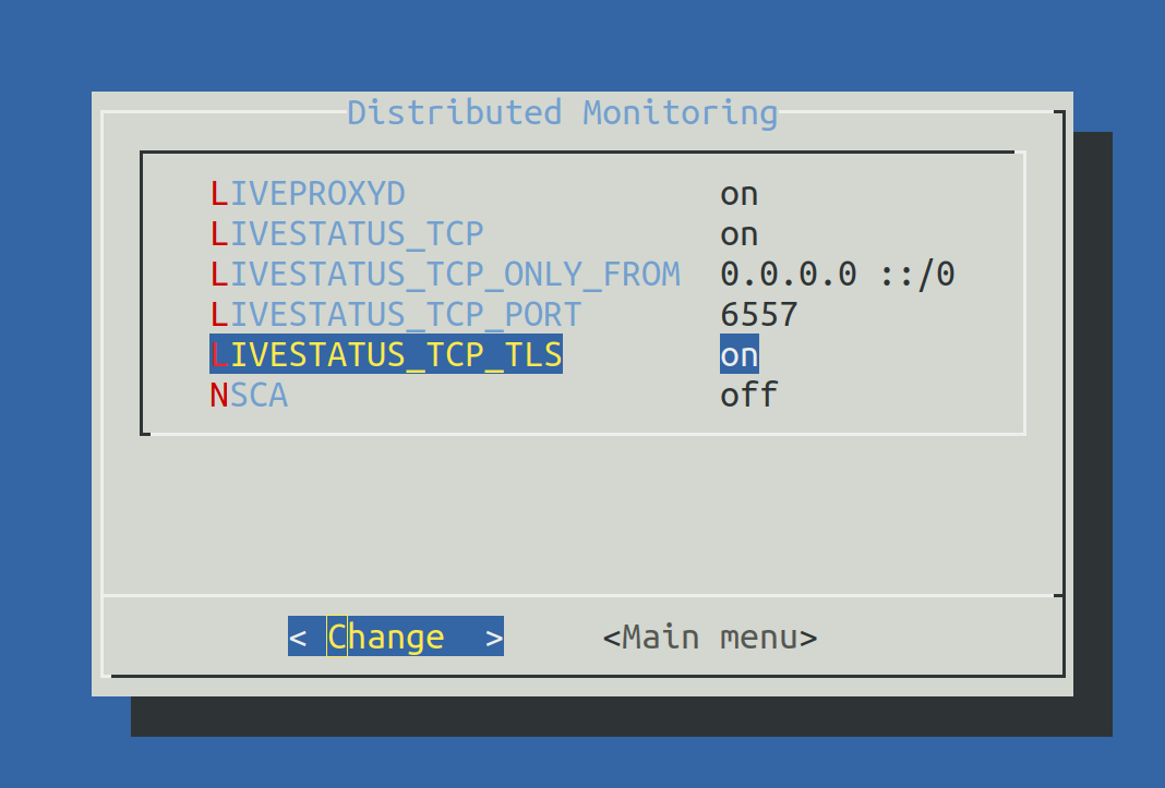

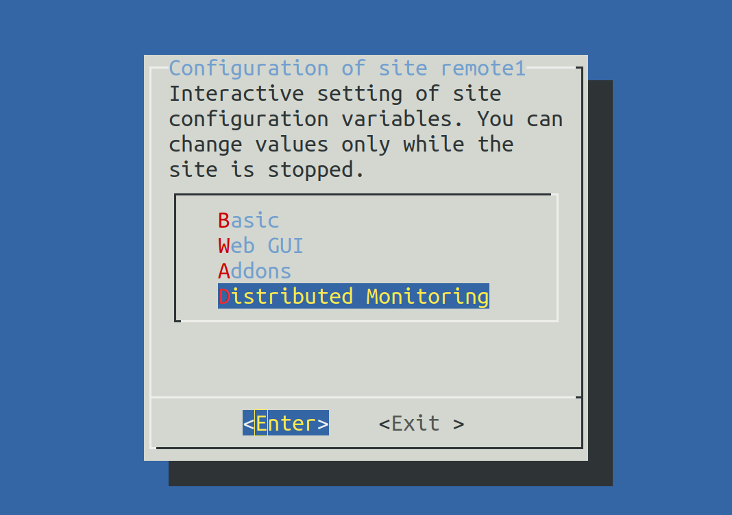

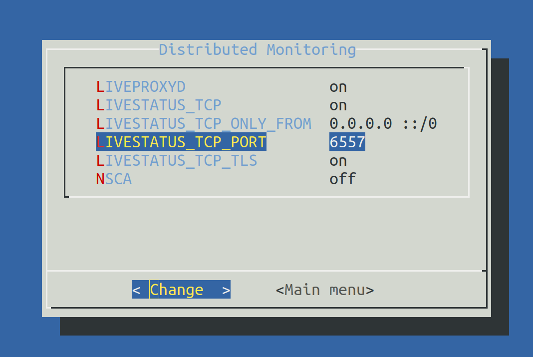

The most important step is now to enable Livestatus via TCP on the network. Note that Livestatus is not per se a secure protocol and should only be used within a secure network (secured LAN, VPN, etc.). The enabling appears per omd config as an site user on a stopped site:
root@linux# su - remote1
OMD[remote1]:~$ omd config
Now select Distributed Monitoring:
distributed monitoring omd config
Set LIVESTATUS_TCP to ‘on’ and enter an available port number for LIVESTATUS_TCP_PORT that is explicit on this server. The default is 6557:
distributed monitoring livestatus tcp activated

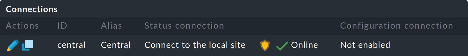

The configuration of the distributed monitoring takes place exclusively on the central site in the menu Setup > General > Distributed monitoring, and this serves to manage the connections to the individual sites. For this function the central site itself counts as a site and is already present in the list:
distributed monitoring central site
Using icon new Add connection, now define the connection to the first remote site:

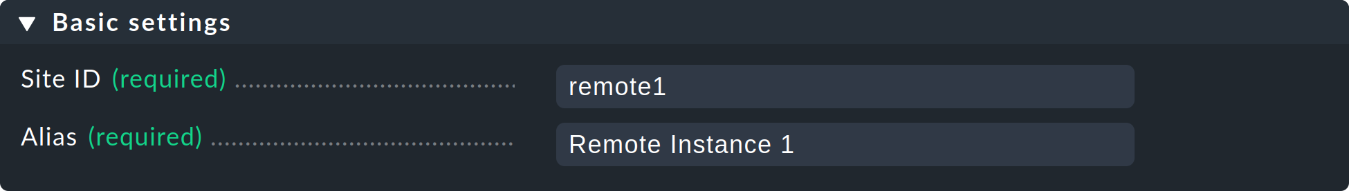

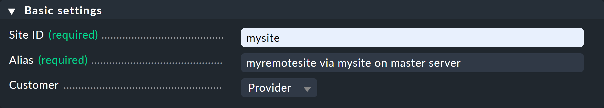

distributed monitoring basic settings
In the Basic settings it is important to use the remote site’s EXACT name — as defined with omd create — as the Site ID. As always the alias can be defined as desired and also be later changed.

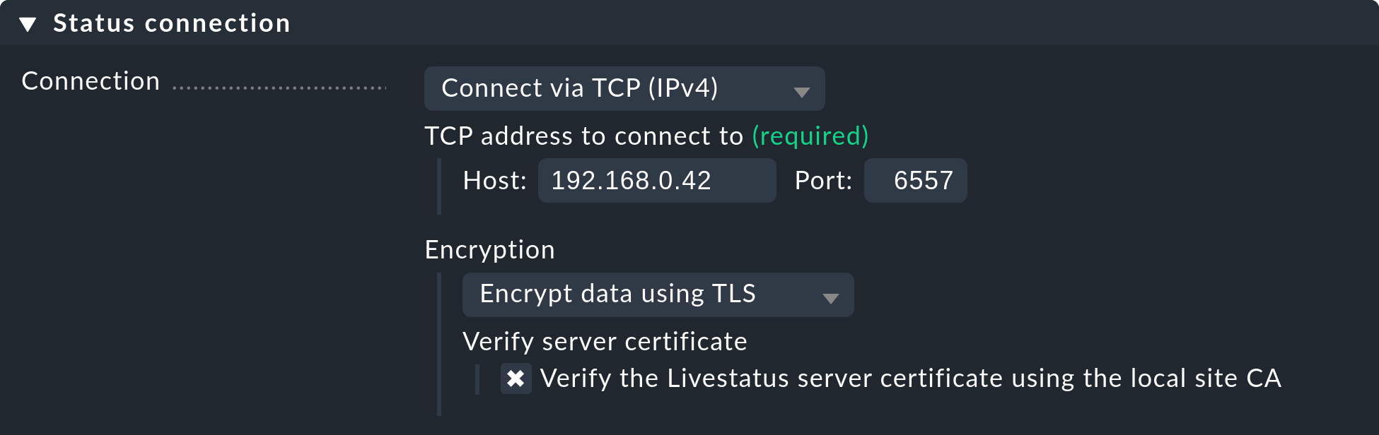

distributed monitoring status connection

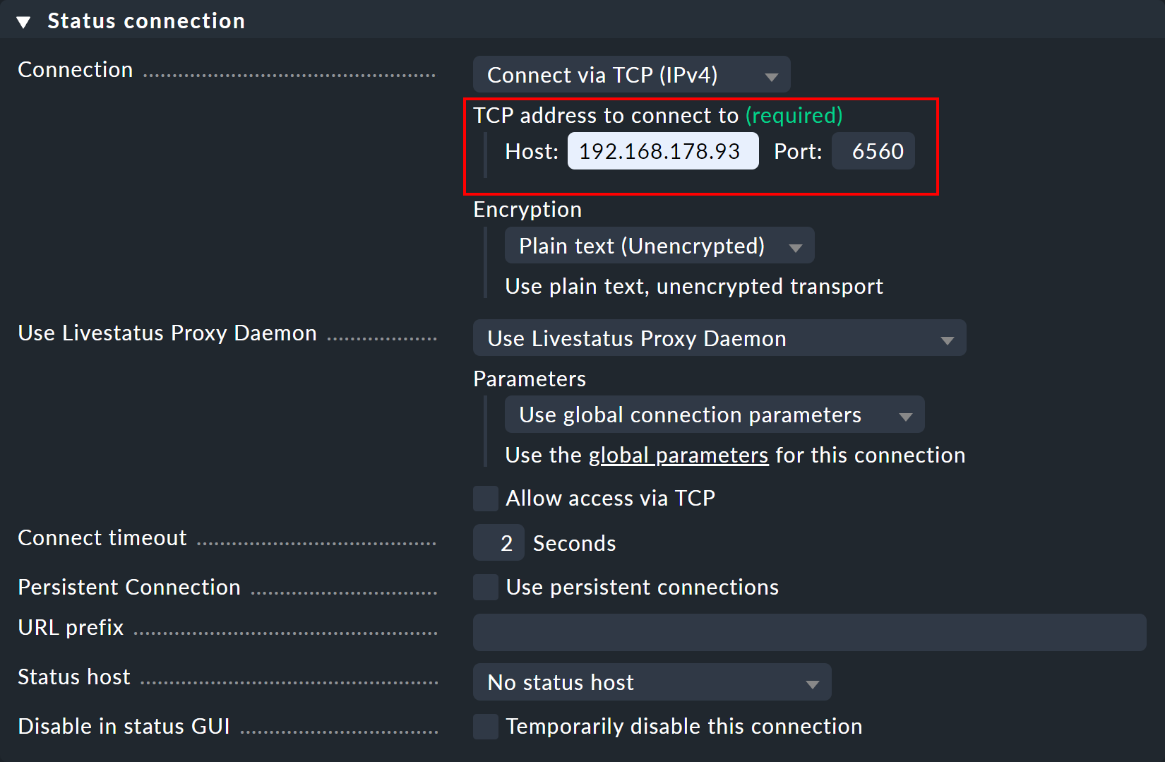

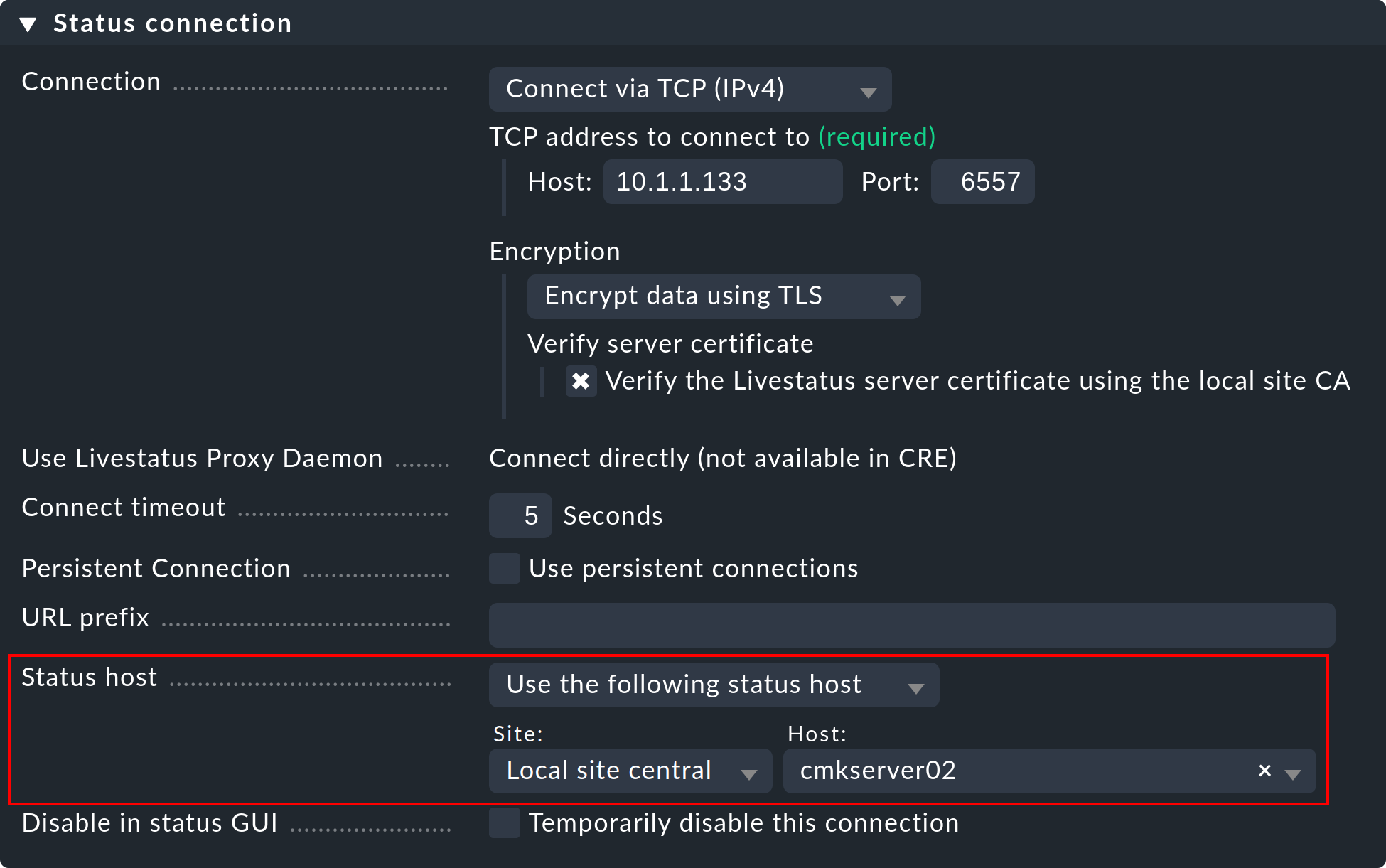

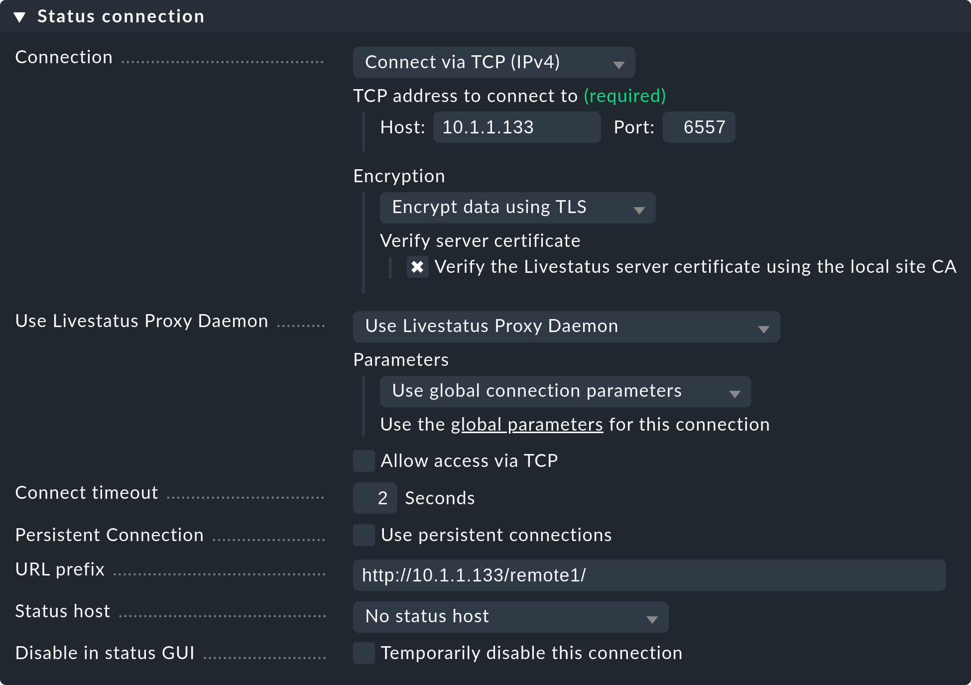

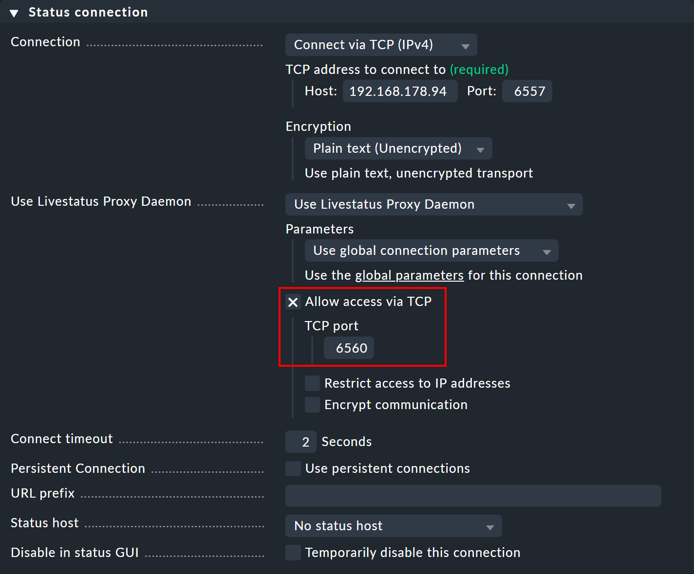

The settings of the Status connection determine how the central queries the status of the remote sites via Livestatus. The example in the screenshot shows a connection with the Connect via TCP(IPv4) method. This is the optimal for stable connections with short latency periods (such as, e.g. in a LAN). We will discuss the optimal settings for WAN connections later.
Enter the HTTP-URL to the remote’s web interface here (only the part preceding the check_mk/ component). If you basically access Checkmk per HTTPS, then substitute the http here with https. Further information can be found in the online help icon help or the article on securing the web interface with HTTPS.
distributed monitoring configuration connection

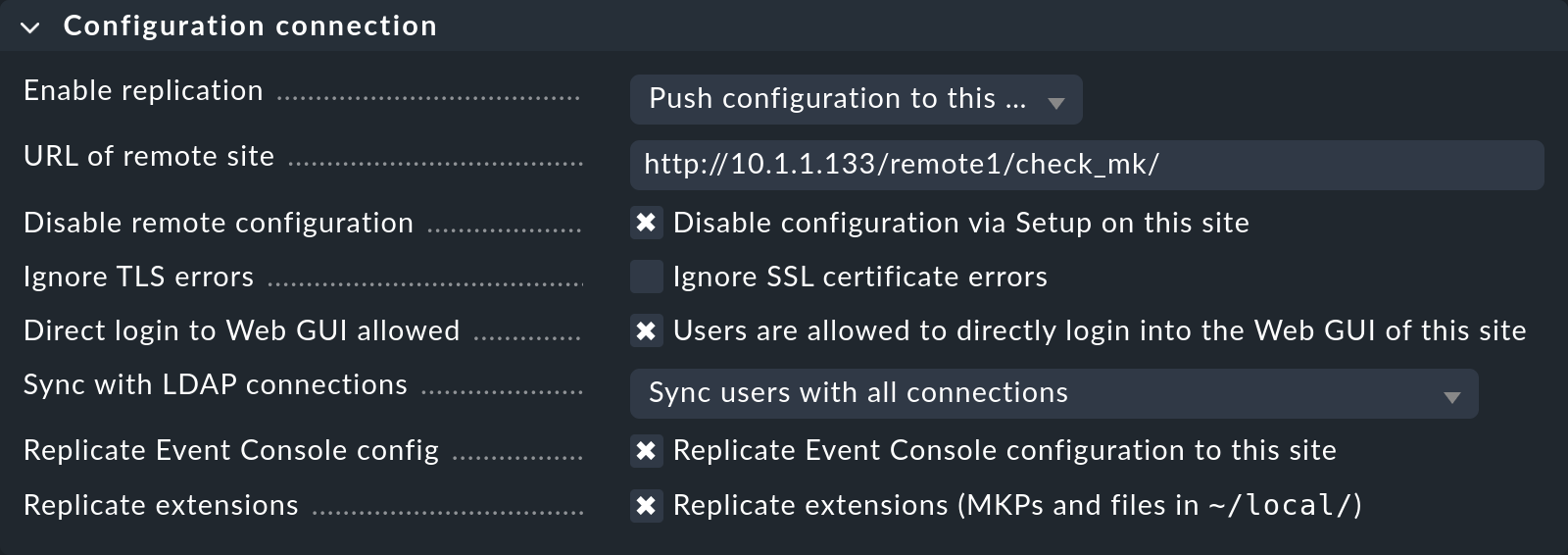

Replicating the configuration and thus using the distributed configuration environment is, as we discussed in the introduction, optional. Activate this if you wish to configure the remote with and from the central site. In such a case select the exact settings as shown in the image above.
A correct setting for the URL of remote site is very important. The URL must always end with /check_mk/. A connection with HTTPS is recommended, provided that the remote site’s Apache supports HTTPS. This must be installed manually on the remote at the Linux level. For the Checkmk Appliance, HTTPS can be set up using the web-based configuration interface. If you utilize a self-signed certificate, you will require the Ignore SSL certificate errors check box.

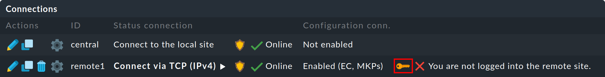

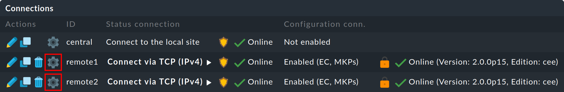

Once the mask has been saved a second site will appear in the overview:
distributed monitoring before login
The (so far) empty remote site’s monitoring status is now correctly integrated. In order to use the distributed configuration environment you still need a login for the remote Checkmk site. To this end, the central site exchanges a randomly-generated login secret with the remote site, through which all future communication will take place. The cmkadmin access on the remote site will subsequently no longer be used.

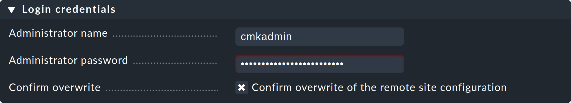

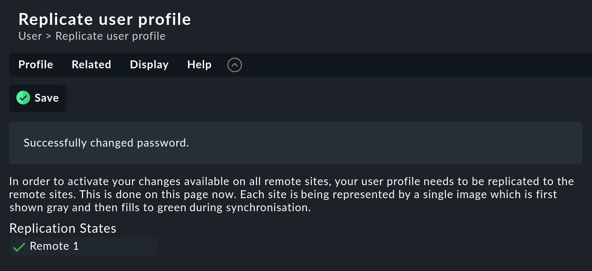

To login use the access data cmkadmin and the according password of the remote site. Do not forget to the box Confirm overwrite, before you click the Login button:
distributed monitoring login credentials

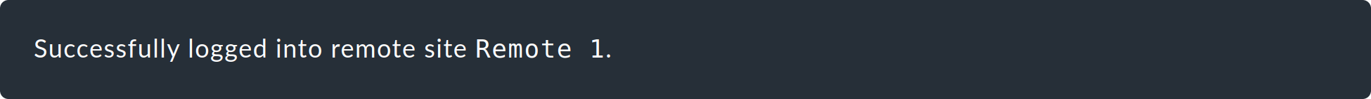

A successful login will be so acknowledged:
distributed monitoring successful login

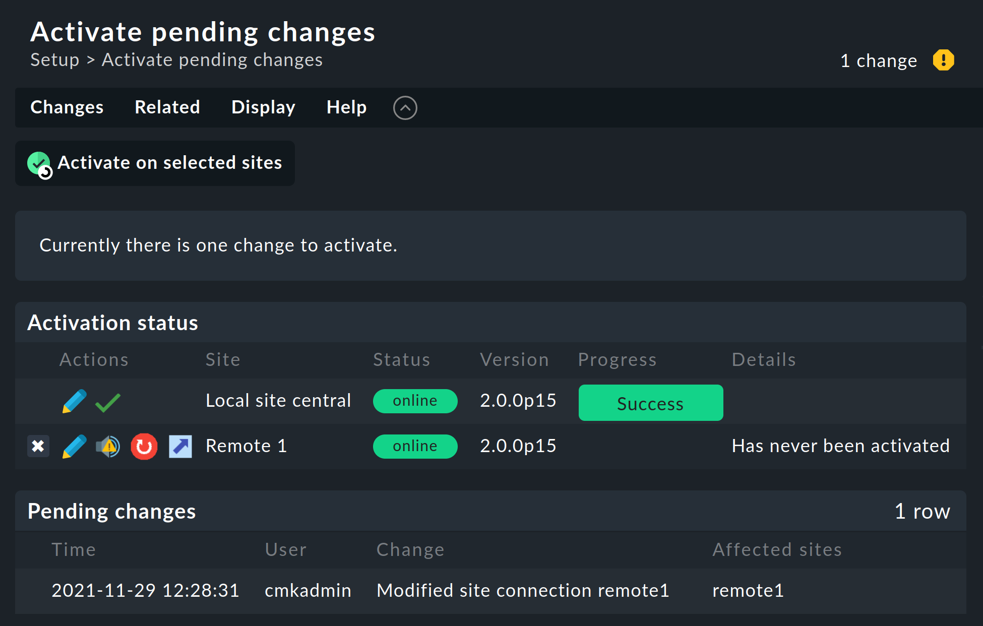

When everything has been successful run Activate Changes. This will, as always, bring you to an overview of the not yet activated changes. Simultaneously the overview will also show the states of the Livestatus connections, likewise the synchronization states of the distributed configuration environment of the individual sites:
distributed monitoring activate pending changes
The Version column shows the Livestatus-version of the respective site. When using the CMC as the Checkmk’s core (commercial editions), the core’s version number (shown in the ‘Core’ column) is identical to that of the Livestatus. If you are using Nagios as the core (Checkmk Community), the Nagios version number will be seen here.
The following symbols show replication status of the configuration environment:
icon need restart
This site has outstanding changes. The configuration matches the central site, but not all changes have been activated. With the icon need restart button a targeted activation for this site can be performed.
icon need replicate
The configuration for this site is not synchronous and must be carried over. A restart will then of course be necessary to activate it. Both functions can be performed with a click of the icon need replicate button.

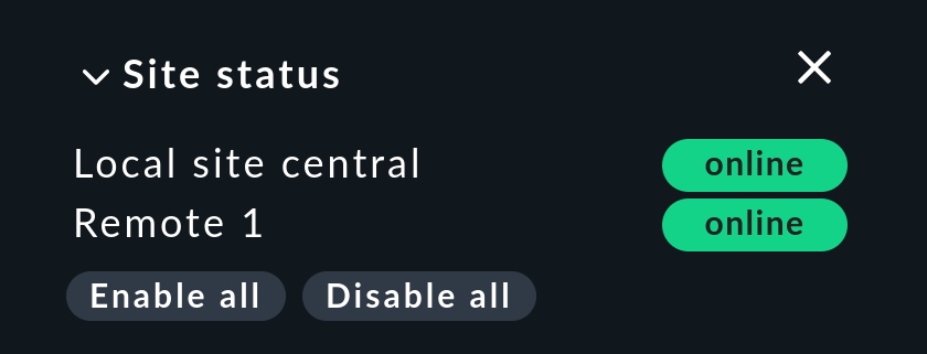

In the Status column the state of the Livestatus connection for the respective site can be seen. This is shown purely for information since the configuration is not transmitted via Livestatus, but rather over HTTP. The following values are possible:
icon status label online
The site is reachable via Livestatus.
icon status label dead
The site is currently not reachable. Livestatus queries are running in a Timeout. This delays the page loading. Status data for this site is not visible in the GUI.
icon status label down
The site is currently not reachable, but this is due to the setting up of a status host or is known through the Livestatus proxy (see below). The inaccessibility does not lead to Timeouts. Status data for this site is not visible in the GUI.
icon status label disabled
The Livestatus connection to this site has been temporarily deactivated by the (central site’s) administrator. The setting matches the ‘Temporarily disable this connection’ check box in the settings for this connection.
Clicking the icon activate changes Activate on selected sites button will now synchronize all sites and activate the changes. This is performed in parallel, so that the overall time equates to the time required by the slowest site. Included in the time is the creation of a configuration snapshot for the respective site, the transmission over HTTP, the unpacking of the snapshot on the remote site, and the activation of the changes.
Important: Do not leave the page before the synchronization has been completed on all sites — leaving the page will interrupt the synchronization.

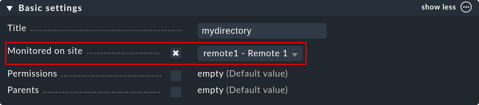

Once your distributed environment has been installed you can begin to use it. You actually only need to tell each host by which site it should be monitored. The central site is specified by default.
The required attribute for this is ‘Monitored on site’. You can set this individually for each host. This can naturally also be performed at the folder level:
distributed monitoring monitored on site

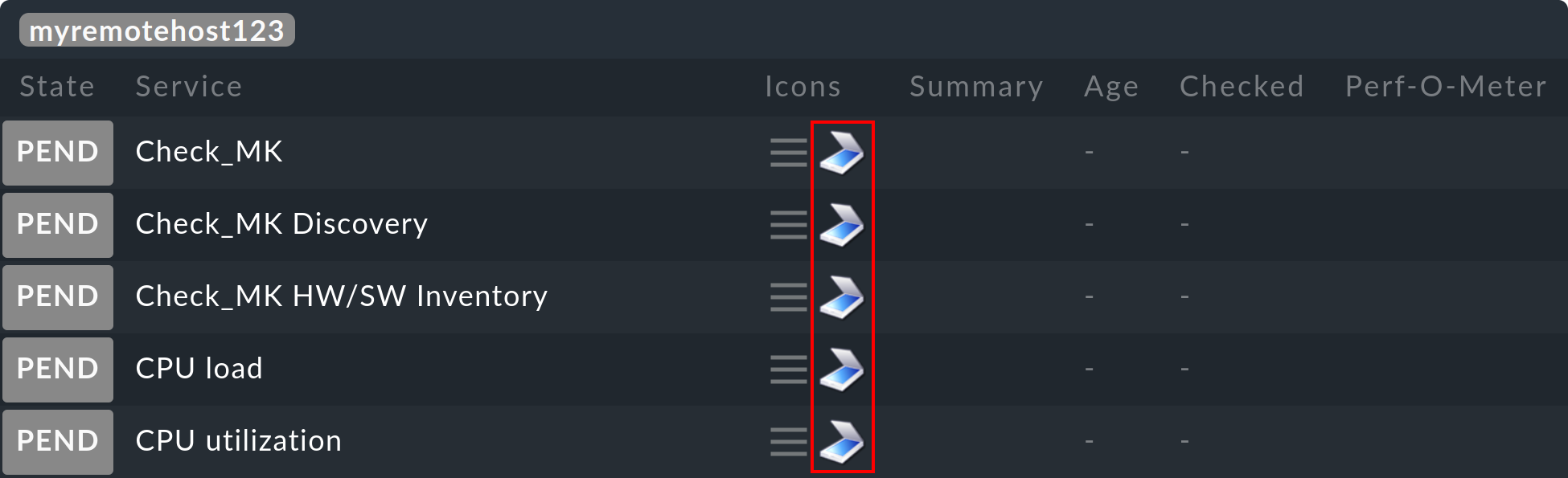

  • Once restarted, hosts and services will show PEND. Currently existing problems may as a result be newly notified.

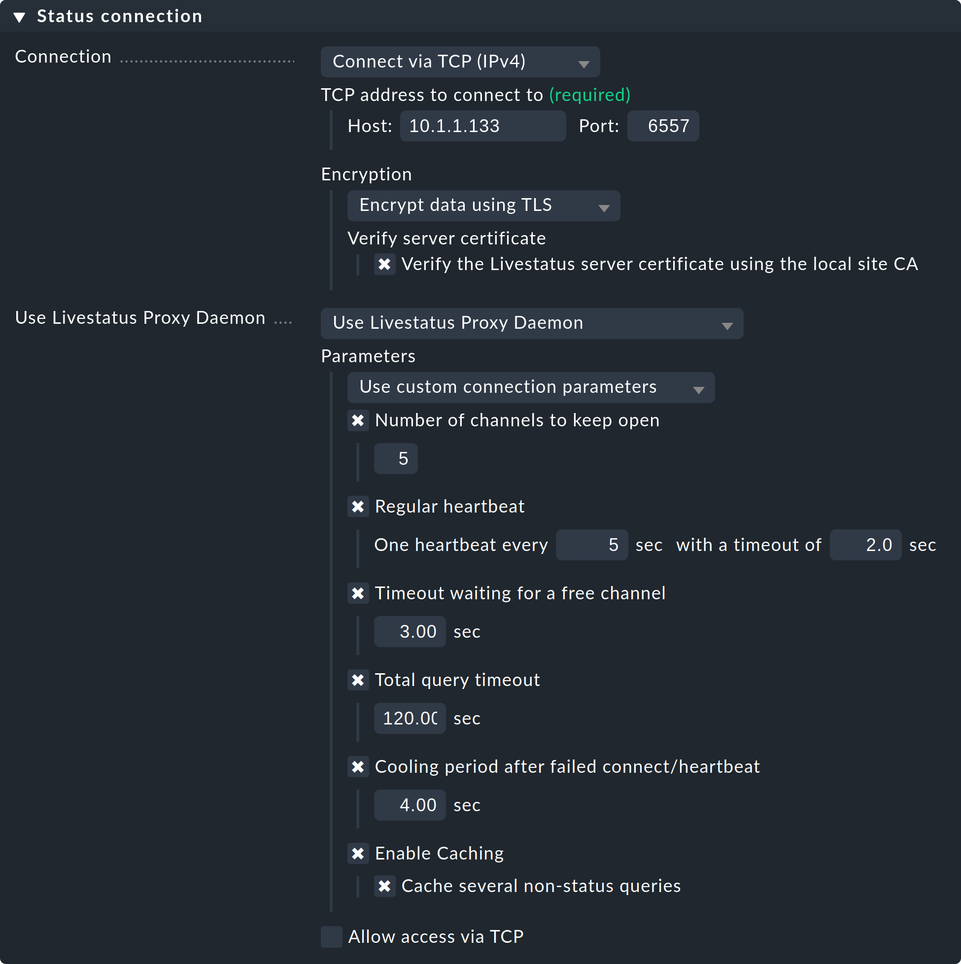

2.3. Connecting Livestatus with encryption
From version 1.6.0 Livestatus connections between the central site and a remote can be encrypted. For newly-created sites nothing further needs to done, as Checkmk takes care of the necessary steps automatically. As soon as you then use omd config to activate Livestatus, encryption is also automatically activated by TLS:
distributed monitoring livestatus tcp tls activated
The configuration of distributed monitoring therefore remains as simple as it has been up to now. For new connections to other sites the option Encryption is then automatically enabled.

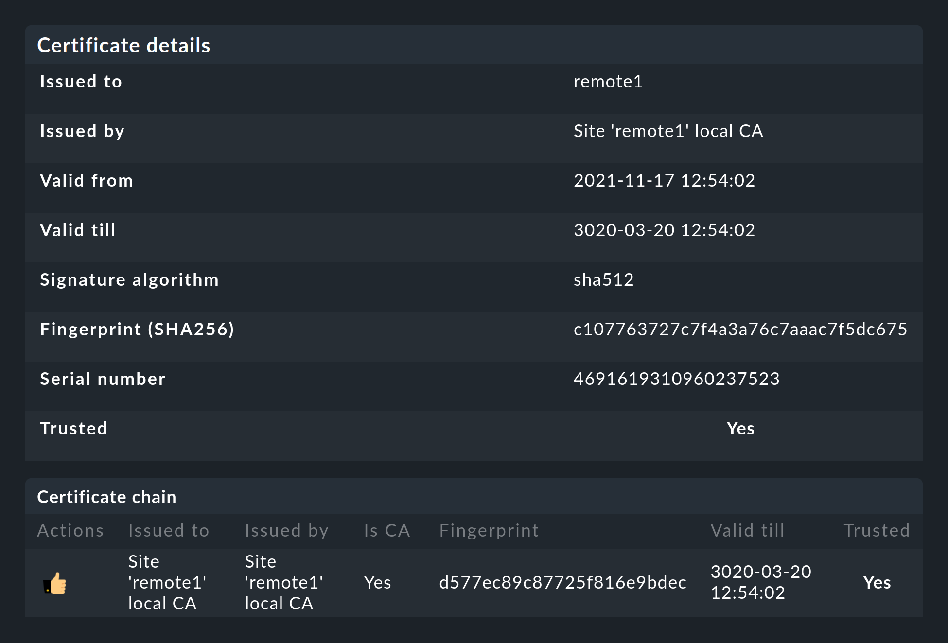

After you add the remote site, you will notice two things — firstly, the connection is marked as encrypted by this new icon encrypted icon. And secondly, Checkmk will tell you that the CA will no longer trust the remote site. Click on icon encrypted to get to the details of the certificates used. A click on icon trust lets you conveniently add the CA via the web interface. Then both certificates will be listed as trusted:
distributed monitoring certificate details
Details of the technologies used
To achieve the encryption Checkmk uses the stunnel program along with its own certificate and its own Certificate Authority (CA) to sign the certificate. These will be individually generated automatically with a new site and they are therefore not predefined static CAs or certificates. That is a very important safety factor to prevent fake certificates from being used by attackers, because any attackers could then gain access to a publicly-available CA.
The generated certificates also have the following properties:
  • Both certificates are in the PEM format. The signed certificates for the site also contain the complete certificate chain.
  • The keys use 4096-bit RSA, and the certificate is signed using SHA512
  • The site’s certificate is valid for 10 years.
The fact that the standard certificate is valid for so long very effectively prevents you from getting connection problems that you cannot classify. At the same time it is of course possible that once a certificate has been compromised it is accordingly long open to abuse. So if you fear that an attacker will gain access to the CA or to the site certificate signed with it, always replace both certificates (CA and site)!

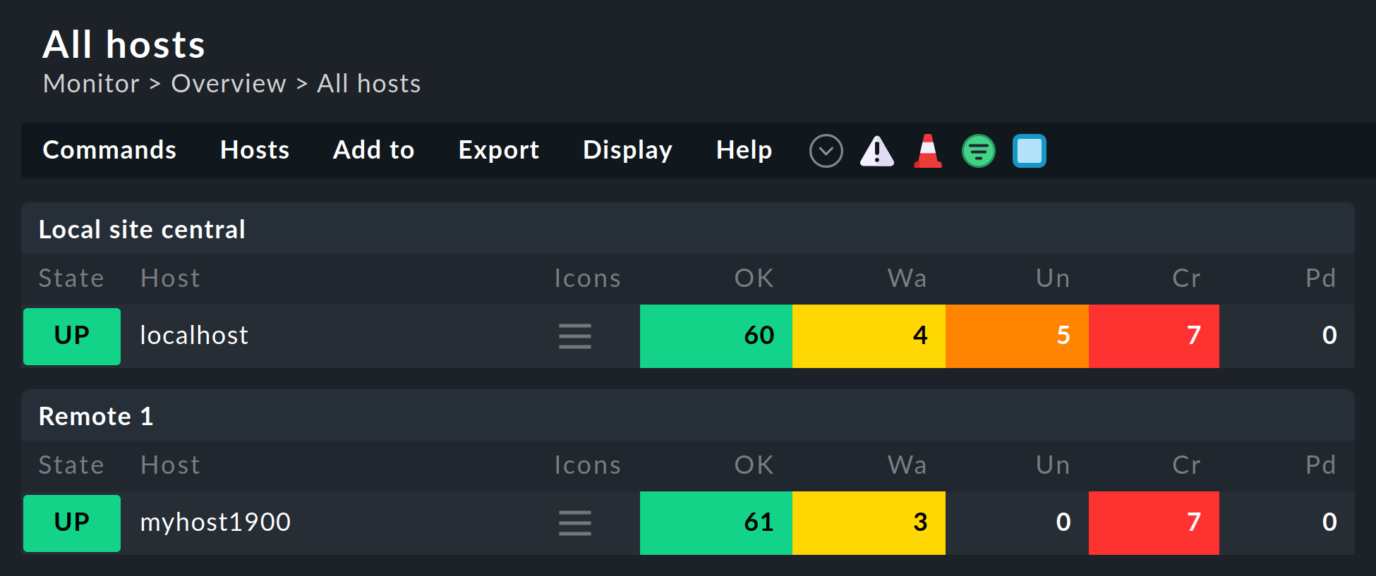

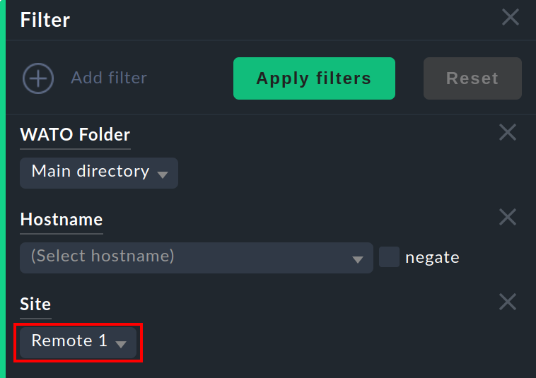

Specifying the site in views
Some of the standard views are grouped according the site from which the host will be monitored — this applies for, e.g. All hosts:
distributed monitoring all hosts

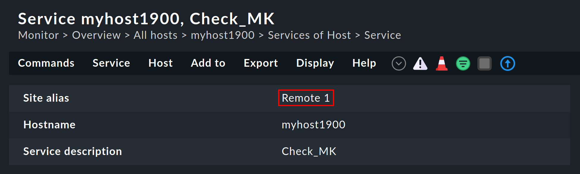

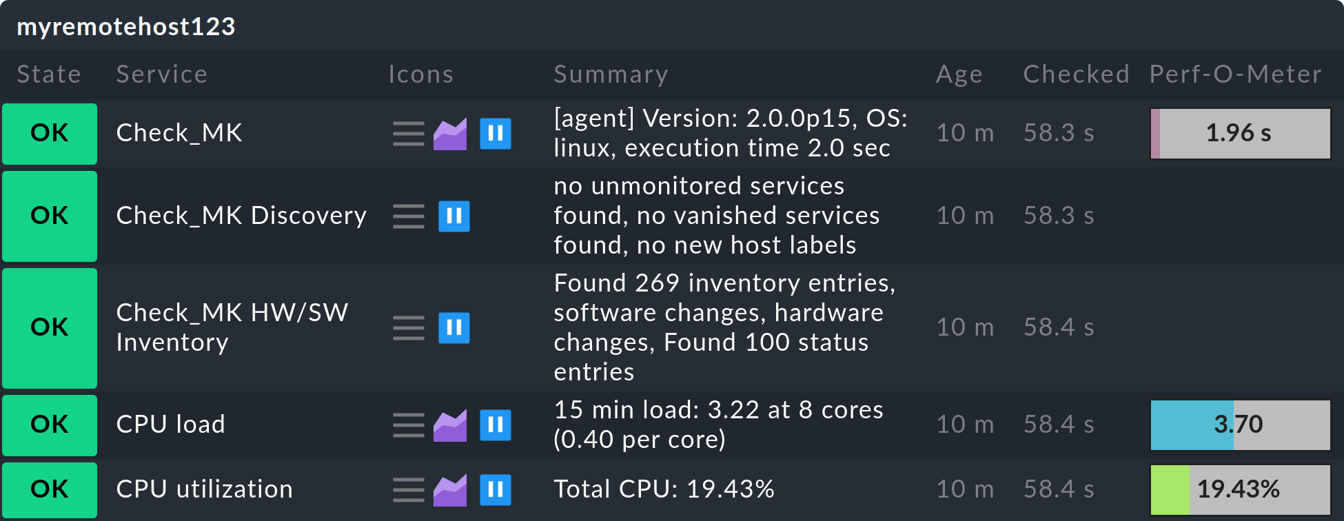

The site will likewise be shown in the host’s or service’s details:
distributed monitoring service check mk
This information is generally available for use in a column when creating your own views. There is also a filter with which a view of hosts on a specific site can be filtered:
distributed monitoring filter by site
Site status snap-in
There is a Site status snap-in for the side bar which can be added using Icon to show all snap-ins.. This displays the status of the individual sites. It also provides the option to temporarily disable and re-enable a single site by clicking on the status — or all sites at once by clicking Disable all or Enable all.
distributed monitoring snapin site status
Disabled sites will be flagged with the icon status label disabled status. With this you can also disable a icon status label dead site that is generating timeouts, thus avoiding superfluous timeouts. This disabling is not the same as disabling the Livestatus connection using the connection configuration in the Setup. Here the ‘disabling’ only affects the currently logged-in user and has a purely visual function. Clicking on a site’s name will display a view of all of its hosts.

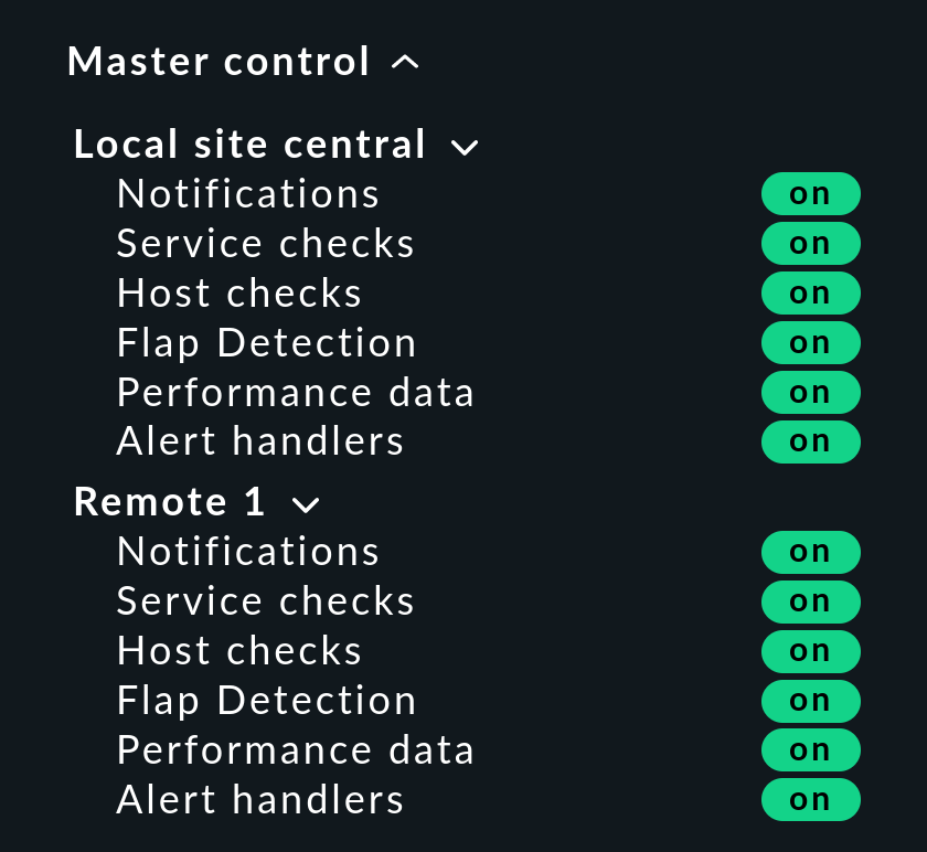

Master control snap-in
In a distributed monitoring the Master control snap-in has a different appearance. Each site has its own global switch:
distributed monitoring master control

Changing a password
Even when all sites are being centrally monitored, a login on an individual site’s interface is quite possible and often also appropriate. For this reason Checkmk ensures that a user’s password is always the same for all sites.
A password change made by the administrator will take effect automatically as soon as it is shared to all sites with Activate Changes.
A change made by a user themselves using the button sidebar settings sidebar in their personal settings works somewhat differently. This cannot execute an Activate changes since the user of course has no general authority for this function. In such a case Checkmk will automatically share the changed password across all sites — directly after it has been saved in fact.
As we all know, networks are never 100 % available. If a site is unreachable at the time of a password change, it will not receive the new password. Until the administrator successfully runs an Activate changes, or respectively, the next successful password change, this site will retain the old password for the user. A status symbol will inform the user of the status of the password sharing to the individual sites.
distributed monitoring replicate user profile

2. Folders
Next, move the hosts and rules into the configuration environment on the central site. This only works for hosts and rules in sub-folders (i.e., not in the Main folder). Hosts in the main folder should first simply be moved into a remote site’s sub-folder via Setup > Hosts > Hosts.
The actual migration can then be achieved quite simply by copying the appropriate directories. Each folder in configuration environment corresponds to a directory within ~/etc/check_mk/conf.d/wato/. These can be copied using a tool of your choice (e.g. scp) from the tethered site to the same location in the central site. If a directory with the same name already exists there, simply rename it. Note that Linux users and groups are also used by the central site.
Following the copying the hosts will appear in the central site’s Setup — as well as the rules you have created in these folders. The folders’ properties will also be included with the copying. These can be found in the directory in the hidden .wato file.
3. One-time editing and saving
So that the attributes of the central site’s parent folder’s functions are correctly inherited, as a final step following the migration the parent folders’ characteristics must be opened and saved once – the host’s attributes will thereby be freshly defined.

3.1. Status hosts
CRE The configuration of Status hosts is the recommended procedure with CRE Checkmk Community in order to recognize defective connections reliably. The idea is simple: The central site actively monitors the connection to each individual remote site. At least we will then have a monitoring system available! The GUI will then be aware of unreachable sites and can immediately exclude and flag them as icon status label down. Timeouts are thus minimized.
Here is how to set up a status host for a connection:
  1. Add the host on which the remote site is running to the central site in monitoring.
  2. Enter this as the status host in the connection to the remote:
distributed monitoring status host
A failed connection to a remote site can now only lead to a brief hangup of the GUI — namely until the monitoring has recognized it. By reducing the status host’s proof interval from the default of sixty seconds to, e.g. five seconds, you can minimize the duration of a hangup.

Select the setting ‘Use Livestatus Proxy-Daemon’ for the connection to the remote sites instead of ‘Connect via TCP’:
distributed monitoring livestatus proxy daemon
The details for host and port are as always. No changes must be made on the remote site. In Number of channels to keep open enter the number of parallel TCP-connections the proxy should establish and sustain to the target site.
The TCP-connections pool is shared by all GUI inquiries. The number of connections limits the maximum number of queries that can be processed concurrently. This indirectly limits the number of users. In situations in which all channels are reserved this will not immediately lead to an error. The GUI waits a given time for a free channel. Most queries actually require only a few milliseconds.
If the GUI must wait longer than Timeout waiting for a free channel for a channel, it will be interrupted with an error and the user will receive an error message. In such a case the number of connections should be increased. Be aware however that on the remote site sufficient parallel incoming connections must be allowed — this is set to 20 by default. This setting can be found in the global options under Monitoring core > Maximum concurrent Livestatus connections.
The Regular heartbeat provides a constantly active monitoring of the connections directly at the protocol level. In the process the proxy regularly sends a simple Livestatus query which must be answered by the remote site within the predetermined time (default: 2 seconds). With this method a situation where the target server and the TCP-port are actually reachable, but the monitoring core no longer responds, will also be detected.
If a response fails to appear, all connections will be declared ‘dead’, and following a ‘cooldown’ time (default: 4 seconds) will be newly established. All this takes place proactively — i.e. without a user needing to open a GUI-window. In this way outages can be quickly detected, and via a recovery the connections can be immediately reestablished and in the best case be available before a user even notices the outage.
The Caching ensures that static queries need only be responded-to once by the remote site, and from that point of time can be responded to directly and locally, without delay. An example of this is the list of monitored hosts required by Quicksearch.

The setup is done in the connection settings on the distributed monitoring, first on the central site, then on the viewer site (which does not actually have to exist yet).
On the central site, open the connection settings for the desired remote site via Setup > General > Distributed monitoring. Under Use Livestatus Proxy Daemon activate the Allow access via TCP option and enter an available port (here 6560). In this way, the Livestatus proxy on the central site connects to the remote site and opens a port for requests from the viewer site — which are then forwarded to the remote site.
Connection settings in distributed monitoring with TCP access enabled for viewer sites.
Now create a viewer site and again open the connection settings via Setup > General > Distributed monitoring. In the Basic settings enter — as always for connections in distributed monitoring — the exact name of the central site as the Site ID.
Site ID in the connection settings.
In the Status connection panel, enter the central site as the host — as well as the manually assigned free port (here 6560).
Connection settings with a central site and free port for Livestatus.
As soon as the connection is established, you will see the desired hosts and services on the remote site in the monitoring views for the viewer site.
If you want to cascade further, you must also allow TCP access to the Livestatus proxy on the viewer site, as done before on the central site, this time with a different free port.

As with Livedump the hosts and services will now appear on the central site in the PEND state. You will however see by the icon shadow symbol that we are dealing with a shadow object. In this way it can be distinguished from an object being monitored directly on the central site or on a ‘normal’ remote site:
distributed monitoring cmcdump pending

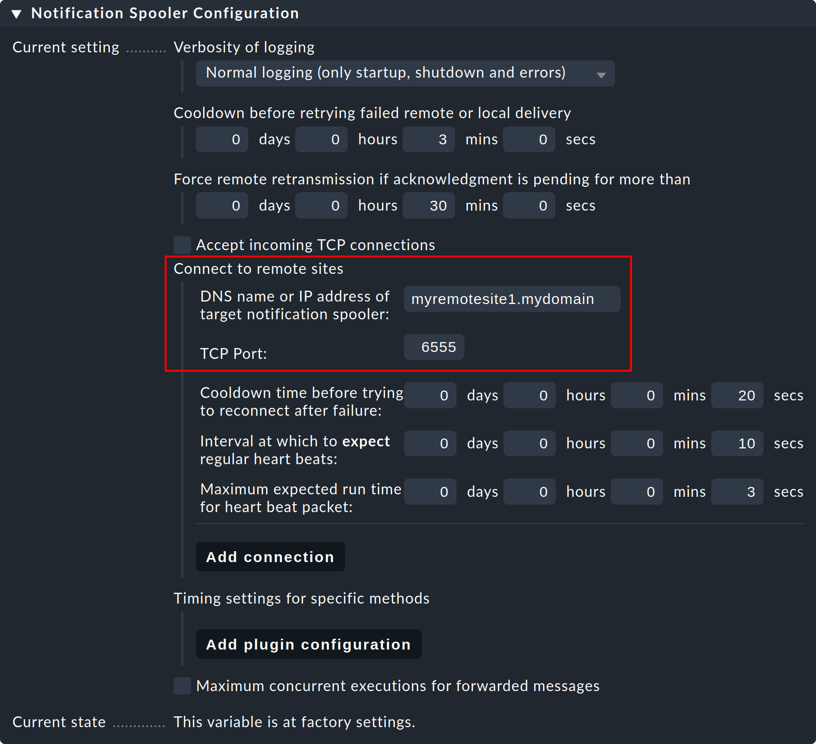

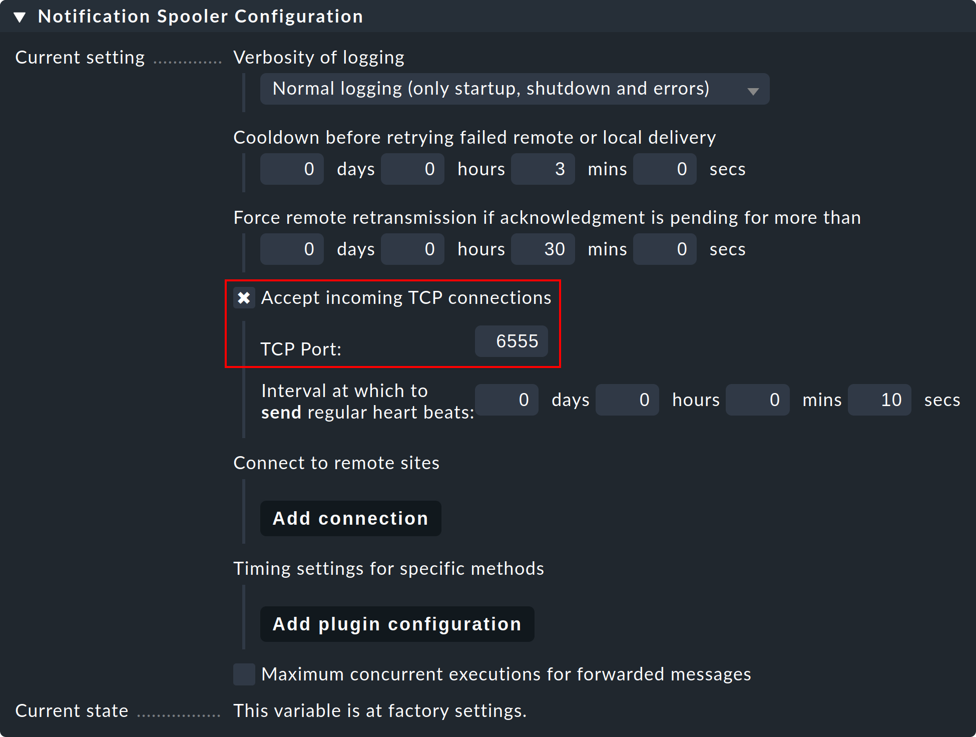

Let us look first at an example where the central site establishes the TCP-connections to the remote sites.
Step 1: On the remote site, edit the site specific global setting Notifications > Notification Spooler Configuration and activate Accept incoming TCP connections. TCP-Port 6555 will be recommended for incoming connections. If there are no objections, adopt these settings.
distributed monitoring notification spooler configuration

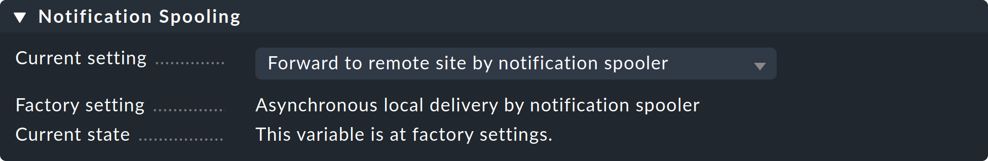

Step 2: Now, likewise, in the Notification Spooling submenu only on the remote site, select the option Forward to remote site by notification spooler.
distributed monitoring notification spooling
Step 3: Now, on the central site — i.e. in the normal global settings — configure the connection to the remote site (and then to additional remotes as needed):
distributed monitoring notification spooler central configuration

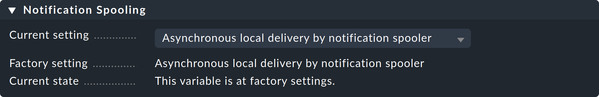

Step 4: Set the global setting Notification Spooling to Asynchronous local delivery by notification spooler, so that the central site’s communications will also be processed over the same central spooler.
distributed monitoring notification spooling central
Step 5: Activate the changes.

To test, select any monitored remote service and set it manually to CRIT with the Fake check results command.
Now on the central site an incoming notification should appear in the notifications log file (notify.log):
central:var/log/notify.log
2021-11-17 07:59:36,231 ----------------------------------------------------------------------
2021-11-17 07:59:36,232 [20] [cmk.base.notify] Got spool file 307ad477 (myremotehost123;Check_MK) from remote host for local delivery.
The same event will look like this on the remote site:
remote:var/log/notify.log
2021-11-17 07:59:28,161 [20] [cmk.base.notify] ----------------------------------------------------------------------
2021-11-17 07:59:28,161 [20] [cmk.base.notify] Got raw notification (myremotehost123;Check_MK) context with 71 variables
2021-11-17 07:59:28,162 [20] [cmk.base.notify] Creating spoolfile: /omd/sites/remote1/var/check_mk/notify/spool/307ad477-b534-4cc0-99c9-db1c517b31f

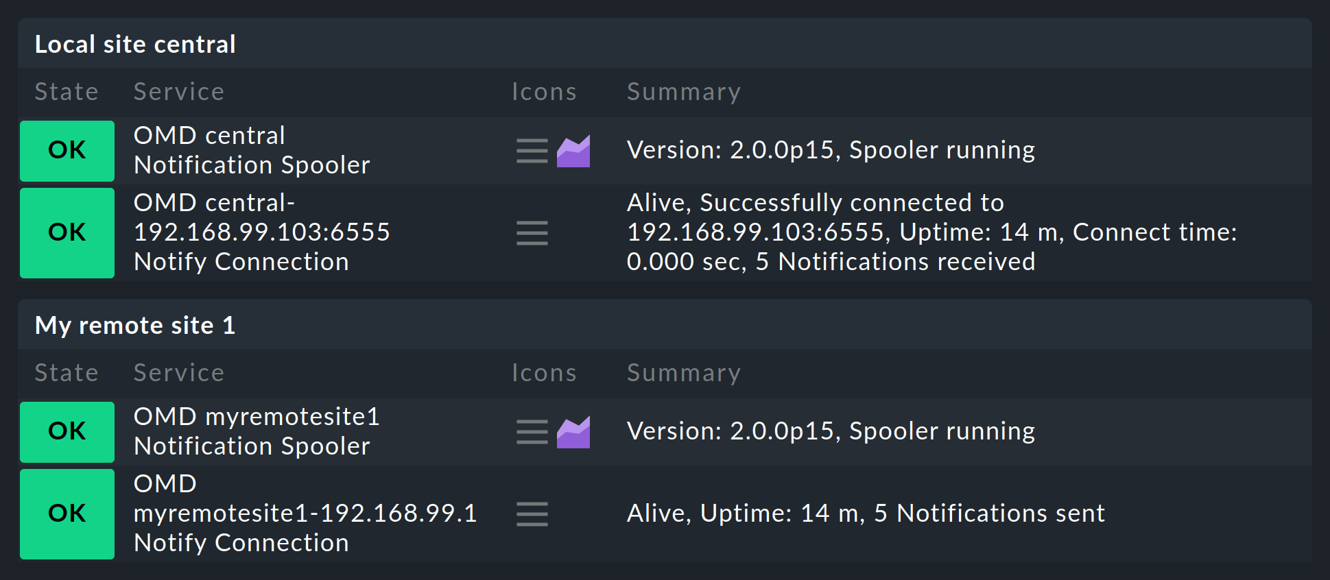

Monitoring the spooling
Once you have set up everything as described you will notice that on the central site, and respectively on the remotes, a new service will be found that must definitely be taken into the monitoring. This monitors the notification spooler and its TCP-connections. Every connection will thereby be monitored twice: once by the central, and once by the remote site:
distributed monitoring notification services
