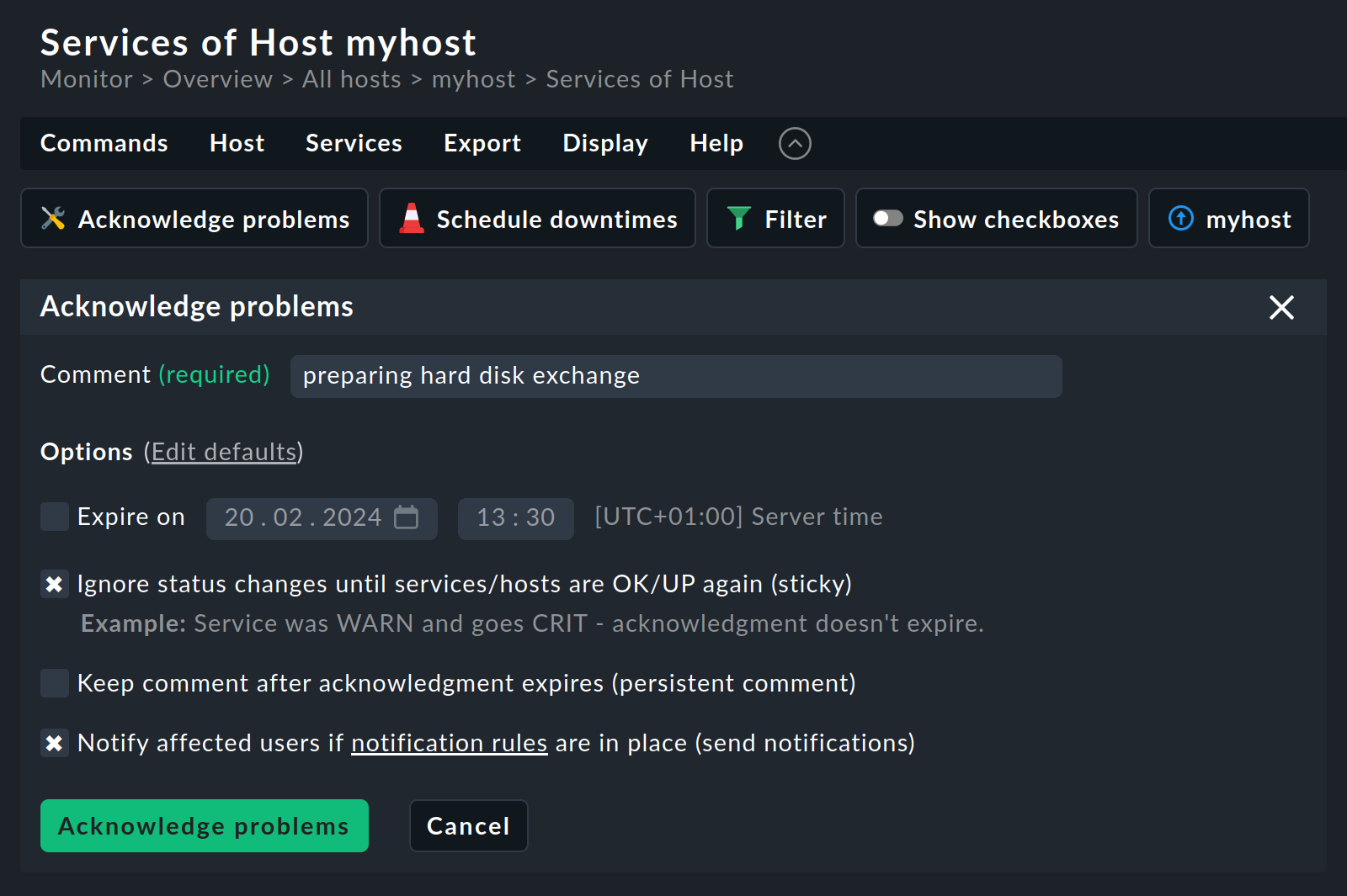

You can access the commands in a view via the Commands menu. When you select one of the commands, a field with the command’s parameters is displayed below the menu bar or action bar. If you select Acknowledge problems it will look like this:
The parameters for executing a command.

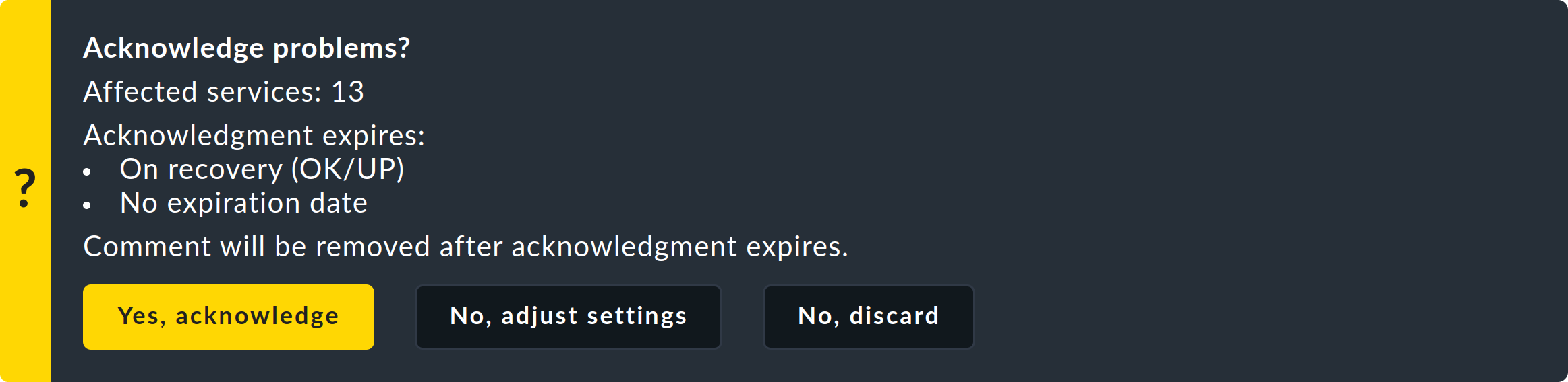

Some commands need further information, such as an acknowledgment. Pressing the Acknowledge problems button opens a confirmation dialog:
Confirmation dialog before executing the command.
If you confirm the request, the chosen command will be carried out on all objects shown in the current view. If you first wish to make a selection in the view, you have three options:

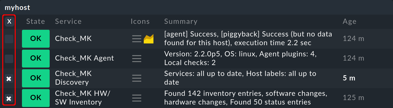

Activated checkboxes open an extra column on the view’s left side where objects can be selected which the command will act on:
Service list with activated checkboxes in the first column.
A click on the small cross at the top of the column will switch all of a table’s checkboxes on or off.

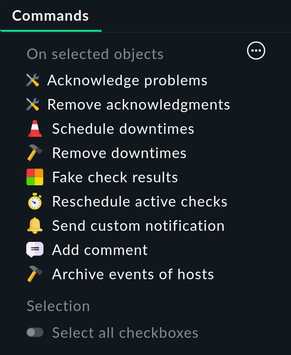

The available commands can be found in the Commands menu:
The 'Commands' menu in Show more mode.
Reminder: Available means that the commands can be different depending on the view and permissions. Also note that you can show less or more in this menu.
