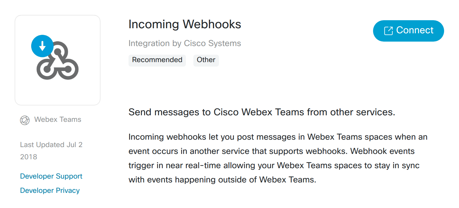

In Webex Teams the Incoming Webhooks app must now be activated or connected. You can find this app in the Webex App Hub.
notifications webex1
Click on Connect on this page. (If you are not logged into Webex Teams with the browser you are using, the Cisco Webex login dialog will appear first.)

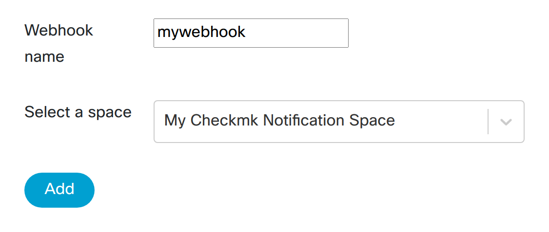

After a short waiting period, at first it looks as if not much has changed — but now, at the end of the input and selection fields, you can specify both a name for the webhook and the area to be used in Webex Teams. Finally click on Add.
notifications webex2

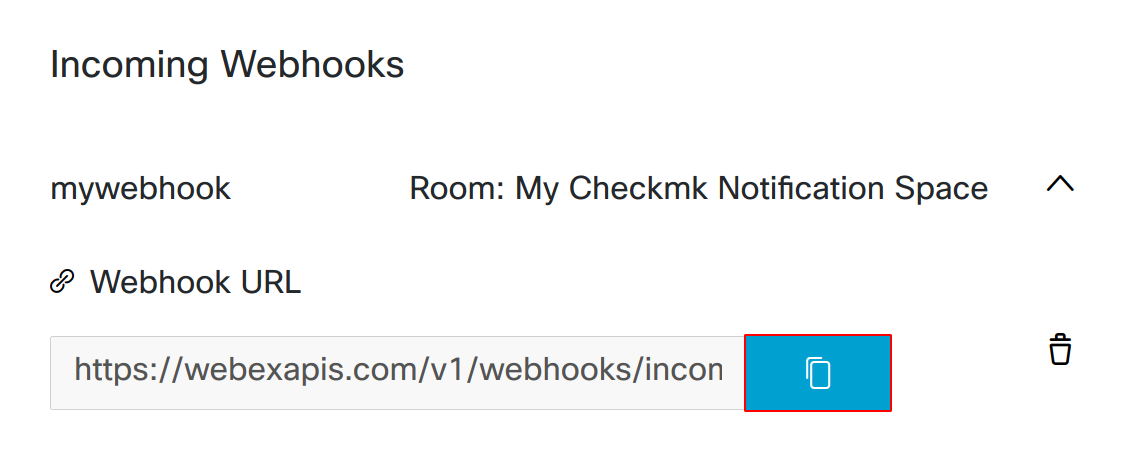

Next, copy the webhook URL created in this way by clicking on the corresponding icon:
notifications webex3

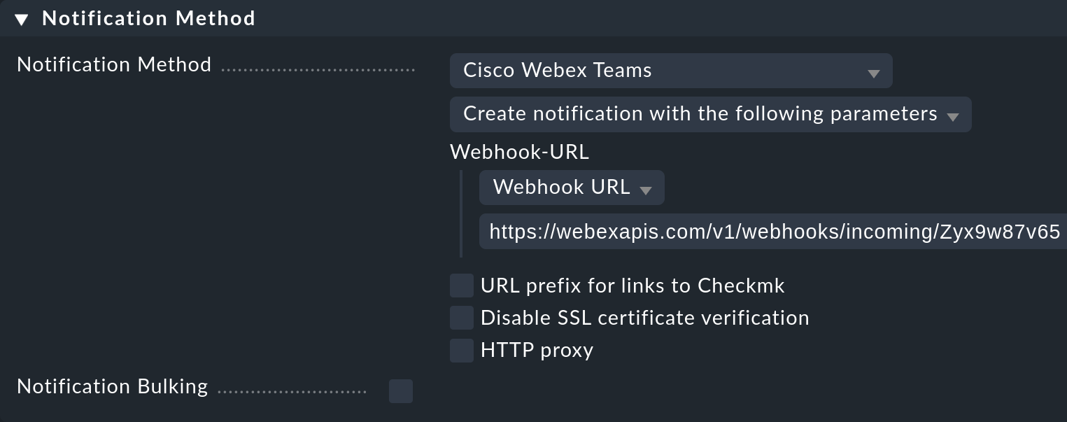

In Checkmk it is now sufficient to specify the webhook URL copied above:
  1. Create a new notification rule with Setup > Events > Notifications > Add rule.
  2. For the Notification Method choose Cisco Webex Teams.
  3. Enter the copied webhook URL:
    The notification method settings for Cisco Webex Teams.
