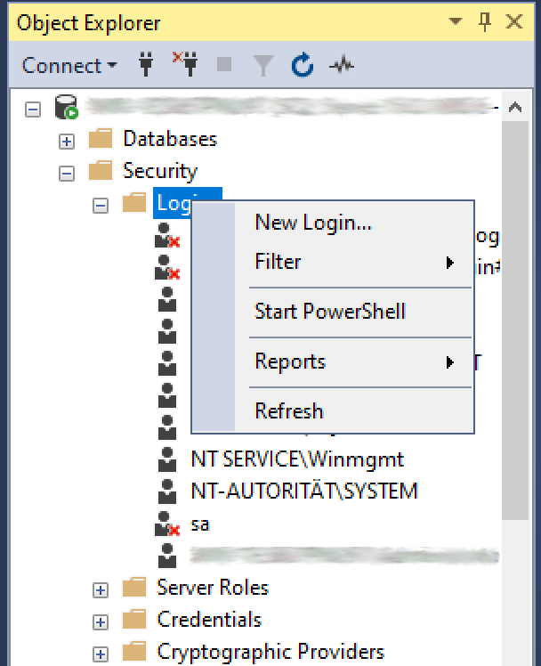

Now log in to MSSQL with a user with sufficient access authorizations in MSSQL, and create a new database user via the Microsoft SQL Server Management Studio:
Selecting the 'New Login...' option in MSSQL.

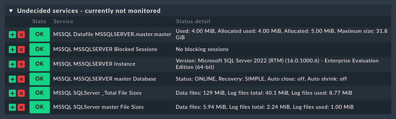

Now that you have installed and configured the plug-in, you can perform a service discovery for this host. The following screenshot shows only a selection of the services that can be found:
Excerpt from the service discovery results.

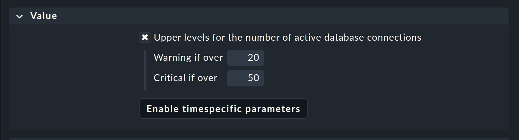

You can specify your own threshold values for the utilization of the maximum number of simultaneous connections specified by MSSQL, as these are much more dependent on the structure of your MSSQL instance than with other services. You can set up the appropriate threshold values in no time at all using a rule from the MSSQL Connections rule set.
Setting the upper thresholds for active connections.

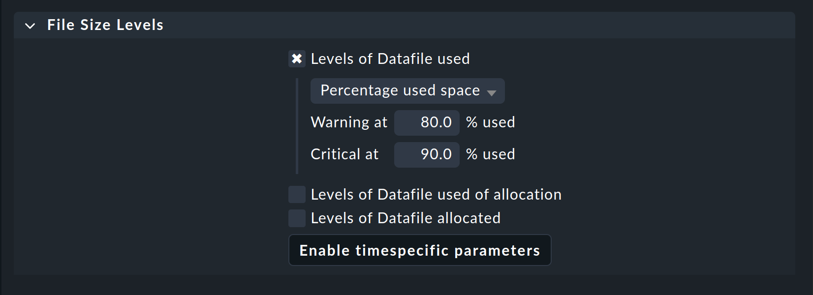

You can also define threshold values for the size of individual files in MSSQL. To do this, use the MSSQL datafile sizes rule set.
Setting the file sizes used.

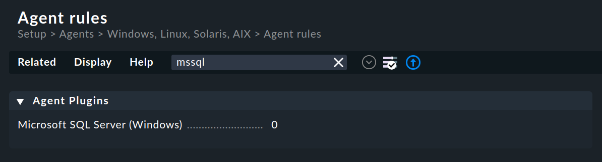

For the initial setup, it is sufficient to setup the database user on the MSSQL host and create a corresponding rule in the Agent Bakery. You can find the rule set under Setup > Agents > Windows, Linux, Solaris, AIX > Agent rules. You can then search for mssql in the search field:
The rule 'Microsoft SQL Server' in the agent rules.

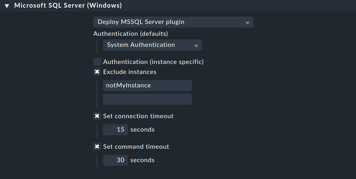

In the new rule in the Microsoft SQL Server (Windows) section, ideally select the System Authentication option for a simple and problem-free connection.
Possible settings for the MSSQL Server in the Agent Bakery.
If you instead opt for the Database User Credentials option, you must also enter the User ID and Password for the desired database user (for example, the user that you created before).
