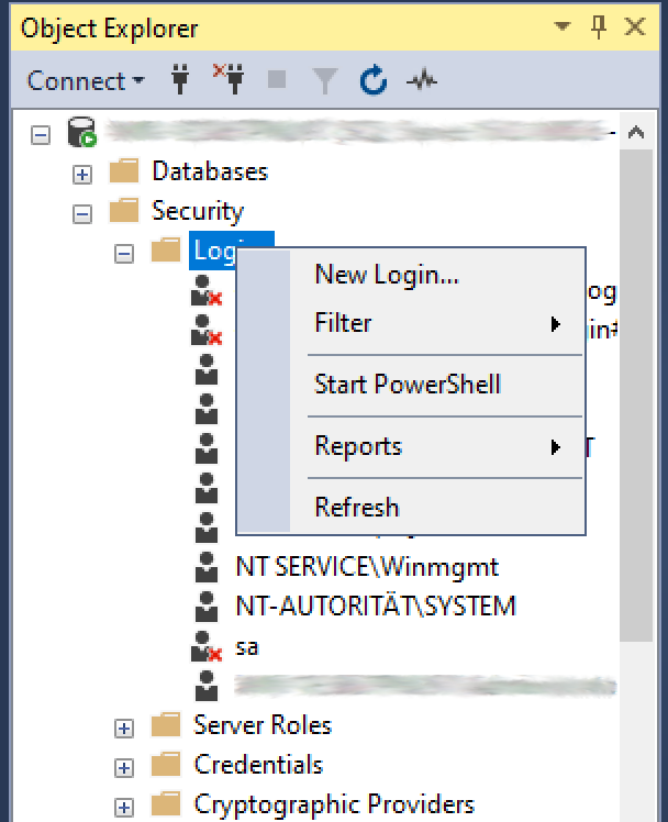

If there is no corresponding user on your MSSQL server or in your instance, you can create one on your Windows system via the Microsoft SQL Server Management Studio (with any user name):
“Selecting the ‘New Login...’ option in MSSQL.”

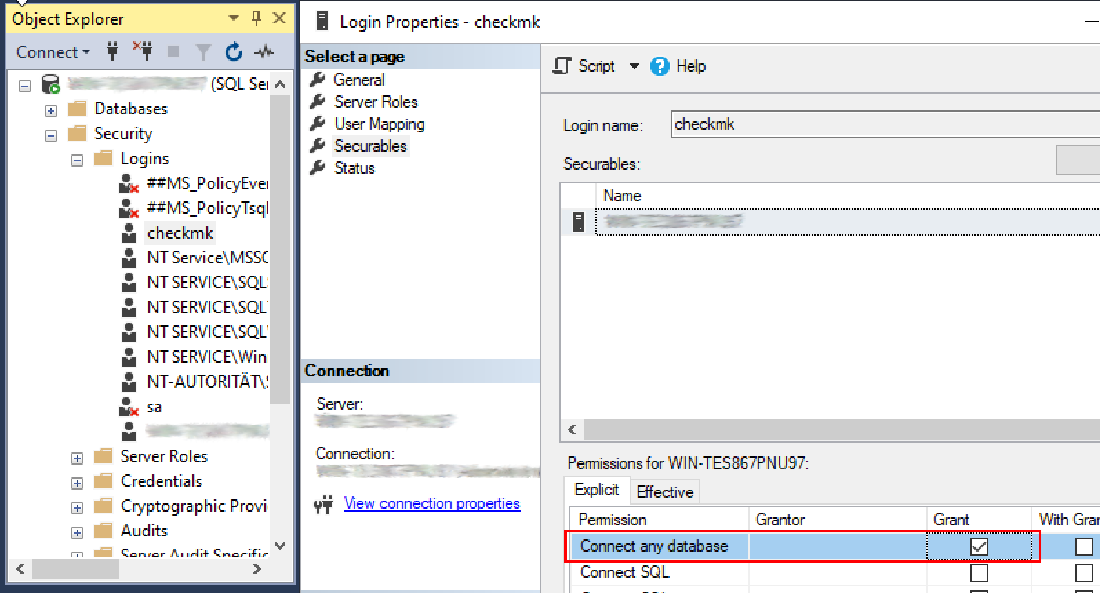

This login requires the following permissions:
  • Connect SQL
  • Connect any database
  • View server state
Grant these permissions in the Object Explorer via Security > Logins. Open the properties of the account (login) and click on Securables. Under Explicit you will find the three entries mentioned above. Set the corresponding check marks in the Grant column and confirm with OK.
“Grant ‘Connect any database’ permission.”

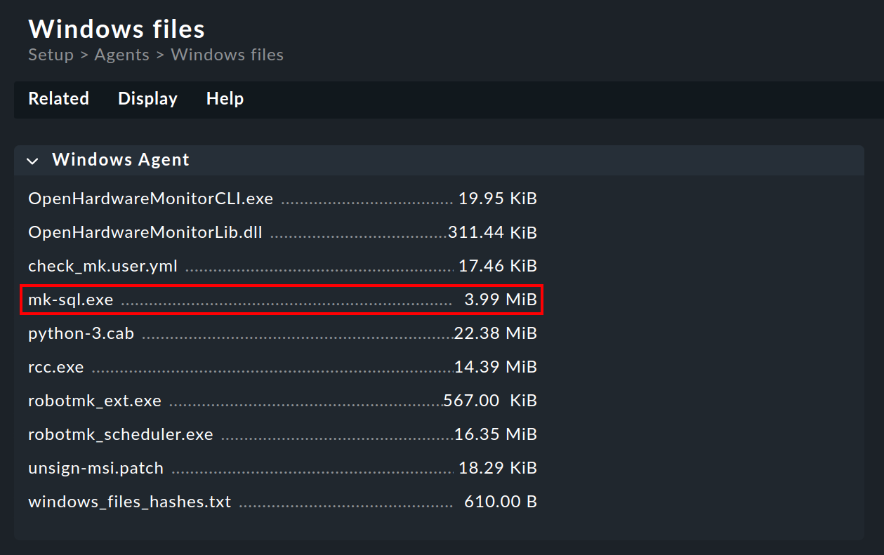

The mk-sql.exe plug-in can be found in Checkmk Community under Setup > Agents > Windows and in the commercial editions under Setup > Agents > Windows, Linux, Solaris, AIX > Related > Windows files:
Selection of the agent plug-in in Checkmk.
Download the mk-sql.exe file and save it on the Windows host in the directory C:\ProgramData\checkmk\agent\plugins\.

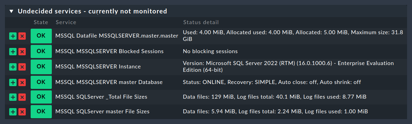

Now that you have installed and configured the agent plug-in, you can perform a service discovery for this host. The following screenshot shows only a selection of the services that can be found:
“Excerpt of the service discovery.”

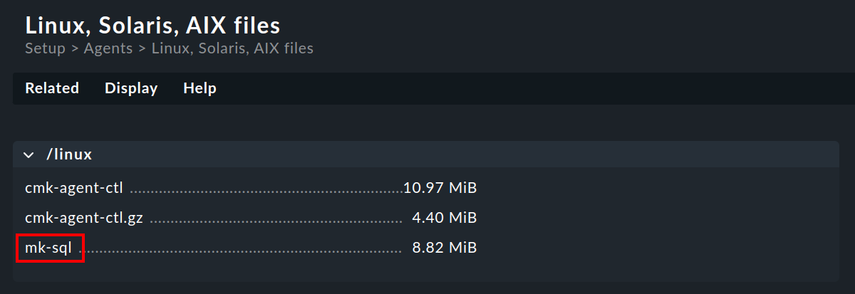

The mk-sql plug-in can be found in Checkmk Community under Setup > Agents > Linux and in the commercial editions under Setup > Agents > Windows, Linux, Solaris, AIX > Related > Linux, Solaris, AIX files:
Download the mk-sql file and place it on the Linux host in the /usr/lib/check_mk_agent/plugins/ directory.

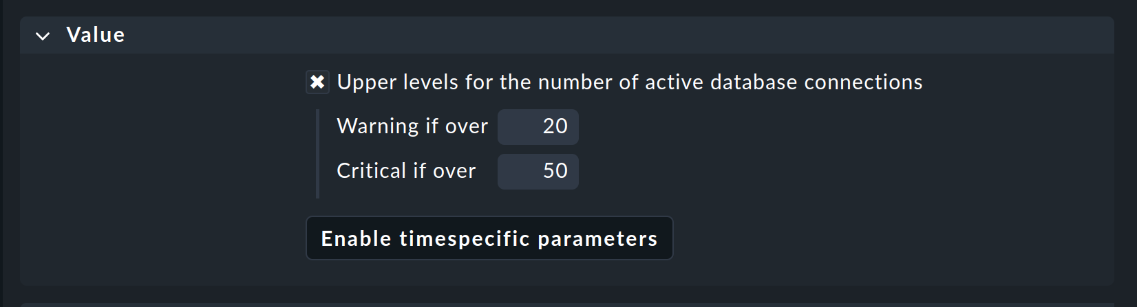

You can specify your own threshold values for the utilization of the maximum number of simultaneous connections specified by MSSQL, as these are much more dependent on the structure of your MSSQL instance than with other services. You can set up the corresponding threshold values in no time at all using a rule from the MSSQL Connections rule set.
“Setting the upper threshold values for active connections.”

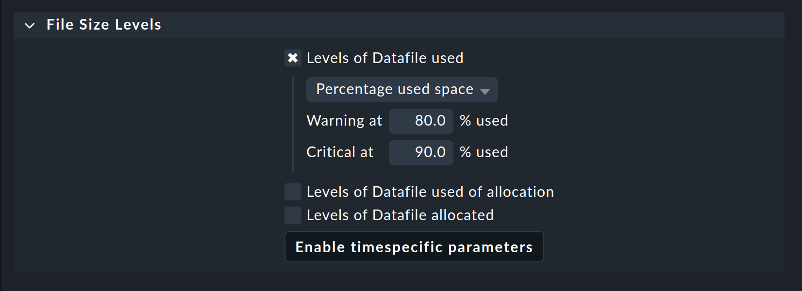

Monitoring file sizes
You can also define threshold values for the sizes of individual files in MSSQL. To do this, use the MSSQL datafile sizes rule set.
“Setting the sizes of files in use.”

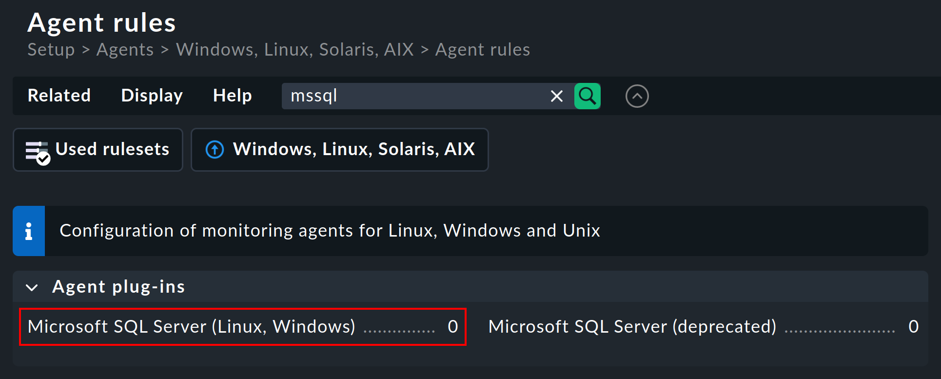

5. Configuration via the Agent Bakery
CEE The setup has been very simplified in the commercial editions using the Agent Bakery, as syntax errors in the configuration files are avoided and customizations to suit changing environments can be made easily. The main difference to a manual installation is that you only have to work on the MSSQL host via the command line if you want to make special MSSQL-specific configurations.

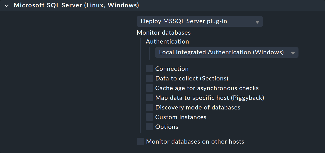

For the initial setup it is sufficient to create a corresponding rule in the Agent Bakery. You can find the rule set under Setup > Agents > Windows, Linux, Solaris, AIX > Agent rules. There search for mssql in the search field:
The rule ‘Microsoft SQL Server (Linux, Windows)’ in the agent rules.
5.1. Setting up the agent rule (Windows)
Depending on how the agent plug-in is allowed to log in to your MSSQL server (see Setting up an account for monitoring), select the appropriate option under Authentication. If you are using the LocalSystem account (NT AUTHORITY\SYSTEM), leave the selection at Local Integrated Authentication (Windows).
“Possible settings for the MSSQL server in the Agent Bakery.”

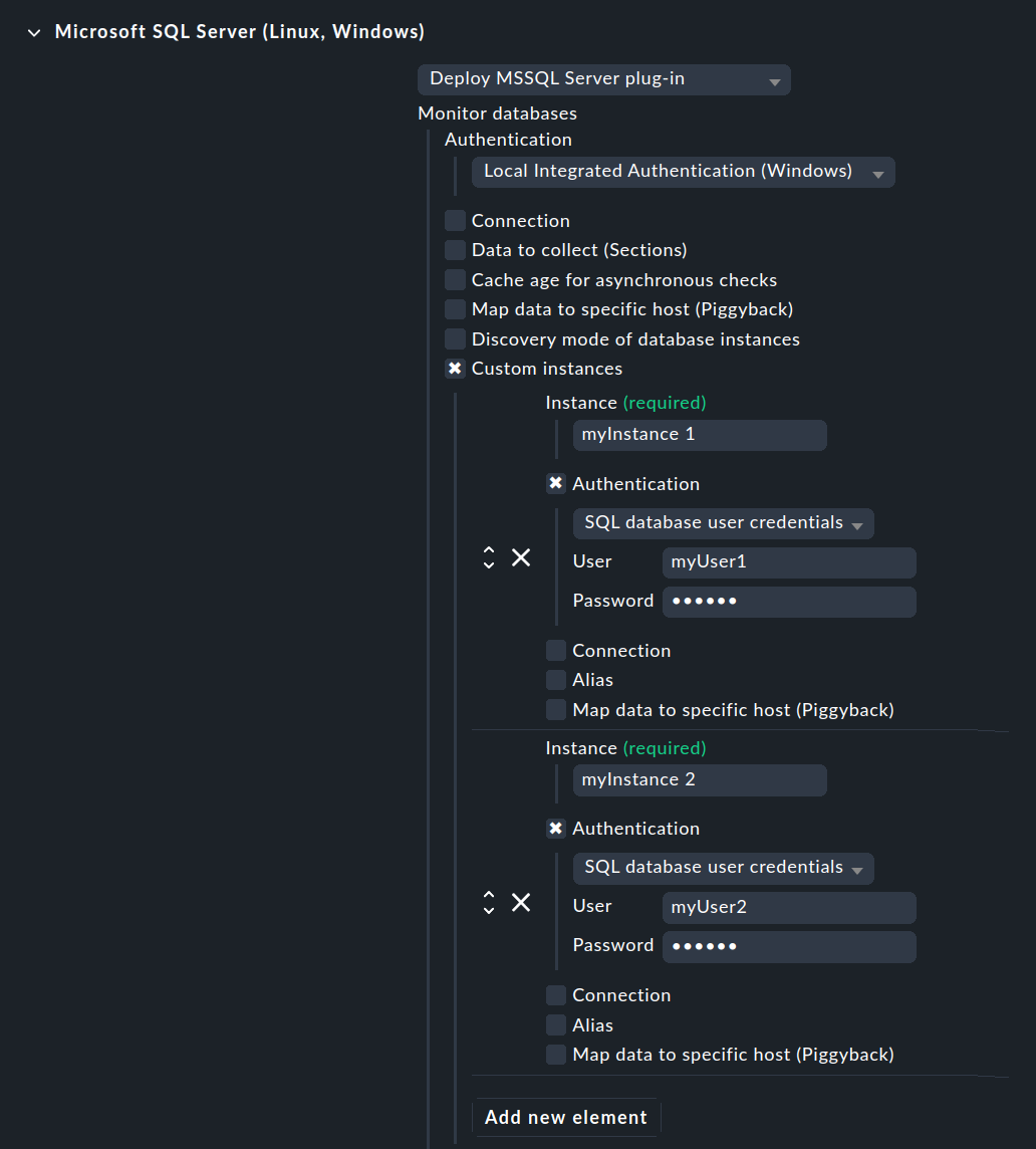

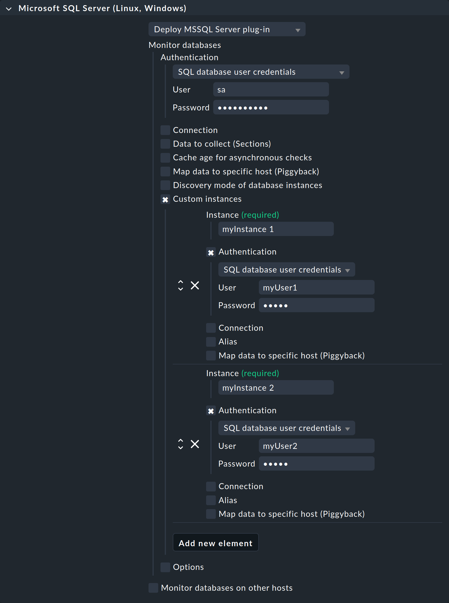

If you are running multiple MSSQL instances with different user names and passwords on the host, select the Custom instances option. Use Add new element to access the details for the first — and then each additional — instance to be monitored. Enter the access data for each instance here, as described above.
“Multiple MSSQL instances in the Agent Bakery rule.”

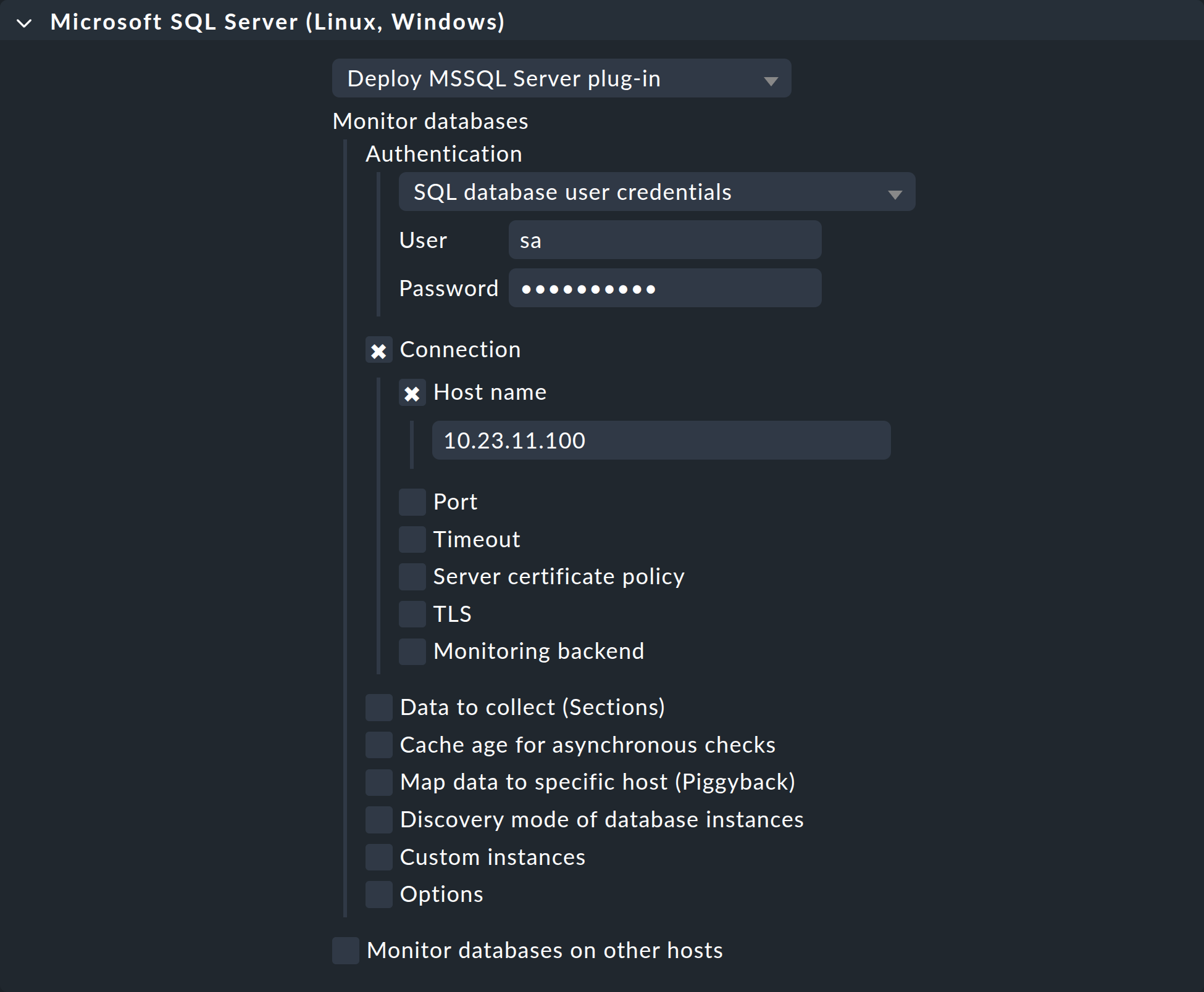

With the settings you have just made, you first create a simple agent for monitoring your MSSQL instance, which is located directly on the host. All available data is evaluated directly in Checkmk and this should be sufficient for a typical case scenario. However, if your organization has a more complex MSSQL environment, there are further options, both for monitoring the database on the same host and for monitoring it on a remote host. These options are basically the same for both connection types.
Option Description
Connection
If you need more specific connection data for the general connection to the MSSQL server, you can specify this here.
