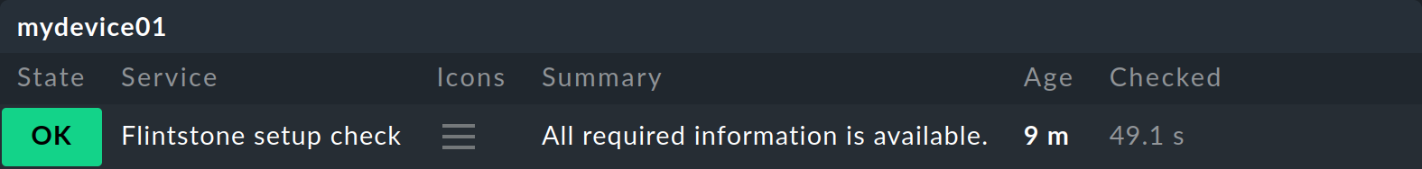

Extend the prepared example file so that the plug-in is only executed for a small number of devices, here the Flintstones, Inc. Fred Router models. The OIDs for contact, device name and location are then retrieved for these devices. These three OIDs are provided by each device. If you want to test the example with real SNMP-capable devices, it is therefore sufficient to customize the model name to be recognized.
~/local/lib/python3/cmk_addons/plugins/flintstone/agent_based/flintstone_setup_check.py
snmp_section_flintstone_setup_check = SimpleSNMPSection(
    name = "flintstone_base_config",
    parse_function = parse_flintstone,
    detect = startswith(
        ".1.3.6.1.2.1.1.1.0",
        "Flintstones, Inc. Fred Router",
    fetch = SNMPTree(
        base = '.1.3.6.1.2.1.1',
        oids = ['4.0', '5.0', '6.0'],
The example also contains the name parameter with which the generated SNMP section is identified and a parse function, which we will discuss later.

But now back to the example in which the OID leaves for contact, device name and location are queried: The following parse function simply copies each element of the inner list into a key-value pair in the returned dictionary:

After restarting the monitoring core …
OMD[mysite]:~$ cmk -R
Generating configuration for core (type nagios)...
Precompiling host checks...OK
Validating Nagios configuration...OK
Restarting monitoring core...OK
… the new service will then be visible in the monitoring:
The new service created by the check plug-in in the monitoring.
Since all fields of the three SNMP leaves are filled, the service is OK
