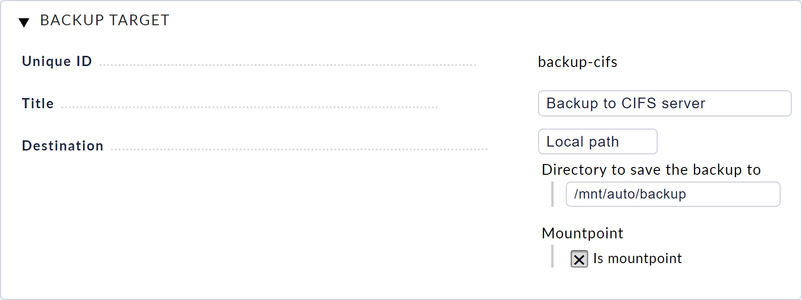

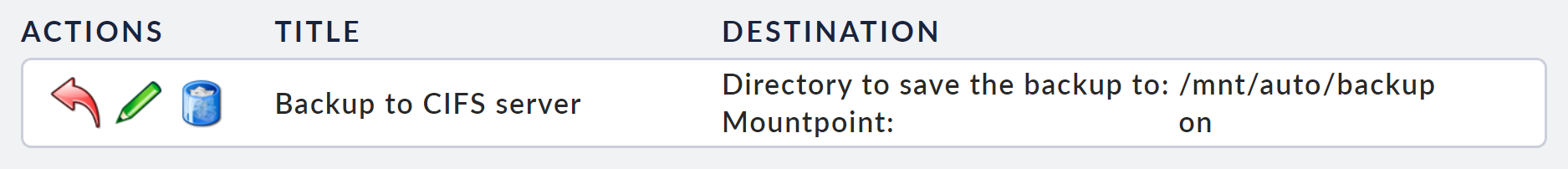

Now select Device backup from the main menu of the web interface and open the backup targets from there via Backup targets. Create a new target via New backup target. You can freely choose the ID and the title. Under Directory to save the backup to configure the file path for the mounted network share, here /mnt/auto/backup. The option Is mountpoint should be active when you back up to a network share. This allows the backup to check whether the network share is actually mounted before saving.
Setting the backup target.

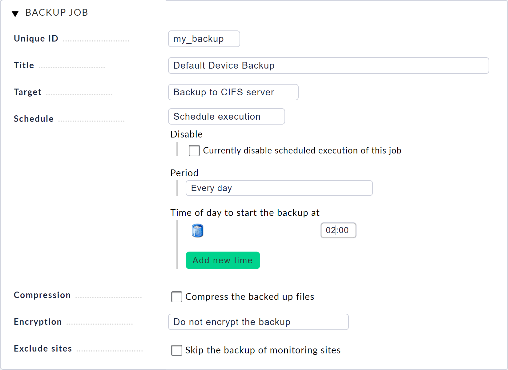

Once you have created the backup target, return to the Device backup page and select New job. Here you can again enter an ID and a title. Then select the backup target you have just created and specify the desired execution interval.

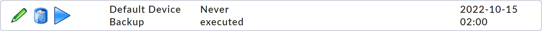

After saving, you will see an entry for your new backup job on the Device backup page. The time of the job’s next execution is shown at the end of the line. When the job is running or has been completed, its status will be displayed in this view. Here you can also start a job manually or cancel running backups.
Display of the time for the next backup execution.

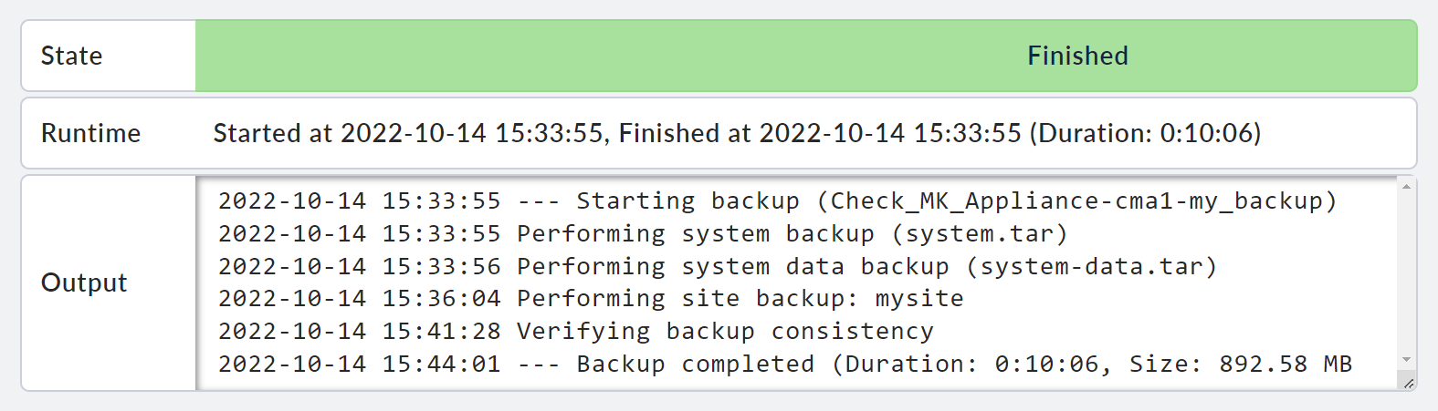

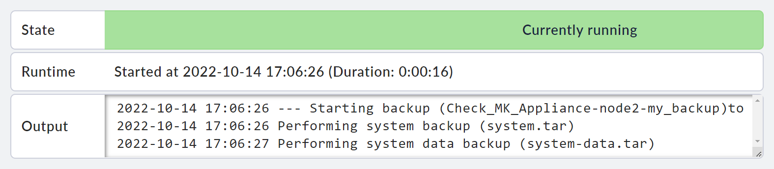

Start the job you have just set up by clicking on the play icon. You will now see in the table that the job is currently being executed. Click on the log icon to display the progress of the job in the form of log output.
Once the backup has been completed, this will also be displayed in the table.

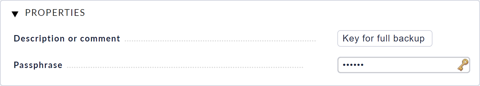

If you want to encrypt the backup of your data, you can configure this directly from the web interface. Your backed up files are completely encrypted before they are transferred to the backup target. The encryption is done using a previously-created backup key. This key is protected by a password, which you must specify when creating the key and keep in a safe place together with the key, as this is the only way to restore an encrypted backup.
To do this, open the Device backup page and select the Backup keys option. From here, create a new backup key. When specifying the password, make sure it is sufficiently complex.
cma de backup key new 2
Once you have created the key, download it and keep it in a safe place.

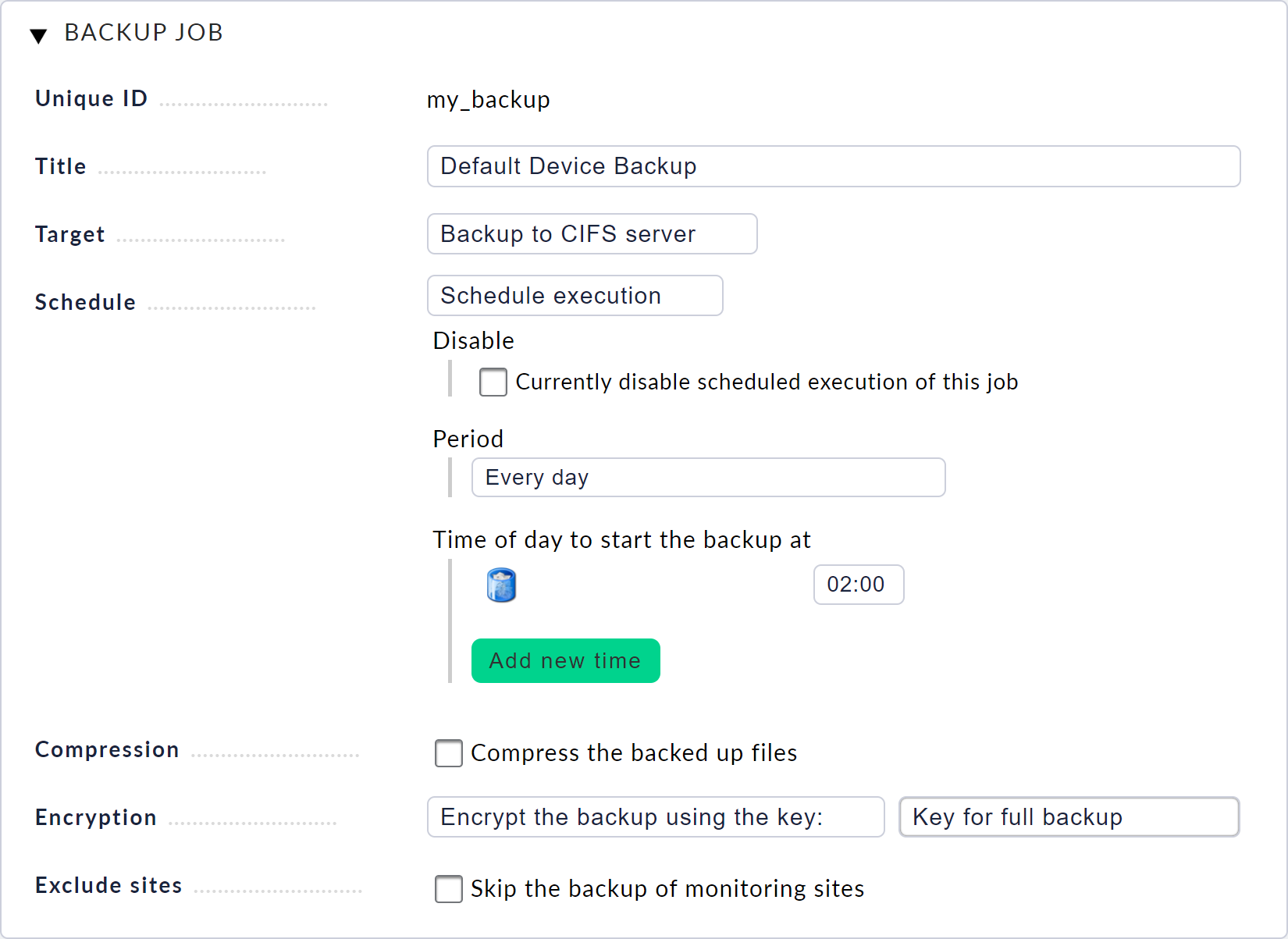

From the Device backup page, edit the backup job that is to create encrypted backups, activate the Encryption item there and select the backup key you have just created.
cma de backup job edit encrypt 2
After you have confirmed the dialog, the next backup will automatically be encrypted.

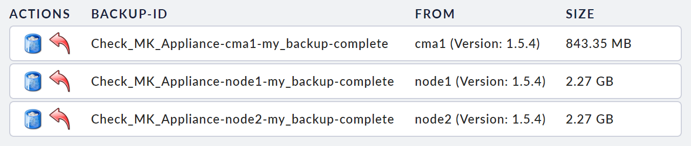

Select the backup directory, you will see a list of all of the backups available there.
cma de backup restore backuplist
To start a restore, click on the arrow icon next to the backup you want to retrieve. After a confirmation dialog, the restore will start and you will be returned to the Restore starting page. You can check the current status of the restore by refreshing this page.

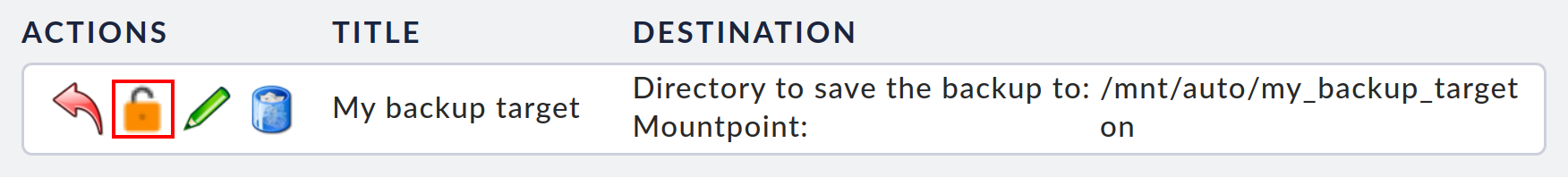

In exceptional situations, it may be necessary to only decrypt an encrypted backup and not restore it completely. You may only want to extract individual files from a backup or examine the backup. As of version 1.7.3 of the appliance, there is an additional button in the restore menu (Device backup > Restore).
cma en backup decrypt backup
As soon as you click on this button, you will see an overview of all encrypted backups that are located in this backup target. Now click on the lock icon in the line of the desired backup, then enter the passphrase of the backup key used and click on Start decryption.
Once the process is complete, you will find the decrypted backup in the list of all backups of the respective backup destination. (Device backup > Restore) It has the same name as the source backup, supplemented by the suffix _decrypted.
