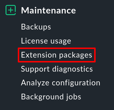

2. Managing extension packages via the Setup Menu
CEE The facility to manage MKPs via the GUI exists exclusively in the commercial editions of Checkmk. In the Setup menu you enter the administration of MKPs via Setup > Maintenance > Extension packages. Here you can install, modify or create MKPs:
mkp manager sidebar

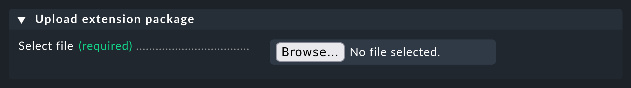

An MKP that you have downloaded from the Exchange, for example, can be uploaded to Checkmk by clicking the Upload package button and will then be made available for installation. To do this, the file must be present on the machine that is also running your web browser. The file name of the package must include the .mkp extension.
mkp manager upload

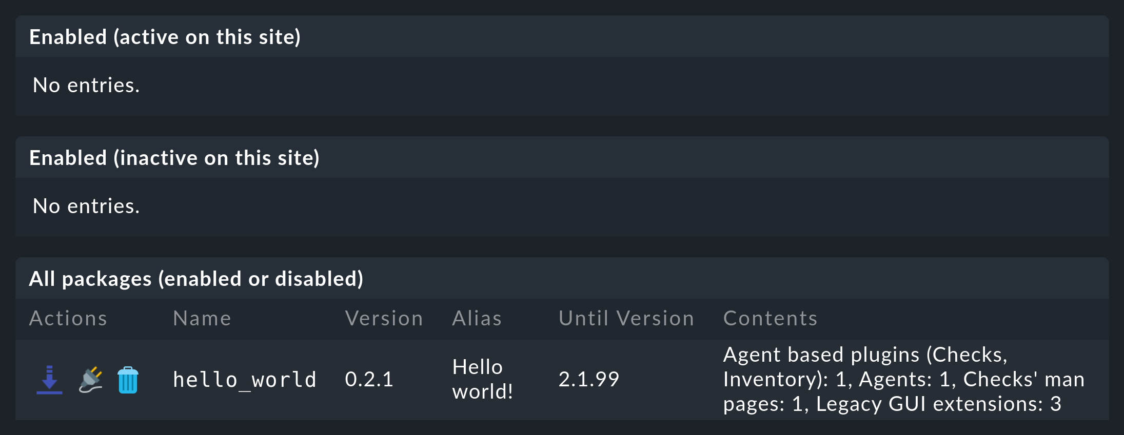

Following an installation, the extension package will initially be available. It is located under All packages (enabled or disabled):
mkp manager present not active

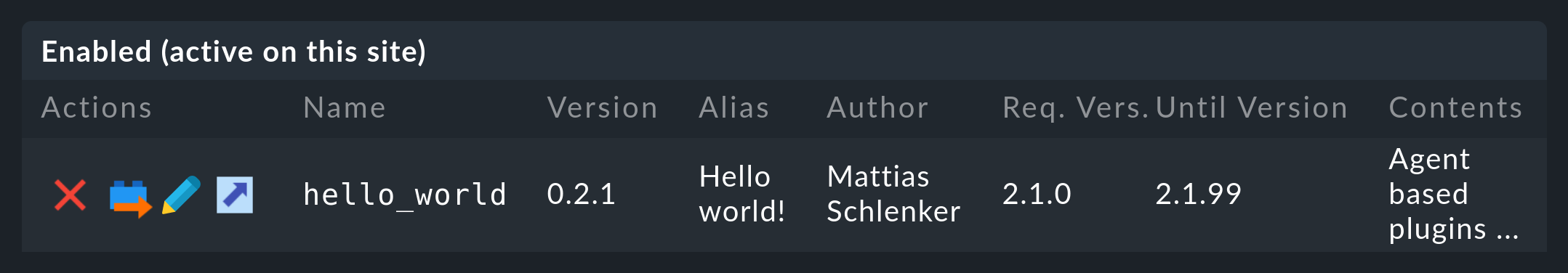

Only with a click on the plug icon icon install will an available package also be activated. During activation, the files are installed in a folder hierarchy under ~/local/. The package description file is also placed in ~/var/check_mk/packages/. After activation, the package will also appear in the list of enabled and active MKPs — Enabled (active on this site):
mkp manager list active
Now perform an activation of changes, after which all functions from the package will be anchored in the system and ready for use.

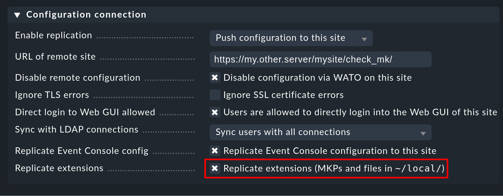

2.4. MKPs in distributed environments
In the case of a distributed setup, it is sufficient to make the packages available on the central site. For each remote site associated with the central site, you can then separately determine whether the customizations should be propagated to that remote site. All you have to do is activate the Replicate extensions option. After that, the MKPs and all other changes within the ~/local directory will also be transferred during a synchronization.
mkp distr wato
If a particular transfer is not desired, simply turn off the option for this or all sites.
Important: The customizations for the distributed setup will only be transferred if the Enable replication option is set to Push configuration to this site.

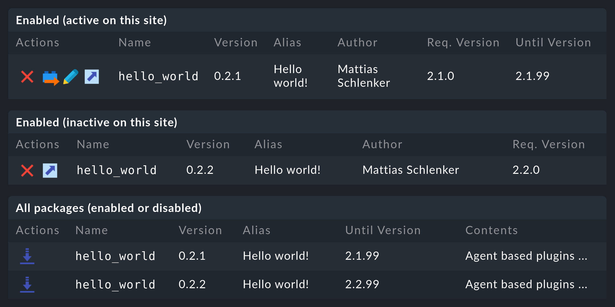

2.5. A special case: enabled but inactive packages
A special situation is the attempted activation of a package that does not match the Checkmk version used. Such a package that is enabled, but whose activation fails because of an incompatible Checkmk version, will end up in the Enabled (inactive on this site) list.
mkp manager all states
But why install packages that do not match the Checkmk version you are using? There are two good possible reasons:
  1. An update of the Checkmk version: You have the possibility of storing packages for both the old and the new versions — when you next perform an update, the newer package will be activated automatically.
  2. Distributed Monitoring: To facilitate updates, the Checkmk major version of remote sites may be one higher than that of the central site. However, this previously made it difficult to distribute MKPs because these had to be compatible with both major versions. With the ability to unlock mismatched packages, you can keep packages on the central site that match both the source and target versions. The newer version will then be automatically activated during an update.
From the version numbers shown in the above screenshot, you can see that it is a Checkmk 2.1.0 central site that provides packages for remote sites that have already been upgraded to 2.2.0.

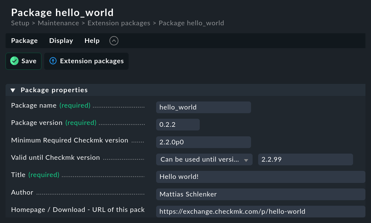

4.1. Editing packages
The correction of minor errors often makes it necessary to adapt an existing package without changing its structure or name. In this case, it is advisable not only to adapt the existing files stored in the file system, but also to at least update the package’s version number. If changes to Checkmk’s APIs require modifications to a package, also adjust the version numbers stored in the package for the minimum and maximum supported versions. In addition, when using the Agent Bakery, the presence of new MKPs triggers the rebuilding of the agent packages.
In the commercial editions use the icon edit icon to get to the modifications dialog.
mkp edit description
Users of CRE Checkmk Community instead take the following two steps via resolve and recreate.

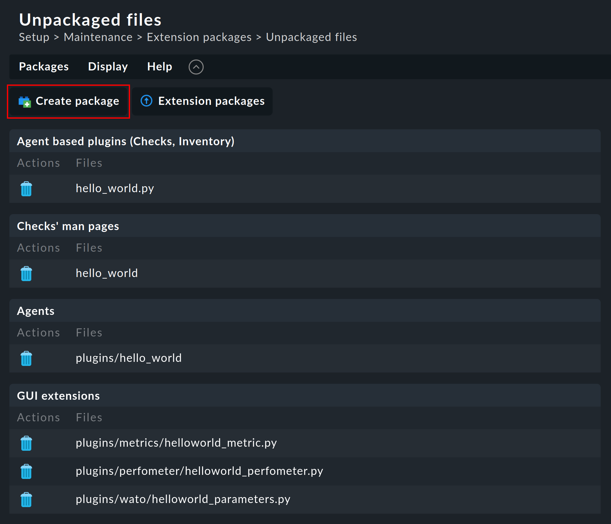

4.3. Finding unpackaged files
The Setup menu
Once the programming or customization work has been completed, it will be necessary to find the existing and added files again. Since these files do not currently belong to any package, they are listed in the Setup under Unpackaged files:
mkps unpackaged
List of Unpackaged files and the Create package button

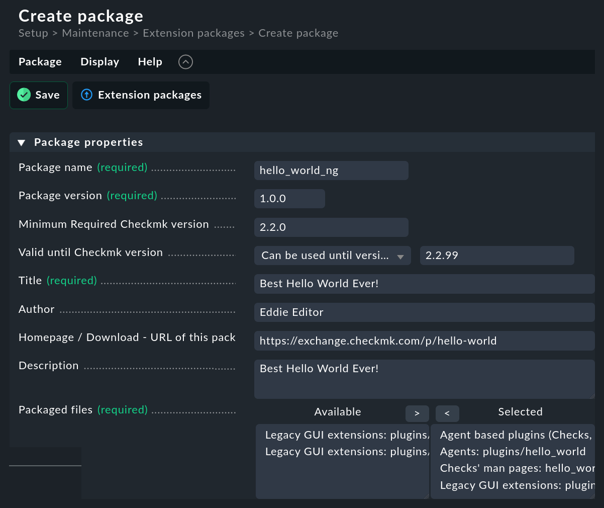

The icon new mkp Create package button in the unpackaged files overview takes you to the dialog for creating a new package:
mkps create
In addition to the obvious details, it is important that you select at least one file to be packaged. Creating a package also creates a package description under ~/var/check_mk/packages/, which contains general information as well as the list of the included files. The maximum supported Checkmk version is of course difficult to predict without a crystal ball.
Extensions that use the new APIs introduced in Checkmk 2.3.0 are future-proof and will also work up to Checkmk 2.5.0 without any adjustments. You can enter 2.5.99 for Valid until Checkmk version as the maximum supported Checkmk version in this case. No statement can be made for the future after that at the time of revision of this article. Packages that use the APIs introduced in Checkmk 2.0.0 will no longer work with Checkmk 2.4.0. Enter 2.3.99 here as the maximum supported version.
You can now download this newly created package as an MKP file via the package list with the icon download icon — to transfer it to another system or to upload it to the Exchange, for example.
