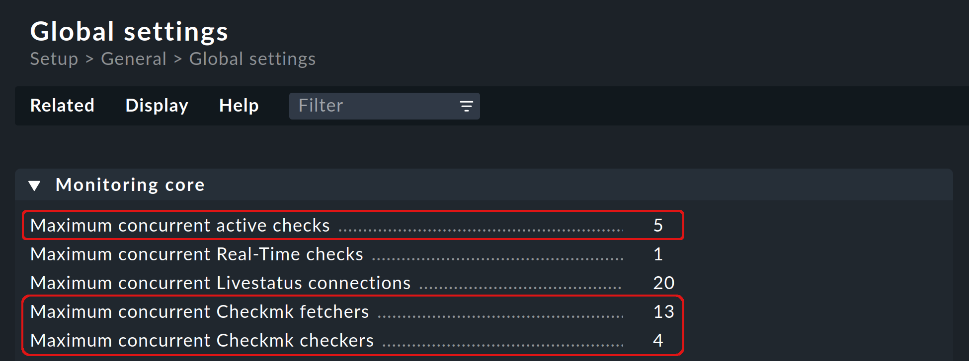

3.3. Setting the number of auxiliary processes correctly
By default, 5 check helpers, 13 Checkmk fetchers and 4 Checkmk checkers are started. These values are set under Global settings > Monitoring Core and can be customized by you:
List of global settings for the CMC's auxiliary processes.

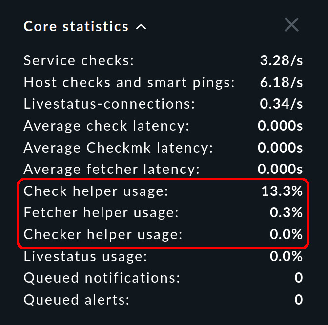

In the sidebar, the Core statistics snap-in shows you the percentage utilization averaged over the last 10-20 seconds:
Core statistics snap-in.
For all auxiliary process types, there should always be enough processes to run the configured checks. If a pool is being 100 % utilized, the checks will not be executed in time, the latency will grow and the states of the services will not be up to date.
The usage should not exceed 80 % a few minutes after starting a site. For higher percentages, you should increase the number of processes. Since the necessary number of Checkmk fetchers grows with the number of monitored hosts and services, a correction is most likely here. However, be careful to create only as many auxiliary processes as are really needed, as each process occupies resources. In addition, all auxiliary processes are initialized in parallel when the CMC is started, which can lead to load peaks.
The Core statistics snap-in shows you not only the usage, but also the latency. For these values, the simple rule applies: the lower, the better — and 0 seconds is therefore best.
You can also display the values shown in the snap-in for your site in the details of the OMD <site_name> performance service.
