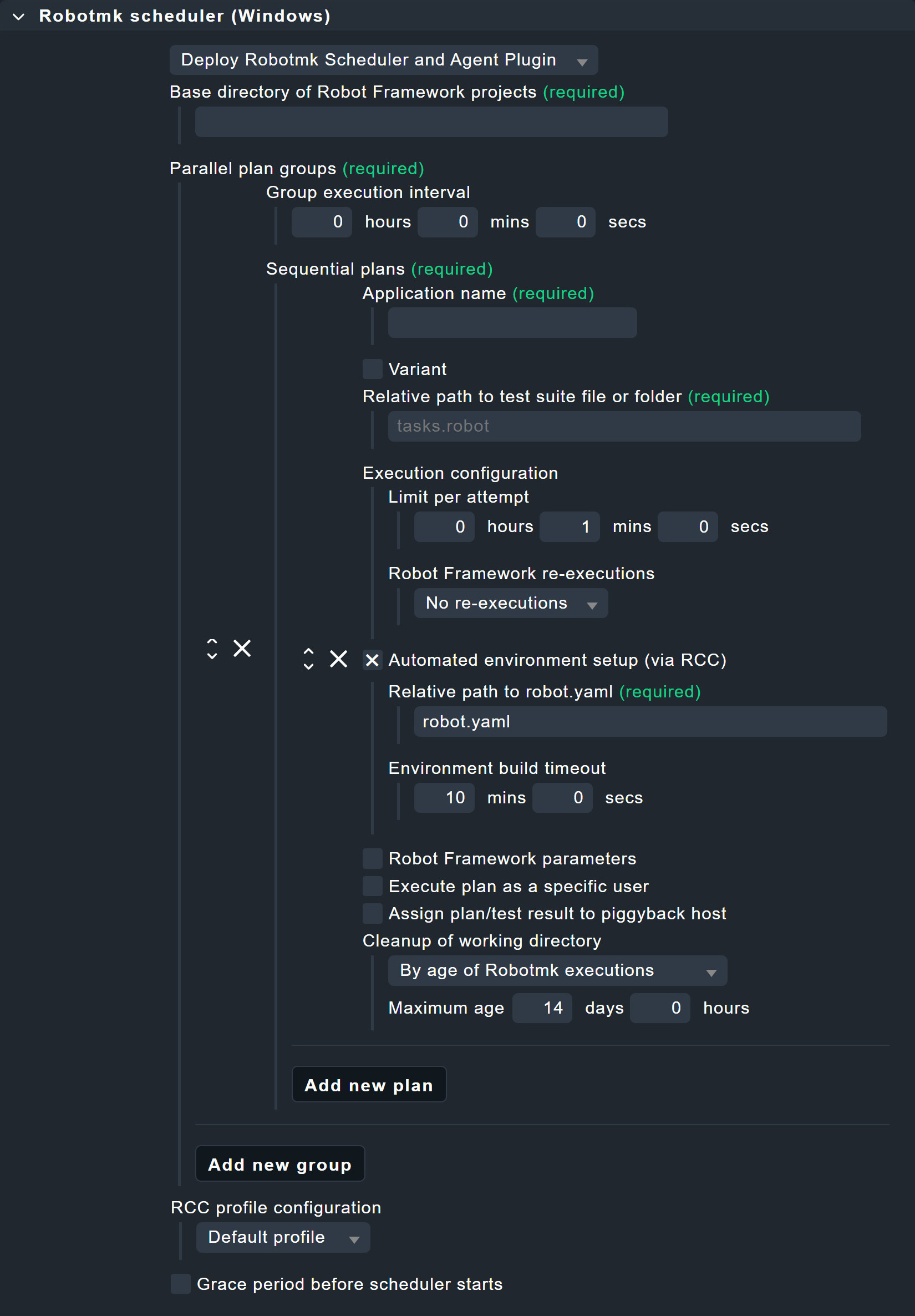

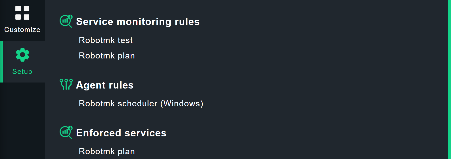

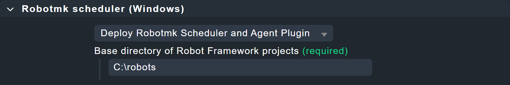

2.1. Configure a rule for the agent plug-in
You can find the Robotmk scheduler under Setup > Agent rules > Robotmk scheduler (Windows). As the rule is quite extensive, here is a look at the empty configuration:
Empty Robotmk scheduler rule.
Configuration of the agent plug-in
First, the scheduler requires the base directory in which all your test suites are located. Enter this arbitrary, explicit file path under Base directory of suites, for example C:\robots.
Path for test suites.
Base directory for all Robot Framework projects

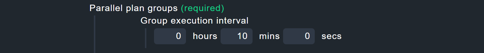

The Parallel plan groups that are shown now are a Checkmk-specific concept.
To explain this, we must first go down one hierarchy level: Here you can see the item Sequential plans. Such a sequential plan defines which suites are to be executed with which parameters. Robot Framework will process these suites one after the other. The reason for this is simple: in practice, tests are sometimes run on the desktop and several test suites could get in each other’s way at the same time (think of them stealing each others control of the mouse cursor).
The plan groups are now an encapsulation for sequentially executed plans — and are themselves executed in parallel. Again, the reasoning is simple: this allows test suites that do not rely on the desktop to be executed in their own plans without delay — the test suite used in this article is a good example of such processing.
Back to the dialog: The only explicit setting is the execution interval, which you set under Group execution interval.
Execution interval for execution groups.
Interval for the (parallel) execution of plan groups
Important
The plans in the plan group naturally have their own runtimes, determined by the timeout of a single execution and the maximum number of repeated executions in the event of failed tests. The execution interval of the plan group must therefore be greater than the sum of the maximum runtimes of all plans in the group. The maximum runtime of a plan is calculated as follows: Limit per attempt × (1 + Maximum number of re-executions).

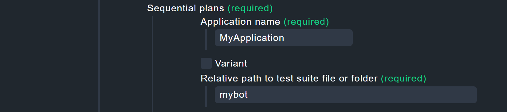

Now it’s time to configure the first plan. You can enter any name under Application name. This name does not have to be unique! The name of the application to be monitored makes sense here, for example OnlineShop, or here in this example simply MyApplication. Of course, it can happen that this online store is tested several times, either by other test suites or by the same test suite with different parameters. In such cases, the Variant field is used to achieve unambiguous results despite identical names. For example, if the application OnlineShop is tested once in German and once in English (via corresponding parameters), you could use corresponding abbreviations here. The monitoring will then return results for My OnlineShop_en and My OnlineShop_de.
However, the specification under Relative path to test suite file or folder is necessary. The path is relative to the base directory specified above, e.g. mybot\test.robot for C:\robots\. Alternatively, a directory (with several robot files) can also be specified here, in which case it would simply be mybot.
Name and path of the suite.
Plan for the execution of suites

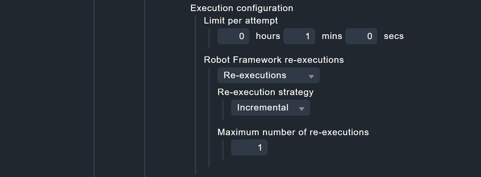

Continue with the Execution configuration. Under Limit per attempt you define the maximum elapsed time — per attempt — that a test suite may run. With Robot Framework re-executions you can now instruct Robot Framework to repeat test suites completely or incrementally if tests fail. If the individual tests in a test suite are independent of each other, the incremental strategy is the best way to save time. If, on the other hand, the test suite tests a logical sequence, such as "Login → Call up product page → Product in shopping cart → Checkout", the test suite must of course be completely reprocessed. In the end, there is always only one result.
In the case of complete retries, only the results from self-contained suites are taken into account for the final result: If a test fails on its final retry, the test suite is counted as a failure. In the case of incremental retries, the final result is made up of the best partial results: If some tests only run successfully on the third attempt, the final result is also counted as a success. Reminder: The combination of attempts and maximum run times of all plans in a plan group determines their minimum execution interval.
Configuration of execution runtimes and repetitions.
Failed tests/suites can be repeated

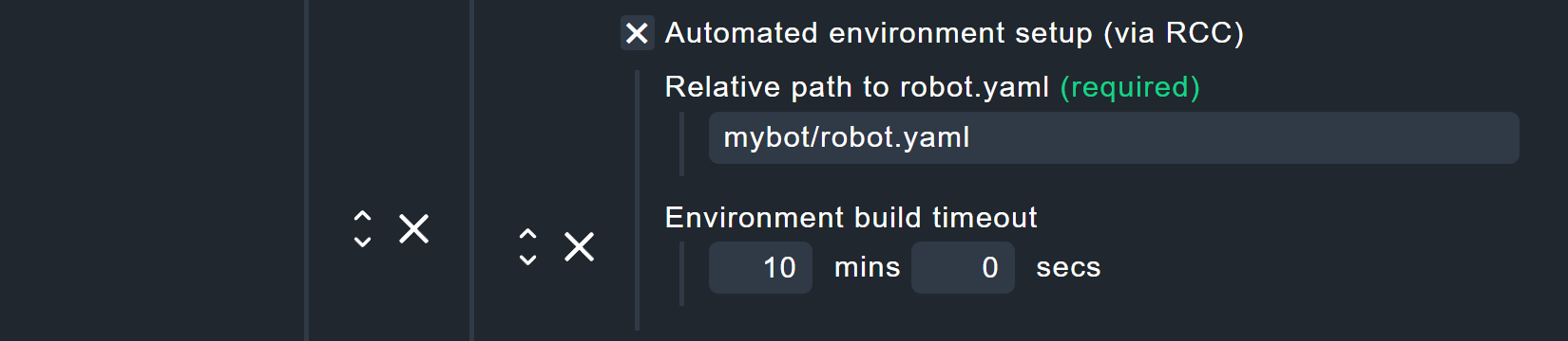

By default, execution via RCC is activated under Automated environment setup (via RCC), for which you must enter two values. Firstly, RCC requires the specification of where the robot.yaml file is located. Its primary purpose is to reference the conda.yaml file, which is responsible for setting up the Python environment, i.e. installing Python and dependencies. This specification is relative to the base directory that you have set above under Relative path to test suite file or folder. The YAML files can be saved in subdirectories, but best practice is the top suite directory. For the above base directory C:\robot\ and the suite directory C:\robot\mybot it is accordingly mybot\robot.yaml.
With the following time limit for building the Python environment, you should bear in mind that sometimes large volumes of data need to be downloaded and set up. Especially for the required browsers, several hundred megabytes are quickly accumulated — but only for the first run. RCC only rebuilds environments if the content of conda.yaml has changed.
RCC configuration of the suite.
Time limit for building virtual environments

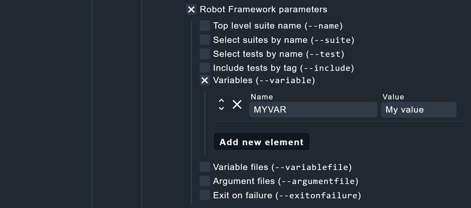

Under Robot Framework parameters you have the possibility to use some of the command line parameters of Robot Framework (which are also displayed by the command robot --help). If you want to use additional parameters, the option Argument files will help. A file specified here can contain any robot parameters. Further information about the individual parameters can be found in the inline help.
For our example project, only the option Variables is activated and a variable MYVAR with the value My Value is set. Remember the command Log ${MYVAR} at the top of the file tests.robot? This is the corresponding reference.
Command line parameters of Robot Framework.
Some options of the robot command

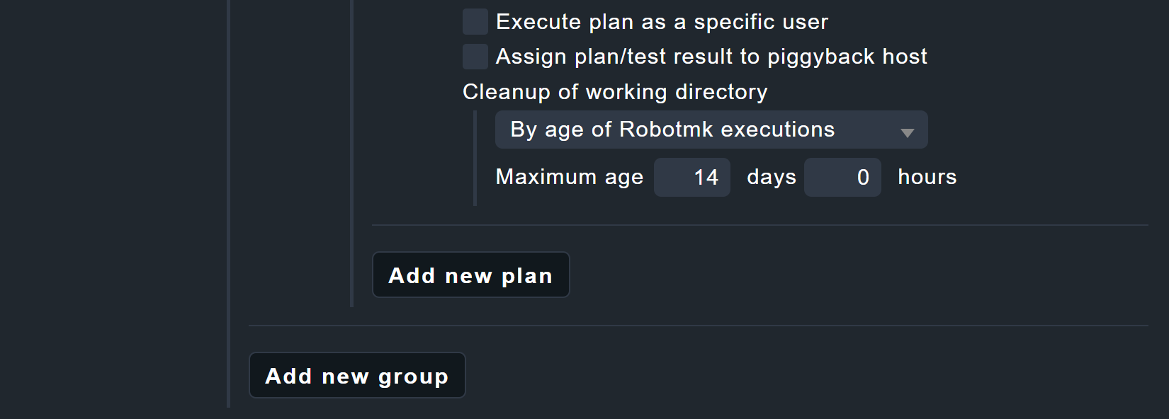

At the end of the suite configuration, there are three largely self-explanatory options. Execute plan as a specific user allows Robotmk to be executed in the context of a specific user account. Background: By default, Robotmk is executed in the context of the Checkmk agent (LocalSystem account), which has no authorization to access the desktop. Here a user can be specified who must be permanently logged in to a desktop session and who has access to graphical desktop applications accordingly.
With Assign plan/test result to piggyback host the results of the plan/test can be assigned to another host. For example, if Robot Framework is testing the ordering process of an online store, the results can be assigned to the corresponding web server.
Each test run produces data that is stored under C:\ProgramData\checkmk\agent\robotmk_output\working\suites\. By default, results from the last 14 days are retained, but you should bear in mind that large volumes of data can quickly accumulate here. At least 500 kilobytes of data are generated per run — with more complex test suites and embedded screenshots, for example, this can quickly add up to several megabytes of data. Depending on the execution interval, the size of the report and your documentation requirements, you should intervene in such a situation.
Options for user context, host assignment and automatic cleanup
Automatic cleanup of the large volume of generated data
Once here, you can now create further plans in this plan group or further plan groups.

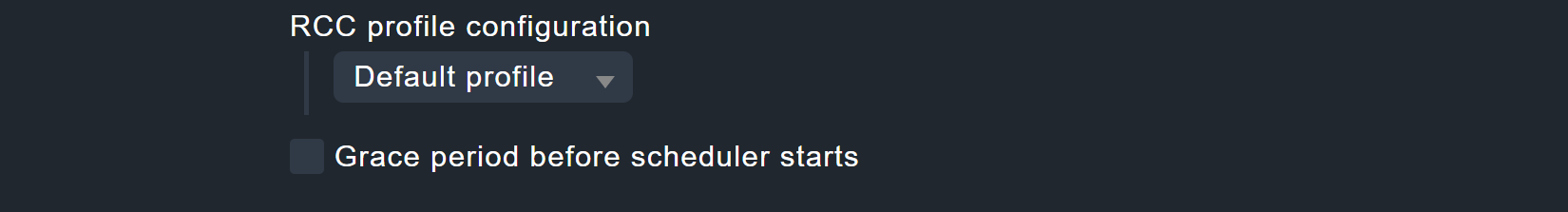

At the end there are two more options, which in turn relate to the complete Robotmk scheduler configuration.
RCC profile configuration allows you to specify proxy servers and hosts to be excluded.
Grace period before scheduler starts can also be very useful: The scheduler starts together with the Checkmk agent before the desktop logon — which, of course, means that any tests on the desktop must fail. The start can be manually delayed using a grace period.
Options for proxy server and a grace period for the scheduler start.
A grace period prevents failures

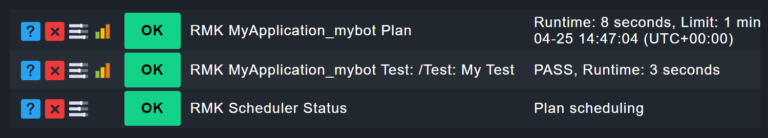

As soon as the Robotmk scheduler and the test suite have been run, the service discovery will produce three new services:
Robotmk-Services im Monitoring
The newly discovered Robotmk services
The service RMK Scheduler Status exists once and immediately after deployment. The services for plans and tests, here RMK MyApplication_mybot Plan and RMK MyApplication_mybot Test: /Test: My Test, are added to the monitoring as soon as the associated suites have been run for the first time.

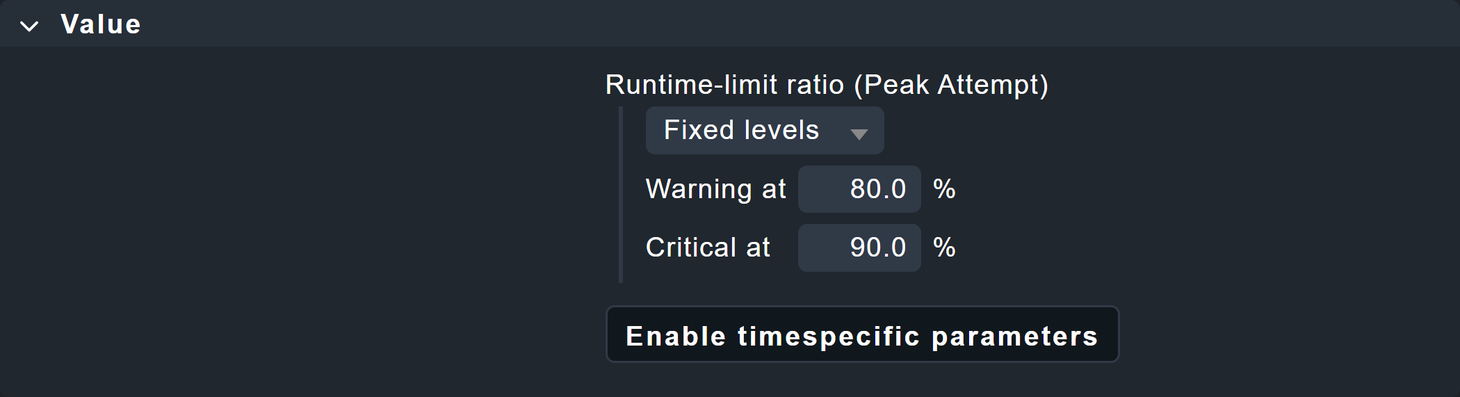

Creating a rule for the plan status
Reminder: Maximum runtimes for plans were defined in the agent rule above. These runtimes can be evaluated with the Robotmk plan rule. For example, you can set the service to CRIT when 90 percent of all calculated timeouts have been reached.
Configuration dialog for threshold values for runtimes of test suites.
Threshold values for status changes based on runtimes

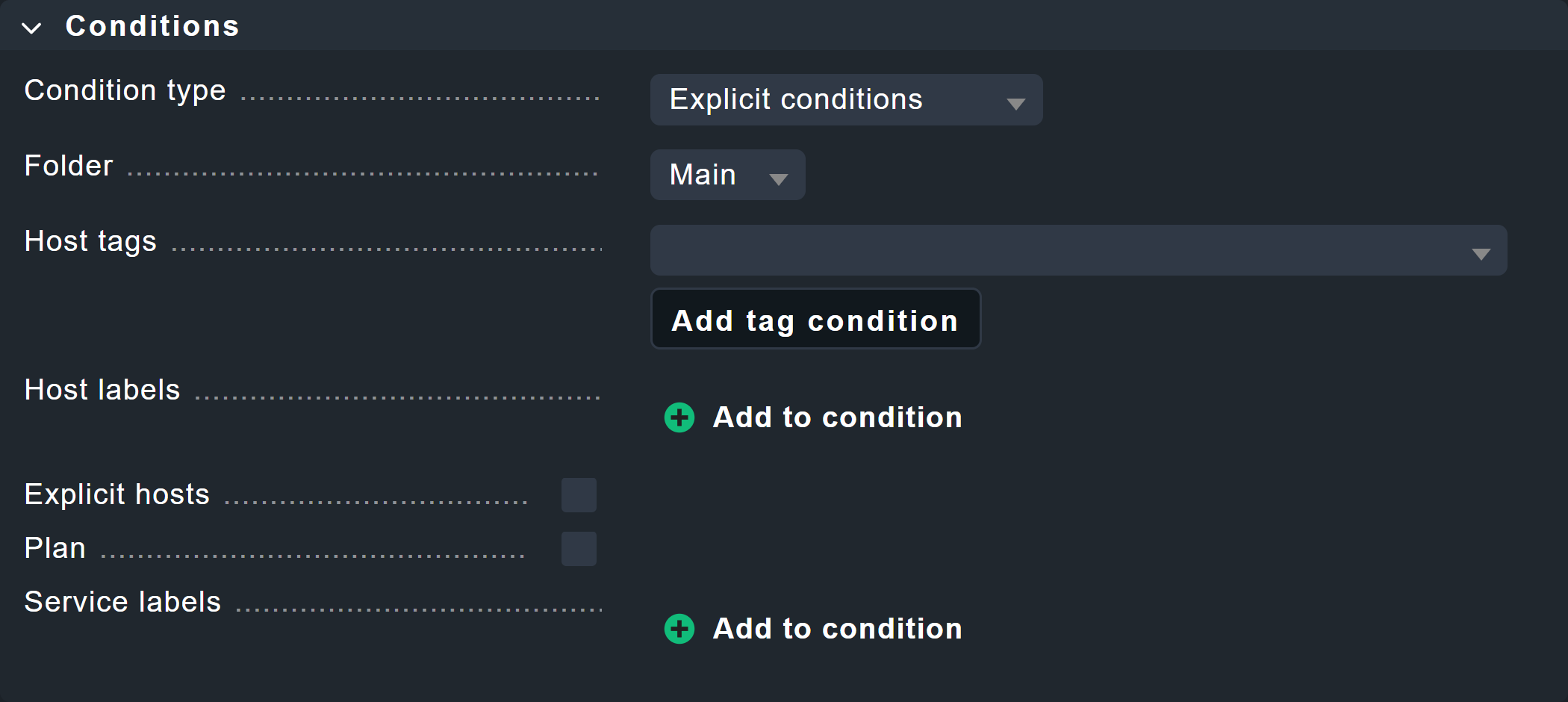

In the Conditions box, there is the option of restricting the rule to specific plans.
Dialog with restriction to the test suite 'mybot'.
Optional restriction to certain plans

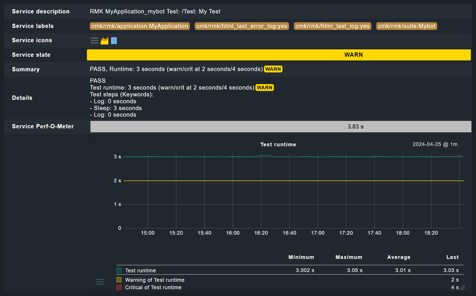

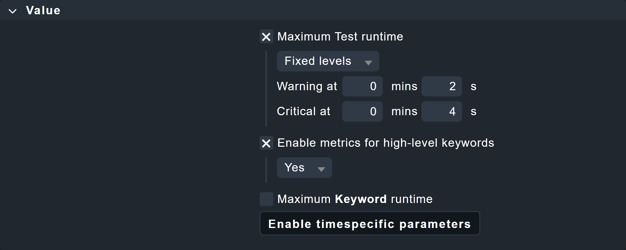

Creating a rule for the test status
Additional data can also be retrieved for individual tests in the test suites via the Robotmk test rule. Here you will again find the option to monitor runtimes, both for tests and keywords. The monitoring of keywords is a Checkmk-specific function. Therefore, the suite-internal status in the Robot Framework report could also be OK because the test suite was processed within the maximum permitted runtime — in Checkmk, however, WARN or CRIT, because a status change takes place at, for example, 80 percent of this maximum permitted runtime.
In addition, the Enable metrics for high-level keywords option can be used to generate metrics for higher-level keywords. This is particularly useful if your tests are organized in such a way that the higher-level keywords describe the 'what' and the lower-level keywords describe the 'how' — this gives you more abstract evaluations.
In this example, the threshold values for the maximum runtime of a test are 2 and 4 seconds. You will see the effects below in the chapter Robotmk in monitoring.
Rule for monitoring keywords with example values.
Monitoring can be expanded using keyword metrics

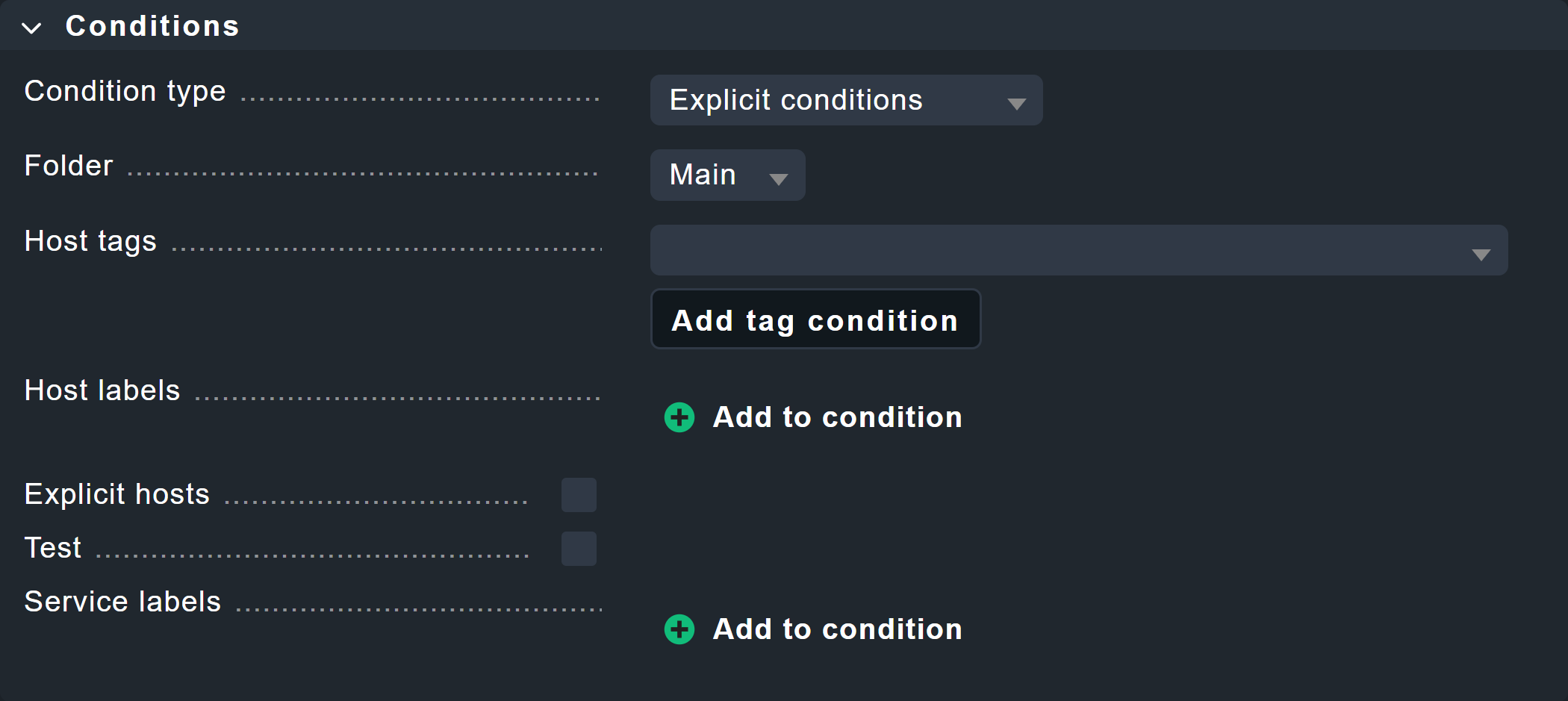

Once again, there is an explicit filter option in the Conditions box, here for individual tests.
Dialog with option to restrict to tests.
Optional restriction to certain tests

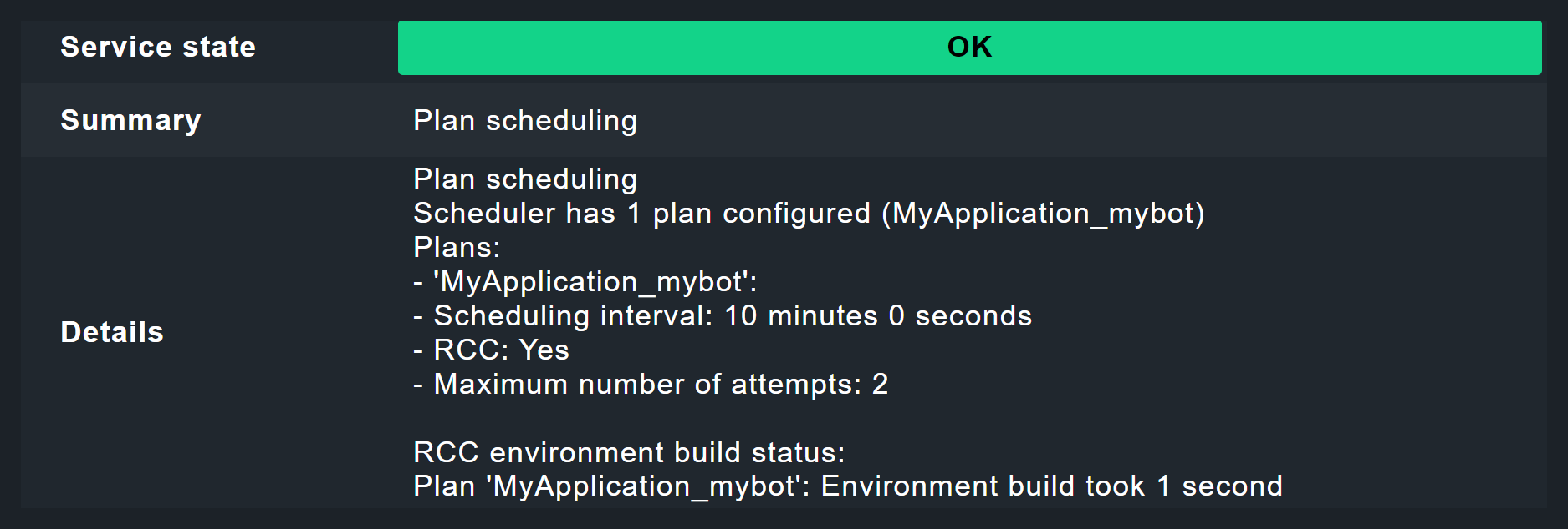

In monitoring, you will find services for the status of the Robotmk scheduler as well as the individual plans and tests — even if you have not created any separate service rules.
Scheduler status
The service RMK Scheduler Status is OK if the scheduler is running and has successfully built the execution environments.
Status of the scheduler in monitoring.
RCC was able to build the environments — in just one second
Here in the image you can see the note Environment build took 1 second. One second to build a virtual Python environment with Pip and Robot Framework? This is possible because RCC is clever: files that have already been downloaded are reused and a new build is only carried out after changes have been made in conda.yaml. The first build would have taken 30 seconds or more.

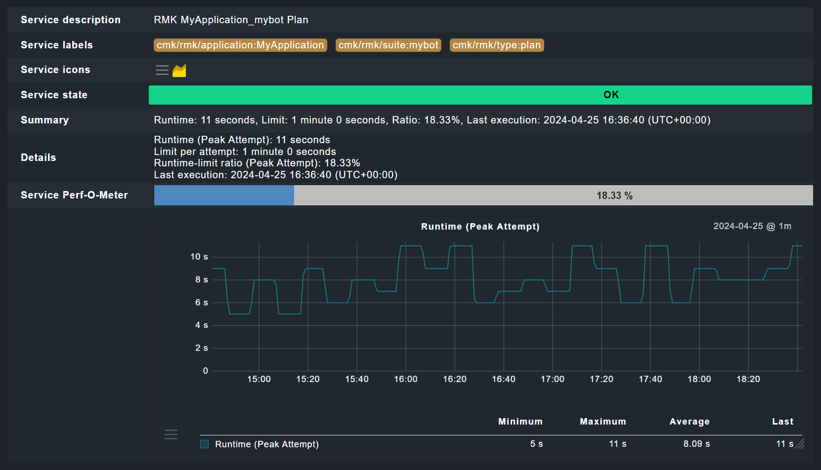

Plan status
The status of a plan is reflected in a service named by application name and suite, for example RMK MyApplication_mybot Plan.
Status of the test suite in monitoring.
The execution of a plan — especially relevant for administrators
Test status
The evaluation of the tests is where it gets really interesting. In the image you can now see the effect of the threshold values set above for the runtime of tests — here the 2 seconds for the WARN status. As the Sleep 3 Seconds instruction in the test itself already ensures a longer runtime, this service must go to WARN here, although the test was successful. The fact that the test was successful is shown by the Robot Framework report, which you can access via the icon log log icon.
Status of the test in monitoring.
Results of a specific suite — especially relevant for developers

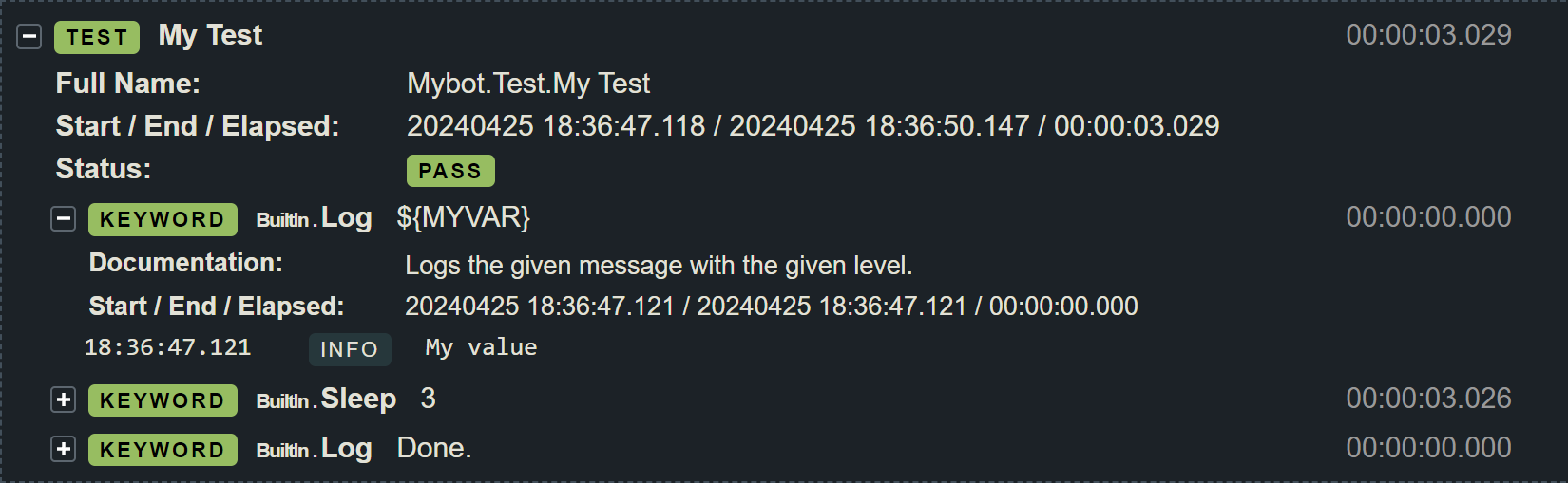

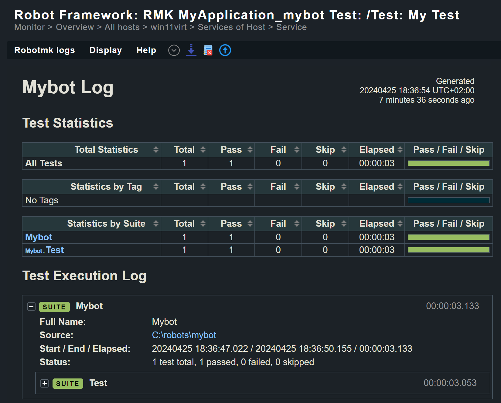

The report now clearly shows that the test and test suite have run successfully.
Robot Framework report for 'Mybot' test suite.
The Robot Framework log, here in optional dark mode
At the bottom of the data you can also see the individual keywords, here for example Log ${MYVAR} together with the value My value set in Checkmk for MYVAR.
Robot Framework report at keyword level.
The log file can be expanded down to the smallest details

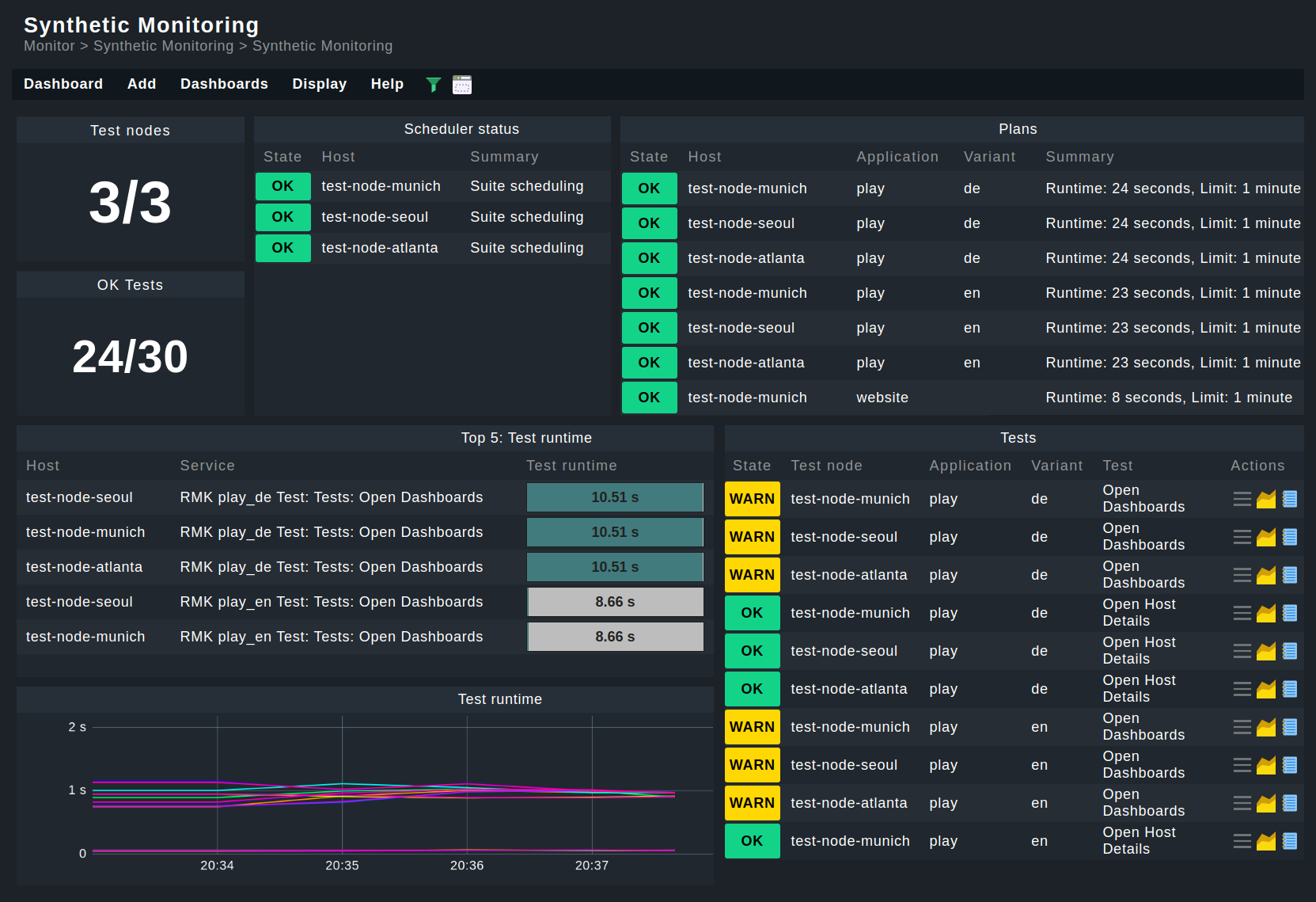

Dashboards
Of course, you can build your own dashboards as usual — but you can also find two built-in dashboards under Monitor > Synthetic Monitoring.
Robotmk dashboard in the web interface.
The complete Checkmk Synthetic Monitoring at a glance (shortened)
