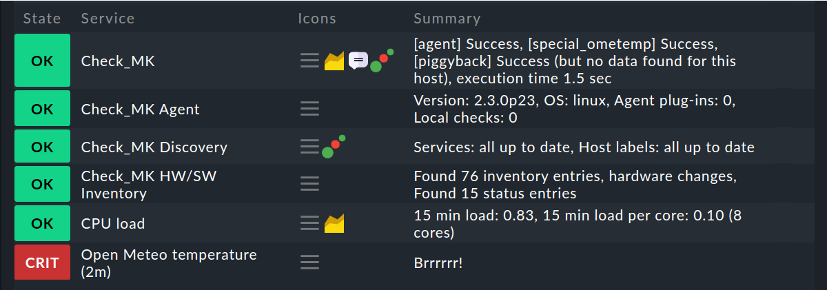

In combination with this check plug-in, the scripts described in this article for special agents, rule configuration and call configuration should now provide you with a functioning service in Checkmk:
View of services including ometemp.

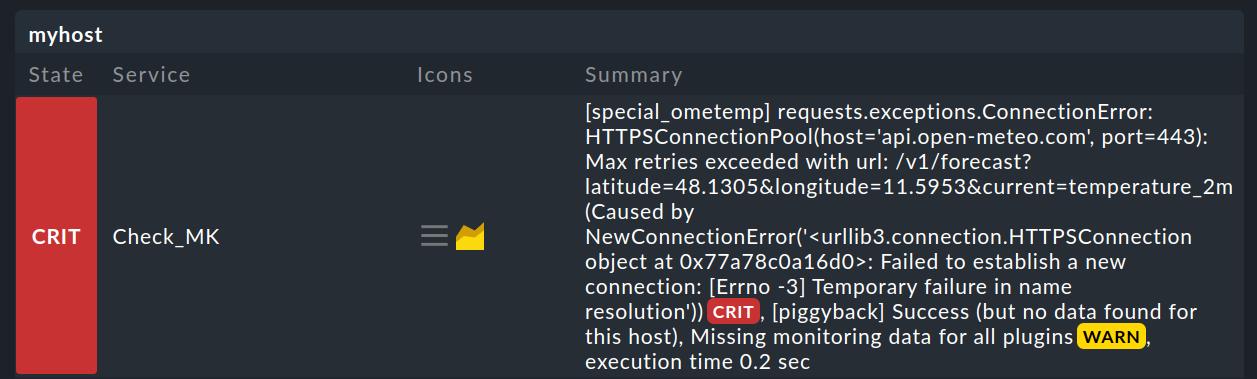

4. Troubleshooting
Even when developing your own special agents, errors and problems can (unfortunately) occur. Identifying what has caused an error is just as important as fixing it.
4.1. Warnings in the host’s service overview
If the Check_MK service suddenly changes its status to WARN or CRIT after its special agent has been activated, take a look at its associated Summary.
Error message from the Check_MK service related to its special agent.

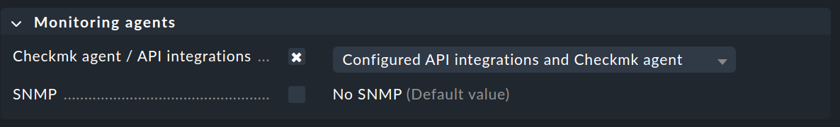

If the Summary indicates a connection with the new special agent, check the host properties. The Configured API integrations and Checkmk agent value must be selected for the Checkmk agent / API integrations parameter.
Selection of ‘Configured API integrations and Checkmk agent’.
