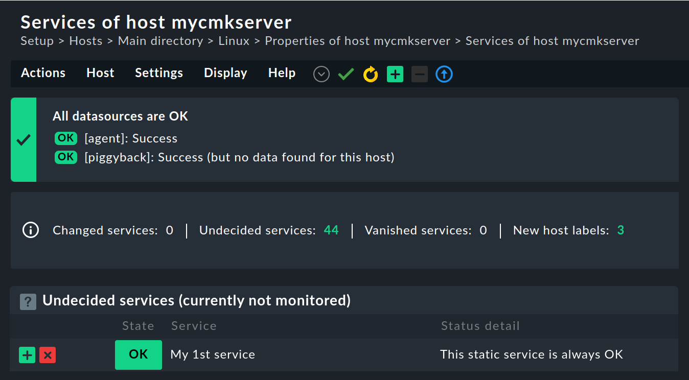

2.3. Adding the service to the monitoring
At every invocation of the Checkmk agent the local check contained in the script will also be executed and appended to the agent’s output. The service discovery also functions automatically like with other services:
localchecks services
Once the service has been added to the monitoring and the changes have been activated, the implementation of the self-created service with the aid of a local check will be complete. Should a problem arise during the service discovery, the Error analysis can be of help.

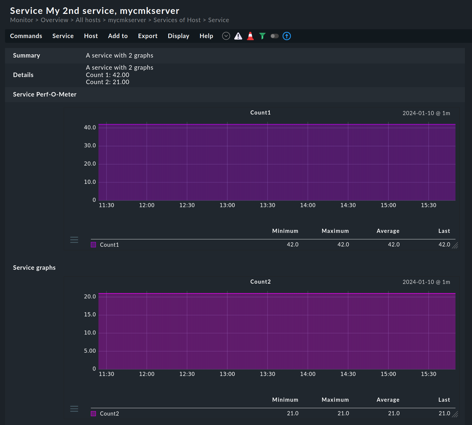

3.3. Multiple metrics
You can also have several metrics output. These are then separated by the 'pipe' character |, for example like this:
count1=42|count2=23
Attention: On Windows hosts you have to prefix a caret (^) to the pipe in the script, so that it does not get interpreted.
mylocalcheck.bat
@echo off
echo 0 "My 2nd service" count1=42^|count2=23 A service with 2 graphs
A complete output with two metrics will look like this:
root@linux# /usr/lib/check_mk_agent/local/mylocalcheck
0 "My 2nd service" count1=42|count2=23 A service with 2 graphs
After you have also included the new service in the monitoring, you will see the text for the status detail in the Summary field in the service list. After clicking on the service, the page with the service details is displayed. The metrics are shown in the Details field and below this you will see the service graphs automatically generated by Checkmk:
localchecks graphs2

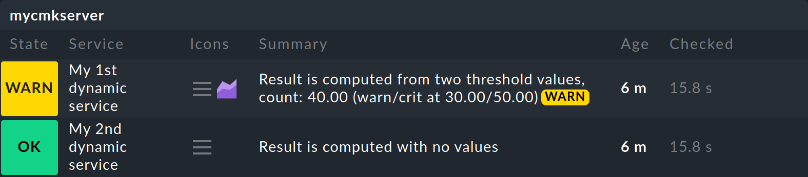

3.4. Calculating status dynamically
In the previous chapters, you learned how to set threshold values for metrics and how to display them in the graphs. The next obvious step is to use these thresholds for a dynamic calculation of the service state. Checkmk provides exactly these options for extending a local check.
If you pass the letter P instead of a number in the first field of the output that determines the state, the service’s status will be calculated on the basis of the threshold as provided.
An output will then look like this:
P "My 1st dynamic service" count=40;30;50 Result is computed from two threshold values
P "My 2nd dynamic service" - Result is computed with no values
… and the display in a service view like this:
localchecks dynsrv
The display differs in two points from the one that we saw earlier:
  • For services in the WARN or CRIT state, the Summary of the service shows all important information about the metrics (name, value, thresholds). This means you can always see how this status was calculated from a value. For all other states, the metric information is only displayed in the Details field.
  • If no metrics have been passed the service’s status will always be OK.

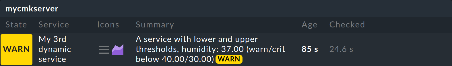

3.5. Upper and lower thresholds
Some parameters have not only an upper threshold but also a lower threshold. An example is humidity. For such cases the local check has the option of passing two threshold values each for the states WARN and CRIT. They are separated by a colon and represent the lower and the upper threshold value respectively.
In the general syntax, it looks like this:
metricname=value;warn_lower:warn_upper;crit_lower:crit_upper
… and in the example like this:
P "My 3rd service" humidity=37;40:60;30:70 A service with lower and upper thresholds
… and in the display of a service view like this:

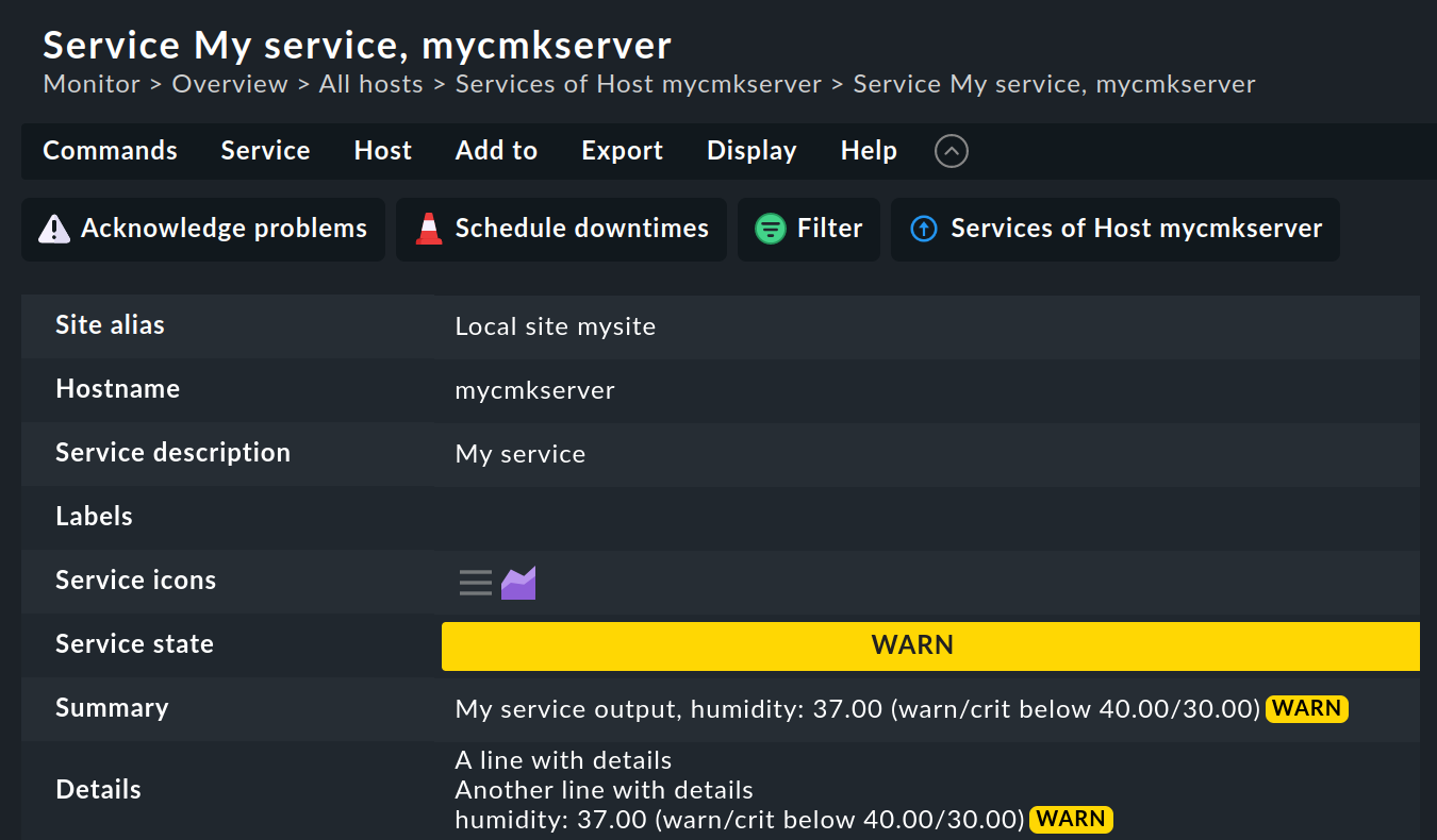

3.6. Multi-line outputs
The option to spread an output over multiple lines is also available. Because Checkmk runs under Linux you can work with the Escape sequence '\n' in order to force a line-break. Even if due to the scripting language the backslash itself needs to be escaped, it will be correctly interpreted by Checkmk:
P "My service" humidity=37;40:60;30:70 My service output\nA line with details\nAnother line with details
In the service’s details these additional lines will be visible under the Summary:
localchecks srv details

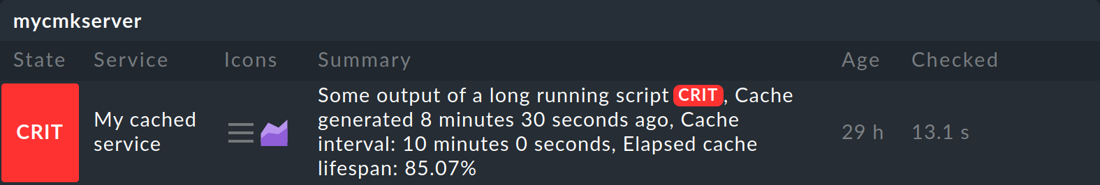

3.7. Executing asynchronously and caching output
The output of local checks, like that of agent plug-ins, can be cached. This can be necessary if a script has a longer processing time. Such a script is then executed asynchronously and only in a defined time interval and the last output is cached. If the agent is queried again before the time expires, it uses this cache for the local check and returns it in the agent output.
Note: Caching is only available for AIX, FreeBSD, Linux, OpenWrt and Windows.
Configuring Linux
Under Linux or another Unix-like operating system, any plug-in can be executed asynchronously. For a local check, the necessary configuration is very similar to that of a plug-in. To do this, create a subdirectory called the number of seconds you want the output to be cached and put your script in that subdirectory.
In the following example, the local check will be executed only every 10 minutes (600 seconds):
root@linux# /usr/lib/check_mk_agent/local/600/mylocalcheck
2 "My cached service" count=4 Some output of a long running script
The cached data is written to a cache directory.
For a service that provides cached data, the cache-specific information is added to the service view:
localchecks srv cached

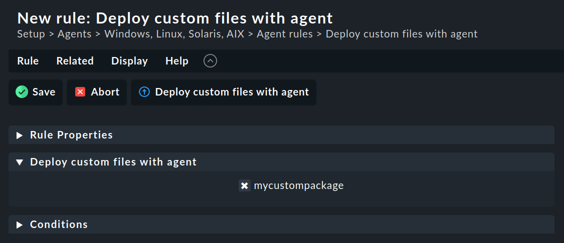

4. Distribution via the Agent Bakery
CEE If you are already using the Agent Bakery, you can also distribute the scripts with local checks to several hosts this way.
To do this, first create the directory custom on the Checkmk server as site user below ~/local/share/check_mk/agents/ and in it a subdirectory tree for each package of local checks:
OMD[mysite]:~$ cd ~/local/share/check_mk/agents
OMD[mysite]:~$ ~/local/share/check_mk/agents$ mkdir -p custom/mycustompackage/lib/local/
The package directory in the above example is mycustompackage. Below that, the lib directory flags the script as a plug-in or as a local check. The subsequent local directory then allocates the file explicitly. Place the script with the local check in this directory.
Important: On Linux, you can configure asynchronous execution analogously as described in the previous chapter by now creating a directory under custom/mycustompackage/lib/local/ with the number of seconds of the execution interval and placing the script there. Under Windows, you can use the rule sets Set execution mode for plugins and local checks and Set cache age for plugins and local checks. These and other rule sets for local checks under Windows can be found in the Agent Bakery under Agent rules > Windows Agent.
In the configuration environment of Checkmk, the package directory mycustompackage will be shown as a new option: Open Setup > Agents > Windows, Linux, Solaris, AIX, create a new rule with Agents > Agent rules > Generic options > Deploy custom files with agent and select the newly-created package:
localchecks custom
Checkmk will then autonomously integrate the local check correctly into the installation packet for the appropriate operating system. After the changes have been activated and the agent baked, the configuration will be complete. Now the agents only need to be distributed.

My service           My service output\, humidity: 37.00 (warn/crit below 40.00/30.00)(!)
For both commands we have shortened the output by lines not relevant for this topic.
If there are errors in a local check, Checkmk will identify them in the service output. This applies as well for erroneous metrics, for false or incomplete information in the script output, or an invalid status. These error messages should aid in quickly identifying errors in a script.
